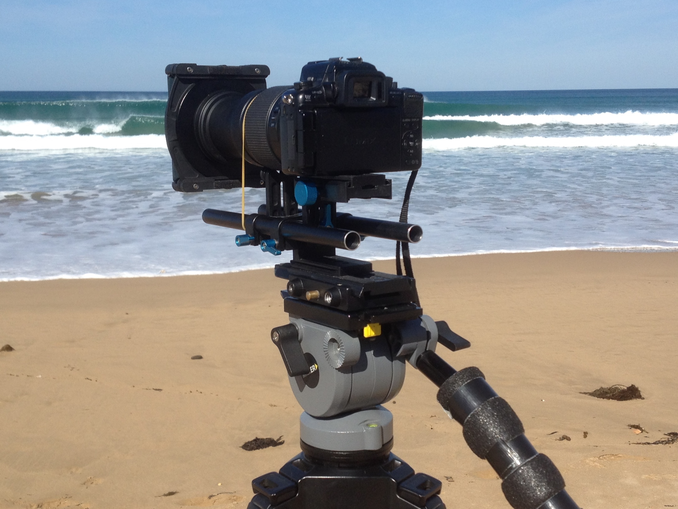

Stanley Posted July 3, 2016 Share Posted July 3, 2016 I have a matte Box but much prefer using just a filter holder. I've made a hood for it if needed. Having a Matte Box in windy conditions is a nightmare for me. Link to comment Share on other sites More sharing options...
