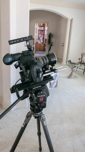

docmoore Posted September 23, 2015 Share Posted September 23, 2015 I hesitate but here it is .... no cinema just working on exposure and post process with these... Two lenses very different character on the C100 Mk II Zeiss Otus 85https://vimeo.com/139408101Richard Gale DSO 88 FFhttps://vimeo.com/139083257 Similar subject matter ... inside soft diffused natural light to outside Texas summer ... I find the rendering of the Canon to be wholly organic the antithesis of harsh clinical ... colors very natural and accurate. When you nail the exposurethey are wonderful ... overexpose a bit and they still refrain from evoking any sense of brittle on the edge of a break character. Such a wonderful camera to shoot ... main drawback is all the material you can capture in a short period of time ... lots to filter through in post.These both were with the Odyssey 7Q+ in Prores HQ ... some say overkill but what a great monitor to gauge exposure and focus. Sorry for the length of the files ... this is about 20% of what I captured with the camera on those outings. And I tend towards a robust file ...not too many milky blacks .... As I normally do not find those in my subject material. Bob Link to comment Share on other sites More sharing options...
