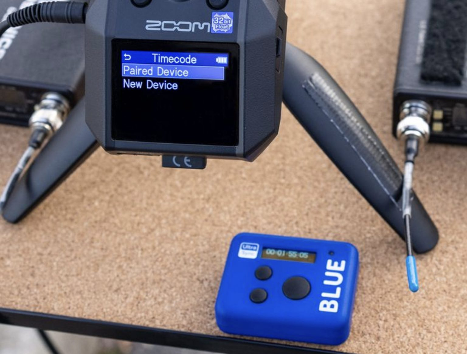

IronFilm Posted January 26, 2024 Share Posted January 26, 2024 A new model, the "Zoom H4essential" just got released today for US$199. Supports timecode, but only via the Atomos (formerly TCS Ltd) Ultrasync BLUE. The new Zoom H6essential (for US$299) also supports timecode via the same manner as well. Is interesting seeing even these very low end consumer products are now kinda supporting timecode too. https://www.newsshooter.com/2024/01/25/zoom-adds-three-new-models-to-its-lineup/ Link to comment Share on other sites More sharing options...

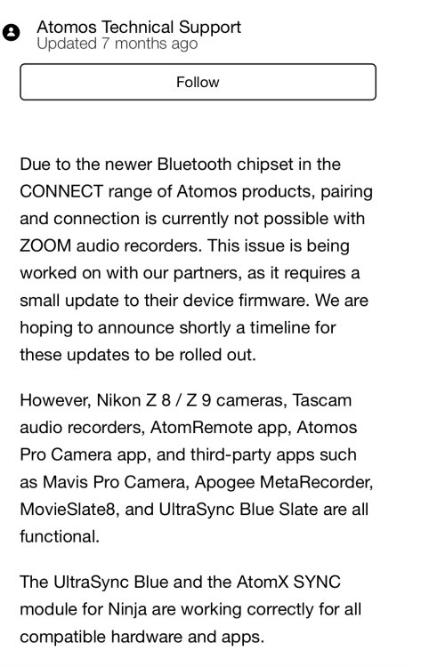

Super Members BTM_Pix Posted January 26, 2024 Super Members Share Posted January 26, 2024 A word of caution about the Atomos/Zoom partnership when it comes to the Connect module for the Ninja V is that it doesn’t work. I got the Connect in a bundle with the AtomX Cast so it wasn’t a massive financial hit but it’s annoying nonetheless as I was looking to it to provide sync of my Zoom recorders when recording ProRes RAW. Needless to say no firmware update has been forthcoming. Which brings me to the second note of caution about their alliance which is that the new Atomos branded UltraSync Blue does not work with my Zoom H3VR due to the same Bluetooth incompatibility with their new chipset whereas the original TimecodeSystems ones do. My F2BT and F3 with the BTA-1 module work perfectly with it but it’s a no-go for the H3VR and, again, needless to say no new firmware has been forthcoming to resolve it. It was interesting to see earlier in the week that FujiFilm are releasing a firmware update to allow the XH2 and XH2S to join the Nikon Z8/Z9 in being able to receive timecode from the UltraSync Blue and hopefully Panasonic and Sony might join in to give the option to use their generally underutilised Bluetooth ports (for video at least) for something useful too. sanveer, IronFilm and ac6000cw 1 2 Link to comment Share on other sites More sharing options...
KnightsFan Posted January 26, 2024 Share Posted January 26, 2024 I guess this TC approach is technically better than nothing, but I do not like being vendor locked into a closed, proprietary system. BTM_Pix's post perfectly encapsulates why. LTC is simple, works well, and has open documentation, so in the absolute worst case, you can fix problems yourself. Not so with UltraSync Blue. Buying a dongle for TC is fine , but if Zoom made a dongle that takes normal LTC via a BNC or 3.5mm, that would be sooooo much better. IronFilm 1 Link to comment Share on other sites More sharing options...

IronFilm Posted January 27, 2024 Author Share Posted January 27, 2024 On 1/26/2024 at 6:32 PM, BTM_Pix said: A word of caution about the Atomos/Zoom partnership when it comes to the Connect module for the Ninja V is that it doesn’t work. I got the Connect in a bundle with the AtomX Cast so it wasn’t a massive financial hit but it’s annoying nonetheless as I was looking to it to provide sync of my Zoom recorders when recording ProRes RAW. Needless to say no firmware update has been forthcoming. Which brings me to the second note of caution about their alliance which is that the new Atomos branded UltraSync Blue does not work with my Zoom H3VR due to the same Bluetooth incompatibility with their new chipset whereas the original TimecodeSystems ones do. My F2BT and F3 with the BTA-1 module work perfectly with it but it’s a no-go for the H3VR and, again, needless to say no new firmware has been forthcoming to resolve it. It was interesting to see earlier in the week that FujiFilm are releasing a firmware update to allow the XH2 and XH2S to join the Nikon Z8/Z9 in being able to receive timecode from the UltraSync Blue and hopefully Panasonic and Sony might join in to give the option to use their generally underutilised Bluetooth ports (for video at least) for something useful too. Expand That's very worrying that there are all these TC incompatibilities with different bluetooth chipsets. Is why they should just use 3.5mm (or even better BNC) for timecode! As if you simply do it the good old way of hardwired, as everything should be for TC, then I could take a twenty year old timecode box and sync it up with a modern camera made today. Or I could take a modern timecode box made today and sync it up with a twenty year old camera! Link to comment Share on other sites More sharing options...
