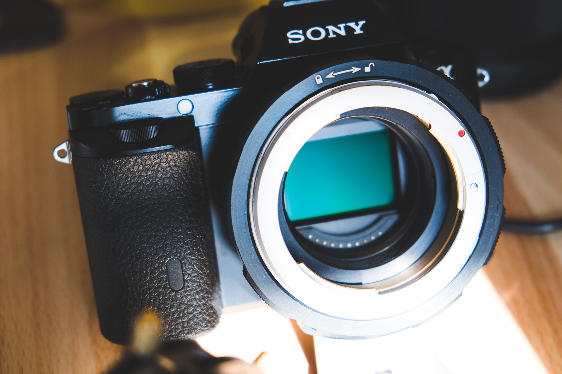

Above: Canon EF locking adapter for Sony E-Mount
In my opinion these are some of the best adapters currently on the market for Canon & Nikon glass.
They take a normal Canon or Nikon lens and turn it into a PL mount (positive locking) with no play between the mount and lens.

I don't get after reading many times. Aren't Canon EF & Nikon F positive lock? (and basically all modern mount, one I've used without PL is the C mount on the D.Bolex)
Excuse my ignorance but do these (very expensive) adapters offer compared to the competition?
  • Administrators
No, EF and Nikon lenses are bayonet locking.
With a positive lock, this works like a PL adapter for cinema lenses.
A locking ring locks around the lens, securing it with absolutely no wiggle like you get with a bayonet.
So rather than rotating to lock the lens, you hold the lens to the adapter and rotate the adapter's locking mechanism around it instead... just as you would do when mounting a PL lens to a RED EPIC.
