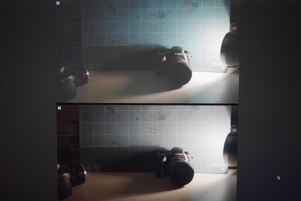

jcs Posted January 1, 2015 Share Posted January 1, 2015 Can we additionally shoot gray scales and charts, and match the brightness on a middle gray shade in one comparison, match black shade in another comparison and match white in another comparison? Such tests might give us a clearer idea of what's going on.Tupp- folks shooting charts/wedges get 12-14 stops for the A7S, and typically ~12 stops for the 1DC:http://***URL not allowed***/dynamic-range-sony-a7s-vs-arri-amira-canon-c300-5d-mark-iii-1dc-panasonic-gh4/Cinema5D's results are controversial, however they used a very high end Xlya 21 self-LED-lit chart in total darkness.Samuel Hurtado gets 12 stops with SLog2 for the A7S: http://www.dvxuser.com/V6/showthread.php?331924-slog2-8-bits-in-14-stops, with his main point all those stops are useable (vs. other cameras). MacGregor measured about the same using CINE4.It would appear the A7S has more DR in the shadows, and about the same or slightly more DR in the highlights vs. the 1DC (based on Andrew's example images). A7S via HDMI must be denoised in post (unlike the 1DC which is still doing NR with settings on "off").araucaria- it's well known that SGamut in Slog2 on the A7S is best avoided, and instead use Pro or Cinema to provide much better color performance. Slog3/Sgamut3 work much better (FS7 and above).The 1DC produces a superior film-style image, especially in color and skin tones vs. the A7S. The A7S provides significantly more detail and more dynamic range. Canon 5D3 RAW produces even better color than the 1DC and about the same DR. For delivering (softish/filmic) 4K content, the 1DC is a very nice camera. When there's good light, the GH4 is excellent too.For 1080p delivery, 5D3 RAW is still the best deal for those wanting something full frame and filmic. I'm currently experimenting with 5D3 RAW to DNG (mlrawviewer), directly into PPro then after WB and basic adjustments back out to XAVC for editing (then archiving the MLV or deleting it). It sounds like 1DC MJPEGs need to be transcoded, so 5D3 RAW isn't much more work and will provide 14-bit color (and 10-bit 422 XAVC/ProRes/DNxHD if transcoding).Also testing the A7S to see if skin tones and a nice filmic look can be derived to look nearly as good as 5D3 RAW (much smaller files, more usable DR, more detail). When a camera is as sharp as the A7S, we can use a lens filter (have a Tiffen Promist on order) or blur in post.To get the most from the A7S, one profile is needed for low light, and another for bright light (perhaps even more for best results). You'll find what works for you with a bit of testing. Link to comment Share on other sites More sharing options...

The Chris Posted January 2, 2015 Share Posted January 2, 2015 A7s looks better in the shadows and has more detail, win-win on the DR and price front. Link to comment Share on other sites More sharing options...
Daniel Lee Posted January 2, 2015 Share Posted January 2, 2015 The 1DC exhibits clipping where the A7s does not, but has a cleaner image than the A7s from what I can tell. Link to comment Share on other sites More sharing options...
Administrators Andrew - EOSHD Posted January 2, 2015 Author Administrators Share Posted January 2, 2015 The 1DC exhibits clipping where the A7s does not, but has a cleaner image than the A7s from what I can tell.It's the other way round on the clipping. Just look at the images I've put up from the original files.Don't try to grade the web compressed JPEGs! Link to comment Share on other sites More sharing options...
jcs Posted January 2, 2015 Share Posted January 2, 2015 For video, Canon rates the 1DC at 12 stops. Sony rates the A7S at 15 stops. In lab conditions with the Xyla 21 chart, the 1DC gets around 12 and the A7S around 14. For useable DR Samuel and MacGregor got 12 for the A7S and by their metric of useable DR would expect the 1DC to be 11 stops (dropping 1-2 stops measured for useable DR).Asking us to look at your examples without modifying them to explore useable DR doesn't make sense, as we'd most certainly make changes for any real work. Even so, your examples generally show more useable DR with the A7S.Comments that imply our eyes don't work are unprofessional, immature, and antagonistic. If you'd like to create drama for page views vs. an honest search for truth, wherever it may lead, how can we take anything you say seriously? pablogrollan and dafreaking 2 Link to comment Share on other sites More sharing options...
