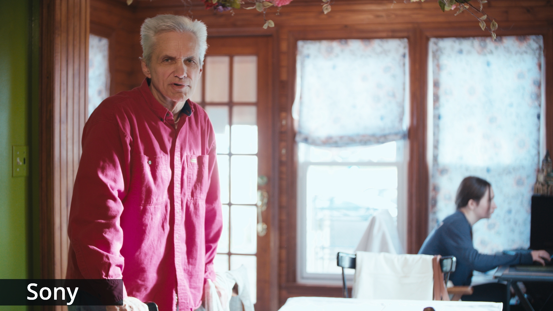

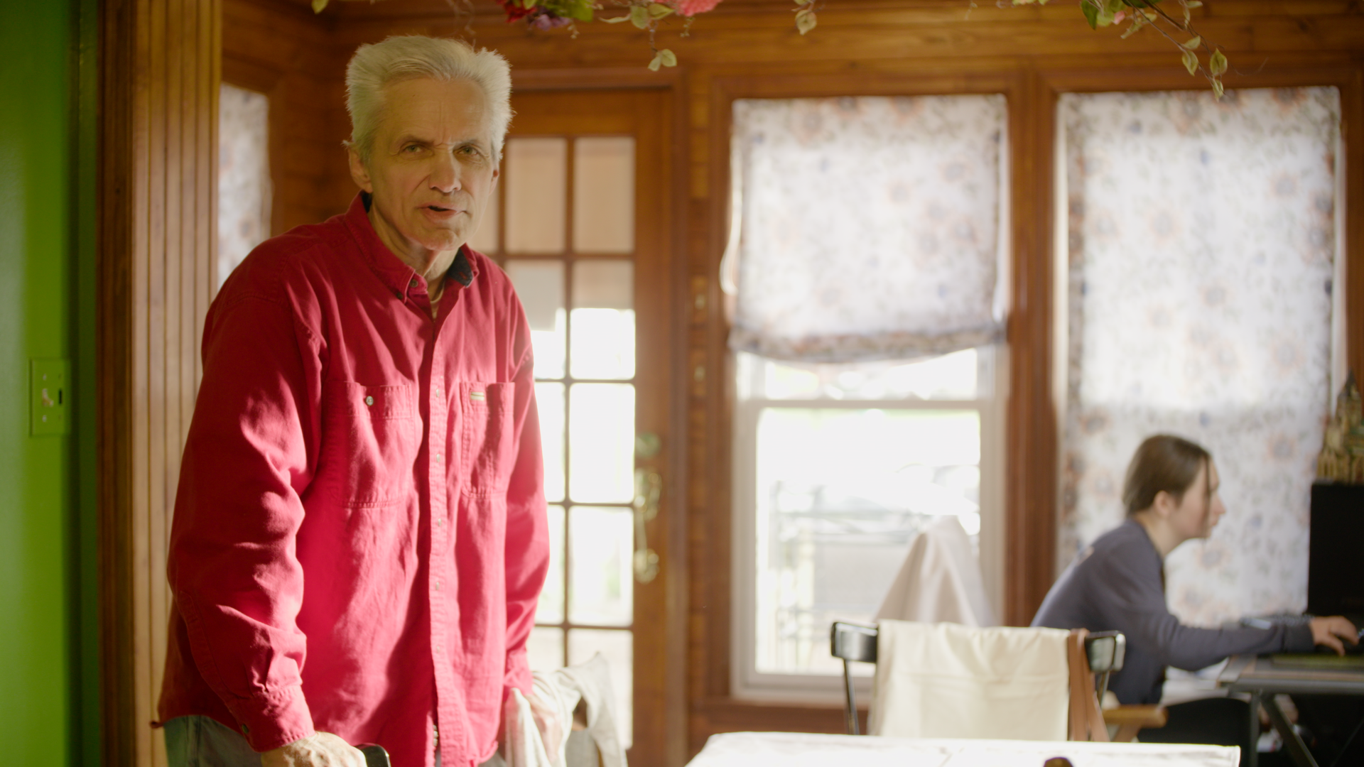

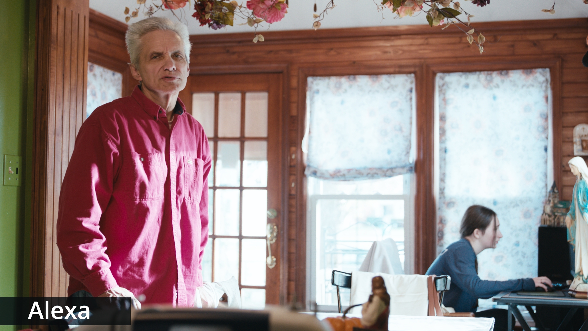

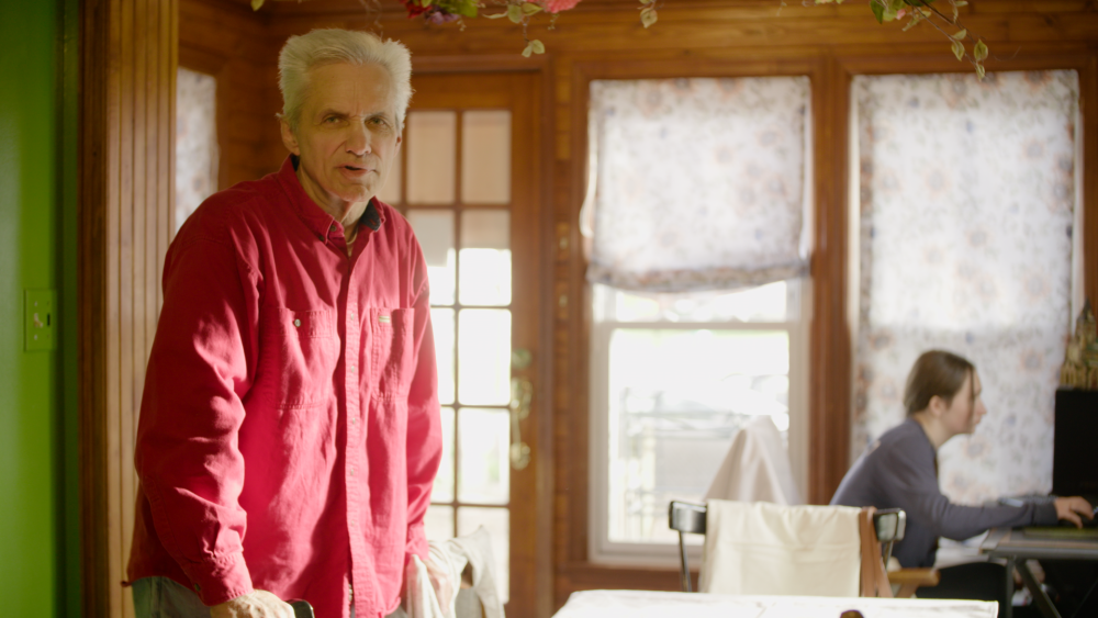

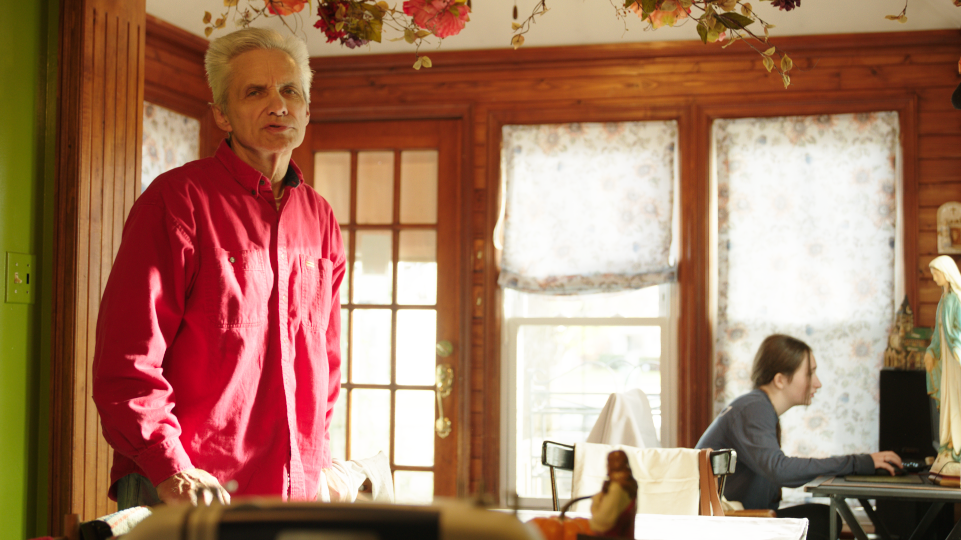

TomTheDP Posted November 7, 2023 Share Posted November 7, 2023 @PannySVHS Here is the Sony with the Alexa. I just adjusted the Hue on the sony and applied the Emotive Color ARRI Daylight lut. Now this is a really bad lighting situation. Sunlight, combined with Tungsten, and also bright green walls in the room lol. here is the raw video from both cameras as well as PNG stills of the LOG image if anyone wants to play with them. https://drive.google.com/drive/folders/1fYuQyBHEq9zvrIB_pQ-GBMXWOKxIhP8W?usp=sharing BrunoCH and PannySVHS 2 Link to comment Share on other sites More sharing options...
TomTheDP Posted November 7, 2023 Share Posted November 7, 2023 @kye I used your hue adjustment technique as a starting point. I think that improved it a lot, no more pink/magenta from the Sony. Might have went too far though. I still have hope for the FX3 as an A cam. 😅 kye 1 Link to comment Share on other sites More sharing options...
kye Posted November 7, 2023 Author Share Posted November 7, 2023 6 hours ago, TomTheDP said: You have to go further then simply exposing the cameras the same and having them set to the same WB. For example having say the Alexa set to 5600k and the FX30 the same in a daytime situation will yield very different results. I recommend doing a proper WB. I've seen a bunch of side-by-side tests where they set both cameras to the same Kelvin WB and then nothing matched. I have no idea why the cameras wouldn't all match the WB, but it looks like they never do. I'd suggest trying a custom WB on a grey card and then trying the comparison again? Link to comment Share on other sites More sharing options...
TomTheDP Posted November 7, 2023 Share Posted November 7, 2023 I'll do one with a grey card next time. 27 minutes ago, kye said: I recommend doing a proper WB. I've seen a bunch of side-by-side tests where they set both cameras to the same Kelvin WB and then nothing matched. I have no idea why the cameras wouldn't all match the WB, but it looks like they never do. I'd suggest trying a custom WB on a grey card and then trying the comparison again? what looks glaringly off to you in the above comparison? Link to comment Share on other sites More sharing options...

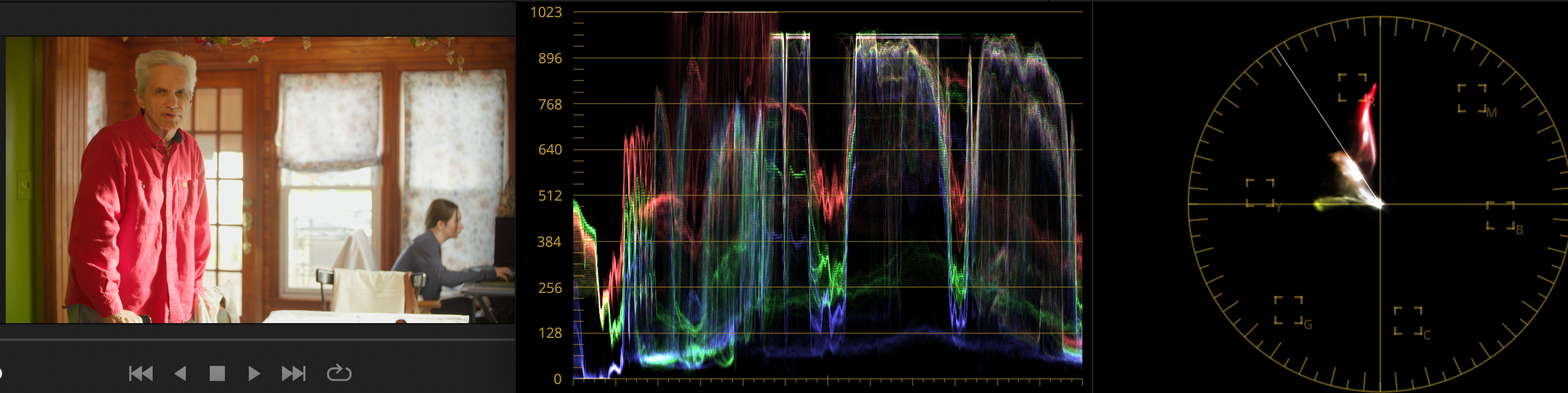

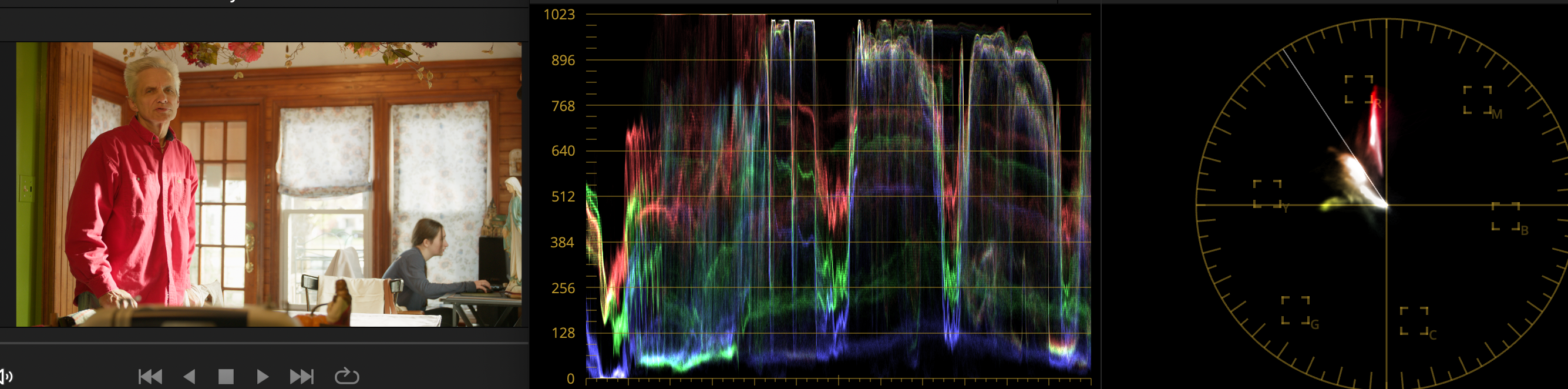

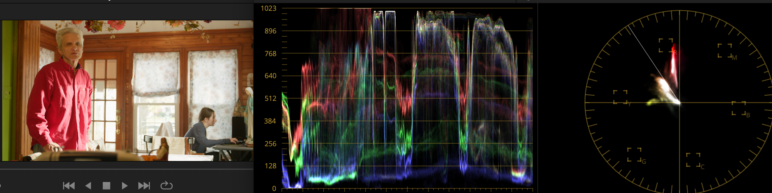

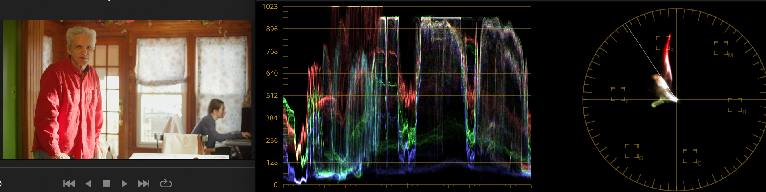

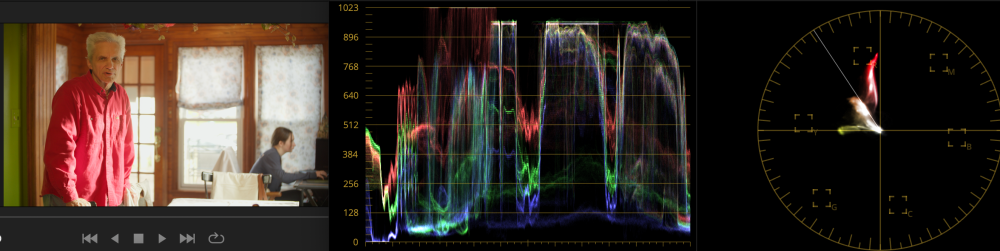

kye Posted November 7, 2023 Author Share Posted November 7, 2023 @TomTheDP Here's a basic match. As I don't own the LUT packs, I have just used a CST sandwich - first node converts to Davinci, second does adjustments, third converts to 709/2.4. The Alexa has no adjustments at all, Sony has a Hue rotation for skin and Tint adjustment pushing green for neutrals. These were literally done just by looking at the vector scope. Added Hue curves for the green wall and the jacket: That would be good enough for most work I'd imagine. 7 minutes ago, TomTheDP said: I'll do one with a grey card next time. what looks glaringly off to you in the above comparison? Skintones. Always skin tones. It's where the viewer will be looking, and we're sensitive to very slight differences. BrunoCH 1 Link to comment Share on other sites More sharing options...
kye Posted November 8, 2023 Author Share Posted November 8, 2023 By the time you put a grade over it, those appear to be fine. This is with a 2383 PFE LUT and I adjusted the WB to be cooler for a bit of separation and reduced the saturation a little: Link to comment Share on other sites More sharing options...
