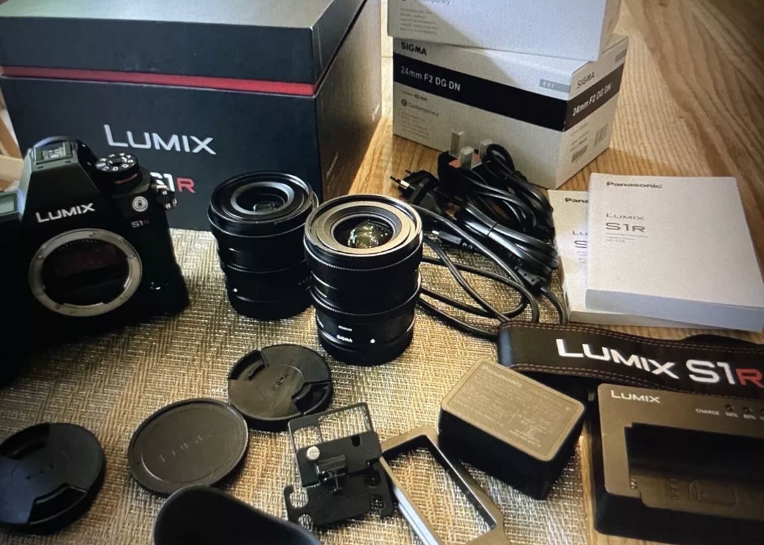

Ninpo33 Posted November 26, 2024 Share Posted November 26, 2024 On 6/16/2022 at 8:58 AM, MrSMW said: Did you know (do you even care…) that the venerable S1R can shoot 10 bit, 5k 30p internally? 🤔 I do care…!!! Just scooped up a deal on eBay for a really clean S1R with two Sigma Contemporary primes (24mm and 35mm f/2) for $1,400 total. Ends up being about $750 US for the S1R body. So excited to play with the 5k mode and have the higher res stills compared to my current setup. Used LUMIX cameras continue to offer crazy specs for the price. Going back through the posts looking for tips and info now on getting the most out of the camera. eatstoomuchjam 1 Link to comment Share on other sites More sharing options...
