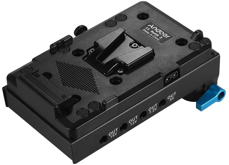

herein2020 Posted September 1, 2020 Share Posted September 1, 2020 22 hours ago, Hangs4Fun said: Easy way to remember that cabling sequence, is that you always start and end with power Had no idea this could happen, I power my monitor with a dummy battery and v mount plate adapter as well. Is this still possible even if the v-mount plate is turned off? I use the adapter plate shown below, it has a power switch to turn off and on the power and I always power it off before connecting or disconnecting any of the cables. Link to comment Share on other sites More sharing options...
Hangs4Fun Posted September 1, 2020 Share Posted September 1, 2020 3 hours ago, herein2020 said: Had no idea this could happen, I power my monitor with a dummy battery and v mount plate adapter as well. Is this still possible even if the v-mount plate is turned off? I use the adapter plate shown below, it has a power switch to turn off and on the power and I always power it off before connecting or disconnecting any of the cables. That is a nice feature. If there is no voltage flowing, then the circuit in question is dead. Most systems don't have that switch option. I had posted an easy to remember "you always start and end with power" in your case you are doing that by disabling the power source. Also, remember this was more a possibility on SDI 6G/12G because the BNC cable could have a proceeding positive that touched before the ground completing the circuit through SGI 😮 This has been reported to happen with HDMI solutions, particularly with the faster HDMI 2.0 and 2.1 (that new 2.1 spec is crazy fast at 48 Gbps). Most likely the gold connections were a tad higher for positive and/or neg had oxidation or lint or something, allowing postive to touch first. In that scenario if you have a powered circuit to both your camera and recorder from the same power source, your hdmi in that scenario can complete the circuit. Many times it can happen quick enough that the higher currents in the battery circuit don't spend enough time in hdmi or sdi to do damage, but in other cases it can fry the hdmi or sdi circuit (they just weren't meant for those levels of currents). All that being said, if you use good quality cables, V Mount plates, C Mount Battery, etc. you are less likely to experience an issue. But if you just follow a good workflow when operating your camera, you can avoid this issue all together. Always start and end with power. Get your power circuits in place and then add input/output. Before shutting down remove all input/output, then disconnect power. The important thing is to keep that power circuit in place to keep the voltage and current in the right places and using the correct grounds. PannySVHS and herein2020 2 Link to comment Share on other sites More sharing options...
