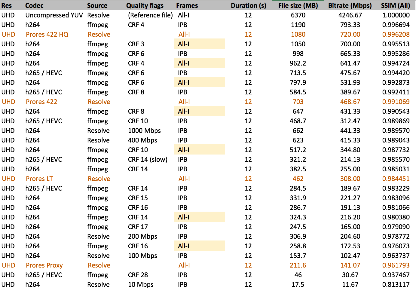

kye Posted August 12, 2020 Share Posted August 12, 2020 Some cameras shoot RAW and Prores, and some shoot h264 and a few shoot h265. There's lots of bitrates on offer too, 50Mbps, 100Mbps, etc. Some are ALL-I and some are IPB. But how good are they? I couldn't find any comparisons, so I did some myself. What I did was take a few shots from the BM Micro Cinema Camera shot in uncompressed RAW of a tree moving in the wind, and made a single UHD frame by putting them in each corner, like this: Also, they were of different lengths, so I just repeated each one, like this: So we have a test clip that was shot RAW (maybe compressing already compressed footage is easier? I don't know, anyway..), that includes decent movement but isn't some stupid test case that means nothing in real life, that doesn't repeat (because the clips are different lengths), and has some deliberately almost crushed blacks to test the pixelation that h264 and h265 sometimes get in the shadows. Then I exported an uncompressed 10-bit 422 YUV file to use as a reference. After some tests and seeing the file sizes and processing times, I decided to only use the first 12s of the timeline. Then I rendered a bunch of clips, either h264 from Resolve, or h264 and h265 from ffmpeg. I tried rendering h265 from Resolve but had issues, and in this test all the maximum bitrates I tried all created the same size file, so I abandoned that. Common wisdom online is that Resolves h265 export mechanism isn't the best and you should use ffmpeg anyway. Then I compared the compressed clips with the uncompressed reference file, which gives a score called SSIM, which goes from 1 (a perfect match) downwards. Here's the results so far: Here are some observations / thoughts, and some answers to some questions I'd had: In Resolve, H264 seems to top out, as I couldn't get it to export at more than about 400Mbps IPB, but ffmpeg went higher than that quite happily ALL-I h264 doesn't seem to be that different than IPB, at higher bitrates anyway - slightly lower quality and slightly higher file size, but not the 3x I've read around the place Prores isn't that much worse in terms of quality vs compression than h264 or h265, despite being an older codec (although maybe there are versions? I have no idea how prores works.. maybe that's important for this topic?) Different encoders have different levels of quality, so what's in a given camera is likely to differ from these results I guess the real question is, how much h264 do you have to have to equate to Prores? The answer seems to be "about the same bitrate, but probably a little less for an ALL-I codec, and a little less bitrate again if it's an IPB". KnightsFan, ntblowz, John Matthews and 2 others 5 Link to comment Share on other sites More sharing options...
kye Posted August 12, 2020 Author Share Posted August 12, 2020 In terms of the GH5, it means that: the 1080p 10-bit 422 200Mbps ALL-I mode is likely to be roughly equivalent to 1080p Prores HQ which is 176Mbps the UHD 10-bit 422 400Mbps ALL-I mode is likely to be roughly equivalent to UHD Prores 422 which is 471Mbps Not bad at all. Link to comment Share on other sites More sharing options...

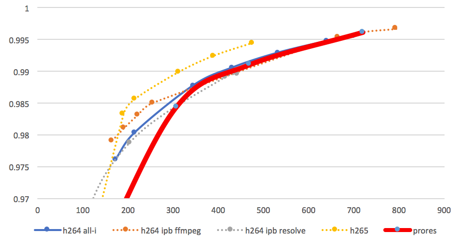

kye Posted August 12, 2020 Author Share Posted August 12, 2020 Here's the graph of what I've done so far: I haven't done any h265 all-i tests yet, although I'm not sure if there are any cameras that use this? I'll also do Prores 4444 and 4444 XQ for completion, assuming Resolve has them. I guess the only news is that h265 is better than h264 or Prores, but it's not 2x better, at least not at this end of the curve. We're in serious bitrate territory here, so not what these h26x codecs were designed to do. Let me know if there's anything else you want me to test while I'm setup for it. Link to comment Share on other sites More sharing options...

kye Posted August 13, 2020 Author Share Posted August 13, 2020 I just rendered a Prores 4444 and a Prores 4444 XQ from Resolve and while the file sizes are much larger, they get a lower SSIM score than Prores HQ. Any ideas why that might happen? They're not radically lower, so I don't think that I've stuffed it up or that there's a technical error somewhere. Link to comment Share on other sites More sharing options...
cpc Posted August 13, 2020 Share Posted August 13, 2020 53 minutes ago, kye said: I just rendered a Prores 4444 and a Prores 4444 XQ from Resolve and while the file sizes are much larger, they get a lower SSIM score than Prores HQ. Any ideas why that might happen? They're not radically lower, so I don't think that I've stuffed it up or that there's a technical error somewhere. Your "uncompressed reference" has lost information, that the 4:4:4 codecs are taking into consideration, hence the difference. You should use uncompressed RGB for reference, not YUV, and certainly not 4:2:2 subsampled. Remember, 4:2:2 subsampling is a form of compression. Link to comment Share on other sites More sharing options...
kye Posted August 13, 2020 Author Share Posted August 13, 2020 2 hours ago, cpc said: Your "uncompressed reference" has lost information, that the 4:4:4 codecs are taking into consideration, hence the difference. You should use uncompressed RGB for reference, not YUV, and certainly not 4:2:2 subsampled. Remember, 4:2:2 subsampling is a form of compression. That makes sense. Rendering a new reference file now. I'll test a few of the other ones I did before to see if they score differently. Link to comment Share on other sites More sharing options...

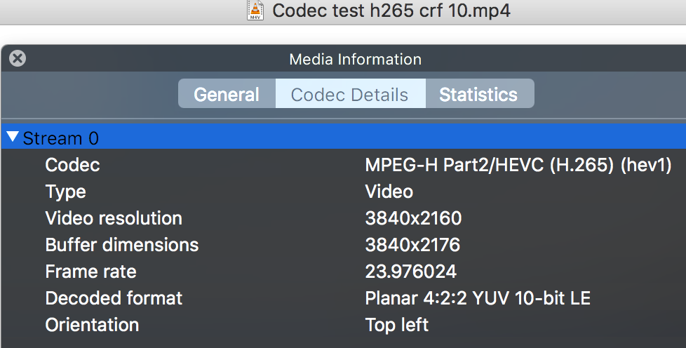

kye Posted August 15, 2020 Author Share Posted August 15, 2020 Does anyone know how to confirm that my h265 files are ALL-I? On the h264 files the ALL-I ones have this from ffprobe: "Stream #0:0(und): Video: h264 (High 4:2:2 Intra) (avc1 / 0x31637661), yuv422p10le, 3840x2160 [SAR 1:1 DAR 16:9], 745951 kb/s, 23.98 fps, 23.98 tbr, 24k tbn, 47.95 tbc (default)" and the h264 IPB have: "Stream #0:0(und): Video: h264 (High 4:2:2) (avc1 / 0x31637661), yuv422p10le, 3840x2160 [SAR 1:1 DAR 16:9], 860083 kb/s, 23.98 fps, 23.98 tbr, 24k tbn, 47.95 tbc (default)" but the h265 files I rendered with -intra as an argument have this: "Stream #0:0(und): Video: hevc (Rext) (hev1 / 0x31766568), yuv422p10le(tv, progressive), 3840x2160 [SAR 1:1 DAR 16:9], 350312 kb/s, 23.98 fps, 23.98 tbr, 24k tbn, 23.98 tbc (default) which seems to suggest they're progressive, but I definitely used the -intra flag. I even converted another one and changed the order of the arguments in case that was stuffing things up. Link to comment Share on other sites More sharing options...
