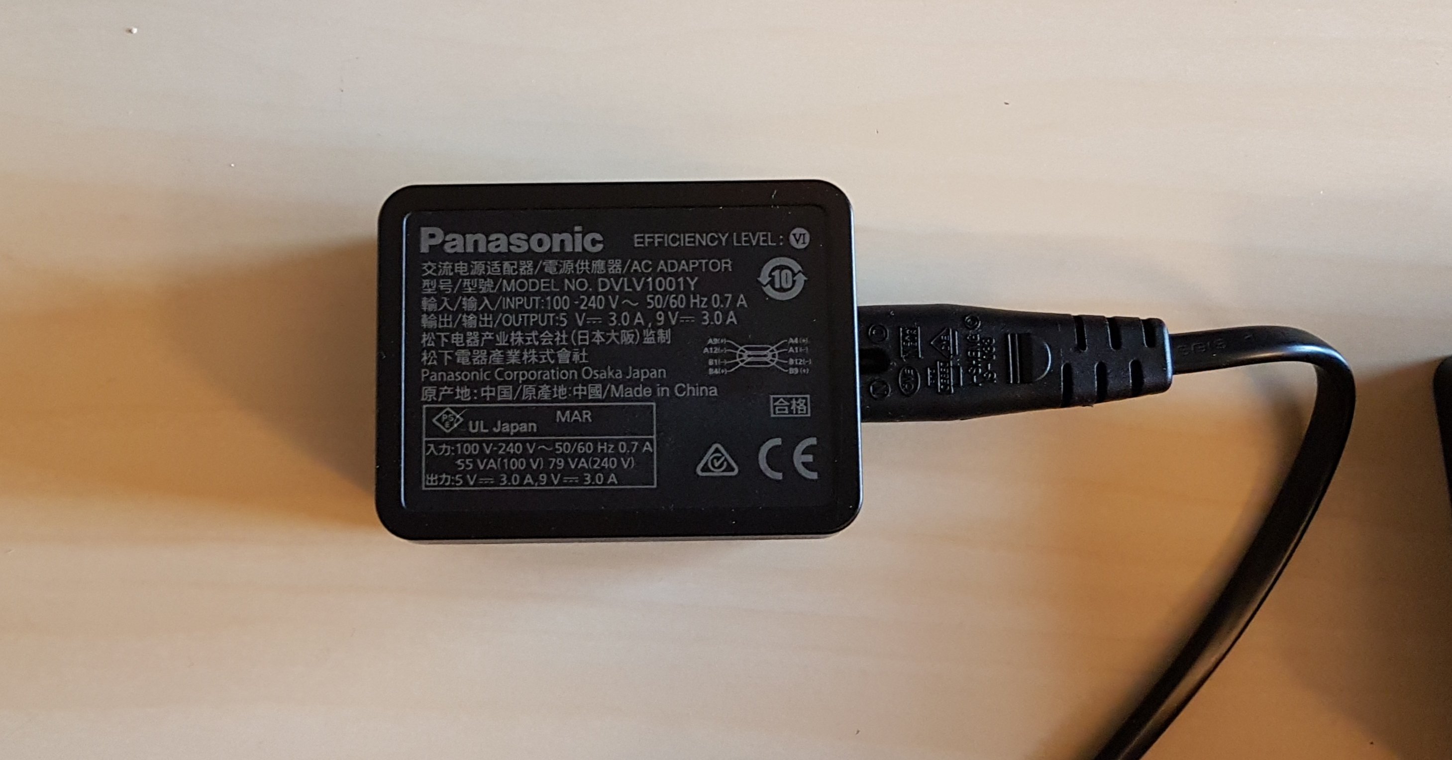

Geoff_L Posted June 3, 2020 Share Posted June 3, 2020 Ah, I forgot : I stopped using the supplied fast charger some weeks after having received my camera. Sure it charge very fast, but charger and batteries got very hot, and I believe the batteries will not last long with such a fast charge (I may be wrong). So I now use a regular wall charger, in which I plug the panasonic battery charger. I can't remember if I had battery problems since... Link to comment Share on other sites More sharing options...
Mark Romero 2 Posted June 3, 2020 Share Posted June 3, 2020 5 hours ago, Geoff_L said: Ah, I forgot : I stopped using the supplied fast charger some weeks after having received my camera. Sure it charge very fast, but charger and batteries got very hot, and I believe the batteries will not last long with such a fast charge (I may be wrong). So I now use a regular wall charger, in which I plug the panasonic battery charger. I can't remember if I had battery problems since... When you say that the supplied fast charger is causing you problems, which charger exactly is it? Is it the DMW-BTC14 charger??? (That is the charger that came with my S1) Link to comment Share on other sites More sharing options...
Administrators Andrew - EOSHD Posted June 3, 2020 Administrators Share Posted June 3, 2020 19 hours ago, PannySVHS said: Dear Andrew, thank you very much for your reply! 1. manual lens, Soligor/Unitor 35-70mm zoom in FD mount- just to name it for the lens lovers among us:), sofore it was in 2. manual focus 3. ambient temperature about 20 to 25 degree Celcius, indoors 4. short video clips of ten to 120 seconds mostly 4k 8bit 25p full frame, ten percent h265 mode with 75mbit in the mix, 50 percent photos 5. battery about six monthis in use, problem occured the last two times in the row now within the last ten or so days. To give my perpective on it, original batteries from Panasonic never failed me on my G6, G7 and GX85 cameras. I have been using these cameras in 30 degrees air, under direct sun. GH5 has served me in super hot conditions for a whole week when we had 40 degrees in Germany two years ago. So would it be possible that the S1 gives that lack of battery performance after a certain period of battery usage, after a few months, I am thinking. If this is not the case I would just buy another original battery and be very happy with my camera. Even moreso once I got the Vlog ugrade.:) OK, I think the best solution is to buy a new battery (at least temporarily and return it to Amazon if it doesn't fix the issue). This will illuminate the possibility that it's just a faulty battery. If it is proven that the problem happens with the new battery too, then we have a situation and I'll notify Panasonic. It may be that the cameras are very marginal in their peak current requirements, so any degradation with the battery as it ages causes an issue. This isn't good either and Panasonic should investigate like Leica are doing with the SL2. PannySVHS 1 Link to comment Share on other sites More sharing options...
Administrators Andrew - EOSHD Posted June 3, 2020 Administrators Share Posted June 3, 2020 5 hours ago, Geoff_L said: Ah, I forgot : I stopped using the supplied fast charger some weeks after having received my camera. Sure it charge very fast, but charger and batteries got very hot, and I believe the batteries will not last long with such a fast charge (I may be wrong). So I now use a regular wall charger, in which I plug the panasonic battery charger. I can't remember if I had battery problems since... This is also interesting. Thanks. Link to comment Share on other sites More sharing options...

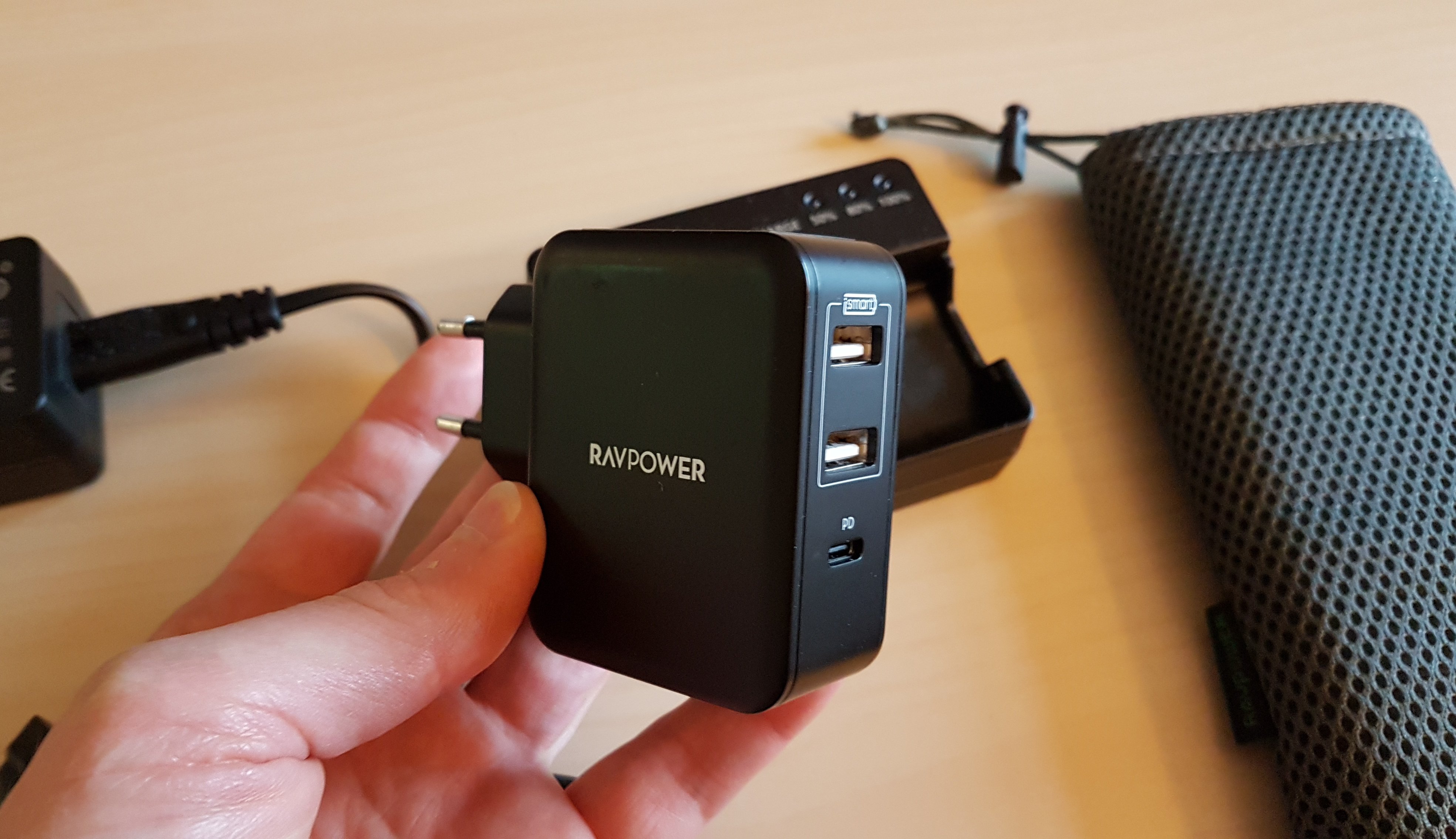

Geoff_L Posted June 3, 2020 Share Posted June 3, 2020 44 minutes ago, Mark Romero 2 said: When you say that the supplied fast charger is causing you problems, which charger exactly is it? Is it the DMW-BTC14 charger??? (That is the charger that came with my S1) No, sorry Mark, I replaced this supplied AC adaptator : By this ravpower ac adaptor: It has 2 ismart ports that I use for charging more slowly and (I hope) preserving the lasting of the batteries. It also has a PD port, in case I need to quickly charge as with the supplied AC adaptor. Very handy when travelling. I did this after having watch th comprehensive video from Panasonic about the charging options for the S1 series (and before a long hiking trip). I also brought this ravpower powerbank : Same story : 2 regular ismart ports, and a Type-c PD in case I need it. Fun facts : I recharged 2 or 3 times the batteries inside my tent, by sub zero temperatures and high humidity, with the powerbank. I had to put the charger in the camera bag or sleeping bag because the charger detect the humidity rate and do not start the charging if unhappy ! PannySVHS 1 Link to comment Share on other sites More sharing options...
