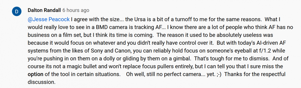

Emanuel Posted July 17, 2020 Share Posted July 17, 2020 Tease me up! https://www.youtube.com/watch?v=DdB_Gam-igg&lc=UgwKhekRV1OUO4XU1g94AaABAg.9BCNLNjbN0-9BCRvBZWuPO Link to comment Share on other sites More sharing options...
