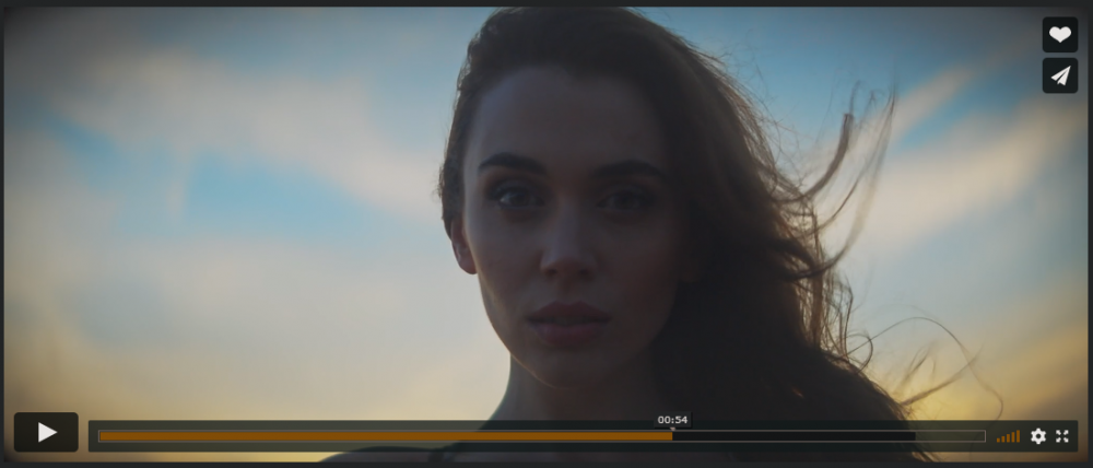

mercer 4,186 Posted November 26, 2019 Author Share Posted November 26, 2019 46 minutes ago, Julien416 said: Kowa 16 d and s are very fine lenses. But they won't cover a wide field of view. They will be perfect for a 75mm anamorphic in S35 coverage (100mm in FF) . Not less unfortunately. Good to know, thanks. Obviously, I am considering taking lenses as I do my research. I have a mint Nikon 100mm series e, do they make good taking lenses. Also, I found this video on Vimeo of the 16-D with the Canon 85mm 1.8... I love the look of this. Is this a typical look of the Kowa 16-D under similar circumstances? As far as taking lenses go... I already own the Nikon 100mm and a Canon 85mm 1.8. I also have a Nikkor 85mm 1.4 (although I was planning on selling it) and a Rollei Zeiss 85mm 2.8. As much as I am willing to build the optimal rig, if I already own a useable taking lens, then that's all the better. 1 hour ago, Julien416 said: An 85mm setup sounds like a good option for you. Rapido has a 85mm contax housing, just pair it with a cinelux with rapido housing and a FVD 16 and you're good to go. It's a pretty modern look, no dreamy veiling flares and no stupid distortions. Thanks for recommending the Rapido solution. I knew they made a focusing unit but didn't realize they make an entire line of products. Their full metal jackets are really cool. I do like the dreaminess of the 16-D and I also like the clean look from the Cinelux and Ultra Star. Hmm... decisions, decisions. Anyway, thanks for your help. I learned more this afternoon than I have the past few days trying to research this stuff on my own. Quote Link to post Share on other sites
heart0less 695 Posted November 26, 2019 Share Posted November 26, 2019 8 minutes ago, mercer said: I love the look of this. Is this a typical look of the Kowa 16-D under similar circumstances? Wow, this looks good! I'd say - yes, but the red flare caught me off guard. 16-D usually have blue flares - I guess the setting sun must've altered it. Also, some vignetting is already getting in the way: Here are some other 16D videos: UMP 4.6K , Takumar 55 mm, 16D, FVD-16A Setups described in the description: A very thorough test: mercer 1 Quote Link to post Share on other sites

mercer 4,186 Posted November 26, 2019 Author Share Posted November 26, 2019 26 minutes ago, heart0less said: Wow, this looks good! I'd say - yes, but the red flare caught me off guard. 16-D usually have blue flares - I guess the setting sun must've altered it. Also, some vignetting is already getting in the way: Yeah, I like the look of that a lot. As @Julien416 said, I suppose it would be a lot cleaner with a 100mm or longer lens... or maybe even with more static shots? Thanks for the videos, I have a lot more research to do, but think I may be on the right path with the either Kowa 16-D or a Blue Star/Cinelux set up. Either way, I really like the options from Rapido, so I have to crunch some numbers and see what will be the best option. Btw, is there much of a difference between the 16-D and the 16-S? Quote Link to post Share on other sites
