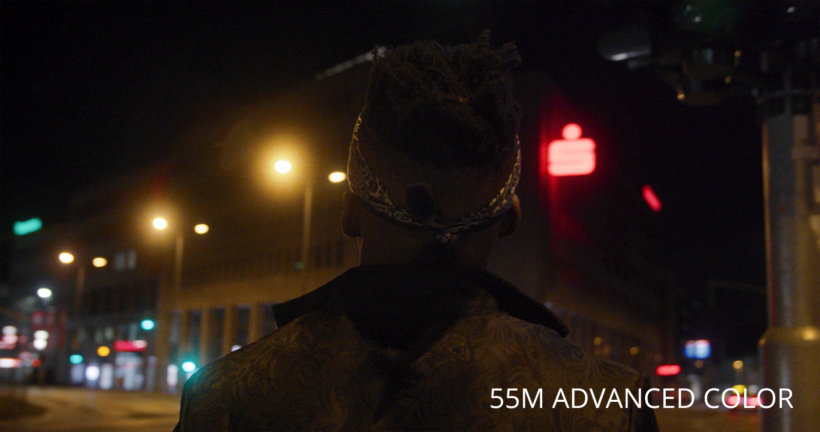

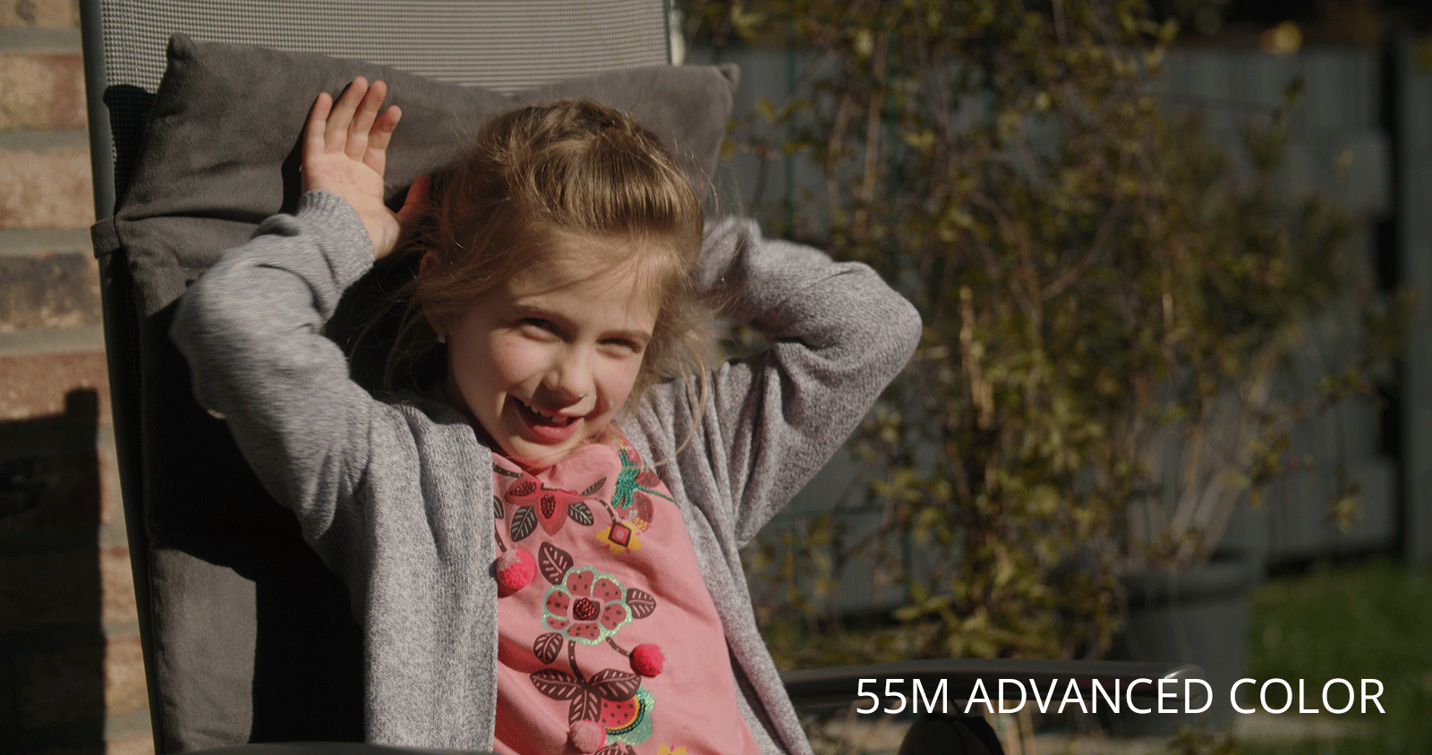

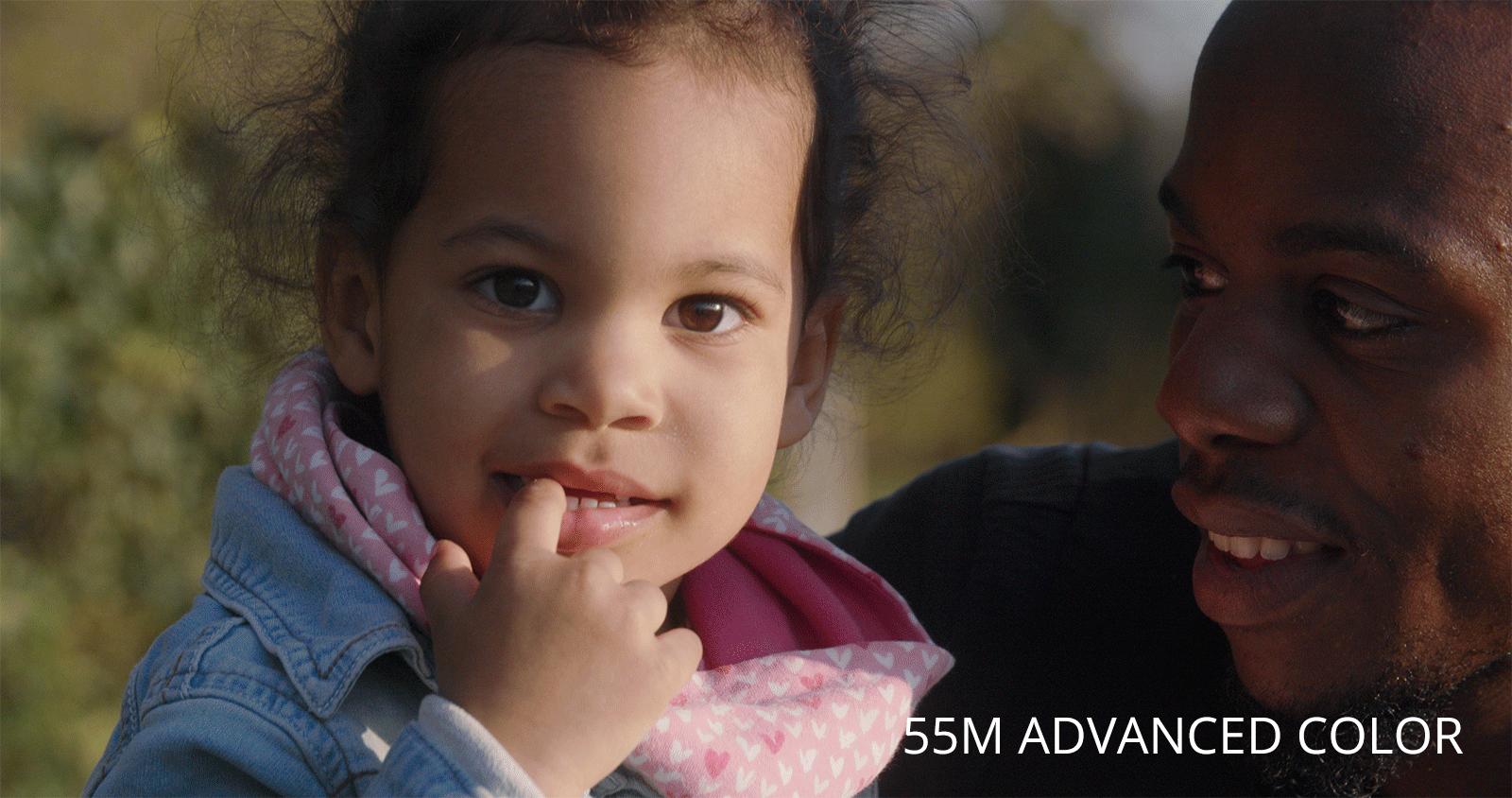

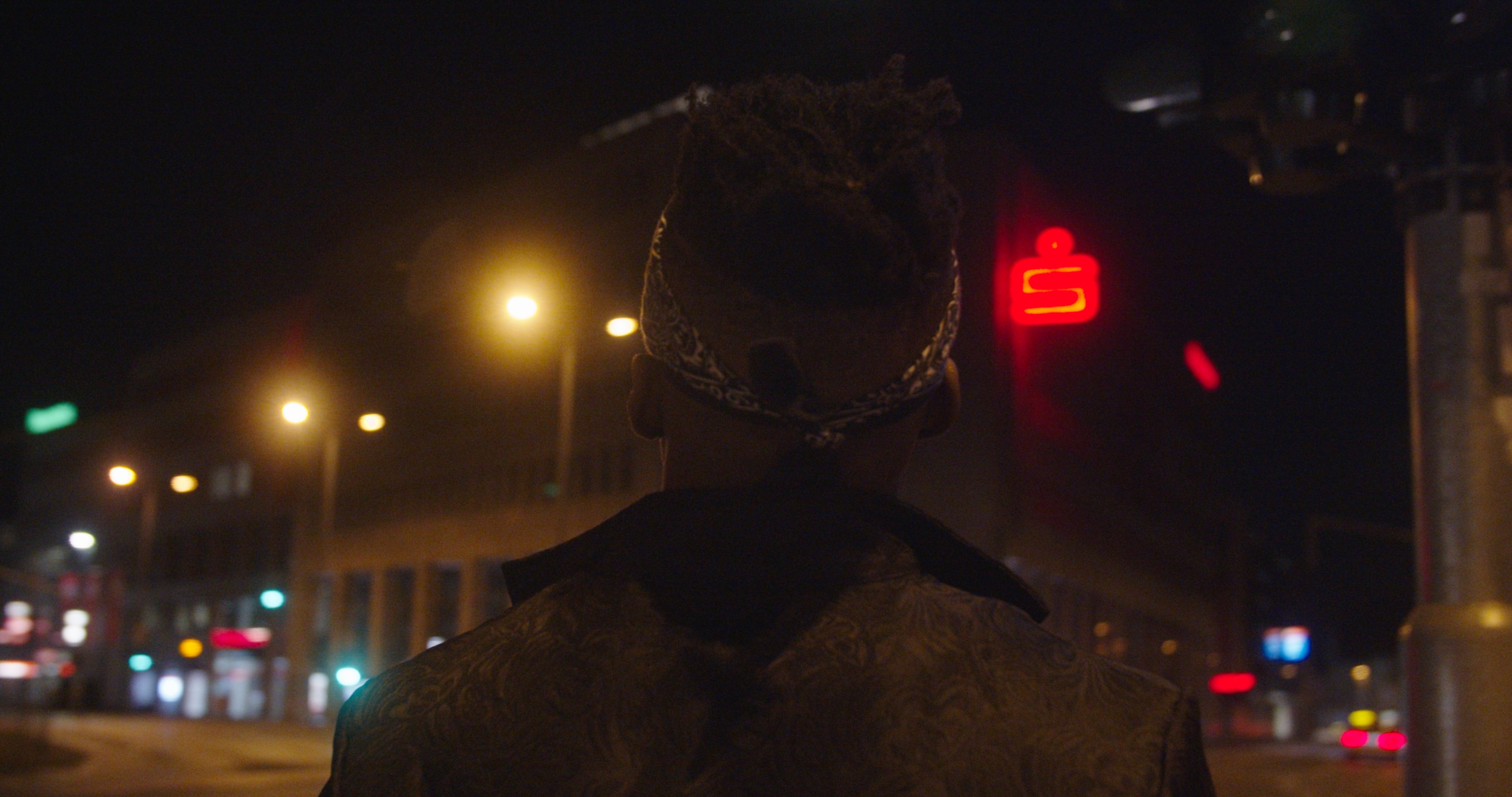

deezid Posted August 14, 2019 Share Posted August 14, 2019 Made to eliminate gamut clipping issues in the first place, but also eliminates the brown cast of BMD Film V4 for the BMPCC 4K and 6K (soon), provides a nicer roll-off for skin, red lights, tungsten, blue lights etc, fixes incorrect color and targets IPP2 Soft Rec709 conversion. A BMD FILM V4 to RedWideGamutRGB/RedLog3G10 conversion to work with inside a native IPP2 workflow is included as well. Pocket 6K version coming soon: More information: http://55media.net/55m-p4k-color/ funkyou86, heart0less and Emanuel 2 1 Link to comment Share on other sites More sharing options...

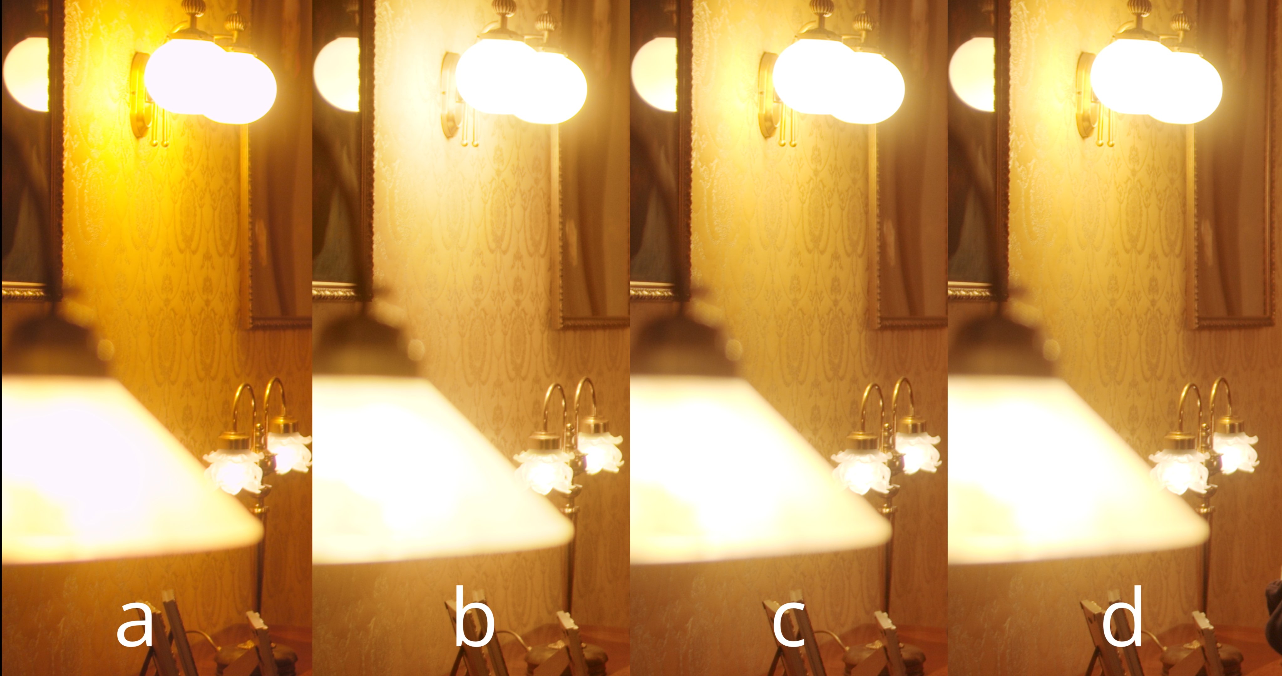

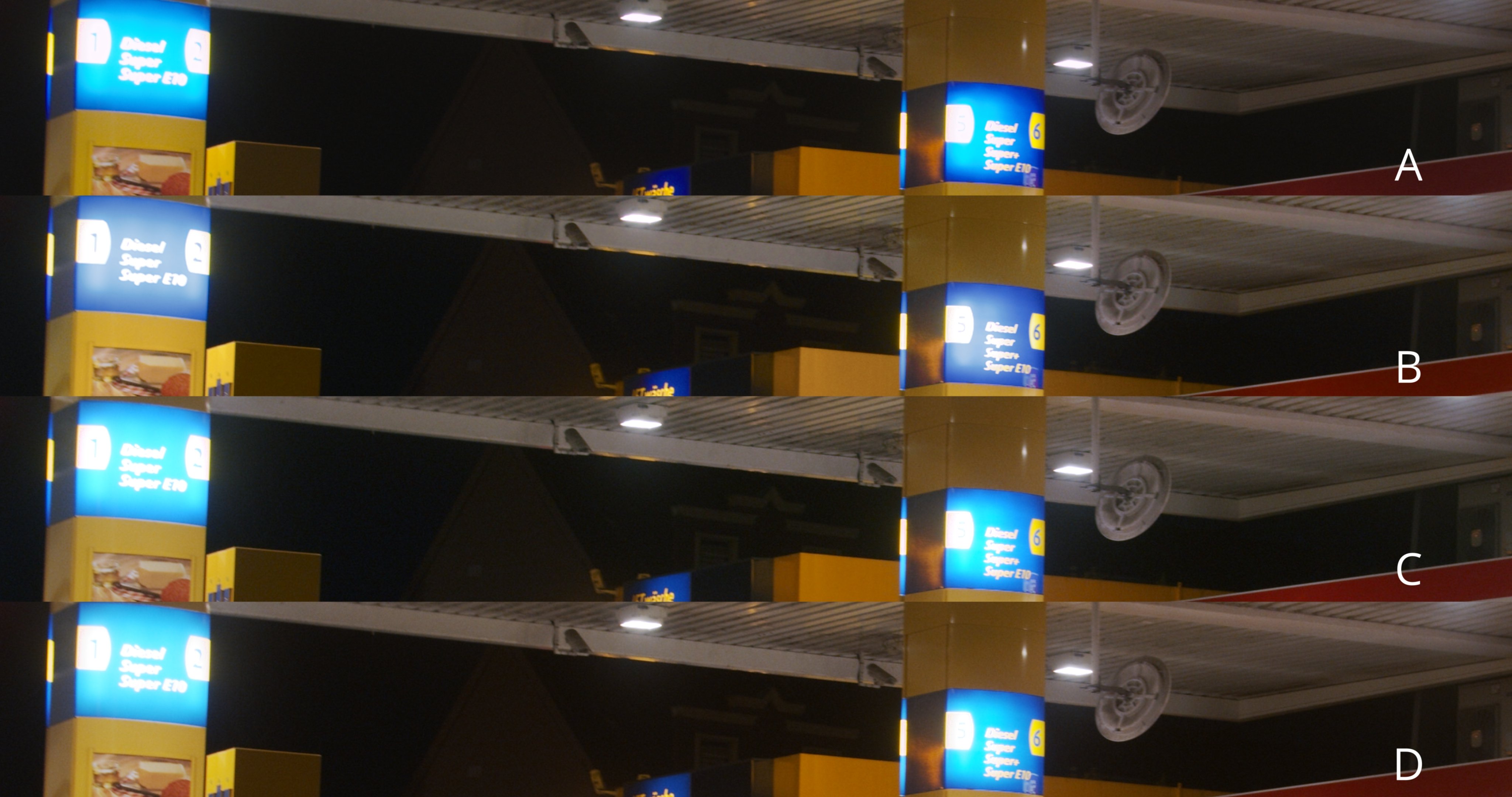

deezid Posted August 21, 2019 Author Share Posted August 21, 2019 Here's a highlight roll-off comparison between Buttery Natural V3 Lut, BMD Film V4 Extended Lut, The+One+Lut and 55M Advanced Lut - in no particular order. Which one do you think is which and what do you prefer? Link to comment Share on other sites More sharing options...
Emanuel Posted August 21, 2019 Share Posted August 21, 2019 B in the first series row, D of Dennis for the last one : -) Link to comment Share on other sites More sharing options...
deezid Posted August 21, 2019 Author Share Posted August 21, 2019 Just now, Emanuel said: B in the first series row, D of Dennis for the last one : -) The order never changes Also RED IPP2 was the target not standard Sony color and their roll-off ? Link to comment Share on other sites More sharing options...
Emanuel Posted August 21, 2019 Share Posted August 21, 2019 3 minutes ago, deezid said: The order never changes Eventually but results vary under different combos... Circumstances also play a role ; -) Link to comment Share on other sites More sharing options...
The ghost of squig Posted August 21, 2019 Share Posted August 21, 2019 D. B looks OK too. Link to comment Share on other sites More sharing options...
deezid Posted August 21, 2019 Author Share Posted August 21, 2019 Just now, Emanuel said: Eventually but results vary... ; -) ARRI and RED do roll-off their highlights properly though , that means desaturated, ARRI even more than RED Link to comment Share on other sites More sharing options...

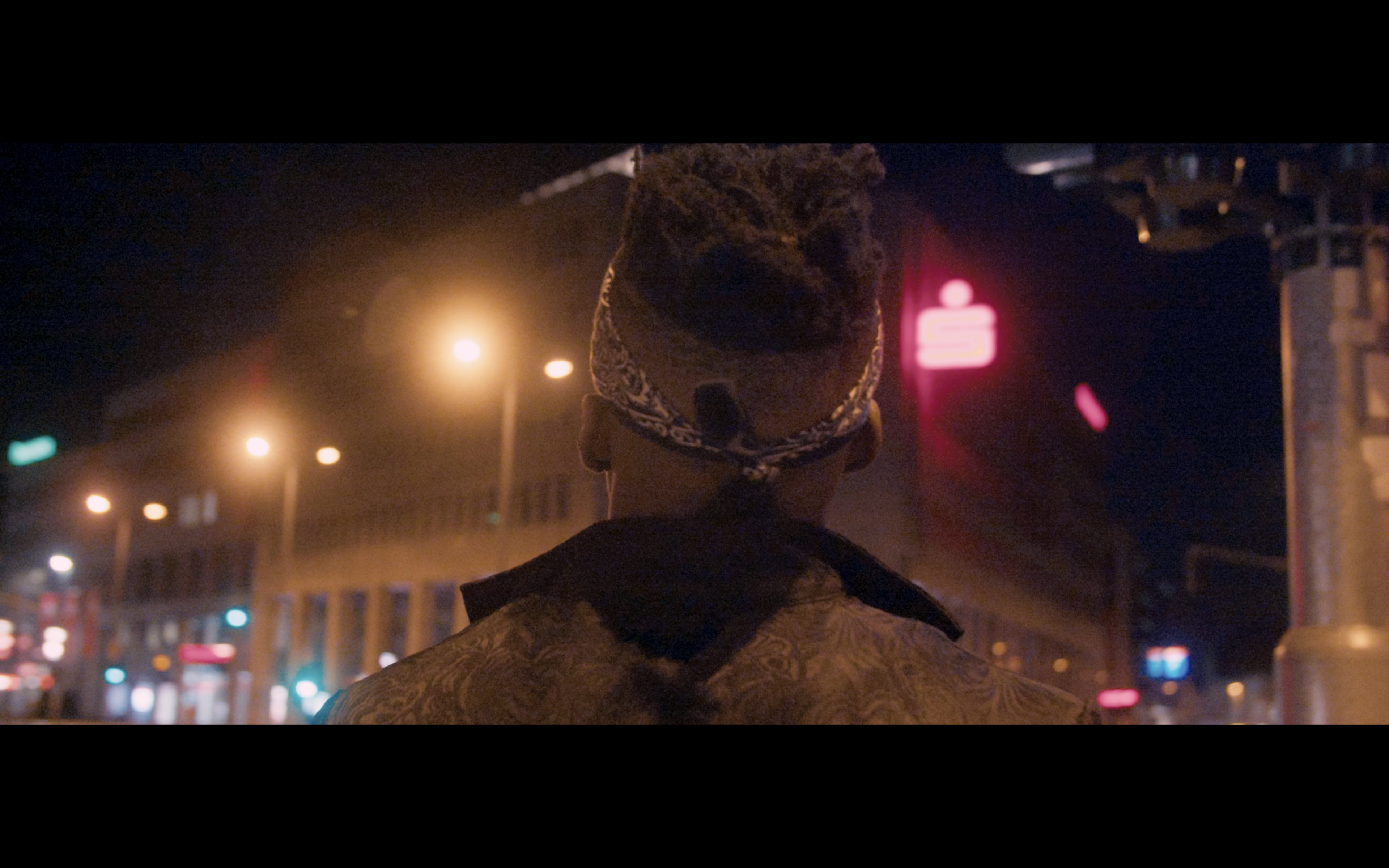

deezid Posted August 21, 2019 Author Share Posted August 21, 2019 1 hour ago, DanielVranic said: I do the CST in Resolve of Linear-LogC and that has given me the best highlight roll-off ever. Not a single LUT i have tried has gotten close. Well, I can debunk that claim. The Lut does a bit more than just a simple Color Space Transform to ARRI Log C to Rec709 Also color is way more accurate with it. BRAW Linear Gamma -> ARRI LOG C (CST) -> ARRI Rec709 (LUT) BRAW Linear Gamma -> ARRI LOG C (CST) Sat Mapping -> ARRI Rec709 (LUT) BRAW BMD FILM V4 -> 55M Advanced Lut Link to comment Share on other sites More sharing options...
The ghost of squig Posted August 21, 2019 Share Posted August 21, 2019 9 hours ago, The ghost of squig said: D. B looks OK too. Strike that, reverse it. The 55M Advanced Lut looks spot on. Are you using an IR filter in daylight? Link to comment Share on other sites More sharing options...

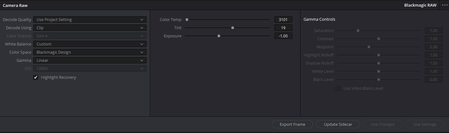

DanielVranic Posted August 22, 2019 Share Posted August 22, 2019 19 hours ago, deezid said: Well, I can debunk that claim. The Lut does a bit more than just a simple Color Space Transform to ARRI Log C to Rec709 Also color is way more accurate with it. BRAW Linear Gamma -> ARRI LOG C (CST) -> ARRI Rec709 (LUT) BRAW Linear Gamma -> ARRI LOG C (CST) Sat Mapping -> ARRI Rec709 (LUT) BRAW BMD FILM V4 -> 55M Advanced Lut Did you decode as Linear first? I find this benefits all camera and technical LUT's, so maybe send me 1-2 second raw file lets put it to the test. Can't debunk based on no evidence Link to comment Share on other sites More sharing options...
deezid Posted August 22, 2019 Author Share Posted August 22, 2019 2 hours ago, DanielVranic said: Did you decode as Linear first? I find this benefits all camera and technical LUT's, so maybe send me 1-2 second raw file lets put it to the test. Can't debunk based on no evidence Of course I did, here are the settings used. Attached is the Braw file A001_03192101_C073_320.braw Link to comment Share on other sites More sharing options...

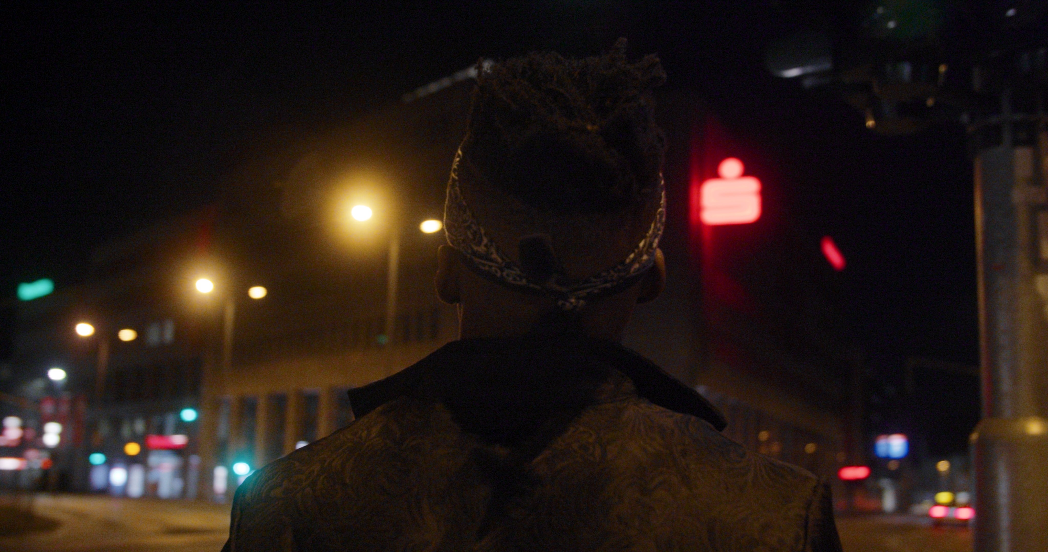

DanielVranic Posted August 22, 2019 Share Posted August 22, 2019 My Linear conversion looks different than yours..? mercer, heart0less and JordanWright 3 Link to comment Share on other sites More sharing options...
deezid Posted August 22, 2019 Author Share Posted August 22, 2019 So you went down with Saturation Max to a low level. Looks horrible honestly. The light on the right is a really colorful red not dull pink and the one on the right is bright orange/yellow. Link to comment Share on other sites More sharing options...
DanielVranic Posted August 22, 2019 Share Posted August 22, 2019 26 minutes ago, deezid said: So you went down with Saturation Max to a low level. Looks horrible honestly. The light on the right is a really colorful red not dull pink and the one on the right is bright orange/yellow. Hey man, no need to be rude about it. Nothing that can not be adjusted in a secondary, or even left if it serves the look. Either way, your LUT appears good. I will pick up when it is available. Link to comment Share on other sites More sharing options...
