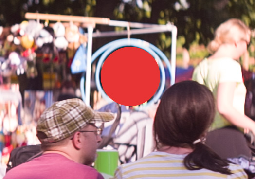

MatthewP Posted May 20, 2013 Share Posted May 20, 2013 Hey Andrew, I think the aspect ratio is off in your video (the first one). It looks stretched horizontally, but compressing it so that the video frame (excluding black bars) is 16:9 fixes the stretch. As you're shooting in 4:3, you will get 16:9 with an anamorphic lens (which was the original use for the Panasonic anamorphic lens - to make a 4:3 camera record in 16:9). Just thought I'd let you know. :) Stunning footage regardless! Here's what I mean: [URL=http://imageshack.us/photo/my-images/12/80767918.png/][/URL] [URL=http://imageshack.us/photo/my-images/809/65037090.png/][/URL] bluegreenturtle 1 Link to comment Share on other sites More sharing options...

MatthewP Posted May 20, 2013 Share Posted May 20, 2013 You only get 16:9 from 4:3 with a 1.33x anamorphic lens. The ones from the film days are 2x anamorphic. Iscorama is a 1.5x stretch. The video isn't off. You're right, it's wider than 16:9, but it isn't as wide as you think, and it's stretched. Funny how your brain compensates if you've been looking at it for a while, though (which is something I've noticed before). Here, look: Top is the original aspect ratio. Bottom has the video frame (including black bars) compressed to 3:2. Blue circle added for easy comparison to the hoops in the background. Speaks for itself. ;) You can't argue that the hoops are at an angle, because they would be taller vertically and they are not. So, the conclusion is that it's stretched ever so slightly, but enough to be the first thing I noticed when I started watching your vid. Shoot a perfect circle head on if you want to see it yourself. Just trying to help. bluegreenturtle 1 Link to comment Share on other sites More sharing options...
Miguel De Olaso Macgregor Posted May 20, 2013 Share Posted May 20, 2013 You're right, it's wider than 16:9, but it isn't as wide as you think, and it's stretched. Funny how your brain compensates if you've been looking at it for a while, though (which is something I've noticed before). Here, look: Top is the original aspect ratio. Bottom has the video frame (including black bars) compressed to 3:2. Blue circle added for easy comparison to the hoops in the background. Speaks for itself. ;) You can't argue that the hoops are at an angle, because they would be taller vertically and they are not. So, the conclusion is that it's stretched ever so slightly, but enough to be the first thing I noticed when I started watching your vid. Shoot a perfect circle head on if you want to see it yourself. Just trying to help. Hey Andrew, I think the aspect ratio is off in your video (the first one). It looks stretched horizontally, but compressing it so that the video frame (excluding black bars) is 16:9 fixes the stretch. As you're shooting in 4:3, you will get 16:9 with an anamorphic lens (which was the original use for the Panasonic anamorphic lens - to make a 4:3 camera record in 16:9). Just thought I'd let you know. :) Stunning footage regardless! Here's what I mean: Probably due to the fact that while Iscoramas are rated as x1.5 anamorphic lenses, they're closer to x1.41 compression ratio if you measure them with a perfect circle. At least that's my experience with the ones I've had. Link to comment Share on other sites More sharing options...

Administrators Andrew - EOSHD Posted May 20, 2013 Author Administrators Share Posted May 20, 2013 Probably due to the fact that while Iscoramas are rated as x1.5 anamorphic lenses, they're closer to x1.41 compression ratio if you measure them with a perfect circle. At least that's my experience with the ones I've had. I think 2580 x 1280 looks about on the money, which makes sense as 1720 x 1.5 = 2580! I got 3000 x 1280 by assuming the Iscorama would give me 2.39:1 from 4:3. Seems it does not. Will have a further look into this and likely re-upload the video tomorrow. Cheers guys. Link to comment Share on other sites More sharing options...
