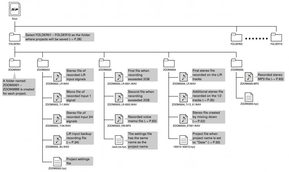

With regard to the file structure, its like this, so each project has a folder and within it the separate files for the recording are denoted LR for stereo recording of the L/R input, Tr1 would be a mono track of Input 1, Tr34 would be a stereo recording of  Input 3 and 4 etc..:

Thanks @BTM_Pix That's kind of what I thought about the file structure. That's perfect.
569365882_ScreenShot2018-06-07at11_47_43.thumb.jpg.8b80eccc32641e94d4fc9cba1537d05d.jpg
That is what nightmares are made out of, compared to the ease and depth of control you get with the Zoom F4/F8/F8n (or really any semi-pro/pro field recorder out there).

What don't you like about that file structure? I'd have thought separate tracks for each input is ideal.
Separate tracks? Yes.
Separate files? No.
Even worse, you have almost no control over the naming structure. And no other control over metadata either.

To me the folder structure is 1 file per channel. In the example they've given in the folder ZOOM0002 I'm looking at it like this:
Stereo track from an XY capsule - room sound
Track 1 is mono - vocals
Tracks 3 and 4 as stereo - 2 mics on 1 guitar
So basically, each file is 1 instrument in this example... that's ideal.
The question is, can you choose for tracks 1, 2, 3, 4, 5, 6 to all be their own mono track, or will 3 and 4 forever be linked as stereo? (I assume you can chose, would be strange if you can't)
I think the capsules will always record to L/R stereo tracks, and then the 4 that are built in can be their own mono tracks.
I'd rather use BWAV and have a single file per take (which you have the option of choosing instead with the F4/F8/F8n). And creating an entire new folder for each take seems a bit ugly indeed.
Plus the H6 has absolutely none of the degrees of customization  the F series has for naming files/tracks/notes/etc, which is very powerful for projects and especially for long running ones.
