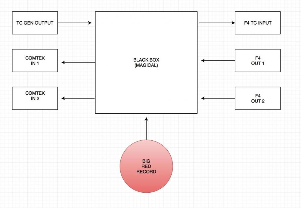

IronFilm 4,204 Posted June 4, 2018 Author Share Posted June 4, 2018 You'd certainly find buyers at that price point, but only a very very very small pool. A more interesting project to think about would be an "auto mute" device for outputs from a recorder. Many more people would be keen on that! Quote Link to post Share on other sites
Super Members BTM_Pix 5,721 Posted June 4, 2018 Super Members Share Posted June 4, 2018 Can you walk me through specifically how you would want that to work because I've a feeling that it could be incorporated into the same box. Quote Link to post Share on other sites
IronFilm 4,204 Posted June 4, 2018 Author Share Posted June 4, 2018 Well first you'd feed into this magic black box as inputs the the outputs from the recorder (at least two inputs would be a reasonable minimum to support). Then from here there are a few approaches as to how to accomplish the goal of starting/stopping recording, the simplest approach by far (but needing an external timecode generator) would be to simply pass through an external timecode generator to the recorder's TC input. Thus when the big red record button on the magic black box is hit this would pass the TC to the recorder (automatically starting it, if it is set to Ext TC) and also in the process open up the audio outputs flowing out (to say the comteks for instance). Easy. Quote Link to post Share on other sites
Super Members BTM_Pix 5,721 Posted June 4, 2018 Super Members Share Posted June 4, 2018 So, like this then ? IronFilm 1 Quote Link to post Share on other sites
IronFilm 4,204 Posted June 4, 2018 Author Share Posted June 4, 2018 Yes! Although could work with many more than just the F4. And all the "magic" that needs to be done is to open up both together, and close both together. Easy. And package it up in a nice little box which is robust, and looks well and works well. I should probably give this a test go myself. Would be a nice addition. (why on earth this hasn't been made already I have no idea, an aversion to external TC?!) Quote Link to post Share on other sites

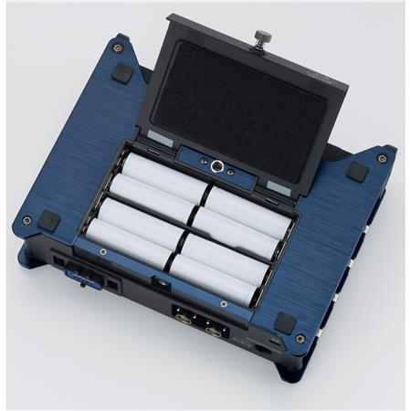

IronFilm 4,204 Posted June 4, 2018 Author Share Posted June 4, 2018 It seems to me like this battery compartment design is worse than before? As this is completely impractical to swap batteries in and out when you've got the recorder in your bag. At least when the battery pack is on the bottom, then most bags have easy access to that. Also by using a battery tray, it is super fast to swap in and out batteries! (if you carry around a spare full battery tray, like I do as a back up) Quote Link to post Share on other sites
