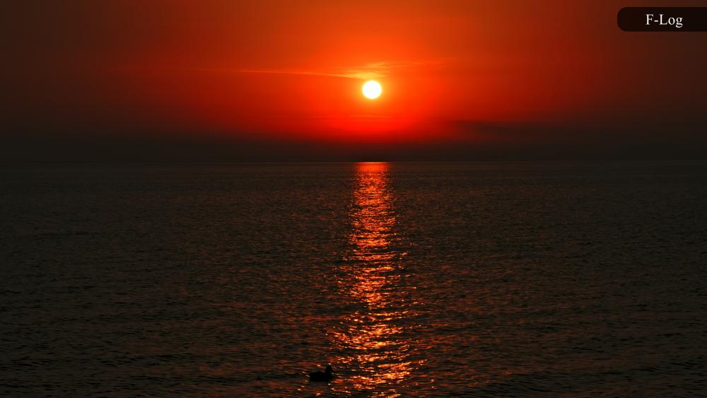

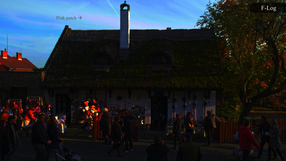

11 hours ago, Attila Bakos said:
I would use masks/keys and Resolve's deband filter for this kind of stuff.
Just one frame: before | after
I did not finetune the key so there is some detail loss here and there, I also modified the sky's color a bit. This is way faster than grain + denoiser.
Awesome results!
I tried your workflow deband workflow + NR + dither, and the results are very nice even with this low bitrate footage
