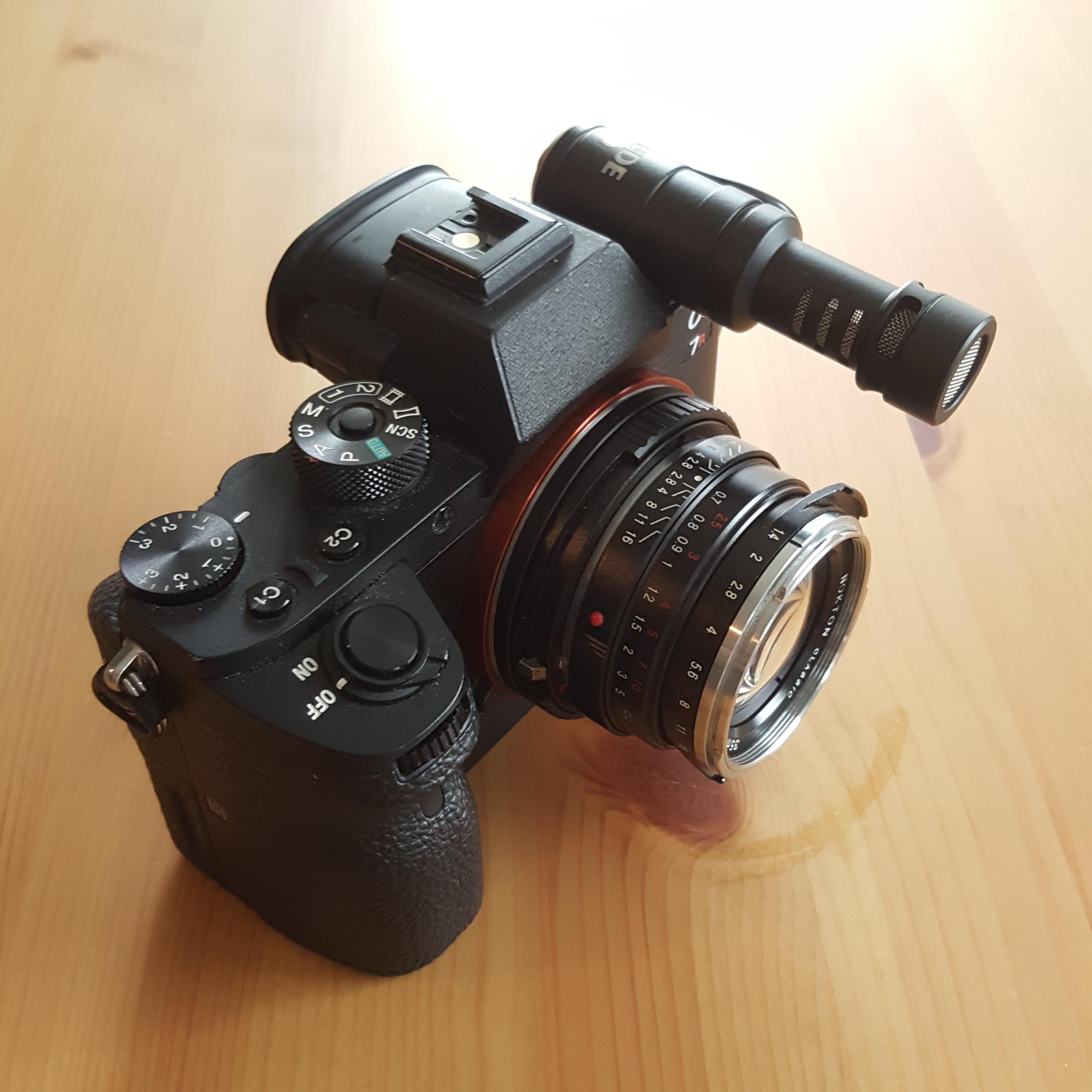

maxotics Posted November 26, 2017 Share Posted November 26, 2017 AFAIK, the biggest difference is the Videomicro isn't powered and doesn't work with the Canon C100 btw. However, I use it on every other camera and it's quite the nifty mic. Mark Romero 2 1 Quote Link to comment Share on other sites More sharing options...
Mark Romero 2 Posted November 26, 2017 Share Posted November 26, 2017 6 hours ago, Kisaha said: Wow! I can see 2 NX1 cameras there, I thought they had vanished from this dimension (the Trump one, where the world goes to hell!) My favorite is the Micro, it is the only Rode mic I ever owned! All the rest, I would rather use something else. It looks good (at US $59 ) and sounds good, but is there any other not-so-obvious reason you like the video micro??? Quote Link to comment Share on other sites More sharing options...
Kisaha Posted November 26, 2017 Share Posted November 26, 2017 @Mark Romero 2 Do not get me wrong, Rode has very good and competitive products, but in most cases they are a notch under what I would like, and usually I found it in Sennheiser products. I have and own other brands too, but in certain market gaps that Sennheiser doesn't have a product, or they are more expensive that I would like, or have the budget for. A great mic is the NTG3, I used it a lot for a few documentary series (because most of the production companies over here own a couple of those), but every time I was going back to my 416, I knew which one was better (at least for me, the NTG3 is a more forgiving microphone). My impression right now, is that the best, cheap, mic(s) for dSLR and mirrorless, right now, is the Sennheiser MKH440, it does more sense in 95% of the uses it is intended to. When I want the absolute cheapest, smallest, lightest, with not a lot of drain in battery, then I go to the micro. It is just brilliant that they built something like this. A) Micro B) 440 C) independent sound recording with pro mics and recorders, those are my user cases. As Max said, it doesn't get in your way. You can see through your EVF, it doesn't really add to the weight, it ain't so "phallic" and aggressive as others, and it is dead cheap! You can find it for even less, including the fur, and the Rycote Lyre system. EDIT: also it has the best design among all this Rode video mic series, and it doesn't need to turn it on/off, I have seen myriad times other Rode video mics to be off, when they should be on, and off, when they should be off! The rest of them are notoriously badly ergonomically built. Especially before the Rode adopted the Rycote Lyre system, they were a disaster to work with. Very bad battery placement, the rubber bands were silly and very bad implemented. I do not agree with some of Max's opinions though, the micro AIN'T that good acoustically and musically, if you like, most of the other microphones were a good bit better than that, the price difference isn't unsubstantial but for all the aforementioned, and the price, it is the best. IronFilm, maxotics, thehebrewhammer and 1 other 3 1 Quote Link to comment Share on other sites More sharing options...
Mark Romero 2 Posted November 27, 2017 Share Posted November 27, 2017 1 hour ago, Kisaha said: @Mark Romero 2 Do not get me wrong, Rode has very good and competitive products, but in most cases they are a notch under what I would like, and usually I found it in Sennheiser products. I have and own other brands too, but in certain market gaps that Sennheiser doesn't have a product, or they are more expensive that I would like, or have the budget for. A great mic is the NTG3, I used it a lot for a few documentary series (because most of the production companies over here own a couple of those), but every time I was going back to my 416, I knew which one was better (at least for me, the NTG3 is a more forgiving microphone). My impression right now, is that the best, cheap, mic(s) for dSLR and mirrorless, right now, is the Sennheiser MKH440, it does more sense in 95% of the uses it is intended to. When I want the absolute cheapest, smallest, lightest, with not a lot of drain in battery, then I go to the micro. It is just brilliant that they built something like this. A) Micro B) 440 C) independent sound recording with pro mics and recorders, those are my user cases. As Max said, it doesn't get in your way. You can see through your EVF, it doesn't really add to the weight, it ain't so "phallic" and aggressive as others, and it is dead cheap! You can find it for even less, including the fur, and the Rycote Lyre system. EDIT: also it has the best design among all this Rode video mic series, and it doesn't need to turn it on/off, I have seen myriad times other Rode video mics to be off, when they should be on, and off, when they should be off! The rest of them are notoriously badly ergonomically built. Especially before the Rode adopted the Rycote Lyre system, they were a disaster to work with. Very bad battery placement, the rubber bands were silly and very bad implemented. I do not agree with some of Max's opinions though, the micro AIN'T that good acoustically and musically, if you like, most of the other microphones were a good bit better than that, the price difference isn't unsubstantial but for all the aforementioned, and the price, it is the best. Thanks for the insight!!! Kisaha 1 Quote Link to comment Share on other sites More sharing options...
maxotics Posted November 27, 2017 Share Posted November 27, 2017 16 hours ago, Kisaha said: do not agree with some of Max's opinions though, the micro AIN'T that good acoustically and musically, if you like, most of the other microphones were a good bit better than that, the price difference isn't unsubstantial but for all the aforementioned, and the price, it is the best. Agree. It's not a "real" mic. What I meant about nifty is that it allows you some directionality and ability to move the mic away from the camera and put on a dead-cat essentially. It may stink, but for the size it's good Sorry, when I said I use it on any other camera I didn't mean it's a mic I use for anything important. Whereas the other mics aren't that much better even though they're large. They're hobby mics. I agree with your other points. The Rhodes were interesting when they came out. But that Takstar, and similar knockoffs, are good enough that it's not really worth it pay more than $50 for an unbalanced mic. In the balanced realm, a whole different ballgame. Quote Link to comment Share on other sites More sharing options...
