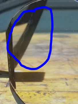

Dr. Verbel' Posted October 23, 2016 Author Share Posted October 23, 2016 My congratulations! You finally did it! Waiting for your version of reworked ana 35NAP 2-3 p.s. What is it? Maybe what I say earlier Quote Caution! WD-40 may ingrained between the cemented lenses... on the pic died lens from another Rectimascop 80/2x. It is not a pity, because she was so dead from fungus. But the possibility may be after WD-40. Maybe yes, maybe no... It is not a big problem, because center of working area is clear on look. 52 minutes ago, Justin Bacle said: Finally got the rear element ! Just needed a lot of wd-40, a screwdriver, and a BIG HAMMER ! #YOLO #HammersFixEverything Link to comment Share on other sites More sharing options...
Justin Bacle Posted October 24, 2016 Share Posted October 24, 2016 10 hours ago, Dr. Verbel' said: My congratulations! You finally did it! Waiting for your version of reworked ana 35NAP 2-3 p.s. What is it? Maybe what I say earlier It is not a big problem, because center of working area is clear on look. Oh, I think it is just one of my cat's hair. I'll check when I get back home Link to comment Share on other sites More sharing options...

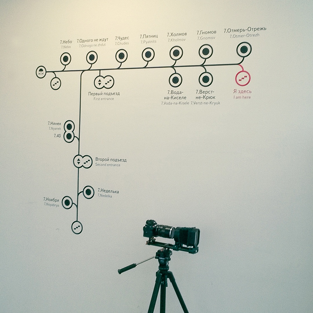

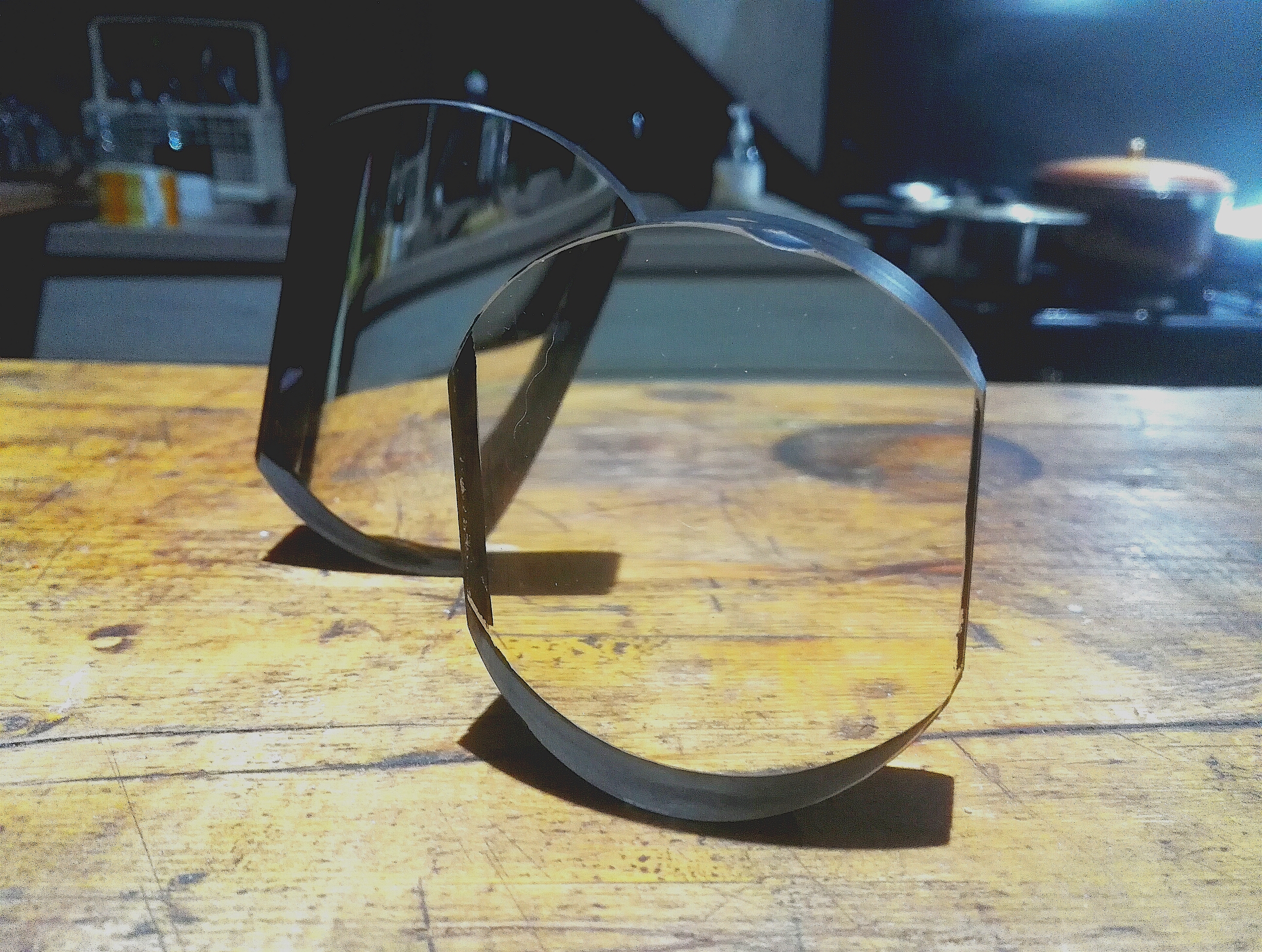

Dr. Verbel' Posted November 21, 2016 Author Share Posted November 21, 2016 I start to think about the housing for my verbascope with single focus Flynn, Justin Bacle and Juank 3 Link to comment Share on other sites More sharing options...
nicknabors Posted November 21, 2016 Share Posted November 21, 2016 What are these 2 circular lenses and how will they be used with your verbascope to enhance the focus? Link to comment Share on other sites More sharing options...
Dr. Verbel' Posted November 21, 2016 Author Share Posted November 21, 2016 Please read this thread, I wrote earlier. scheme on pic 2 hours ago, nicknabors said: What are these 2 circular lenses and how will they be used with your verbascope to enhance the focus? Justin Bacle 1 Link to comment Share on other sites More sharing options...

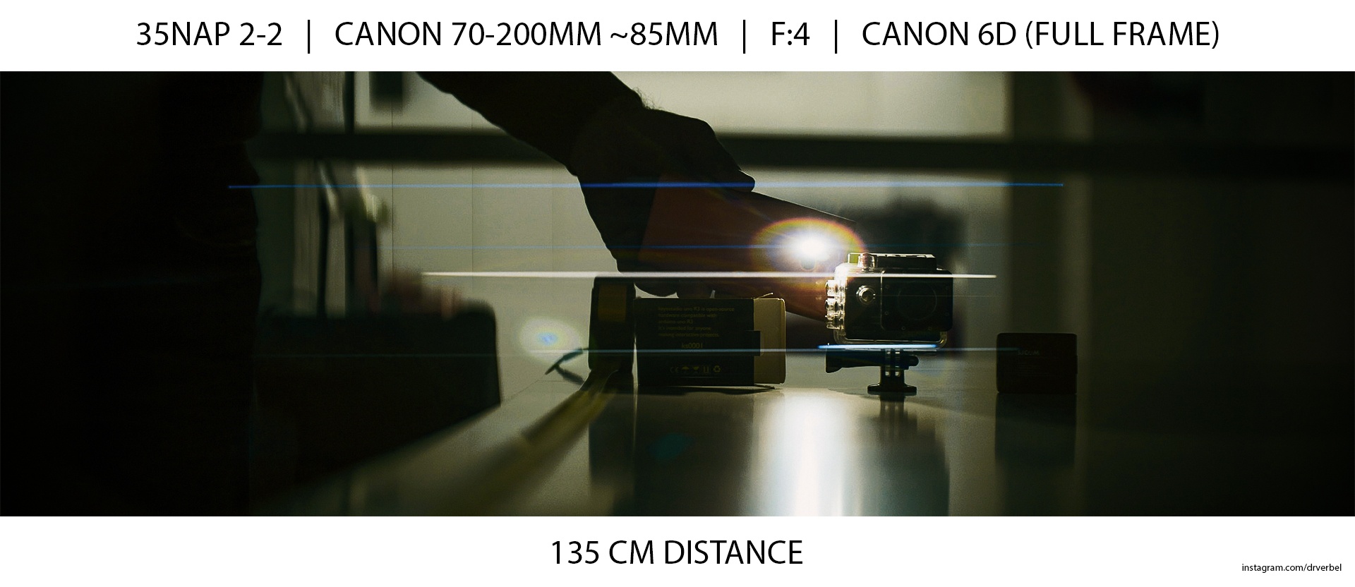

Dr. Verbel' Posted December 22, 2016 Author Share Posted December 22, 2016 Sharpness test of 35NAP 2-2, similar to 2-3, 2-3M, 2-4. low light / original / ana Juank and funkyou86 2 Link to comment Share on other sites More sharing options...
