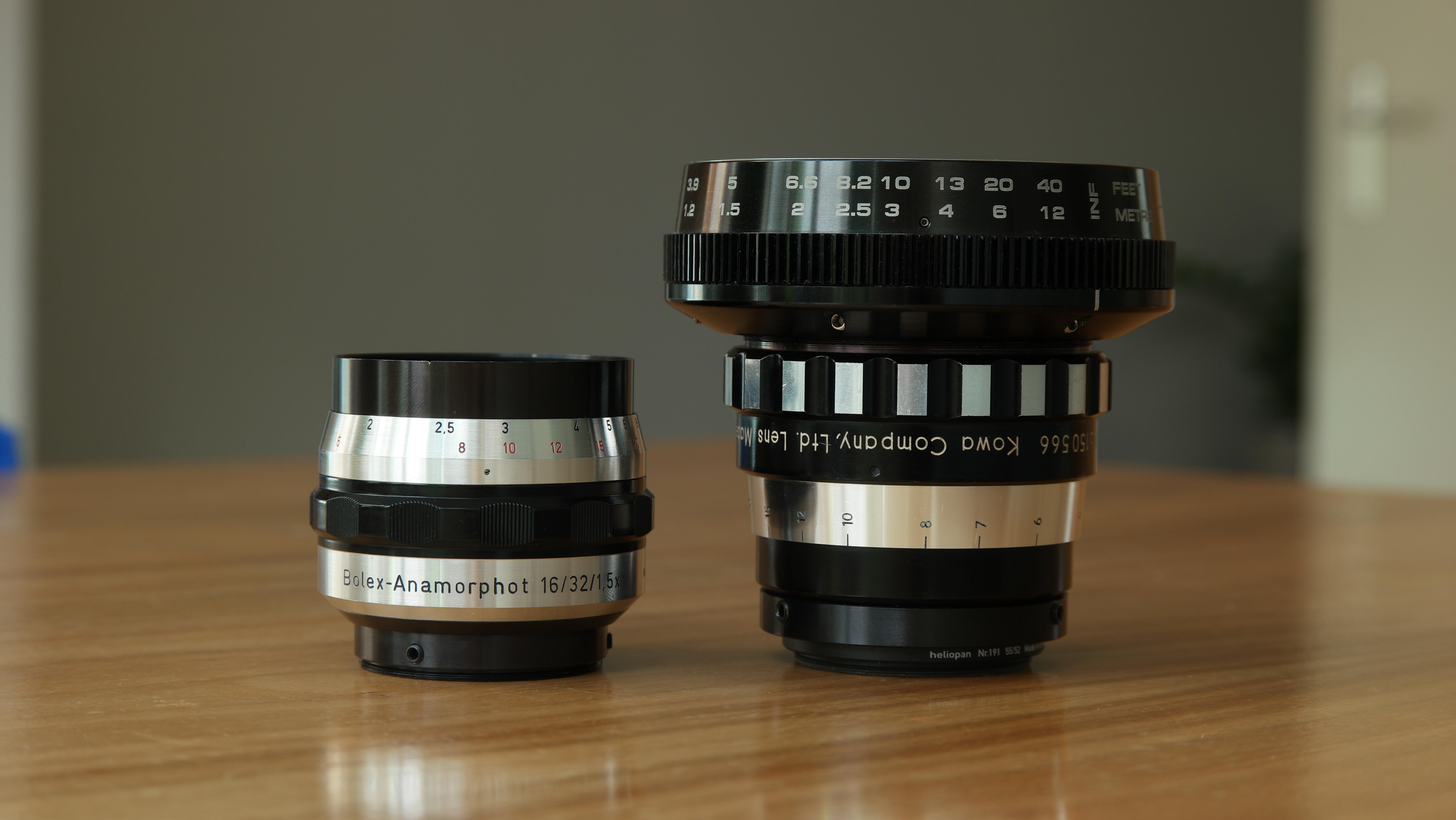

keessie65 Posted June 5, 2017 Share Posted June 5, 2017 To everybody I can say, if you have a Bolex, keep him, don't sell him. It's a great lens. I owned one and sold him. Now I have a Kowa c35, also a great lens but as second lens I am looking for a Bolex 16/32/1.5x again. So if you want to sell your Bolex, let me know. Thanks! SigurdW 1 Link to comment Share on other sites More sharing options...

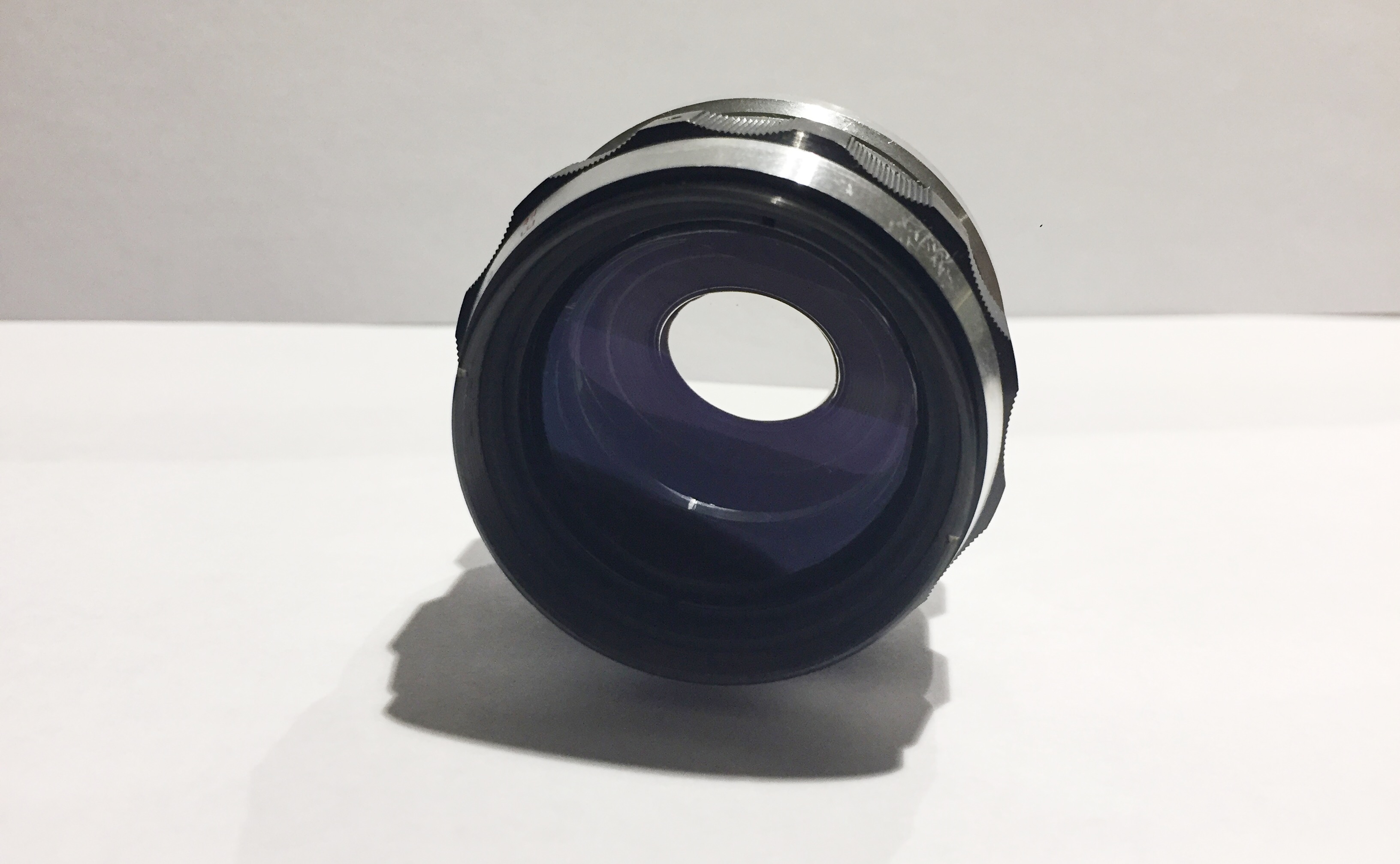

keessie65 Posted June 23, 2017 Share Posted June 23, 2017 Back to the Bolex family again! I few weeks ago I just send only 5 emails to Bolex shops all over the world and there was one guy in Ellijay (US) that has one in stock, not mentioned for sale... till I mailed. Today I received this little lens and it is in almost NEW quality. Now I have two 1.5x lenses, but I think the Bolex will be standard mounted on my NX1. Dick Sweeney, Ian Edward Weir, SigurdW and 2 others 5 Link to comment Share on other sites More sharing options...

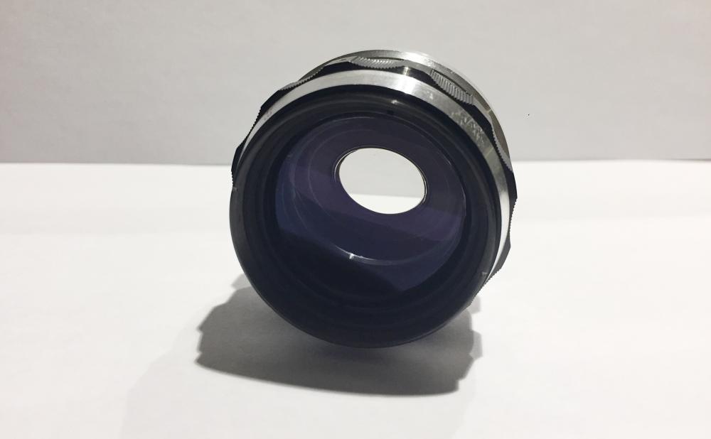

fws Posted July 9, 2017 Share Posted July 9, 2017 Hey guys, I have a Bolex Anamorphot 8/19/1.5x in that I'm selling. It's served me well, but I'm not using it enough anymore to justify it just sitting around. Listing on eBay should go up tomorrow evening (California time). If anyone is interested in this great little lens, let me know! keessie65 1 Link to comment Share on other sites More sharing options...
fws Posted July 10, 2017 Share Posted July 10, 2017 Link for my eBay auction on a Bolex Anamorphot 8/19/1.5x! Hope someone wants to take it over for me - it's been a lot of fun shooting with it http://www.ebay.com/itm/Rare-Bolex-Moller-8-19-1-5x-Anamorphot-Anamorphic-Lens-/122588936753?hash=item1c8adeba31:g:iWQAAOSw1JhZYdf1 Link to comment Share on other sites More sharing options...
