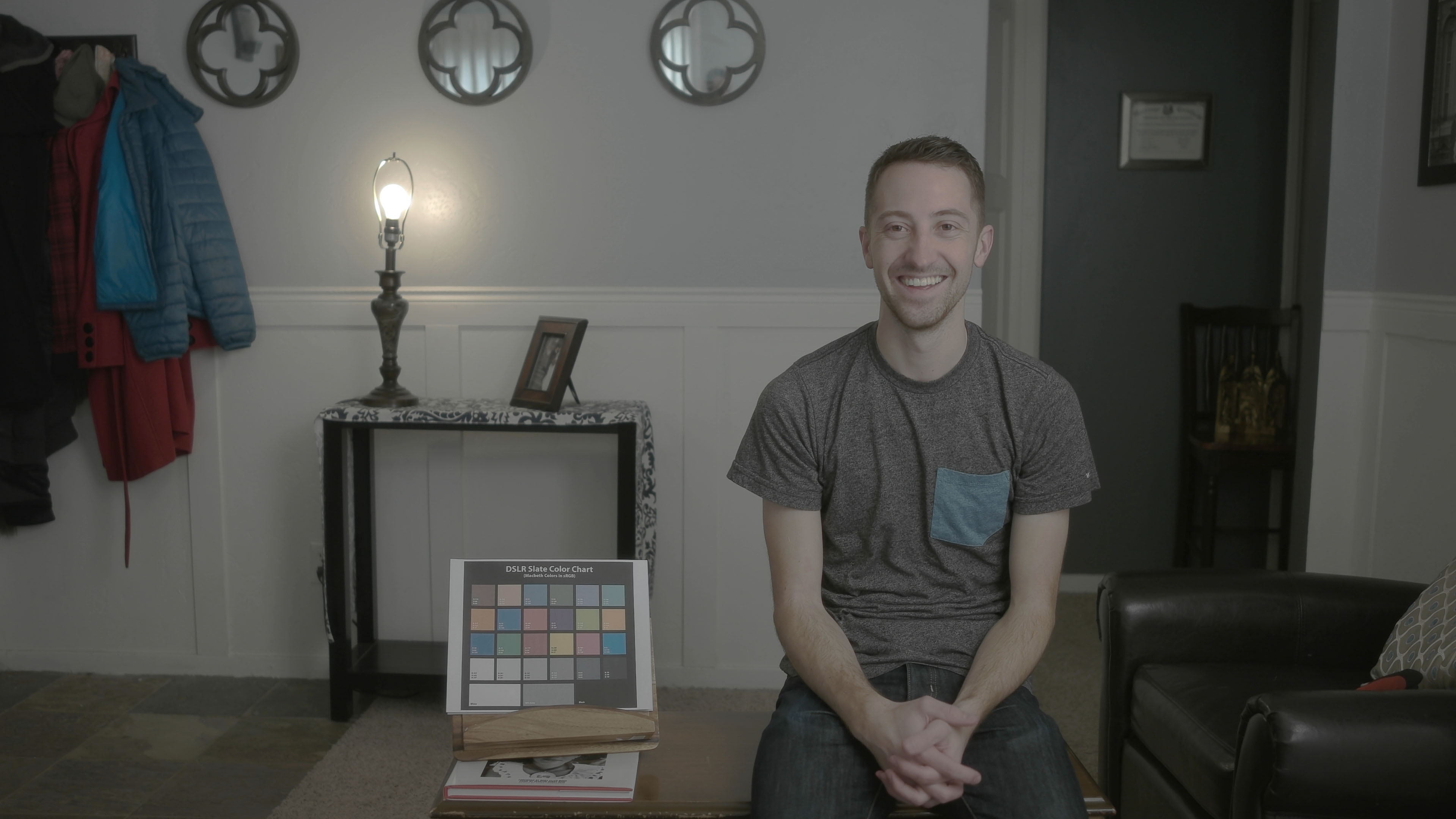

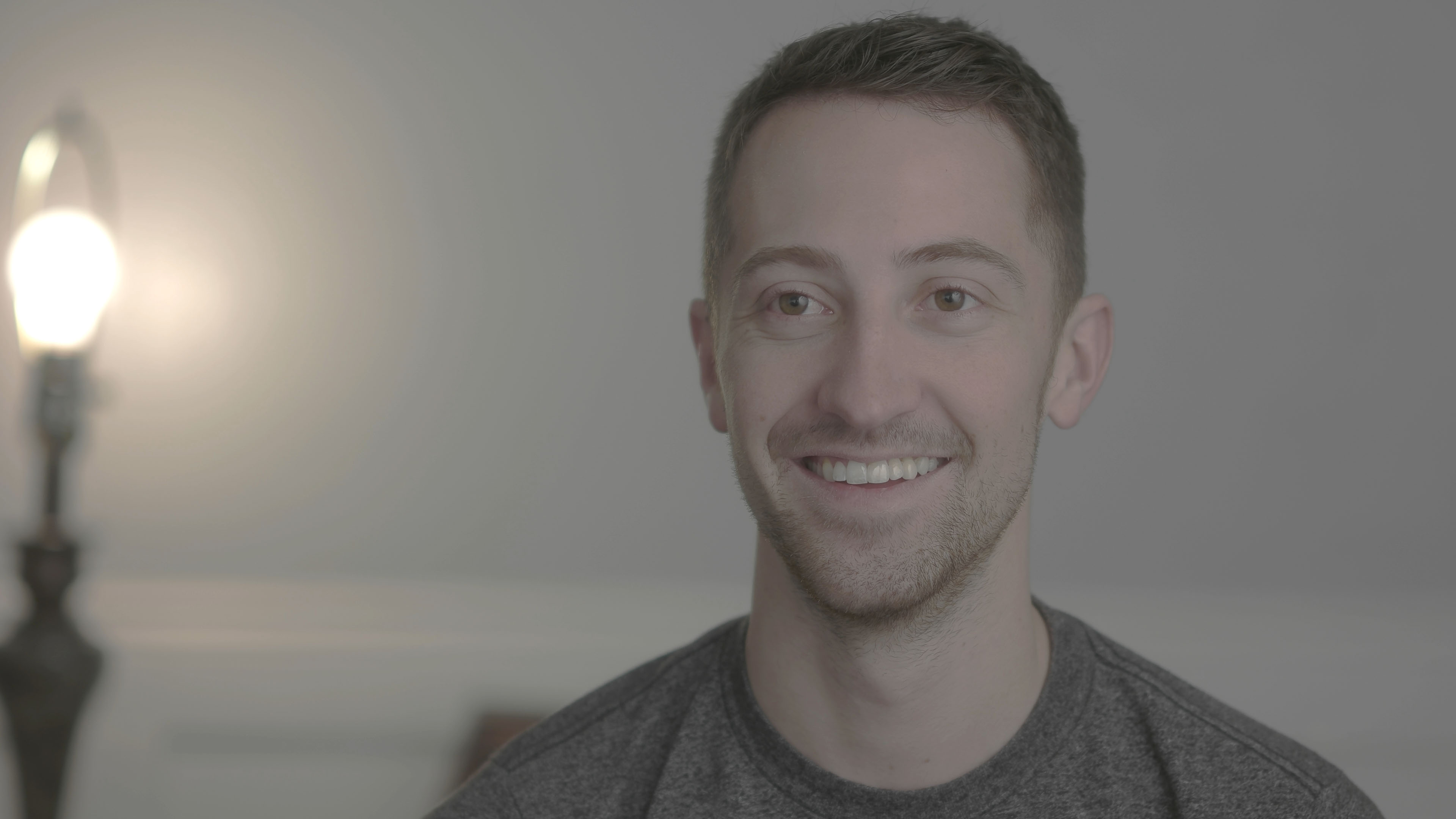

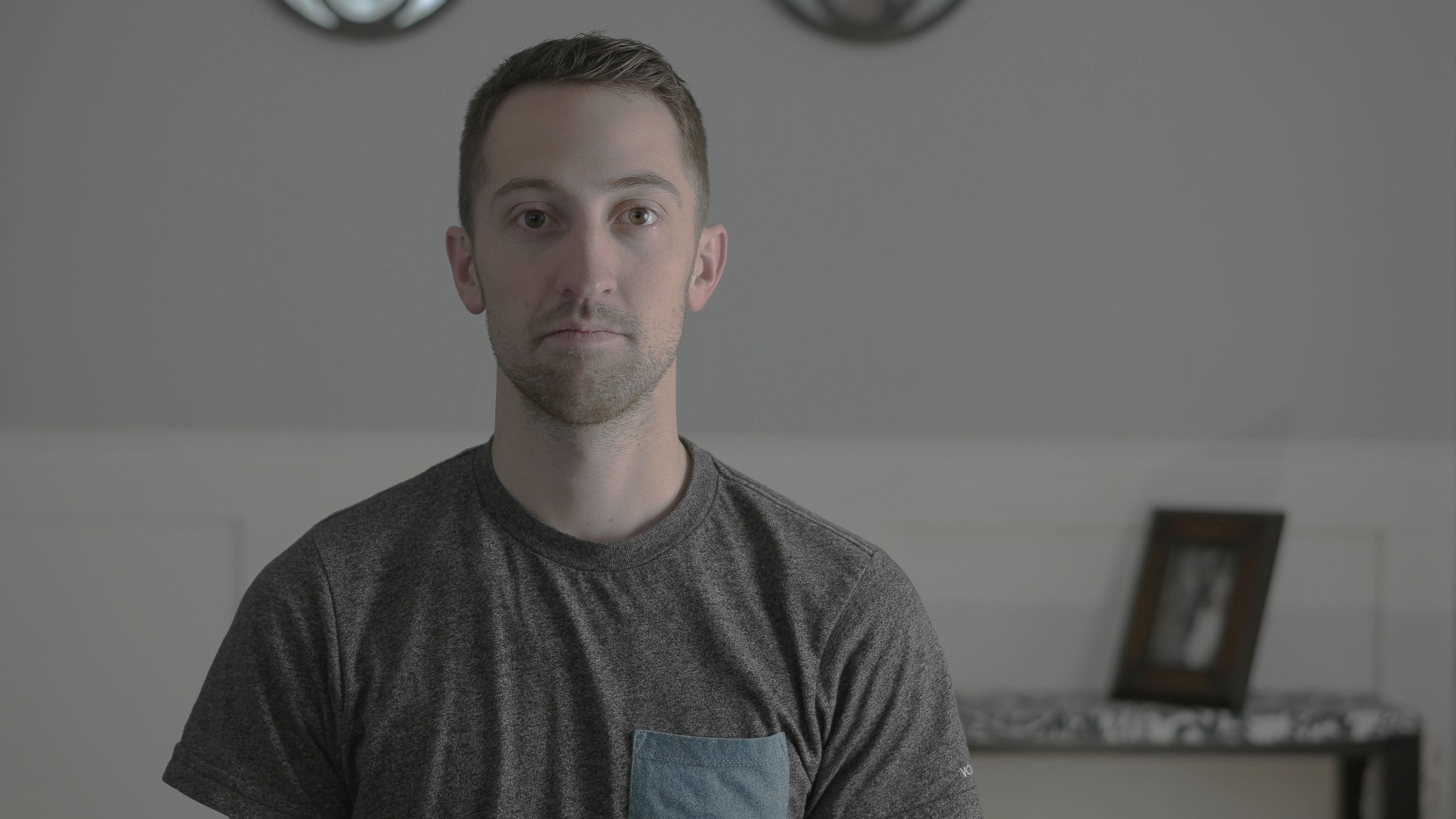

caseywilsondp Posted January 14, 2016 Share Posted January 14, 2016 On 1/13/2016 at 2:33 PM, KarimNassar said: if you could setup a shot on a tripod that introduces banding and macroblocking issues, such as for example a white wall next to a window that is a little underexposed with gradual fall off of the light on the wall, to compare the internal vs 10-Bit 4:2:2 shogun that would be great. I would assume it makes no difference since the output of the nx1 is not 10bit 4:2:2 but would be interesting to check and compare.yesterday I actually did a test, though not a comparison. I didn't notice macro blocking as an issue, but banding was terrible... Which was very disappointing. I wasn't expecting to get the same latitude as I was on my a7s, but after dialing my settings in I felt I was really close... But the banding is terrible (though it appeared very tolerable on the flat image before i started grading) which makes the really low contrast settings on the nx1 good for really only a few types of scenes. I'll upload a picture that's "raw" and one "graded" in a couple of minutes for you to see. Link to comment Share on other sites More sharing options...
kidzrevil Posted January 14, 2016 Share Posted January 14, 2016 I was playing around with the camera today and noticed at the same exposure settings when using 16-255 and especially 16-235 the camera doesn't display the same highlight clipping as it does when using 0-255. My overexposure guide (zebras) were going nuts then I switched to 16-235 and poof no more clipping at the same exposure. Has anyone else noticed this ?! From my understanding you are not supoosed to be gaining any DR by switching the luminance I am very confused right now ! Link to comment Share on other sites More sharing options...

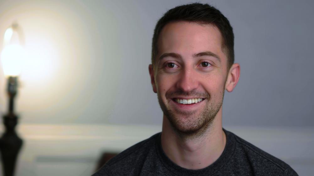

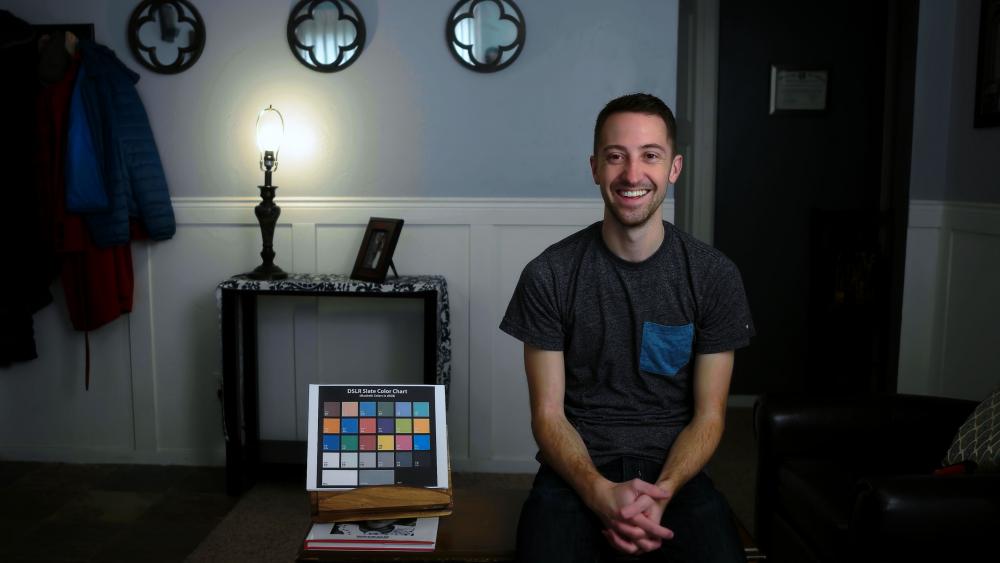

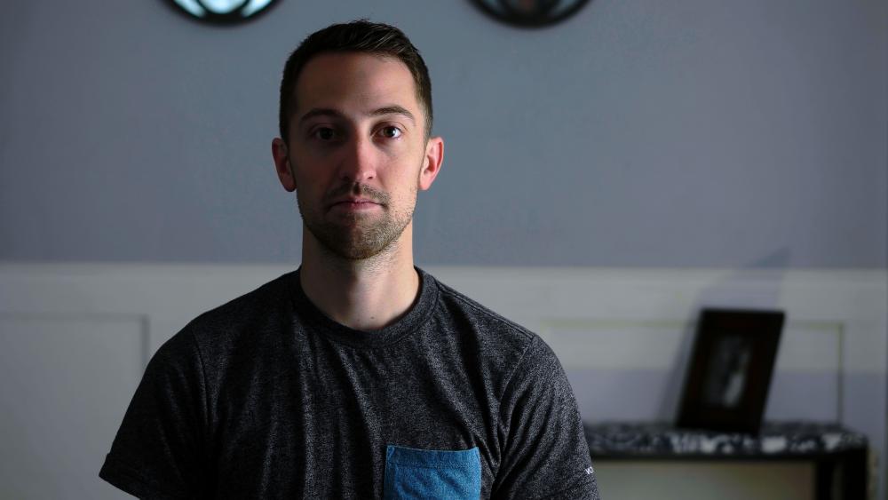

caseywilsondp Posted January 14, 2016 Share Posted January 14, 2016 Ok here are some grabs from the scene. In some cases the banding I would honestly say is "acceptable" though not ideal.. and maybe thats just me being a little generous.The grade contains about 60% of neat video denoising, which is more aggressive than what I really ever use. I was hoping it would help mitigate some of the banding problems.. and it does to some limited extent.Jpegs:Tiffs for better viewing: NX1_Color_Test_Close.tif NX1_Color_Test_Close_Graded.tif NX1_Color_Test_SideL.tif NX1_Color_Test_SideL_Graded.tif NX1_Color_Test_Wide.tif NX1_Color_Test_Wide_Graded.tifCamera settings as follows:Gamma DR, Contrast -10, Sharpness -10, Saturation -4, MBL +10, range is 16-235Shogun set to capture in ProRes HQNow I'm definitely a noob to this camera (thus the testing) so I must ask, is there some other setting somewhere that I need to make sure is adjusted properly? Like a picture profile or something? HDMI is set to 3840x2160 (24) clean out.Tomorrow I'm going to try the test again. I'll shoot/edit quickly to test different settings. What values of above should I change? I am planning on dropping contrast to 0 (I actually did drop it to -5 to test one shot, and the banding was still prevalent) and adjust MBL closer to 0, which seems a shame because in my earlier tests (as posted in this thread) I was able to get a TON of usable detail out of the shadows... but the banding just might not be worth it.Also maybe you can edit the tiffs to have less banding, if so, how?Please share your thoughts. Liam, KarimNassar and Pavel Mašek 3 Link to comment Share on other sites More sharing options...
Geoff CB Posted January 14, 2016 Author Share Posted January 14, 2016 From looking at your originals, I think you have your Saturation turned down to far. My personal settings: Gamma DRSaturation - 1Sharpness - 10Contrast - 6Black Level + 5 But I do think banding is an issue when it comes to grade. This is the best settings I have found so far for the camera. Marco Tecno 1 Link to comment Share on other sites More sharing options...
