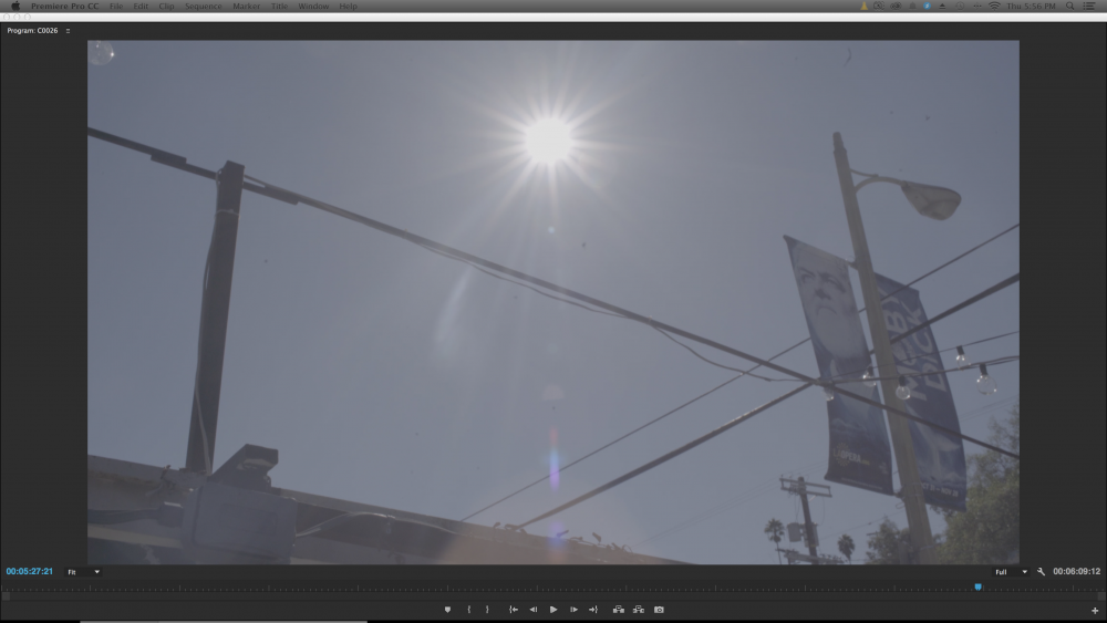

TheRenaissanceMan Posted November 4, 2015 Share Posted November 4, 2015 This is different than I've seen on Blackmagic cameras. There, the blown highlights just turn black. Easy to fix with one click in Resolve. Here, there's this gunky purple transition from normal overexposure to black hole. I don't know how well Resolve will handle that. IronFilm 1 Link to comment Share on other sites More sharing options...

Cliff Totten Posted November 5, 2015 Share Posted November 5, 2015 I took my A7s-II outside at noon today and tried for over an hour to get that black hole sun problem. I shot in rec709, slog1 and slog2. I shot with high ISO's and low. I shot with both large and small apertures. I changes lenses 3 times. I pointed at the sun, at reflections of the sun, LED lights and regular flash lights. I over exposed and under exposed....ALLOT!Everything looked completely normal. As hard as I tried, at no time could I generate this problem whatsoever. (not even slightly)I have no idea how your camera is doing that so easily. Maybe you got a lemon?Mine?...after all I did today, I'd definitely say my A7s-II bullet proof. It's certainly immune to this issue. On another note,...Did you shoot that color-banded video in 60 or 100mbp/s? Link to comment Share on other sites More sharing options...
