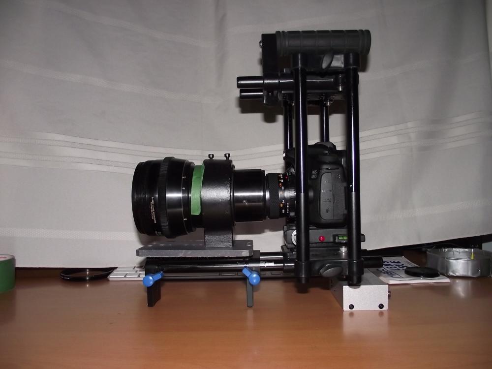

This  was my first lens and it was dam good lens when it comes to quality its right up there with ISCO i head sankor  many other small anamorphic lenses but they cant match sharpness and quality of this lens its not video sharp like never projection lenses but has that film softens its unique. What i love with this lens i can use 35mm lenses and up. you can even cut it in half and use 24mm and up. And best thing is that i only focused with one lens. I have kowa for B&H but its pain in the ass to focus. Its noit havey just some pople are lazy to do the work if you do the work you will get some beautiful images out of it
MY beast
Link to post
enny, I appreciate the info and the picture of your setup!
I watched a clip of Roberto Lopez' chopped B&L which used a 24mm Nikon. In a later clip there's a shot at 0:45 where the curvature in the pillars is very pronounced. I don't know if that's a characteristic of the B&L, a result of being too close to the pillars, a byproduct of the lens hack, or some combination.  But it's definitely something I want to avoid (or at least minimize).
Are there any other tips, details, or footage you could share?  Can you explain how you do single-focus with your setup?  Do you focus with the B&L, or the taking lens?
Thanks again!
Link to post

no i dont focus with the B&L at all just the back lens. B&L does not focus i been trying to focus or defocus while spinning the front of the lens but no effects is noticed curvature of the pillar is bad its defiantly due to  modification i have never seen anything like this on my image i would get edge to edge sharpens and clarity.
Tips i would not modified the lens at all just to be safe i was thinking but decided not to.

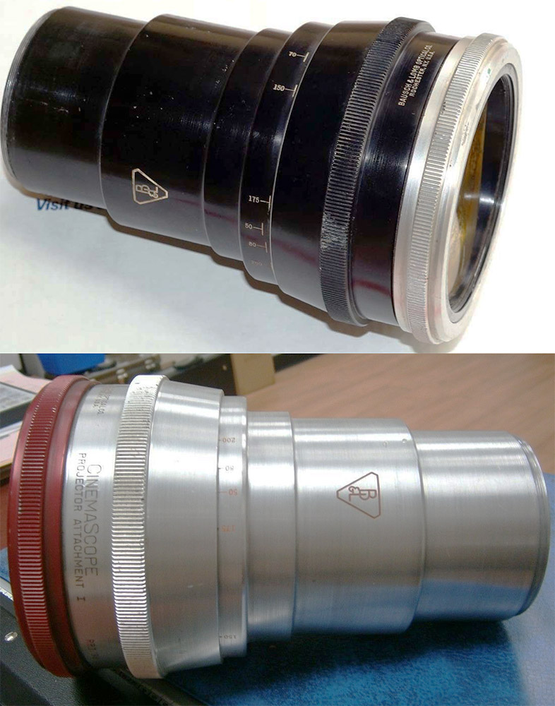

A little more B&L  info: The locking ring (silver or red) must be tightened/loosened with the distance ring. I've found two kinds of B&Ls, one has a black body and silver locking ring, the other has a silver body and red locking ring:
black-silver.thumb.jpg.9943ea34799cfa5a5
The black ones were the later models.

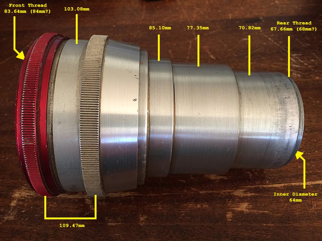

I had a chance to unpack my recently-acquired Bausch & Lomb and poke at it.  Here are my caliper measurements of diameters, accurate to within +/- 0.1mm
Measurements.thumb.jpg.003cf8d0e22f854d5

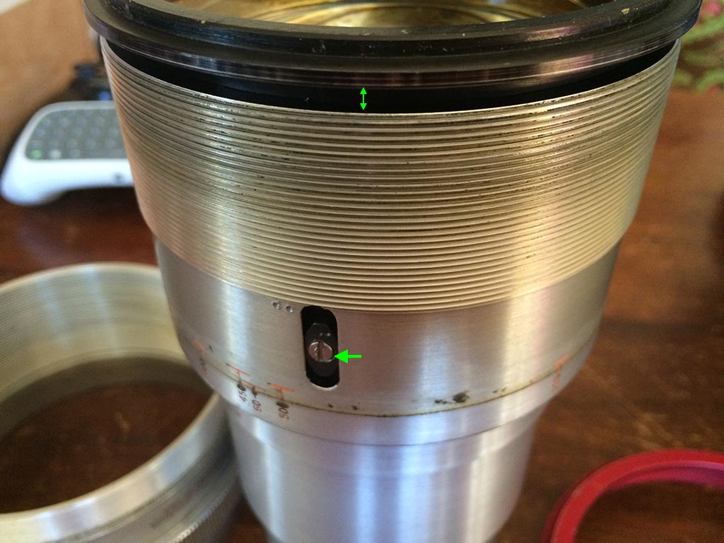

At the top you can see there's some space between the lip of the front element housing and the main housing (green arrow).  I'm wonder if loosening the screw (other green arrow) allows the front housing to be pushed down.  From the Anamorphic Lens-cyclopedia: The lens can be set to closer than the minimum focus of 50 feet by turning it past this setting and pushing the front element housing down to its maximum depth within the lens body. [source].
With luck this may allow focusing closer than 12ft, which is the lens' reported minimum focus distance.  It's also reported that it the B&L can use lenses as wide as 35mm on a micro 4/3 sensor without vignetting. Once I have all the support pieces assembled, I'm looking forward to testing the minimum focus & vignetting with my MIR 1B 37mm.

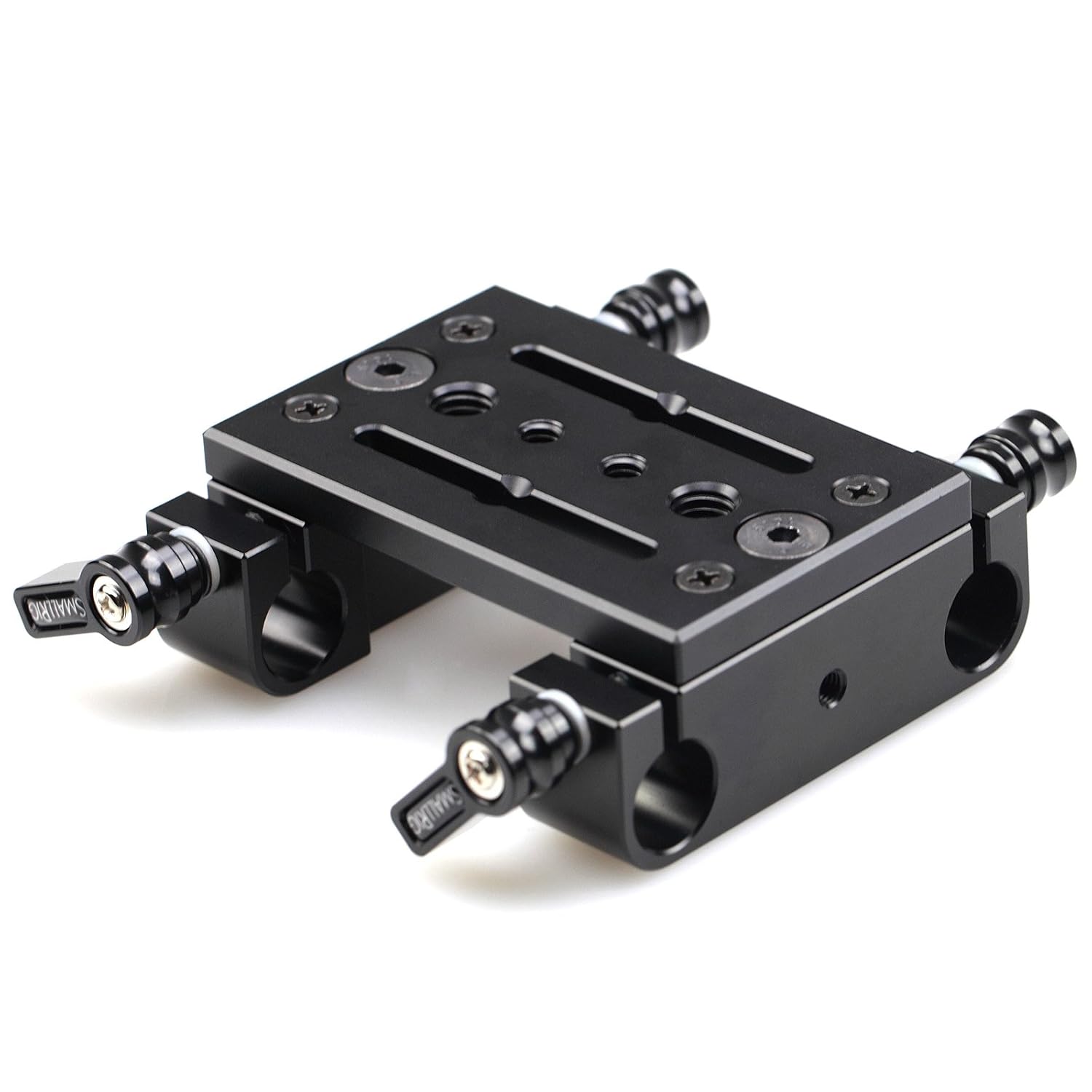

The B&L's weight is reported as approximately 8 pounds...by far the heaviest in the Lens-cyclopedia.  So for support I'm going fasten these finderscope rings to a DSLR mounting plate, then affix the B&L, and put it on rails (basically my variation of the Tecnoir support rig, which doesn't appear to be available anymore).

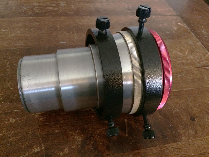

My Orion clamps arrived today.  I was worried that they might be a little too small.  I removed the red B&L ring and slid one over and it fits snugly between the retaining ring and the focus ring.  So snugly in fact nylon screws may not even be necessary.
clamp1.thumb.jpg.27a29c2f8b6a5942b26f242
I noticed when I slid the red retaining ring back on & tightened it (until it locked with the focus ring), I was able to turn the focus well past the minimum 50ft distance mark. A couple posts above you can see the focus marks on both the black and silver models.  In the picture above I've screwed the focus so far down that it completely covers all the focus markings.  I'm curious to see what the resulting min. focus distance will be.
I wanted to attach the second Orion ring to the 77.35mm section (see measurements picture in previous post) but the nylon screws are about 1.5mm too short to get a solid purchase.  I can probably do a little sanding at the base of each screws to get the rest of the way, or try to find longer screws.  Alternately, I could attach the second ring to the 85.10mm section of the barrel:
clamp0.thumb.jpg.310d39b3baa89c2339ec10b

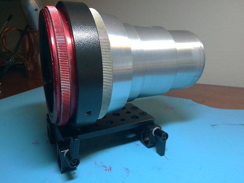

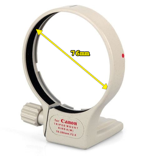

But I want the stabilization points to be farther apart along the body of the lens.  So I ordered a cheap lens collar:
clamp.thumb.jpg.03414bd151d3b5d899157ca2
Which should give the perfect fit.  Then I can fasten the Orion ring & the Canon collar to a 15mm baseplate, and it will be good to go.  Once my Xetron XA arrives I'll probably use the 2nd Orion ring (and pick up another Canon collar and 15mm baseplate) for that, so that each lens has its own dedicated support.
If you need a support solution a big honking anamorphic lens, you should consider the Orion clamps.  They'll fit anything from 105mm down to 80mm in diameter.  They are heavy duty and inexpensive.

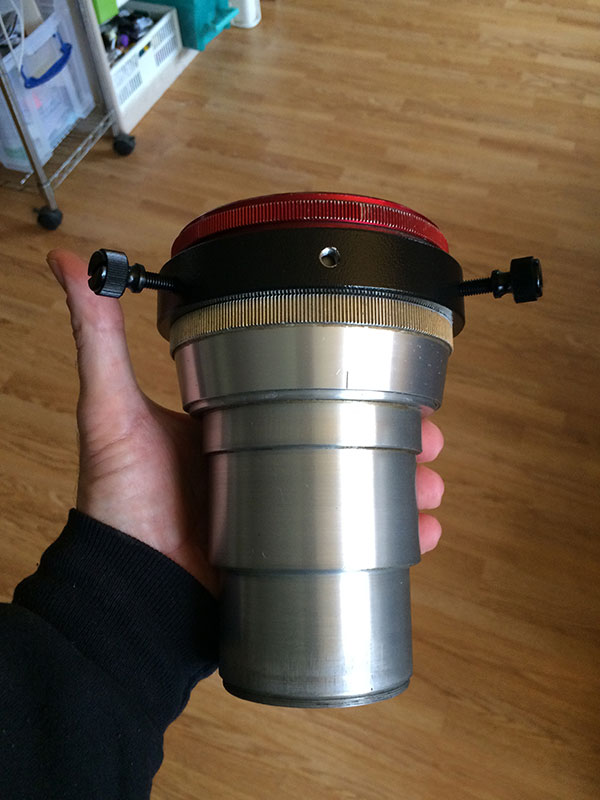

My mistake.  Somewhere I read this lens was 4.4kg which is incorrect — It's not even 4.4lb.  I put it on a digital scale and it weighs in at a dainty or 3.56lb, or 1,627g.
Feels like 8 pounds though :stuck_out_tongue_winking_eye:
