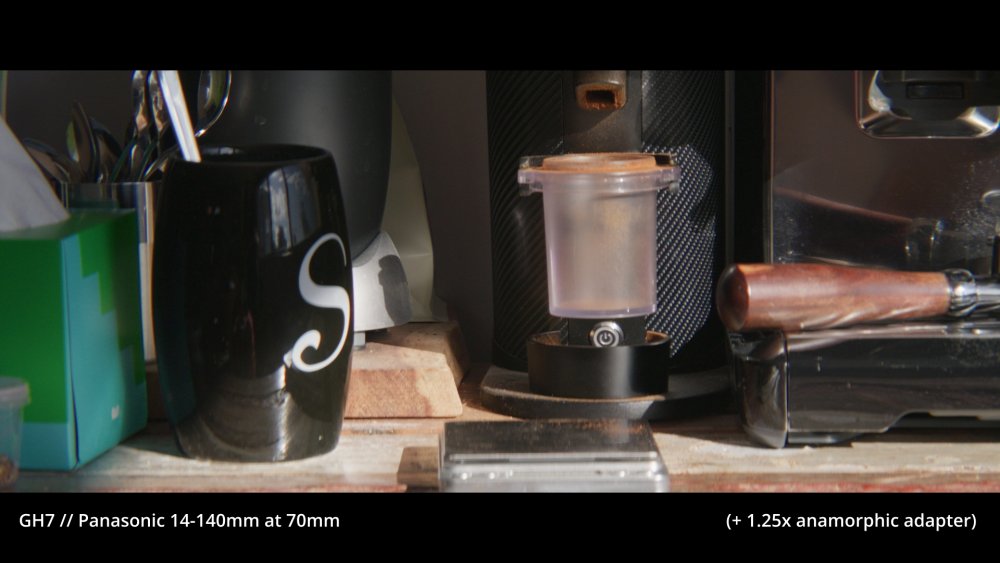

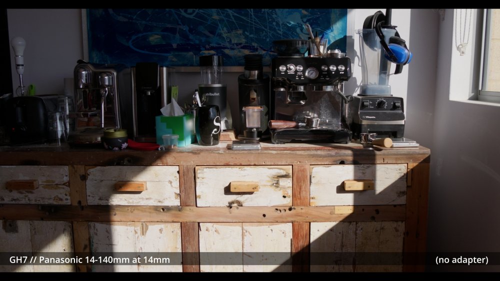

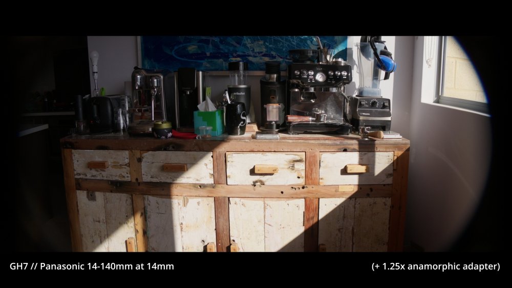

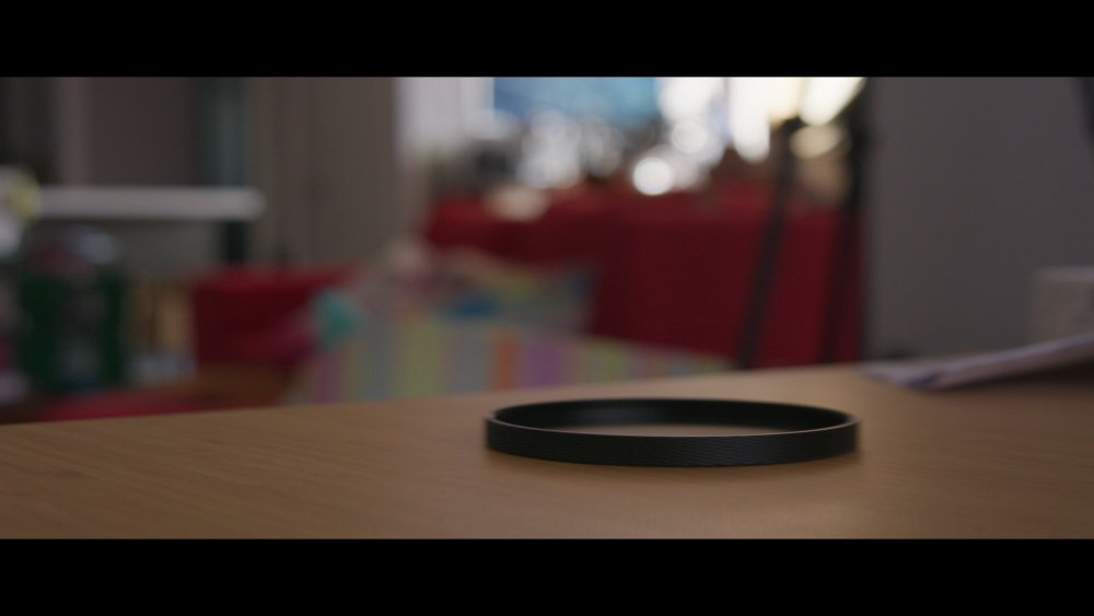

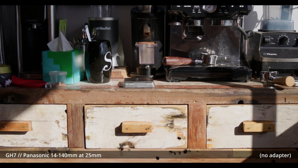

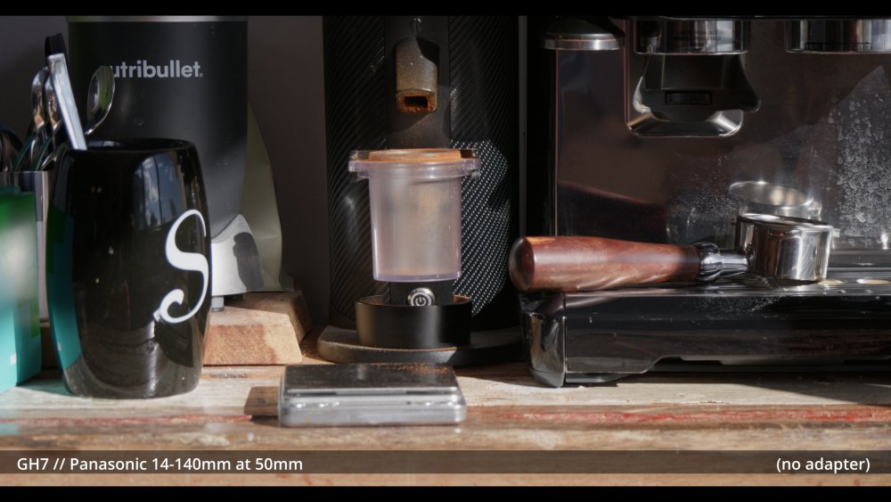

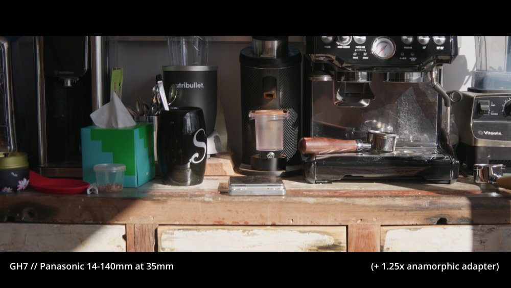

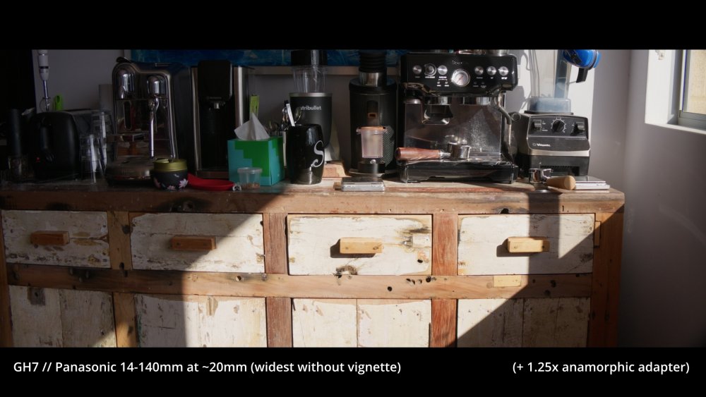

kye Posted July 30, 2025 Author Share Posted July 30, 2025 Sirui first light.... I'm not 100% sure I've done everything correctly, so take these with a pinch of salt. Also, the Sirui has a vND on it but the normal shots don't, so that might account for the WB and polarisation differences. The advice I heard was to set the taking lens to infinity and then focus with the adapter (single focus setup) but the AF on the taking lens seems to work just fine and Uncle ChatGPT says that setting the taking lens to infinity is more likely to be an optimal setting rather than the only setting that will work. Here's a shot where I set the adapter to minimum focus and then focused closer with the taking lens.. I don't think it's properly focused though, and the bokeh isn't squished much at all, so this is probably quite far from optimal settings, but also possible. Obviously I have a lot of testing to do, but if I can still use the AF to fine-tune the focus then that's even better as I can sort-of zone-focus with the adapter and then shoot quickly with AF like I normally do! Overall though, a very promising start.. despite it being so big and heavy!! BTM_Pix 1 Link to comment Share on other sites More sharing options...

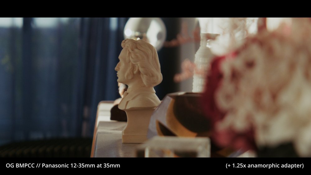

kye Posted July 30, 2025 Author Share Posted July 30, 2025 Then, to go from the ridiculous to the absurd... But it's like that saying, all's well that ends well.. and Chopin seems to like it. Link to comment Share on other sites More sharing options...

Super Members BTM_Pix Posted August 1, 2025 Super Members Share Posted August 1, 2025 On 7/30/2025 at 9:41 AM, kye said: I'm not 100% sure I've done everything correctly, so take these with a pinch of salt. Also, the Sirui has a vND on it but the normal shots don't, so that might account for the WB and polarisation differences. Have you got a non native MFT lens at that 14-24mm range that you could have a quick test with as the taking lens ? Trying to see the wood from the trees regarding the extent of the (expected) barrel distortion of the adapter without the camera's built in correction of the native lenses adding or subtracting from the party. Link to comment Share on other sites More sharing options...

kye Posted August 2, 2025 Author Share Posted August 2, 2025 18 hours ago, BTM_Pix said: Have you got a non native MFT lens at that 14-24mm range that you could have a quick test with as the taking lens ? Trying to see the wood from the trees regarding the extent of the (expected) barrel distortion of the adapter without the camera's built in correction of the native lenses adding or subtracting from the party. I'll have a look but the widest non-MFT I think I have is probably 28mm. BUT, if you mean no electronic contacts (which means the camera doesn't know the lens and wouldn't compensate for it?) then I have 7.5mm F2, 8mm F4, 15mm F8, 17mm F1.4, 17.5mm F0.95. Happy to do some quick tests - let me know what you want to see 🙂 Link to comment Share on other sites More sharing options...

Super Members BTM_Pix Posted August 2, 2025 Super Members Share Posted August 2, 2025 3 hours ago, kye said: I'll have a look but the widest non-MFT I think I have is probably 28mm. BUT, if you mean no electronic contacts (which means the camera doesn't know the lens and wouldn't compensate for it?) then I have 7.5mm F2, 8mm F4, 15mm F8, 17mm F1.4, 17.5mm F0.95. Happy to do some quick tests - let me know what you want to see 🙂 I thought you had a bunch of old tat like the rest of us with M42, Y/C etc mounts but yeah if you have non electronic MFT lenses then thats fine. The 17mm f1.4 would be fine if you get a chance. Link to comment Share on other sites More sharing options...
kye Posted August 2, 2025 Author Share Posted August 2, 2025 22 minutes ago, BTM_Pix said: I thought you had a bunch of old tat like the rest of us with M42, Y/C etc mounts but yeah if you have non electronic MFT lenses then thats fine. The 17mm f1.4 would be fine if you get a chance. Yeah, I have a bunch of M42, but none wider than 28mm as it's all FF vintage. I'll grab some shots. BTM_Pix 1 Link to comment Share on other sites More sharing options...

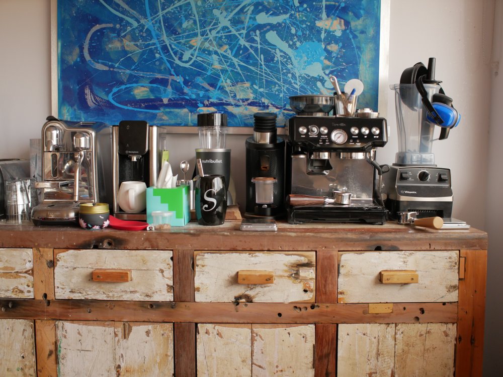

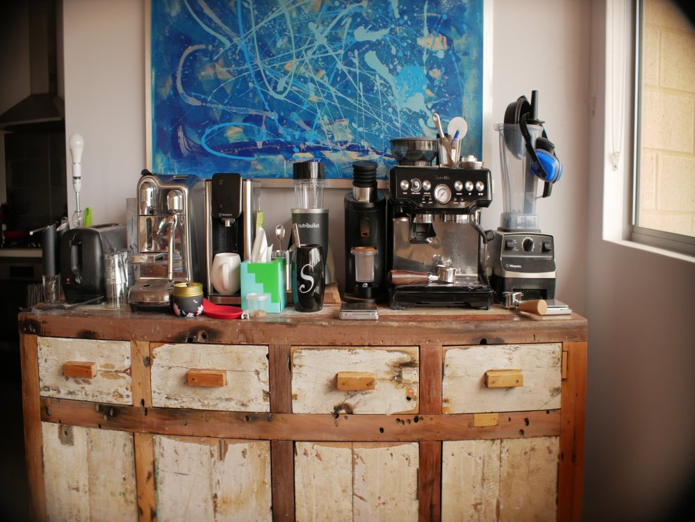

kye Posted August 4, 2025 Author Share Posted August 4, 2025 On 8/2/2025 at 4:58 PM, BTM_Pix said: I thought you had a bunch of old tat like the rest of us with M42, Y/C etc mounts but yeah if you have non electronic MFT lenses then thats fine. The 17mm f1.4 would be fine if you get a chance. I just remembered that the 17mm F1.4 has a strange filter thread size I don't have an adapter for, so I went with the Voigtlander 17.5mm instead, plus I also did the Voigtlander 42.5mm as well. I took stills on the GX85 so you can see the full sensor readout, and the SOOC images below are the actual images from the SD card and 7.9MB each so pixel pee to your hearts content if desired. I even remembered to set the taking lens to infinity and focus with the adapter! Voigtlander 17.5mm at F2.8, no adapter, SOOC: Voigtlander 17.5mm at F2.8, with Sirui 1.25x adapter, SOOC: Voigtlander 17.5mm at F2.8, with Sirui 1.25x adapter, de-squeezed (0.8x vertical size adjustment): Voigtlander 42.5mm at F2.8, no adapter, SOOC: Voigtlander 42.5mm at F2.8, with Sirui 1.25x adapter, SOOC: Voigtlander 42.5mm at F2.8, with Sirui 1.25x adapter, de-squeezed (0.8x vertical size adjustment): Hopefully that's useful. I took a shot of something round last week and pulled it into Resolve and rotated it 90 degrees and lined it up at 50% opacity to test the squeeze factor, which turned out to be just under 1.25x, but I suspect this might change depending on the focus distance. I don't know if it might also change with the taking lens, but I'm probably not going to do extensive testing on all my lenses. Also, for my purposes, it's meant to be a controlled degradation so nailing the squeeze factor for all focus distances isn't a high priority. Let me know if you want any other tests, some of these are pretty quick to do. BTM_Pix 1 Link to comment Share on other sites More sharing options...
Super Members BTM_Pix Posted August 4, 2025 Super Members Share Posted August 4, 2025 7 hours ago, kye said: Hopefully that's useful. It certainly is, thanks for doing that. Much appreciated. kye 1 Link to comment Share on other sites More sharing options...
