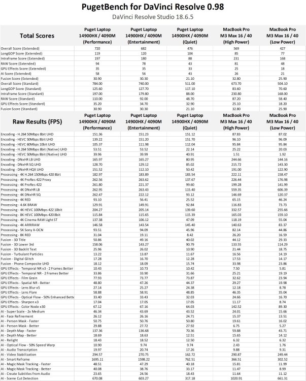

kye Posted April 26, 2024 Share Posted April 26, 2024 It's worth pointing out that the thermals might be the dominant factor here, considering that laptops will throttle down on their performance in order to manage overheating, so a few extra fans in the laptop can make more difference than which model of CPU / GPU you buy! John Matthews, eatstoomuchjam, shooter and 1 other 3 1 Link to comment Share on other sites More sharing options...

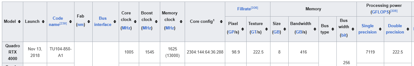

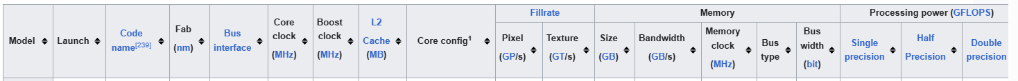

ac6000cw Posted April 26, 2024 Share Posted April 26, 2024 7 hours ago, kye said: It's worth pointing out that the thermals might be the dominant factor here, considering that laptops will throttle down on their performance in order to manage overheating, so a few extra fans in the laptop can make more difference than which model of CPU / GPU you buy! I agree (as someone who has done all my editing for years on either gaming or workstation-class laptops). Generally, decent laptops in both of those categories should have cooling good enough for long-term high CPU and GPU loads, but you do need to choose carefully - and expect them to be noisy when they are working hard! Also be careful when comparing desktop and laptop GPUs - they can have the same or very similar model numbers, but the laptop version might have different performance specs (and more aggressive thermal management) e.g. : (info from Wikipedia) The desktop version of the nVidia Quadro RTX 4000 (100-125 watts Thermal Design Power): ...versus the mobile version (60-80 watts TDP): shooter and kye 2 Link to comment Share on other sites More sharing options...
eatstoomuchjam Posted April 26, 2024 Share Posted April 26, 2024 If you're in the PC world, you're definitely better off editing on desktop vs laptop if you're working with high-res footage or doing effects, etc. Most laptops throttle down a lot when not plugged in and (in my experience) make a jet engine noise when dealing with a prolonged load on CPU/GPU. And as ac6000cw says, the mobile GPU's are almost always lesser versions of their desktop counterparts. Also when on battery, life tends to be very short because CPU/GPU pull a lot of power. My M2 Max, on the other hand, can handle 8k Canon raw acceptably - and I got the weaker variant of it. Performance is almost the same whether plugged in or on battery. Fans do ramp up when working it hard (now that I've added denoising to most of the scenes that need it, the 14-minute short I'm currently working on/grading definitely has the fans running full blast when I run an export). Basically, in absolute performance numbers a high-end PC desktop will beat any Mac currently on the market and at a fraction of the cost of a Mac Studio ($3k for a decent Ryzen + RTX 4090!). A top-of-the-line PC laptop plugged into the wall will also outperform the MBP in absolute numbers (except whoooooosh fan noise)... but if you want to actually be mobile, the Mac is the hands-down winner. shooter and kye 1 1 Link to comment Share on other sites More sharing options...

Emanuel Posted April 27, 2024 Share Posted April 27, 2024 Well, not exactly the fastest... https://cpu.userbenchmark.com/Compare/Intel-Core-i9-14900KS-vs-AMD-Ryzen-9-7950X3D/m2295306vsm2052977 https://www.pugetsystems.com/labs/articles/intel-core-i9-14900ks-content-creation-review/ Except for RAW though: shooter 1 Link to comment Share on other sites More sharing options...
eatstoomuchjam Posted April 29, 2024 Share Posted April 29, 2024 My guess is that the difference in actual user experience of a system receiving a 923 and one receiving 893 will be negligible. Between the two, I'd choose the one where I get a better deal. ac6000cw and shooter 2 Link to comment Share on other sites More sharing options...
