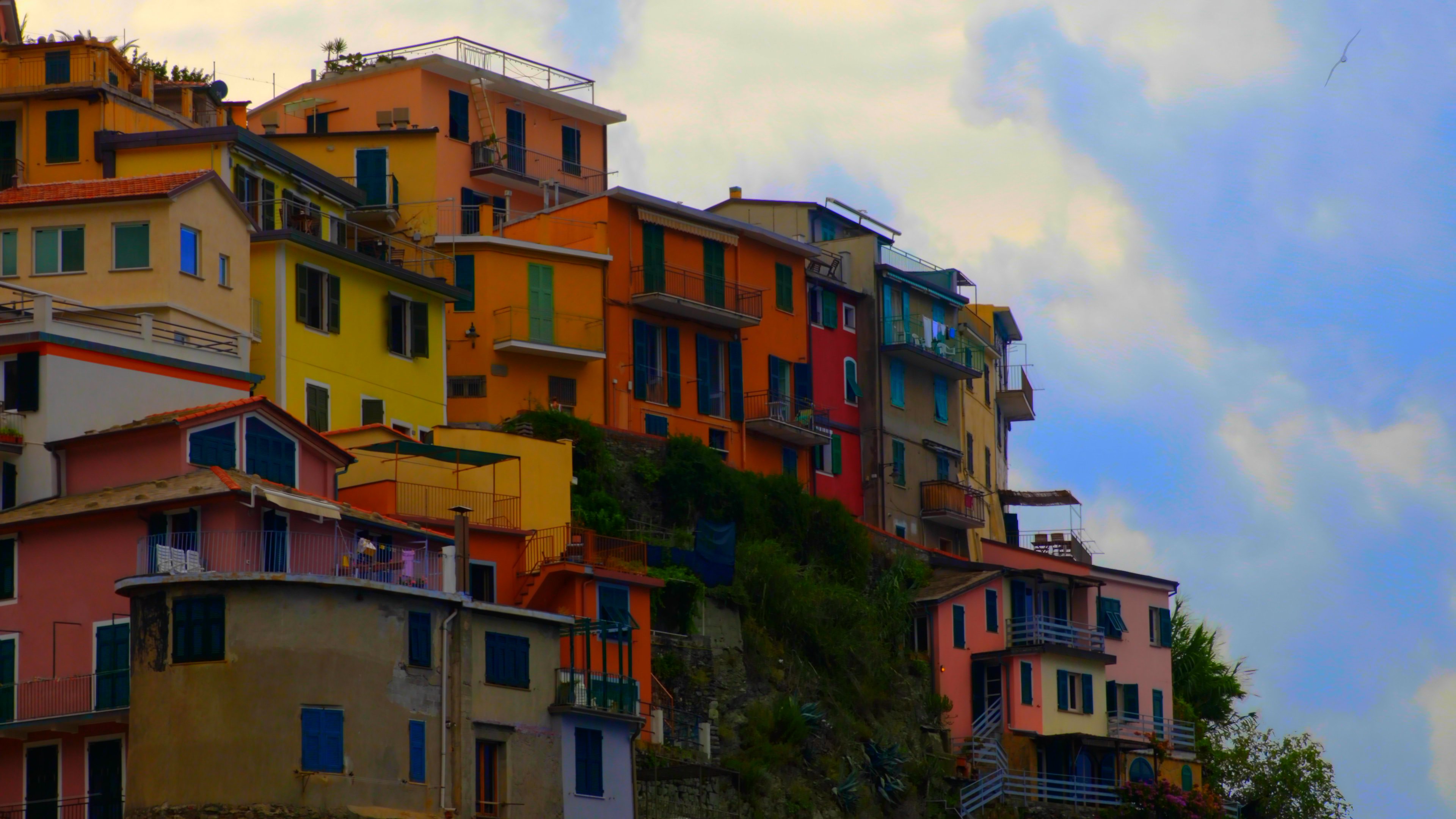

Just as predicted by Tag Team in their 1993 epic hit "Whoomp! There it is!" about recording in 8-bit with LOG profiles, I'm back with the XC10 footage, getting wrecked once more.
Take this delightful image of a cluster of lovely buildings on the Cinque de Terra in Italy:
As you can see, the combination of an overcast day and the C-Log profile makes for a pretty flat image:
So, we adjust WB, levels and some saturation, and get this lovely starting point:
Problem is, look at the noise!

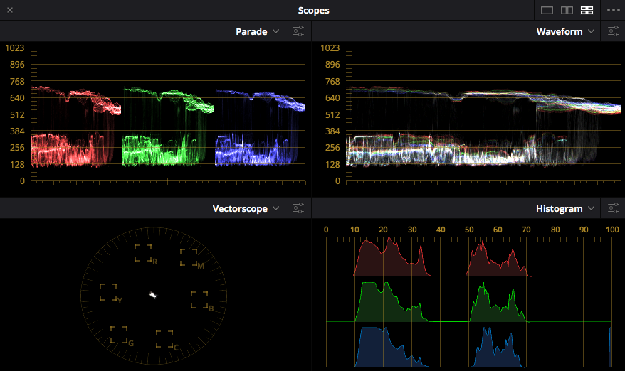

Perhaps our 8-bit file doesn't do a good job with a log profile - let's look at the vectorscope:
Yes.  This is real.
We talk about colour density and thickness of image....   well, this isn't it.
Luckily, Resolve is the love child of a Swiss Army Knife, a tank, and Monet, so with a little Temporal NR and a touch of sharpening, we can pull this phoenix out of the ashes.
Now look:
Obviously I have more work to do on this shot - a lot in fact - but I'm learning.
Grading with this camera is a learning experience, I just wish it wasn't like being pushed into the deep end at gun-point.

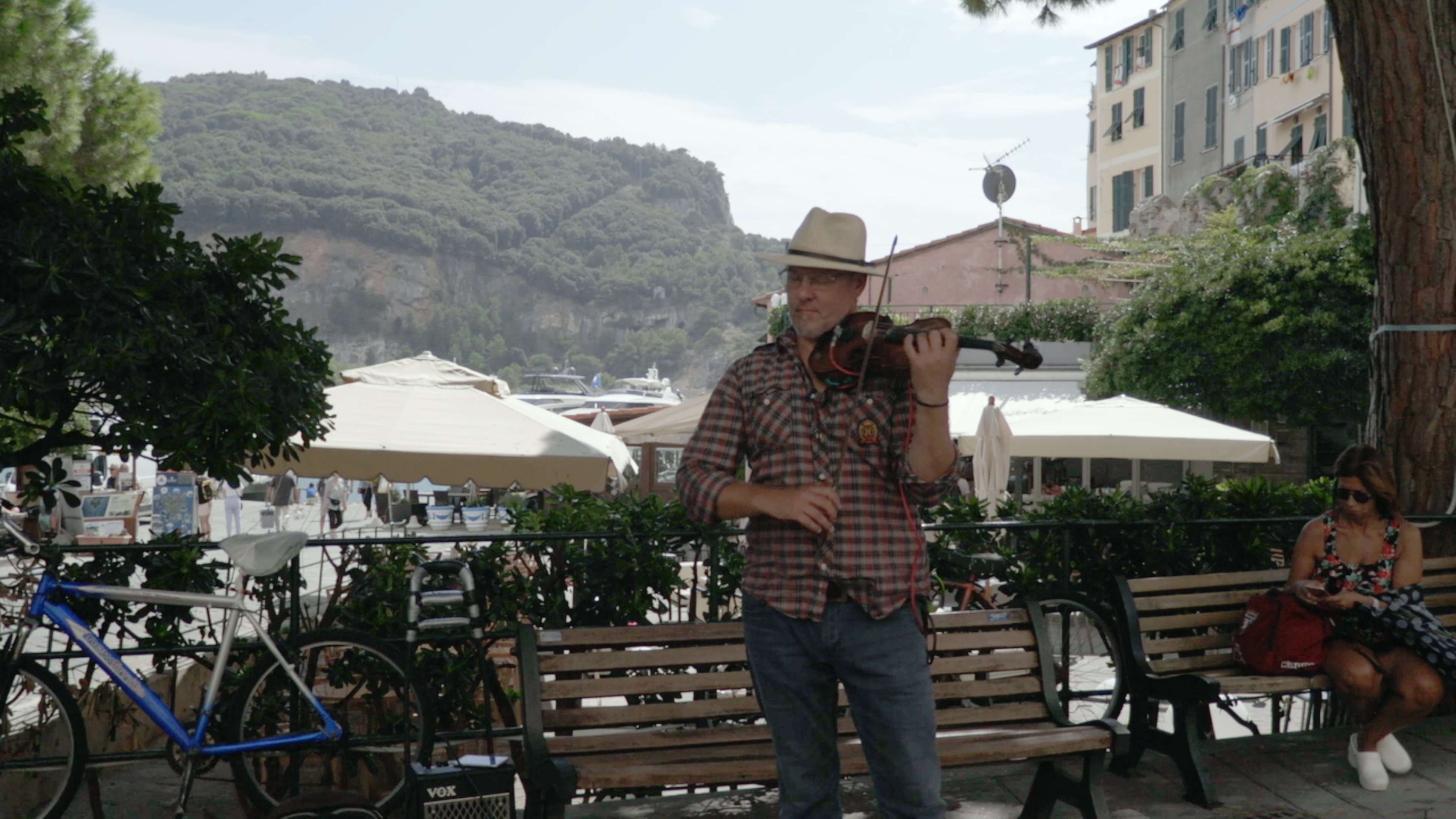

That codec is really hurting it. Especially in a scene like this. Had fun and pushing it around though.
As you implied, some of your issues are that you're hoping shots not well exposed can be successfully manipulated into a gratifying image.
What the photons are doing in your frame to begin with seems to be the bigger problem than the grading.  Your reference image of the town from above is a good example of that.  Early evening light creates more drama than a midday overcast shot. Sometimes with certain footage, you're never going to get it where you want it to be.  In that case you need new footage or just accept it wasn't shot well enough to begin with.
As someone that does the latter all the time, I've learned to know when I get a good shot and when I'm trying to make a silk purse out of a sow's ear.

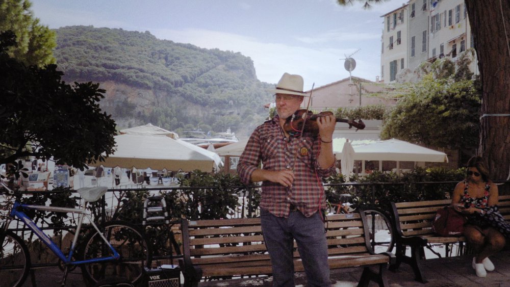

My attempt at a quick image grade of your violinist is sloppy as hell, stylized, and heavy-handed, but it's how I would mess around with an "iffy" shot in Premiere on my own work.  A few traveling mattes to control the brightness behind the subject that demands the eyes attention; take the attention off that as much as possible.  Lift the exposure on the guy's face a bit, trying not to halo too bad -- which I couldn't avoid, actually.
De-saturation of the blacks and highlights, WB to taste, film grain, an application of a FUJI ET film stock, blah blah blah.  It's all personal preference.
FWIW, I just did something similar on a project last week.  Got an bit of footage where the subject is pretty much silhouette and needed to pull his exposure out.  I pretty much knew going in to work on that image that it wasn't gonna look good.  I just accepted that the best I could do to it was make it mediocre rather than crappy.
Honestly, I wouldn't use that wide shot of the violinist if possible.  Hopefully, you have also shot him with a compressed FOV and created a sequence of tighter shots to frame out and soften the background distractions.  The first thing to do when on location would have been to recognize you're shooting a subject in silhouette and change angles so that bad lighting isn't happening.
Good luck overall.  It's always a lot of work...if you find you're doing too much in post, then reassess why that's happening.  The best looking projects need the littlest touches in post-production.
BTW, yes, those of us that shoot 8-bit are limited in what we can do in post on a bad shot...so I've just accepted that as a challenge to try not to get unforgiving shots to begin with.
It's baked in shooting discipline because you know you're not working with as much of a "fix-it-in-post" safety net.
