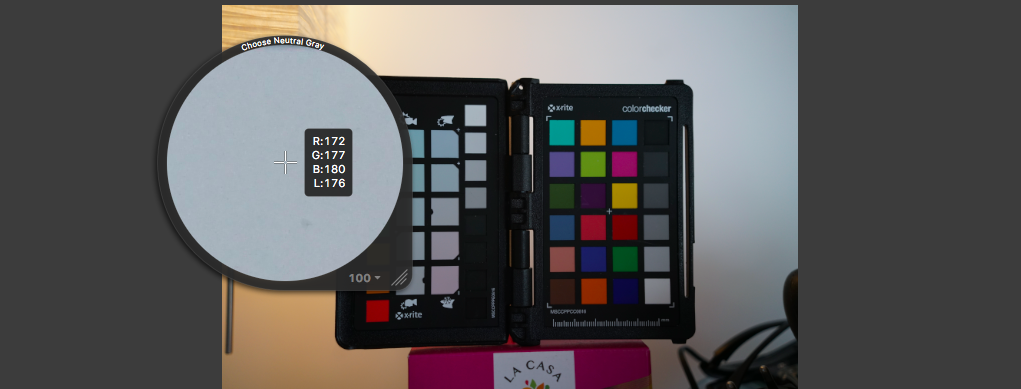

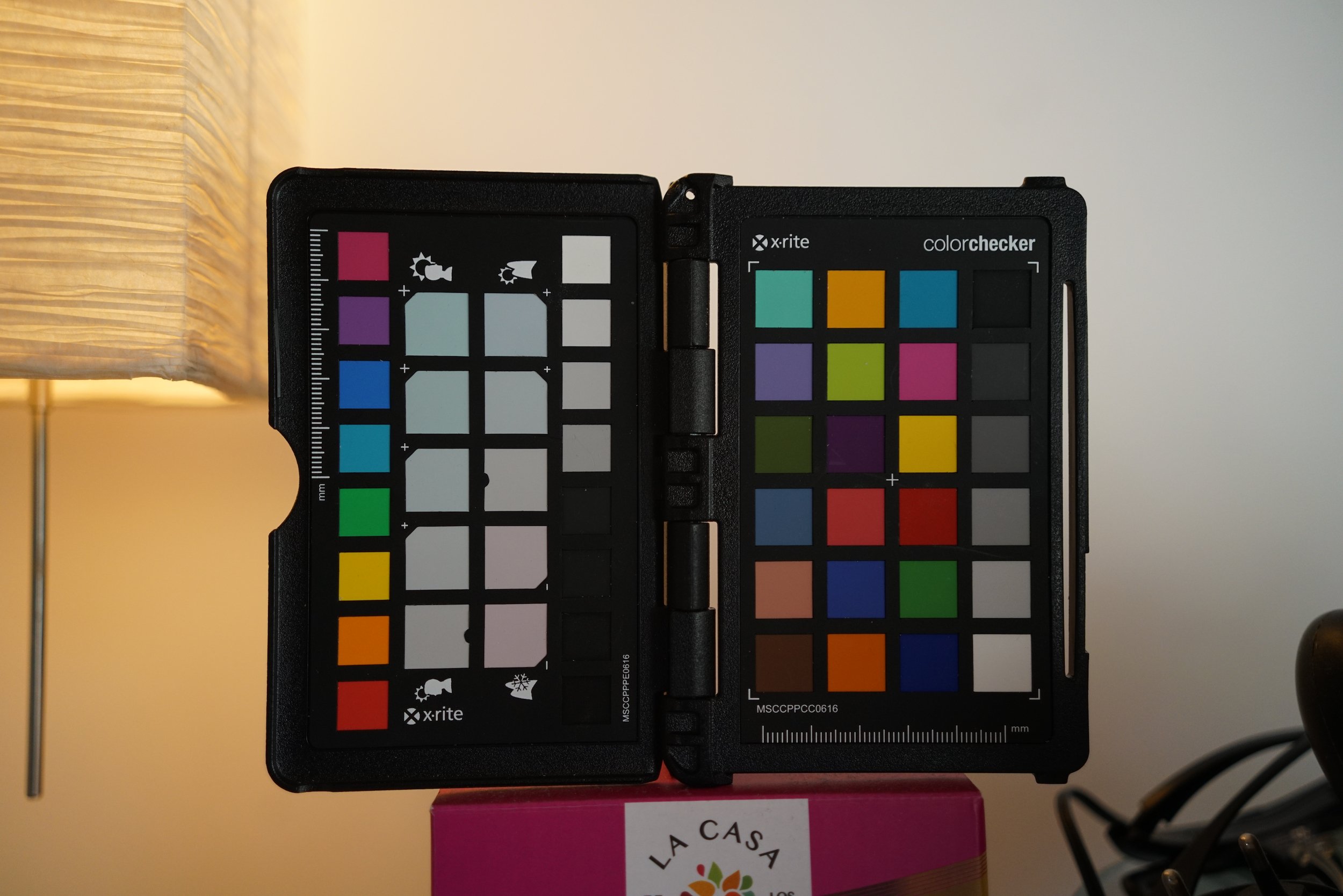

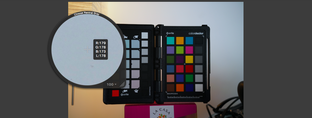

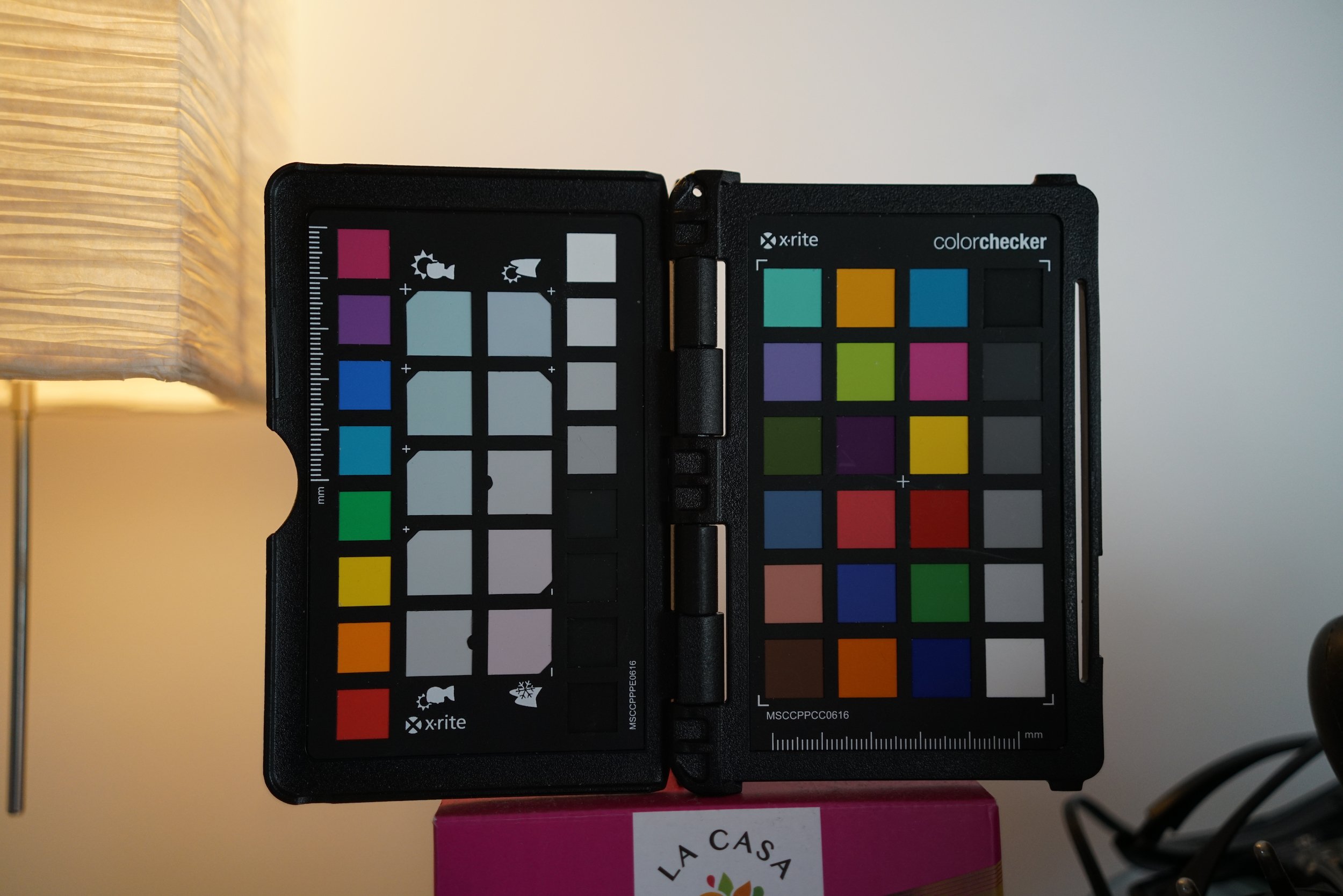

Super Members BTM_Pix Posted January 17, 2020 Super Members Share Posted January 17, 2020 On 1/16/2020 at 8:14 PM, Andrew Reid said: Ah yes I do remember it Gotta be worth a try hasn't it?! OK, nothing elaborate but did these today with an A7Rii. All standard profile, straight out of the camera JPEGs. To make a reference, this is a daylight one, which the AWB does OK with and as expected is pretty much identical to manually white balancing it using the knock off Expodisc. This one is using AWB. And this is the one using the Expodiscalike. To make it make a more challenging comparison, I set the X-Rite up against a white wall adjacent to the window with the left side being lit by a lamp and the right side being lit by daylight. This is it with the AWB. And this is it after setting a manual WB with the Expodiscalike. The AWB is slightly cooler and the Expodiscalike is actually a more accurate representation of how it looked to the eye. Putting the dropper on the same colour patch on the X-Rite, you can see the broad difference in RGB values. AWB on top, Expodiscalike below. So its a subtle difference but even on a quick not exactly that scientific test its definitely there and of course the advantage is it will be locked in for the whole shot. Link to comment Share on other sites More sharing options...

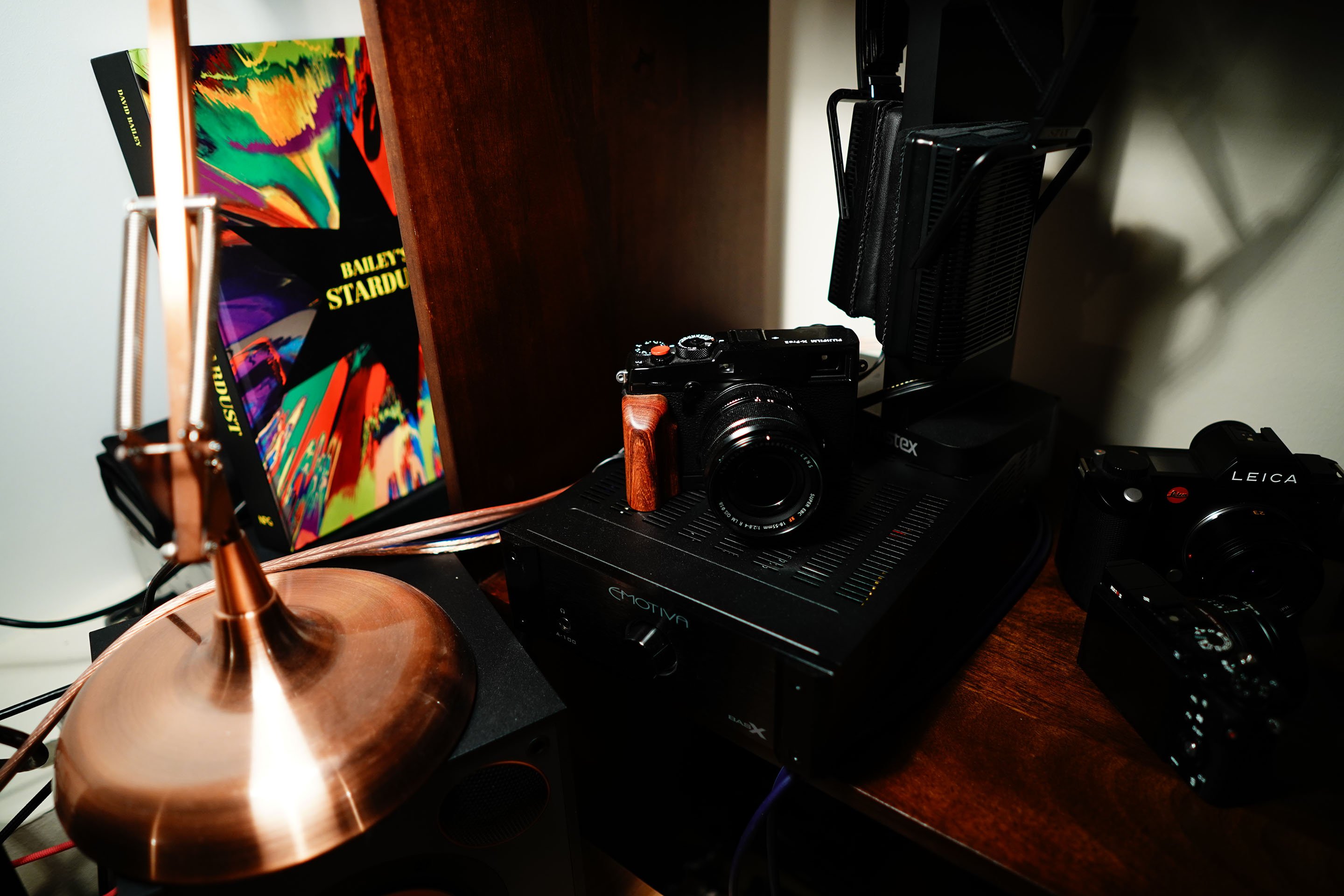

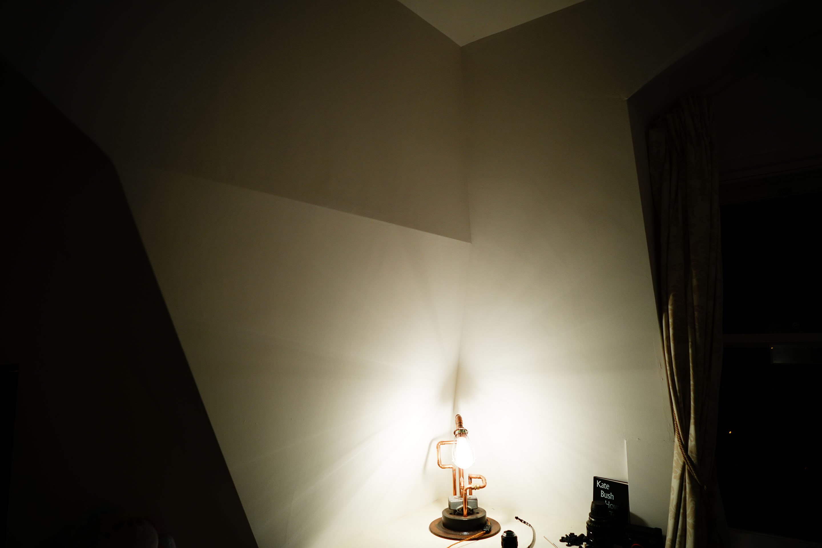

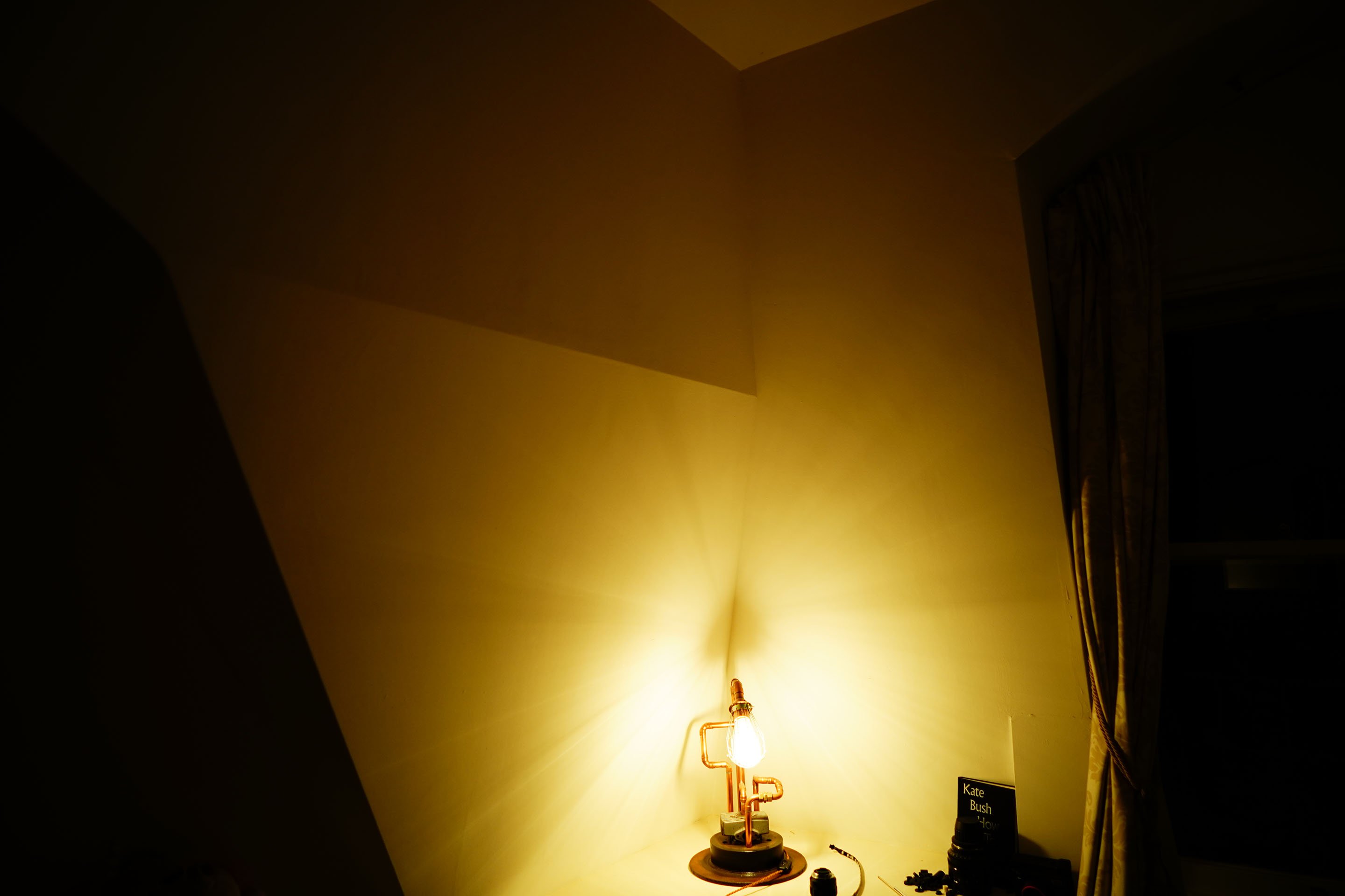

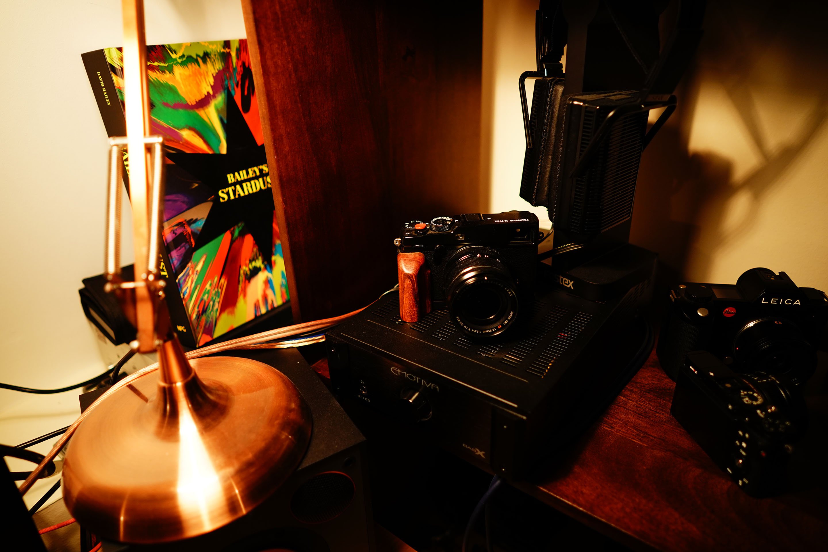

Administrators Andrew - EOSHD Posted January 18, 2020 Author Administrators Share Posted January 18, 2020 The problem I am having with the Sony AWB is under incandescent light and also when there is a mix of artificial light. I'll show you what I mean... Just digging out the file. Here is how AWB Priority = White is supposed to look And here is AWB Priority Ambient, doing it's job to keep the ambient shade of warm retro light bulbs... But AWB Priority = White is very useful, as it maintains a Leica-like neutral white, allowing you to tweak the temperature in post. It is as useful for S-LOG as it is for Creative Styles. S-LOG has some WB baked in too, so that neutral look is important. Here is AWB Priority = White gone wild... It has done a piss stain balance. It is not a nice ambient amber or white. It is neither. Here is how it should look: And it did get there. Just took a lot of coaxing. The reliability needs fixing. Link to comment Share on other sites More sharing options...
