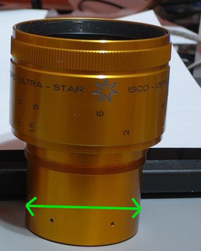

I just ordered one like the one on the right of the photo. Now I need a clamp. I don't know what to buy. My taking lens has a 52mm thread, but I might use another taking lens in the future.
Share this post
Link to post

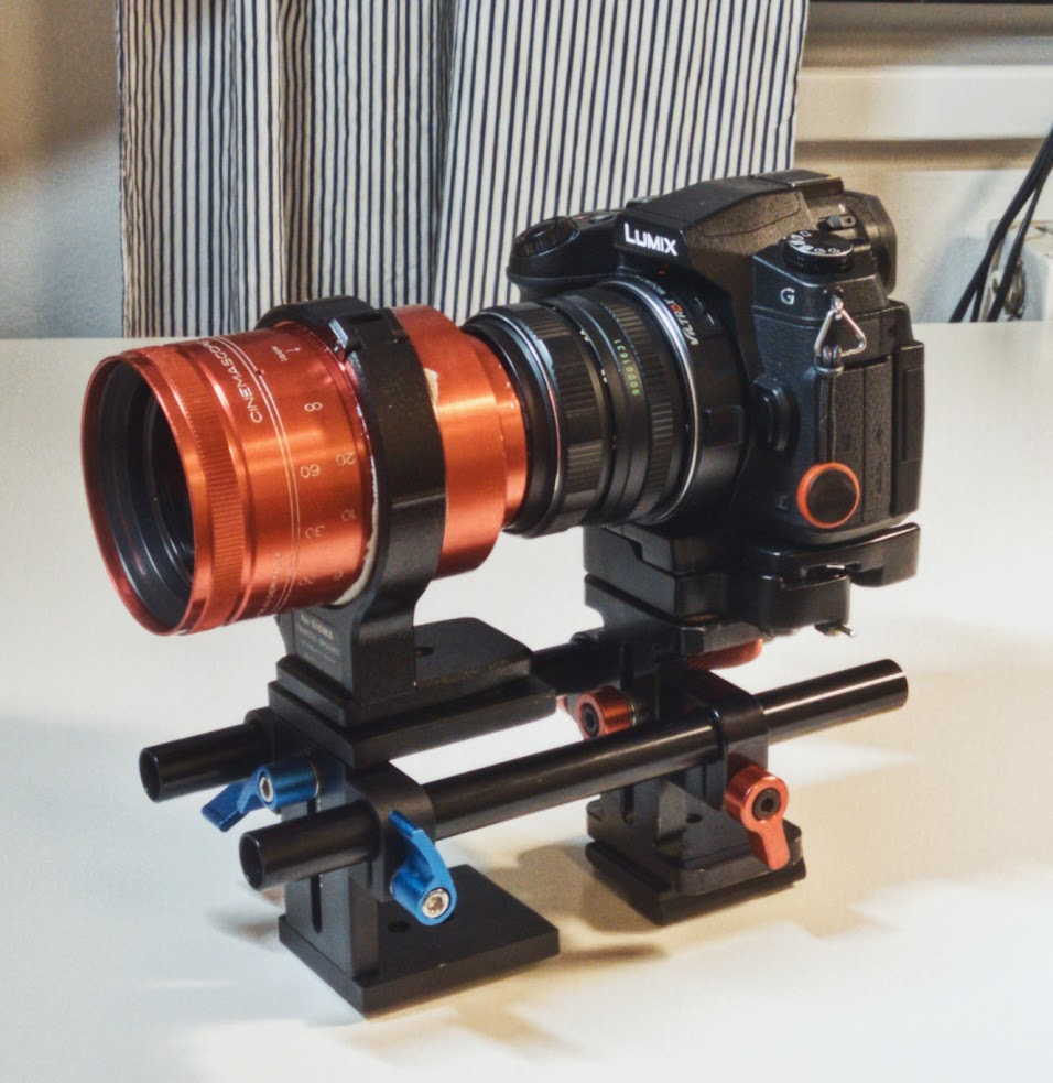

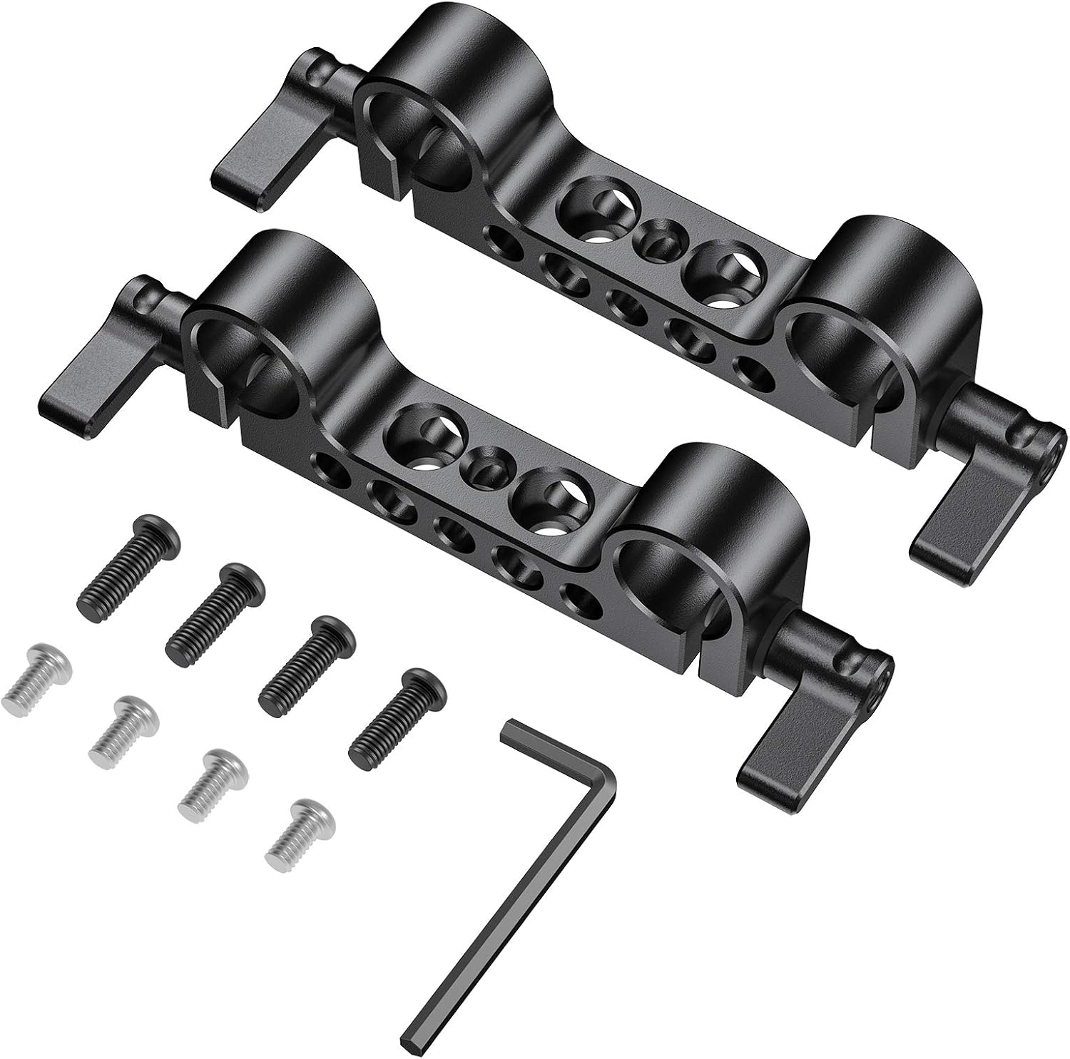

If you plan on building a solid rig based on 15 mm rods, then I highly recommend getting some baseplate / clamp (like this) and a lens collar.
Attach the lens collar to the clamp, slide ISCO inside and secure it (a layer of tape may be necessary to add some grip).
You'll have something like this:
I can confirm that lens collars made for SIGMA 70-200mm F2.8 II EX DG MACRO HSM fit ISCO almost perfectly.

Thanks a lot heart0less for the precious info about the lens collars!
My ultrastar has its back housing removed, so it looks exactly like that one on the right :
Do you think it will be heavy anyway?
If possible I'd rather look like a tourist than a cameraman when I shoot.
Share this post
Link to post
Mine too, welcome to the club.  ( :
Still, if you ever wanted to mount the lens collar, you can place it just a bit closer to the front.
Yeah, I feel you; every one of us would..
It won't be that heavy, unless you add a variable diopter in front, NONETHELESS: your taking lens may take some strain, especially its filter thread, not to mention the camera's lens mount.
I'd say that all those bigger scopes like ISCOs, Cineluxes, Sankors need some kind of a lens support.
Maybe it's just me being on the safe side of things..

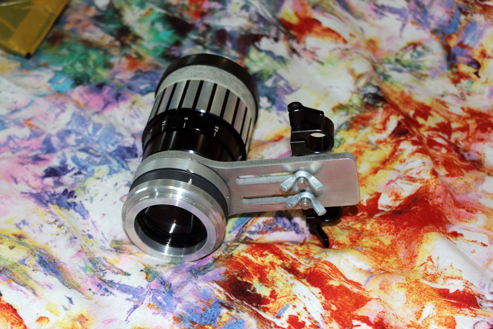

My mounting way for 58mm filter thread (Canon 85mm f1.8) taking lens is here.
BTW, this lens is easy to add(glue a step up ring) non-rotating filter thread for CPL

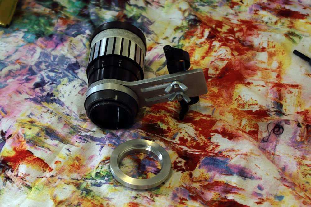

sorry im a bit late too the party i made my own but i had access to a waterject cutter. you could do something similar with a drill just depends on how enthusiastic you are
i measured everything then had a piece cut out of 5mm sheet alloy
my elmoscope came with a mount attached  i had the arm machined off the mount and three holes drilled and tapped to bolt the old mount and my "custom" upright together. The waterject cost me nothing however the machining was a different matter Still i get a warm glow at night keeping a local fed and watered. At the same time i had a adapter made up as the back of the elmoscope is an odd filter size, the other side of it is the same size as a 85mm takumar i think.
i had hopes of getting a single focus solution before now but that hasn't worked out. The issue is that its a solid mount so i come unstuck if the lenses wants to move forward or backwards when you focus the taking lens as there is no give in the system  At this point 1) i either change the base to a linear rail to allow it to move as the taking lens moves 2) buy a single lens solution  3) buy the sirui anamorphic and worry about the elmoscope later on 4) build some type of bellows that has 30-40mm travel but that may cause issues with vignetting.
hope the photos give you some ideas
