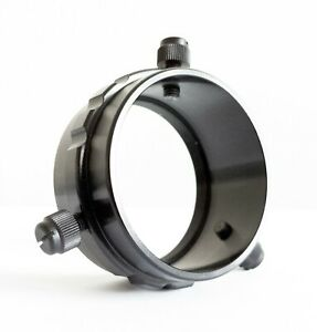

I think @Marty means that he is not able to secure it properly and make it stay perfectly horizontal.
To do that you either need to add some screws (that's why "professional" clamps have screws inside them) which will keep the adapter in place:
OR
Get a lens collar, like I suggested in the first place.
