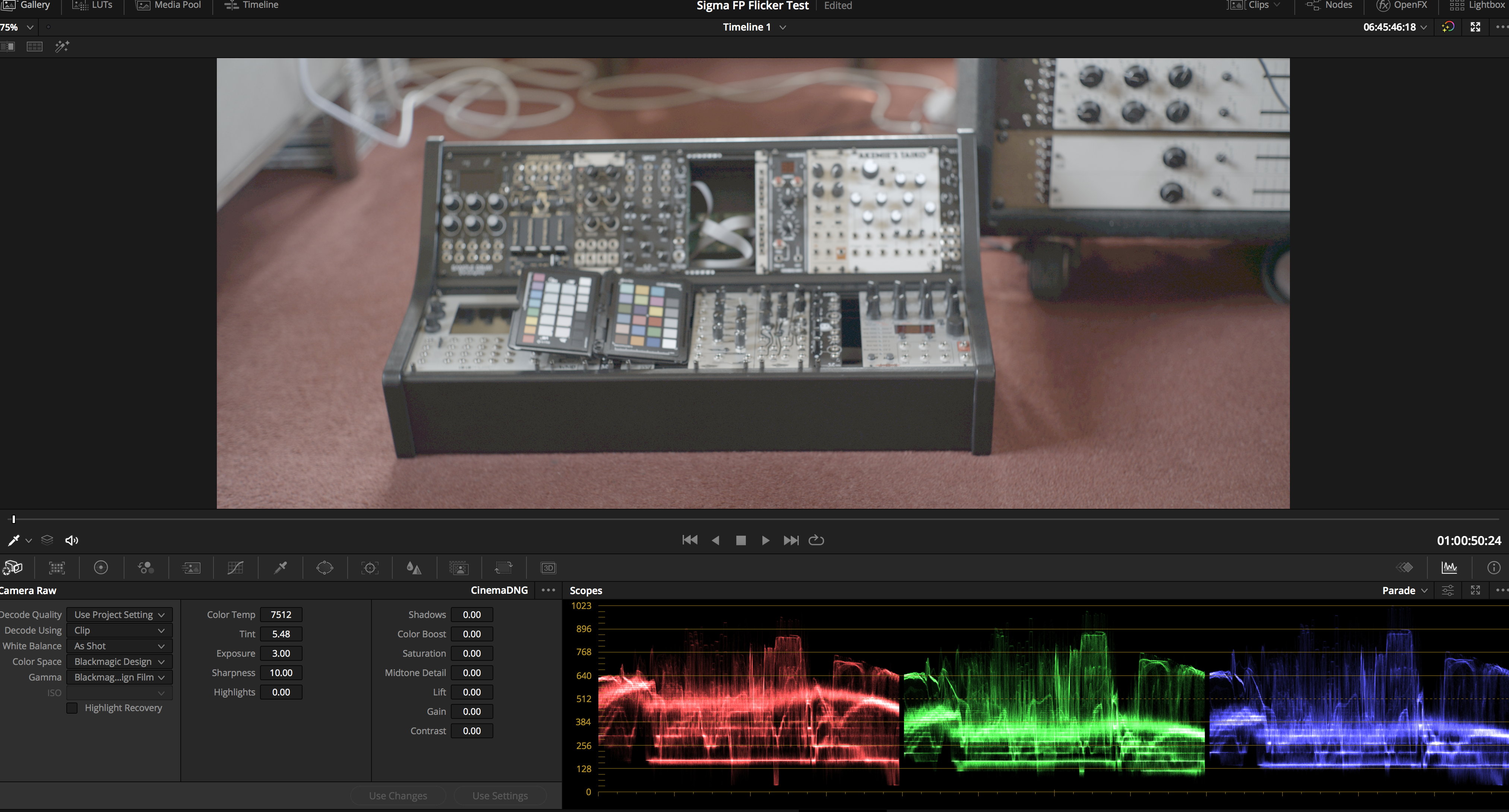

Yes, it is happening....
I shot ISO 125, 160, 250 and 320 4K UHD 10 Bit.
The first frame of every clip is about one stop brighter than the clip as a whole. This can be seen visually and with the scopes in Resolve.
I can add ISO 200 from yesterday as also having this issue. But ISO400 and 640 were clear of the issue.
