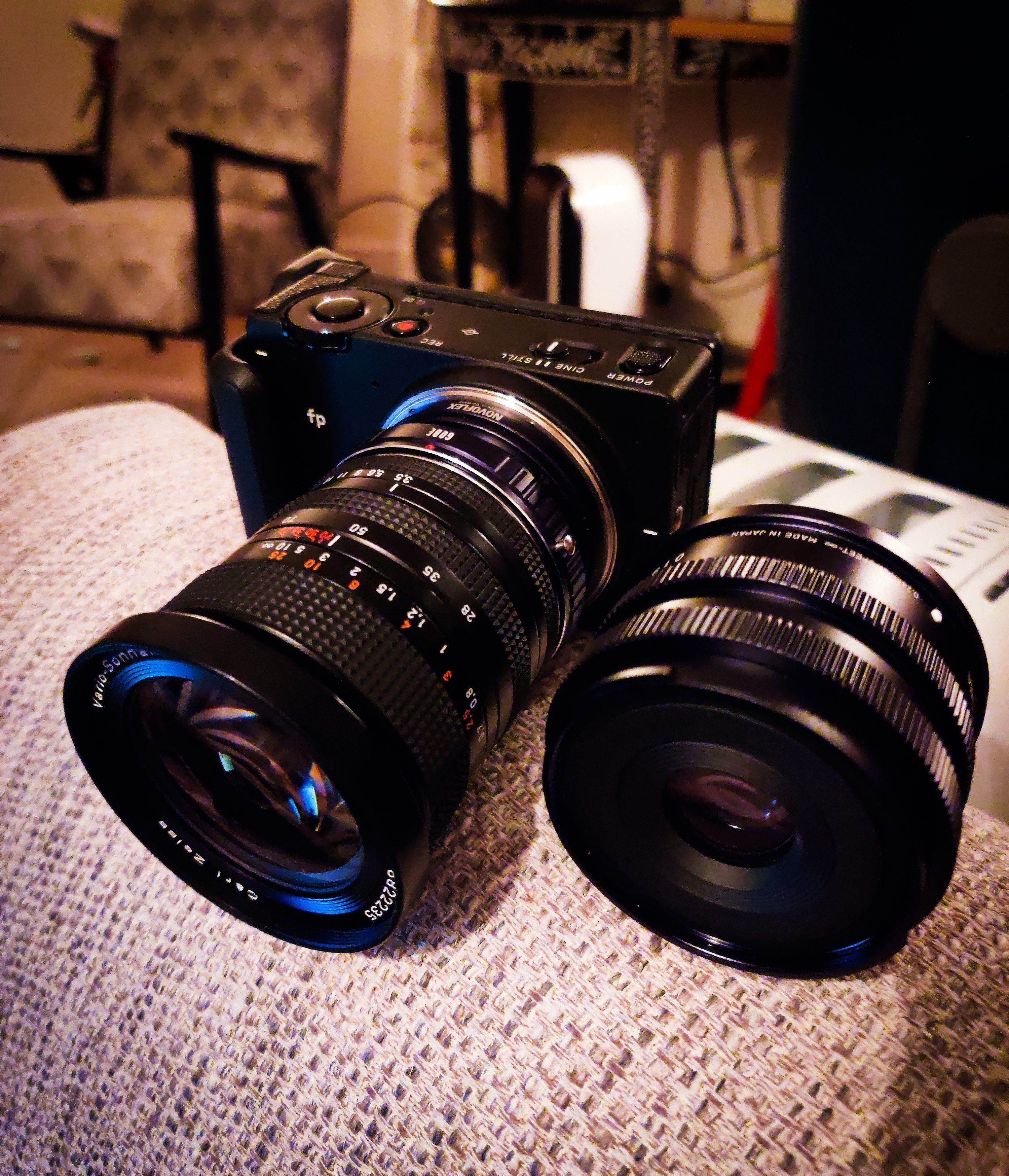

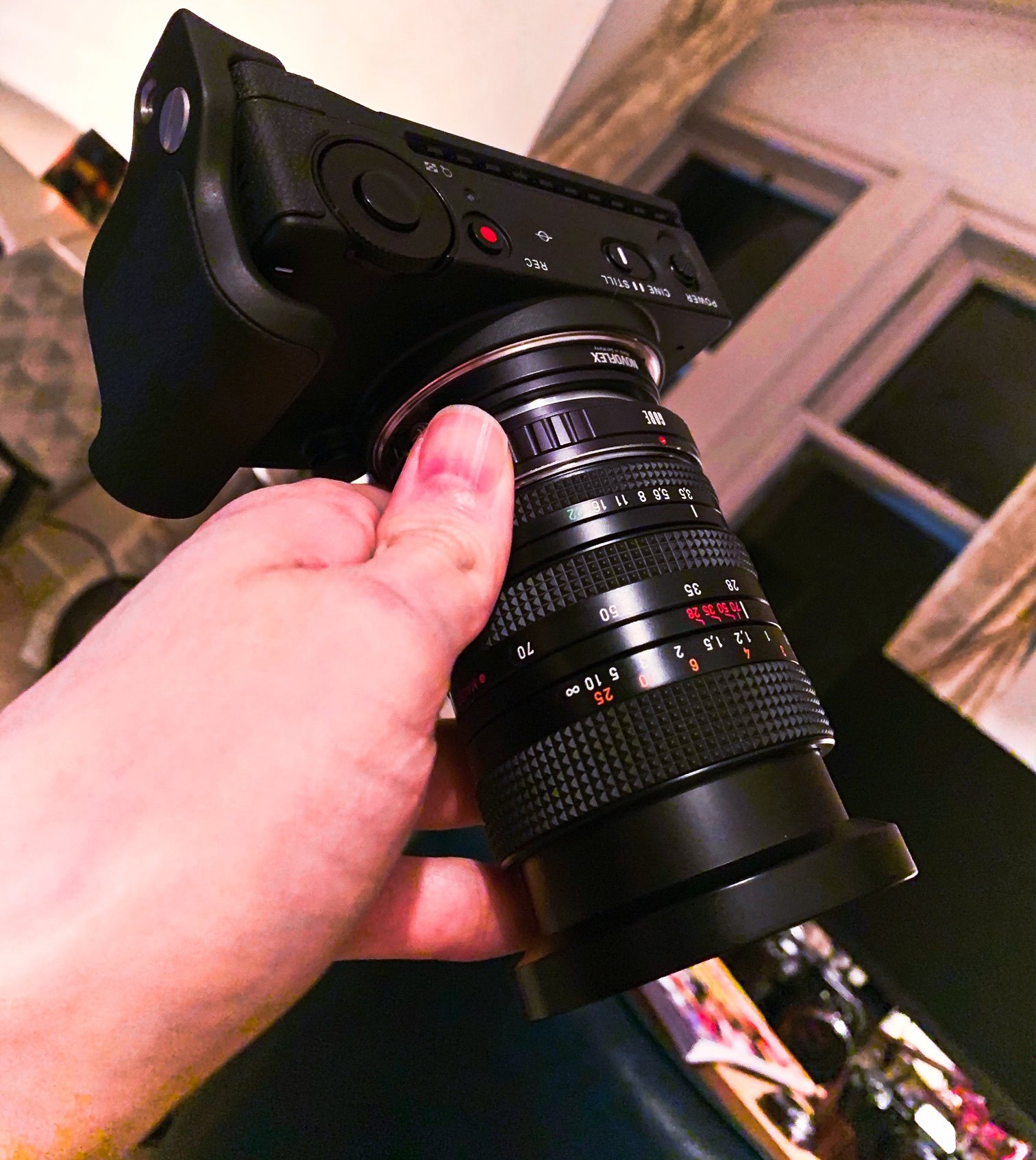

Administrators Andrew - EOSHD Posted January 18, 2020 Author Administrators Share Posted January 18, 2020 Now the good news... That Contax Zeiss 28-70mm F3.5 is a stunner, a real gem. So small and light. Almost as small as the Zeiss 55mm F1.8 FE It does not seem parfocal but it has character. Amazing macro mode too and the Zeiss look. I have quite enjoyed putting it on the Leica M AF adapter on my Sony a9 too... Autofocus it Even the Sigma 45mm F2.8 is a fatter lens. BTM_Pix and Lars Steenhoff 2 Link to comment Share on other sites More sharing options...
Lars Steenhoff Posted January 18, 2020 Share Posted January 18, 2020 Yes the zeiss lens is a keeper, I received mine today, and it's not perfectly parfocal with the adapter I use, I read somewhere that parfocal depends also on the distance to the sensor, its needs to be perfect. My copy is focussing very smooth, really happy with it. Link to comment Share on other sites More sharing options...
rawshooter Posted January 18, 2020 Share Posted January 18, 2020 I can also warmly recommend the Tokina 28-70mm/2.8 which is a bought-up and continued Angenieux design: https://cameragx.com/2018/04/11/the-truth-about-the-angenieux-28-70-af-zoom/ mercer, JordanWright and Lars Steenhoff 3 Link to comment Share on other sites More sharing options...

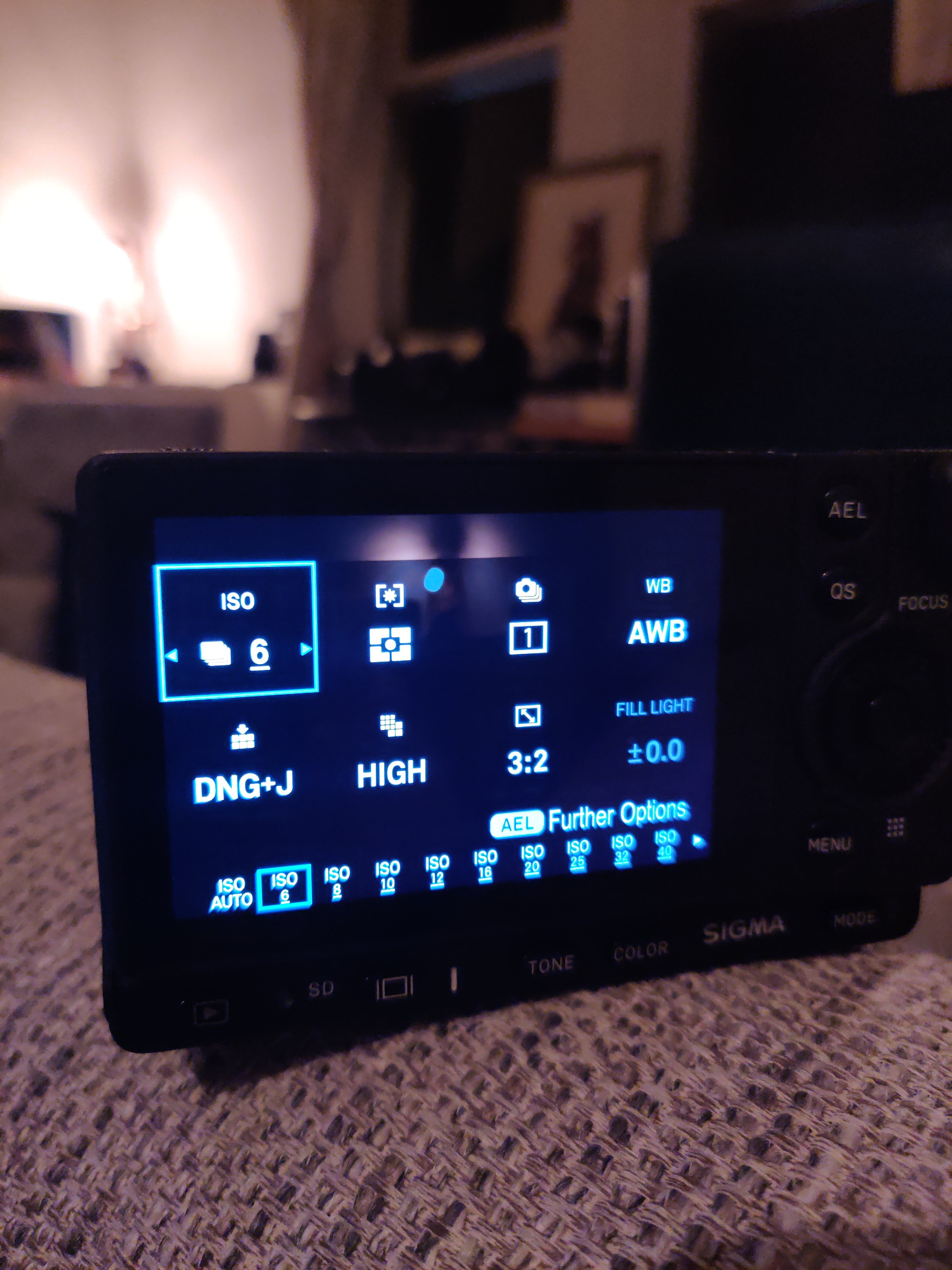

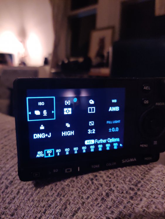

Administrators Andrew - EOSHD Posted January 18, 2020 Author Administrators Share Posted January 18, 2020 Have you checked out the ISO 6 mode yet? Would be good if they got that working in 4K... Goodbye NDs. I am working-around the M mode bug by using Auto ISO and Expo.comp, not ideal... They really need to fix that, it's fundemental stuff! Also could not get Exposure bracketing to work at all. I will just shoot stills 99% in A priority and lock exposure during a shot. Link to comment Share on other sites More sharing options...
Lars Steenhoff Posted January 18, 2020 Share Posted January 18, 2020 Iso 6 only works for stills ... and yes it would have been nice if it could be used for video. Link to comment Share on other sites More sharing options...
