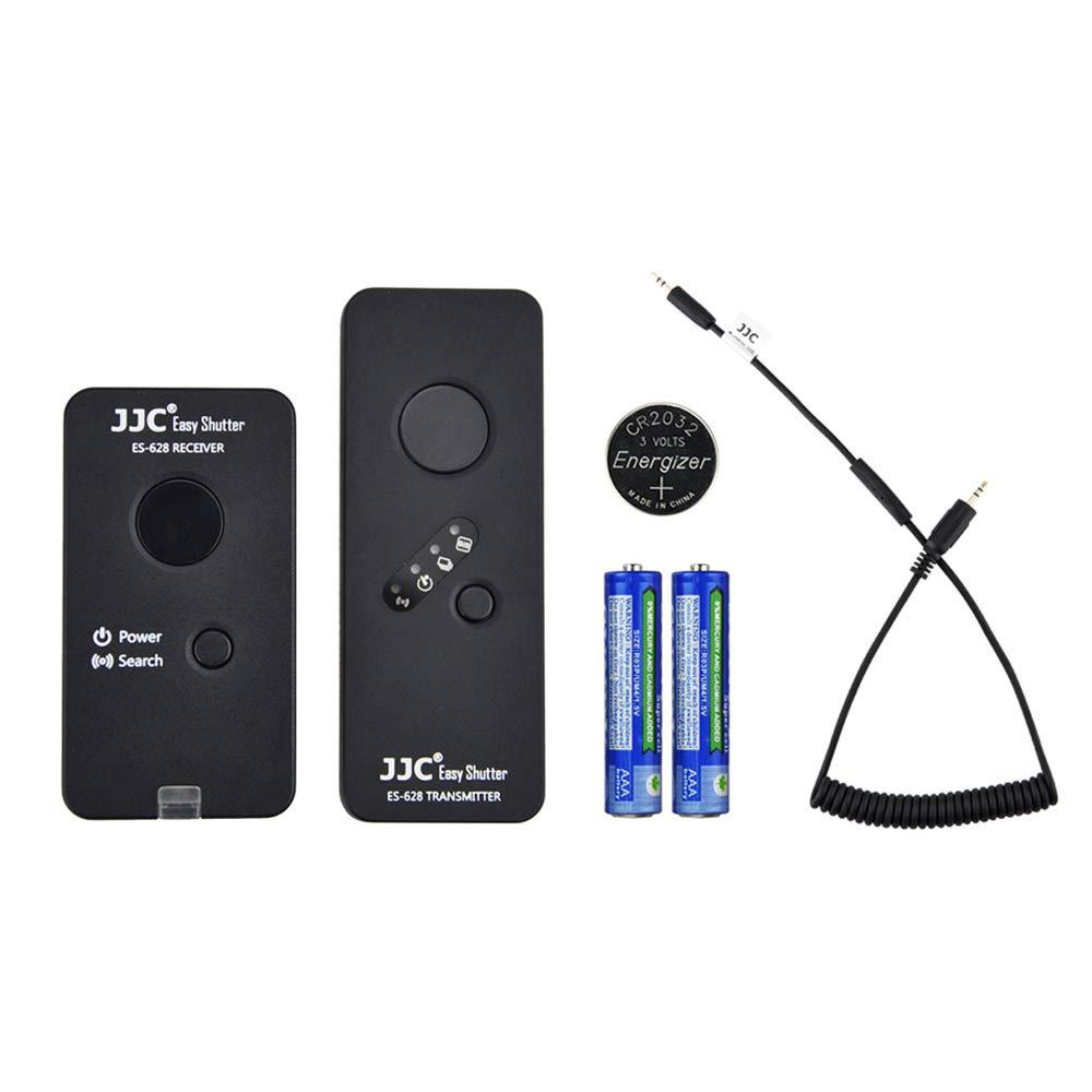

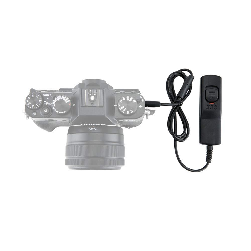

Super Members BTM_Pix Posted August 1, 2019 Super Members Share Posted August 1, 2019 Whatever happened to you trying to get a cable from Tilta ? The Fuji remote does not require any power as it gets it from the camera. I think the easiest approach for you to do is to buy one of these cheap £10.99 RR100 compatible remotes from Amazon Then crack open the handle part and take it from there as at least you will then have a fully working example to work from. https://www.amazon.co.uk/JJC-Shutter-Release-Fujifilm-Replaces/dp/B07K9VLFN2 If you want to be a bit more fancy then they do a wireless version for £21.50 that you could do the same thing with. This may well be more appropriate as you can have the handle anywhere then without running cables. https://www.amazon.co.uk/Wireless-Shutter-Release-Fujifilm-Replaces/dp/B07N5J6LZM Adam Kuźniar 1 Link to comment Share on other sites More sharing options...
thephoenix Posted August 1, 2019 Author Share Posted August 1, 2019 On 8/1/2019 at 12:45 PM, BTM_Pix said: Whatever happened to you trying to get a cable from Tilta ? The Fuji remote does not require any power as it gets it from the camera. I think the easiest approach for you to do is to buy one of these cheap £10.99 RR100 compatible remotes from Amazon Then crack open the handle part and take it from there as at least you will then have a fully working example to work from. https://www.amazon.co.uk/JJC-Shutter-Release-Fujifilm-Replaces/dp/B07K9VLFN2 If you want to be a bit more fancy then they do a wireless version for £21.50 that you could do the same thing with. This may well be more appropriate as you can have the handle anywhere then without running cables. https://www.amazon.co.uk/Wireless-Shutter-Release-Fujifilm-Replaces/dp/B07N5J6LZM Expand thanks man well the think with the wireless is that you need the receiver, so it would take more room than just a simple cable coming from the handle. for the tilta, it was for the nucleus nano, ordered the lanc cable but doesn't work i think this will be my next job to have this #"*#~& nucleus nano work with the fuji but i think it is way more complicated as the nano has his own connectors. On 8/1/2019 at 12:43 PM, Adam Kuźniar said: Literally on the same website there's a section about Fujifilm - https://www.doc-diy.net/photo/remote_pinout/#fuji AFAIK it's being powered by the camera. Also check this out - https://www.fujix-forum.com/threads/diy-x-t1-wired-remote-release-for-bulb-mode.21852/ Or just search for a "diy shutter release" Expand thanks will check that Link to comment Share on other sites More sharing options...
thephoenix Posted August 1, 2019 Author Share Posted August 1, 2019 i think this could be good too https://www.amazon.fr/JJC-Déclencheur-Connexion-Fujifilm-Appareils/dp/B07KBB288K/ref=sr_1_9?__mk_fr_FR=ÅMÅŽÕÑ&keywords=JJC+Fujifilm+X-T3&qid=1564667023&s=gateway&sr=8-9 Link to comment Share on other sites More sharing options...
