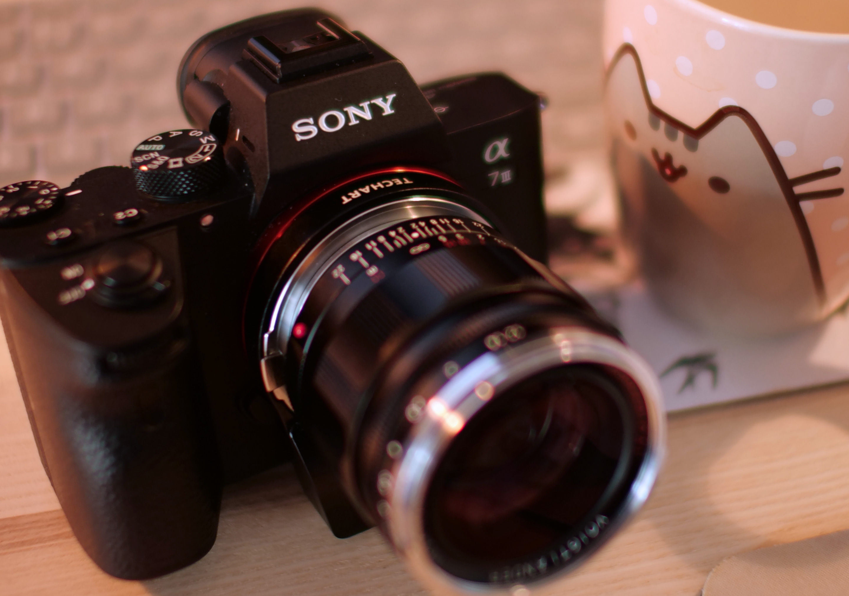

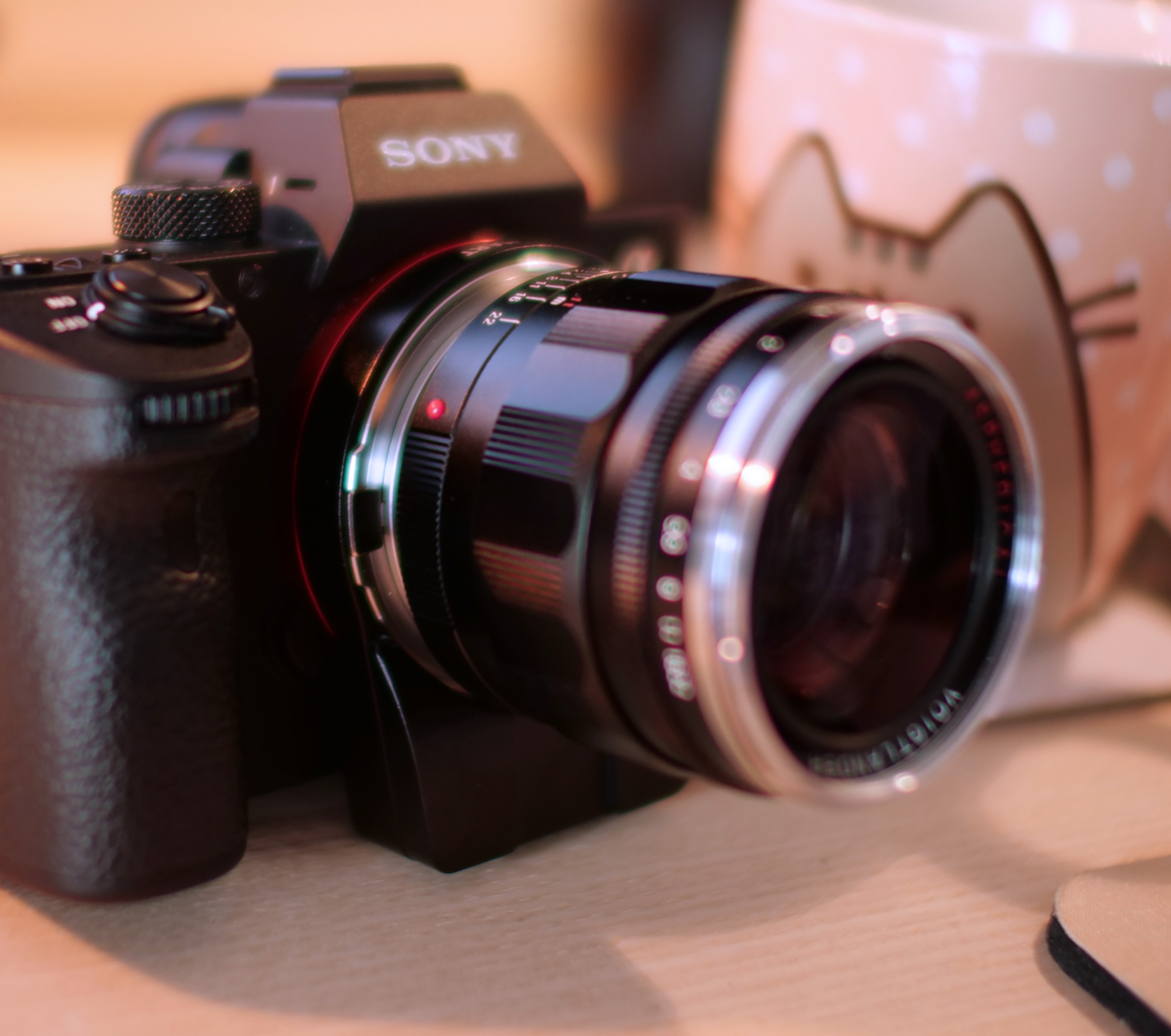

Administrators Andrew - EOSHD Posted May 29, 2018 Administrators Share Posted May 29, 2018 That would be ironic. Well it certainly saves having to buy more than one expensive autofocus adapter. Even for Nikon G glass. The TechArt is mindblowingly good for stills and AF-S... but again same limitation as the Metabones for AF-C in video mode... And it's pretty noisy. Apparently it can focus larger lenses up to 700g The motor housing is tiny, much smaller than the motorised Sony A-mount adapter. Vogitlander 35mm F1.2 autofocus anyone? BTM_Pix, jase and Inazuma 3 Link to comment Share on other sites More sharing options...
