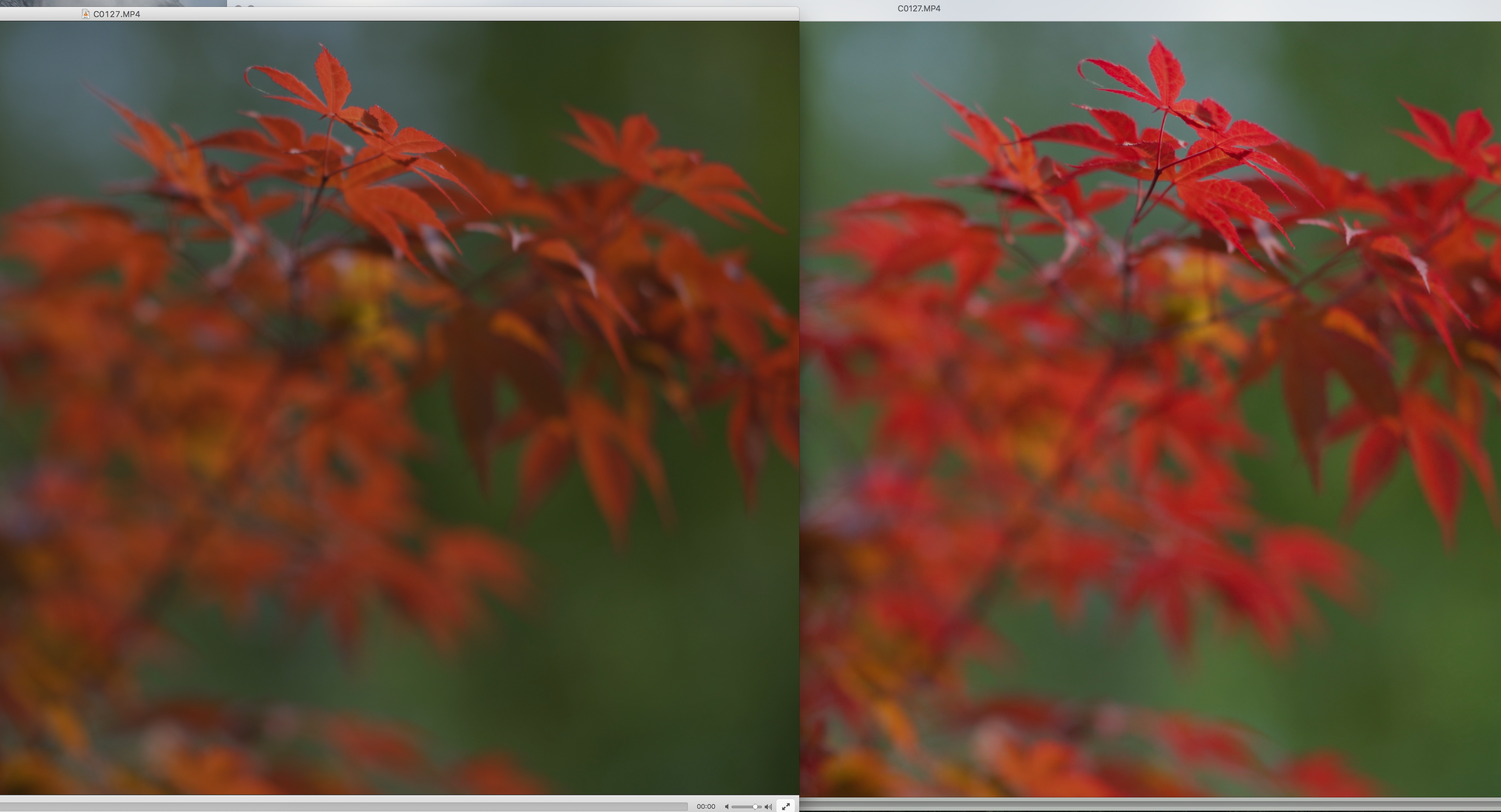

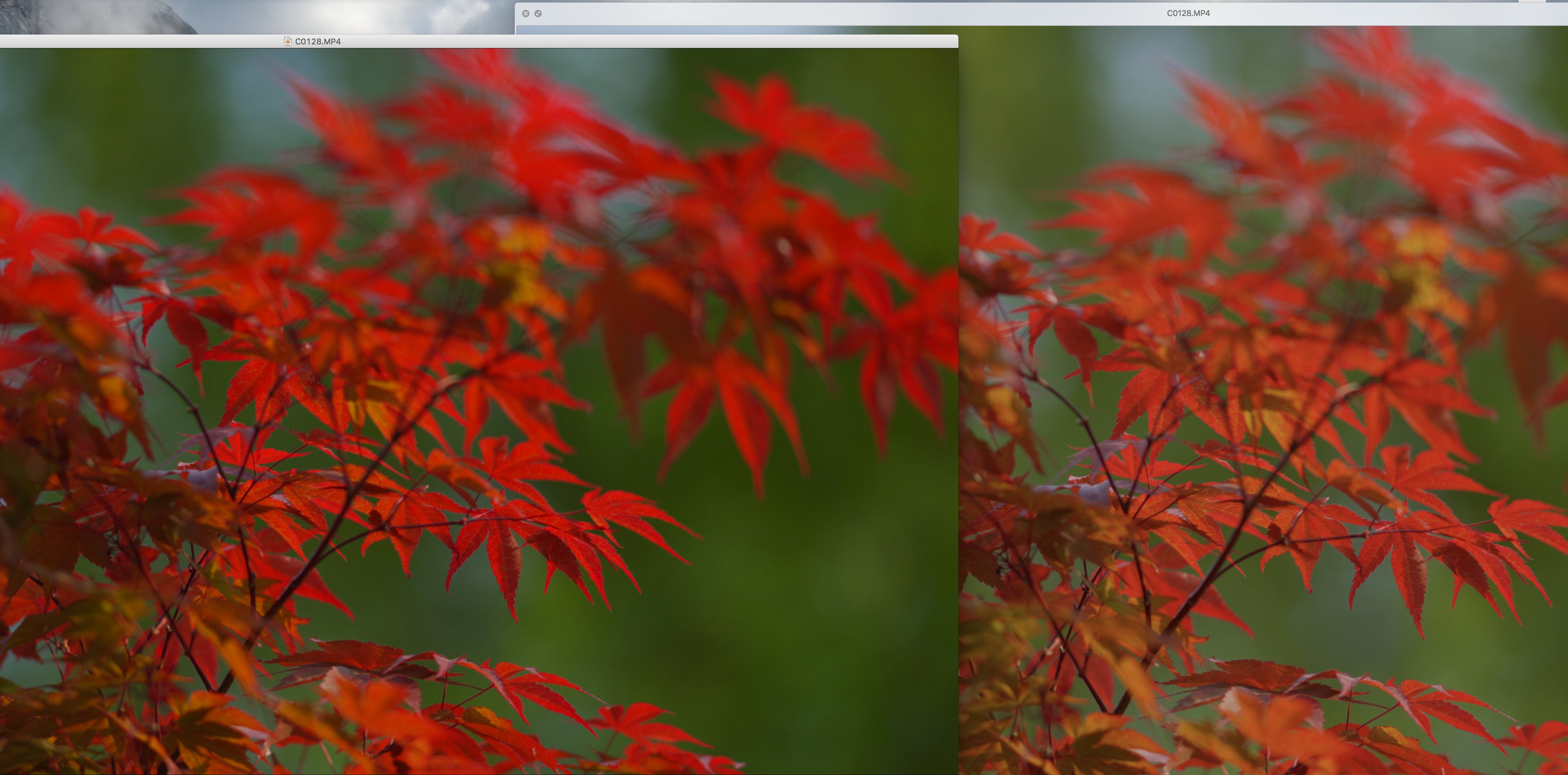

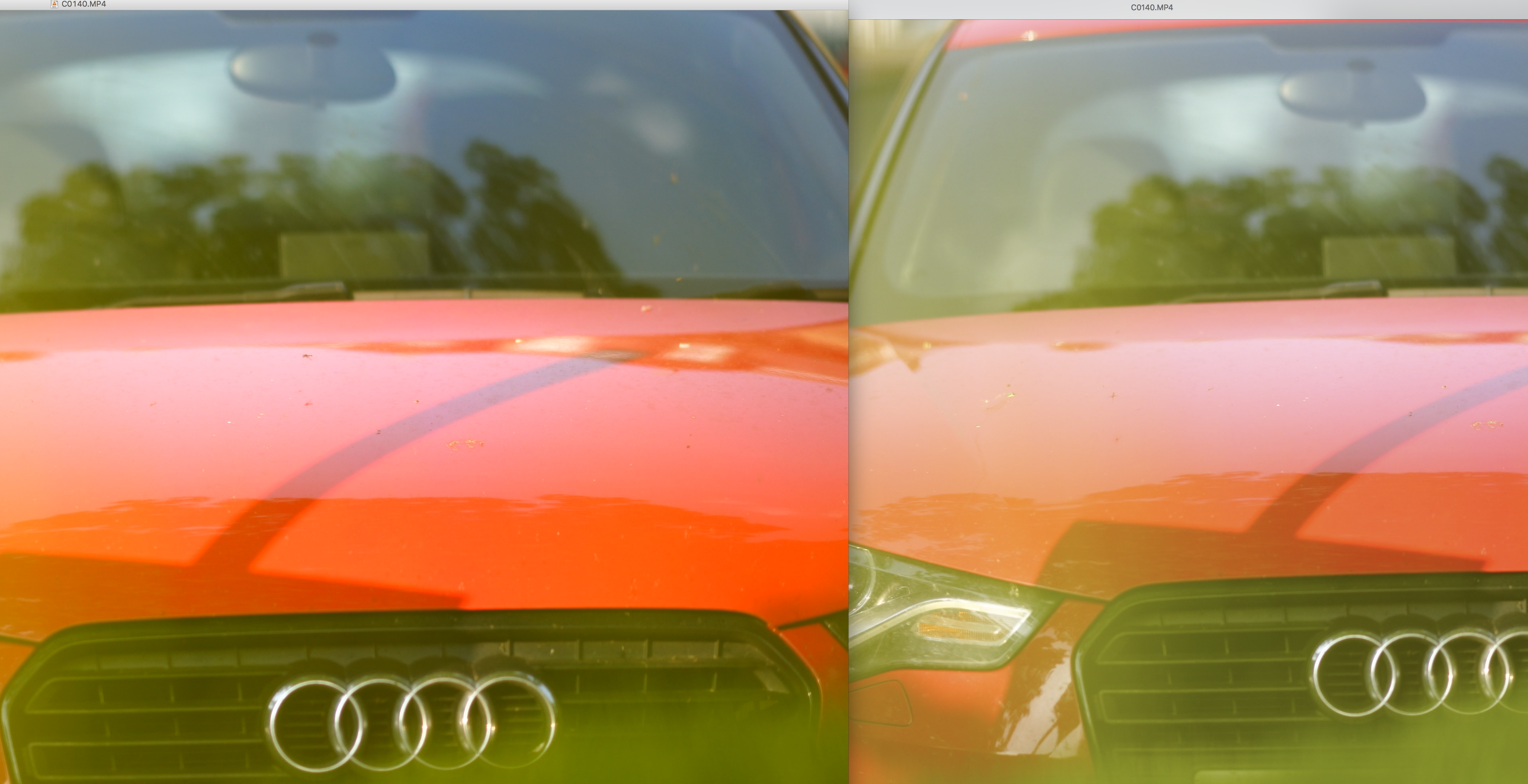

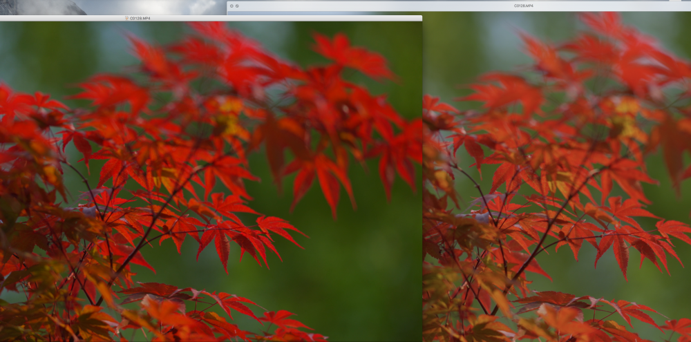

Administrators Andrew - EOSHD Posted May 21, 2018 Author Administrators Share Posted May 21, 2018 Here's a preview of what's going on... VLC Player and Premiere seem to have same result. Quicktime Player and Finder Preview have different result. Camera LCD is in a world of it's own, I'll talk about that later. VLC on left / Quicktime on right: This clip is using Rec.709 colour space in HLG. It appears desaturated in Quicktime and correct in VLC Player: This next clip is using Rec.2020 in HLG:: Behaviour is the opposite. It appears desaturated in VLC Player and more more saturated in Quicktime, which incidentally matches the camera LCD when View Assist is turned on, as if Apple is converting the colour to rec.709 in Quicktime without telling us. The following clip is using S.Gamut 3 Cine as per my new EOSHD Pro Color settings: It is a shot through some grass but you can still see the differences especially to red balance. VLC Player has the punchy, correct colour. Quicktime is desaturated and shifted to orange. So be very careful when setting up colour on your camera, as what you see might not be what you get. By the way, Quicktime changes based on what Color Profile you have selected in MAC OS Display Control Panel. Therefore if the display profile and camera colour space are mismatched, you get the wrong colour in Finder, preview, thumbnails and Quicktime Player. VLC and Premiere do not change and seem to maintain the format of the file. This is stupid behaviour by Quicktime because if you record a mixture of clips with different colour spaces, you cannot keep changing your display profile in MAC OS to match each clip (i.e. Rec.709 if you record in 709, or Rec.2020 if you are using Hybrid LOG Gamma)!! kaylee 1 Link to comment Share on other sites More sharing options...
Deadcode Posted May 21, 2018 Share Posted May 21, 2018 Im using High Sierra on Hackintosh and it seems like the VLC player is not using the monitor calibration profile. It's like sRGB Default profile hardcoded... Quicktime is using the monitor calibration but with a little gamma lift (1.9 gamma maybe?) You should check your footage in Davinci Resolve. In the Perferences menu try it with "use monitor calibration" (Quicktime look) and try without it (VLC look) Advice 1.0: You should try the following in Davinci: in the color panel add a Color Space transform node and transform your REC2020 to REC709. If it matches to the image in quicktime, then yes, it shows you REC709 version of the footage without permission. Advice 2.0: upload the out of cam HLG footage to youtube, and check it on your phone. It will shows correct HDR image with P3 Gamut. (you have iPhone X if i remember correctly) If you watch your REC2020 HLG files on youtube on a regular REC709 display, you will see a REC709 version of it with gentle highlight roll-off. The colors will look like the same as it was in Quicktime. Edit: check youtube in Safari, Chrome on desktop and in app / safari on phone if you want total confusion :D There will be some differences... So in which app should we trust? :D i trust in the scopes.... Link to comment Share on other sites More sharing options...
Administrators Andrew - EOSHD Posted May 21, 2018 Author Administrators Share Posted May 21, 2018 It is wrong for Quicktime to be applying the monitor profile to the video file. It should be remapping the video file to your monitor profile, not imposing the display preferences onto the video file, causing the colour to shift. EthanAlexander 1 Link to comment Share on other sites More sharing options...
Deadcode Posted May 21, 2018 Share Posted May 21, 2018 27 minutes ago, Andrew Reid said: It is wrong for Quicktime to be applying the monitor profile to the video file. It should be remapping the video file to your monitor profile, not imposing the display preferences onto the video file, causing the colour to shift. It is remapping the video file to your monitor profile. Playing back REC2020 content as REC709 is the way the HLG implemented to be backward compatible on older displays, so quicktime is actually working as it should be. VLC has some serious color management problems. Open VLC player play a video file, and while playing change the monitor calibration profile to whatever you want. It does not affect the image in VLC which is a shame... Link to comment Share on other sites More sharing options...
Administrators Andrew - EOSHD Posted May 21, 2018 Author Administrators Share Posted May 21, 2018 What's even more stupid on Apple's part is that by default FCPX now adjusts the gamma curve of Hybrid LOG Gamma footage so that effectively it is automatically grading your image. You have to go into the settings and set "Show HDR As Raw Values"! 12 minutes ago, Deadcode said: It is remapping the video file to your monitor profile. Playing back REC2020 content as REC709 is the way the HLG implemented to be backward compatible on older displays, so quicktime is actually working as it should be. It is not working as it should be because the colours are fucked. Premiere is fully representative of the original material as I shot it. Quicktime and FCPX change the gamma curve and colour to convert the Hybrid LOG Gamma material to the final graded HDR image... Which isn't much good if you are using Hybrid LOG Gamma as a flat image profile to manually grade or apply your own LUT. Geoff CB 1 Link to comment Share on other sites More sharing options...

EthanAlexander Posted May 22, 2018 Share Posted May 22, 2018 Andrew, I think this has more to do with the P3 display on your iMac than the OS or camera. I've got one and it's been very frustrating because of the inconsistency: Sometimes even inside of FCPX itself, the footage will be displayed differently whether on a timeline or in the browser, even when the project and library are set the same. Your first example is definitely an instance where the video is not being properly remapped to the display gamut, but it could be because of the mismatch with rec709 which doesn't traditionally go with HLG. So I think what it's doing is treating it like 10 bit footage on a rec709 display with no remapping. (Just like an RGB JPEG displayed on an sRGB display looks washed out.) 6 hours ago, Andrew Reid said: This clip is using Rec.709 colour space in HLG. It appears desaturated in Quicktime and correct in VLC Player: The second example I think is actually an instance where VLC is the one getting it wrong and preview is getting it right, since 10 bit footage should look really good on a P3 display. I don't think it's converting it to rec709 without telling you: 6 hours ago, Andrew Reid said: next clip is using Rec.2020 in HLG:: I'm not sure though - that's just my take. I find the whole thing frustrating though, I'll tell you that. We've got this incredible 5K display that's capable of displaying insane color and contrast and we're left dealing with unreasonable inconsistency and headache! kaylee 1 Link to comment Share on other sites More sharing options...
