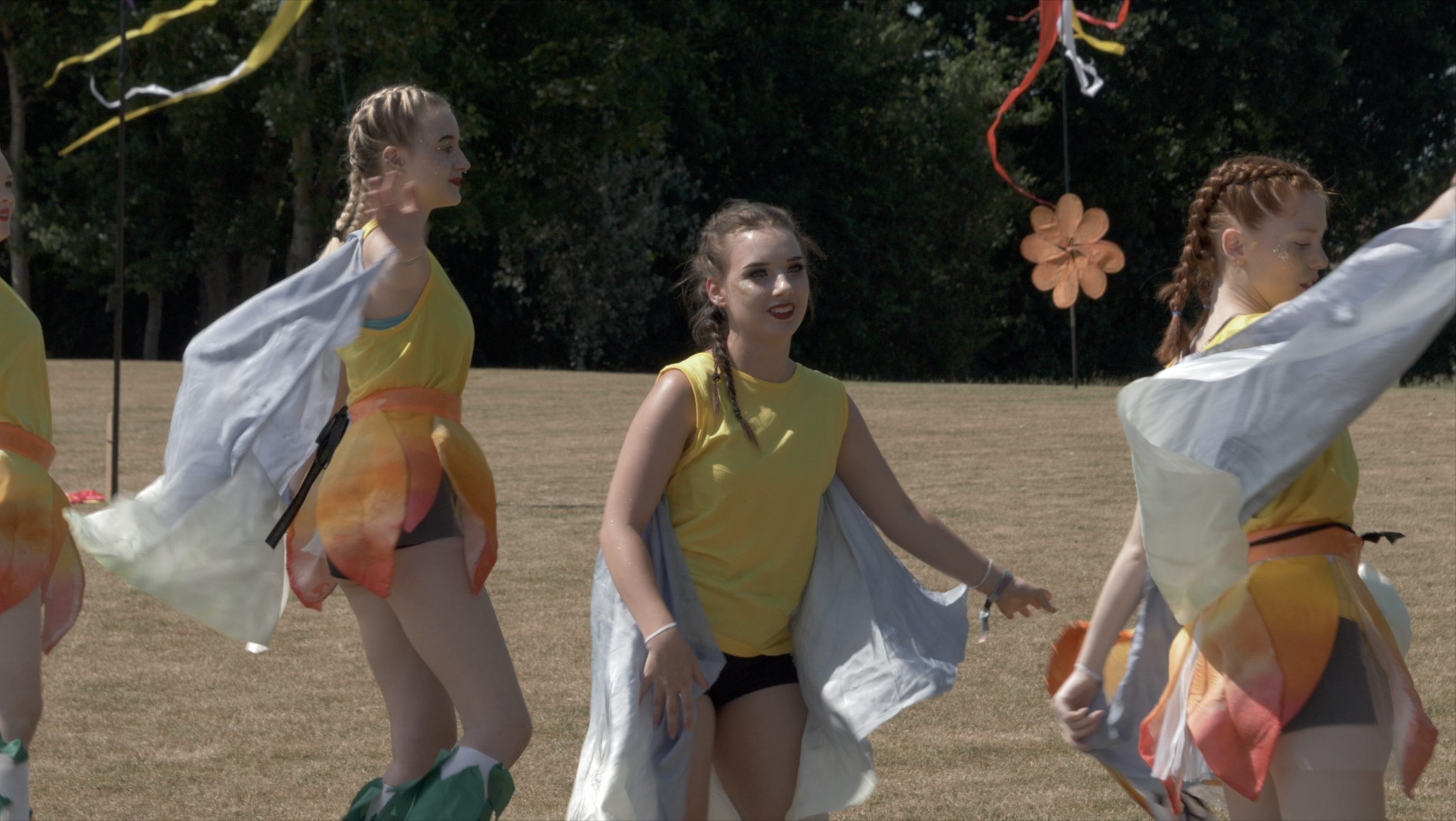

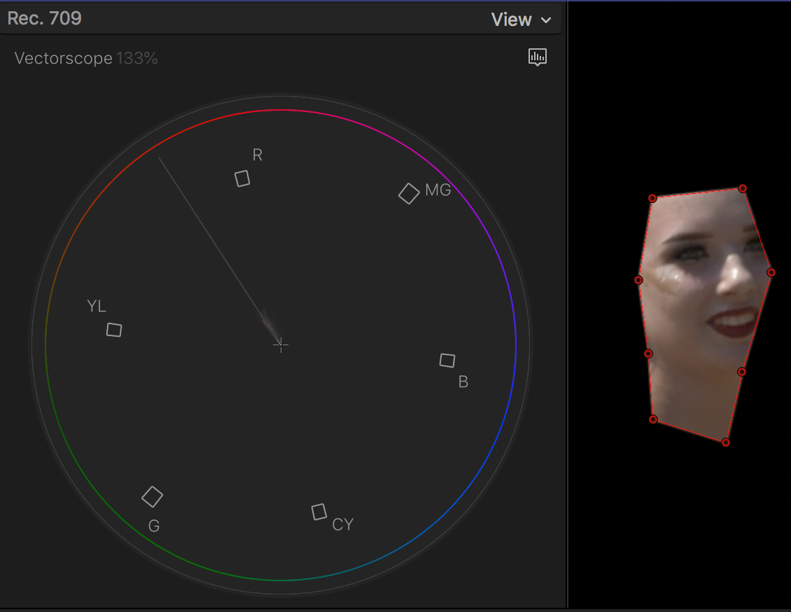

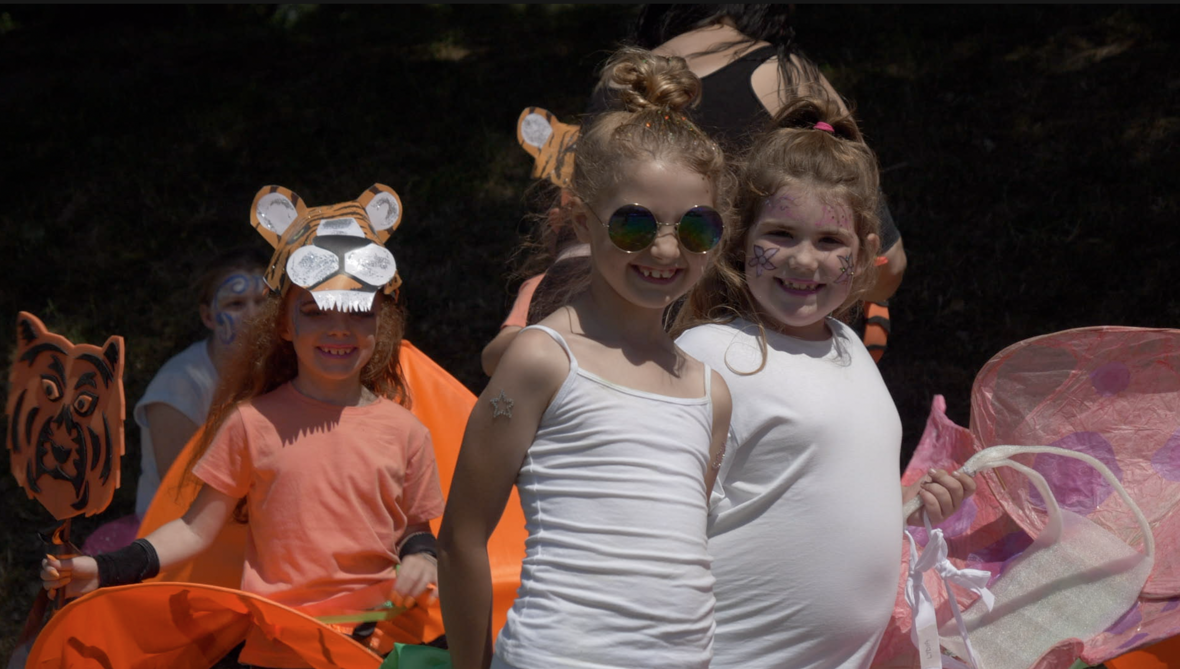

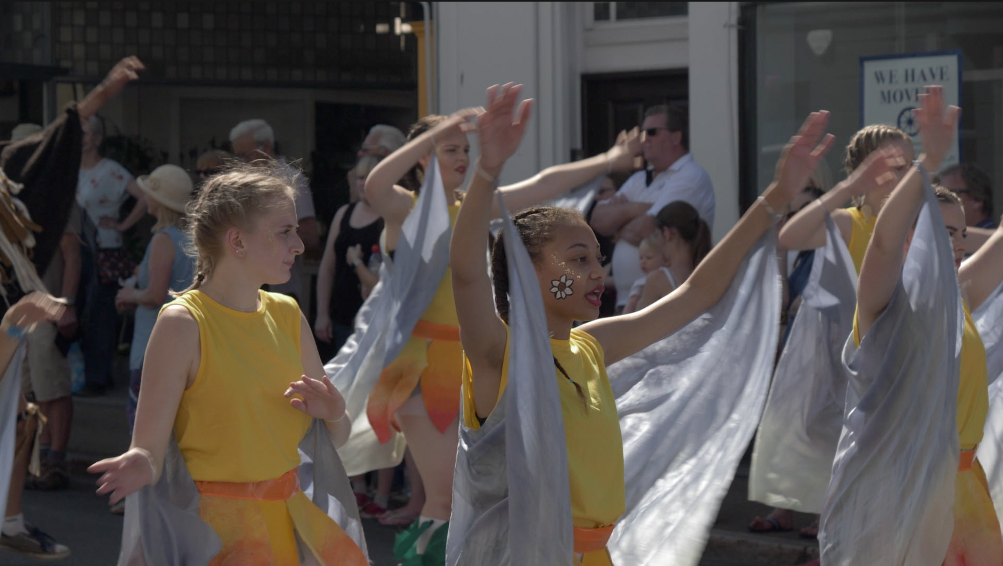

Hi fuzzynormal,
How do you get such a wide aperture (0.95) with your VND?  This weekend I shot an outdoor carnival event in the mid-day sun.  With my 12-60/f2.8-4 and Heliopan 0.3-1.8 (six-stop) VND I was at around 50% to 2/3 strength on the filter.  By the way, I liked the promo above.  Pretty nice, smooth movement despite using only the GH5 IBIS.  Do you notice much difference between the GH5 stabilisation and your old E-M5ii?
I've been going back and forth between using a fixed breakthrough photography 3 or 6-stop filter with xume magnets, and the heliopan VND.  The breakthroughs definitely seem to have more life in the shots and good colour, but you need to vary the aperture to get the right exposure. The VND definitely makes the image (especially people) look flatter or more "matte".  I've been thinking of trying those new aurora VND on kickstarter as they go a little bit darker and maybe I can get away with larger-aperture primes.
Always tradeoffs, as I wish the 12-60 had a wider aperture on the long end for easier shallow depth of focus.  I used to like using the 35-100/2.8, for events but sold it with my second GX80 and bought a used GH5+12-60 to try and do it all with one camera.  Maybe next time, I'll be brave like you @fuzzynormal and shoot the whole event with my 15/1.7 or 25/1.4 and rely on the GH5 4k ETC mode + 4k->1080p cropping in the edit to get more range...
I've only just started editing, but I think that the Heliopan VND is keeping the colour quite true.  I shot Cine-D with either auto WB or "sunny" and applied the Leeming LUT as a start.  The vectorscope shows fairly good skintones.  (Although I can only go by scopes as I'm colourblind).  I think that I might push the saturation a bit and see if the colours of the costumes pop a bit more...
Any suggestions would be highly appreciated!
