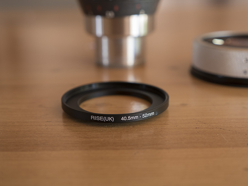

fabutch Posted April 8, 2017 Author Share Posted April 8, 2017 Thanks! Yes the focus ring is not so smooth. Maybe with time it will loosen up. There is a little allen wrench provided, maybe it's for loosening it up. The focus throw is a little short but we get used to it. It remains perfectly manageable. I attached it to the Moller with a step-up ring 40.5mm to 52mm, fits perfectly. Overall I'm very satisfied, build quality is very good and I'm very pleased about the picture. Quote Link to comment Share on other sites More sharing options...

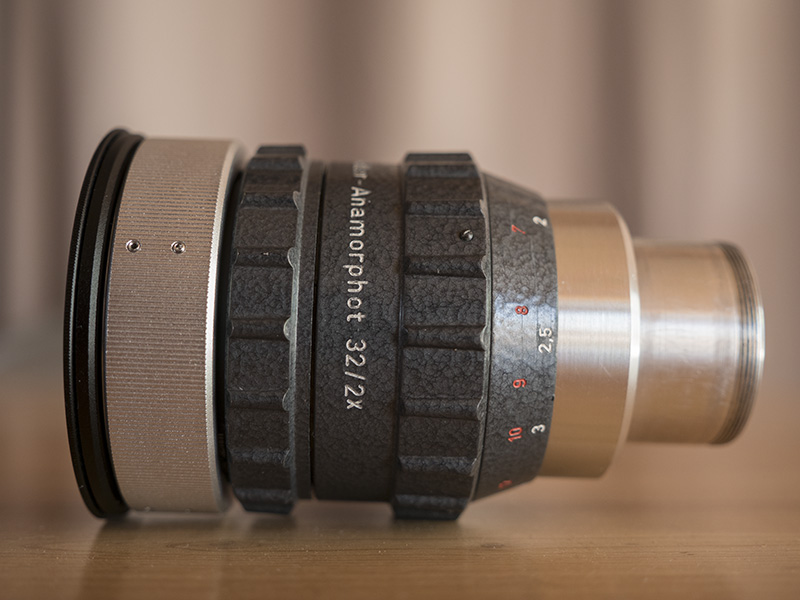

fabutch Posted April 20, 2017 Author Share Posted April 20, 2017 Sure, here is the focuser8 mounted to the Möller with the step-up ring 40.5mm to 52mm Timotheus 1 Quote Link to comment Share on other sites More sharing options...

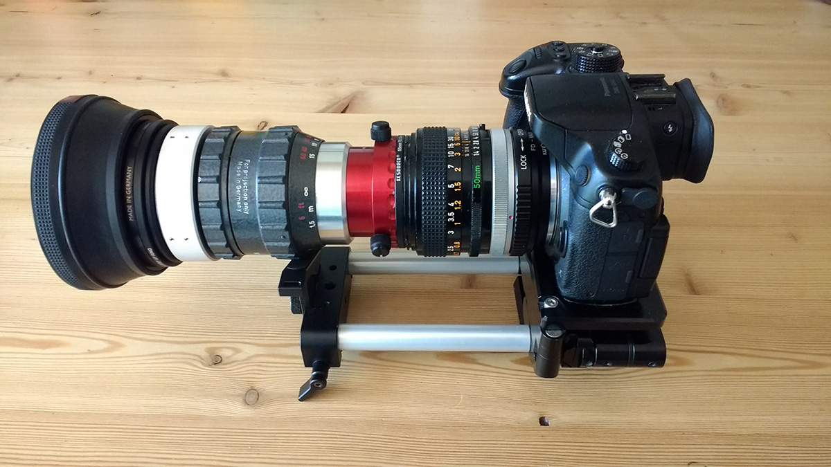

fabutch Posted April 20, 2017 Author Share Posted April 20, 2017 Yes, the 40.5 just screws right on to the Möller. I use a redclamp. Here is the rig I used for the footages... Gh4 - Edelkrone Pocket rig on lens support - M43 to canon FD - Canon FD 50mm 1.4 -55mm to 52mm - red clamp - Möller - 40.5mm to 52mm - Focuser8- 67mm to 72mm - BW nd filter - lens hood funkyou86, nahua and Timotheus 3 Quote Link to comment Share on other sites More sharing options...
