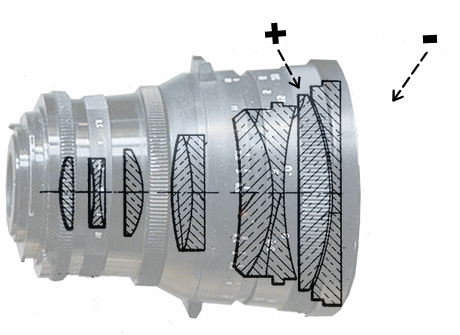

Dr. Verbel' Posted November 17, 2016 Share Posted November 17, 2016 2 hours ago, Laquaglia Punto Ernesto said: Are there any link to any DIY front element mods? Thanks I maded, but not yet create good body for single focus. and bad diopter. but working! scheme as on the gif. Link to comment Share on other sites More sharing options...
