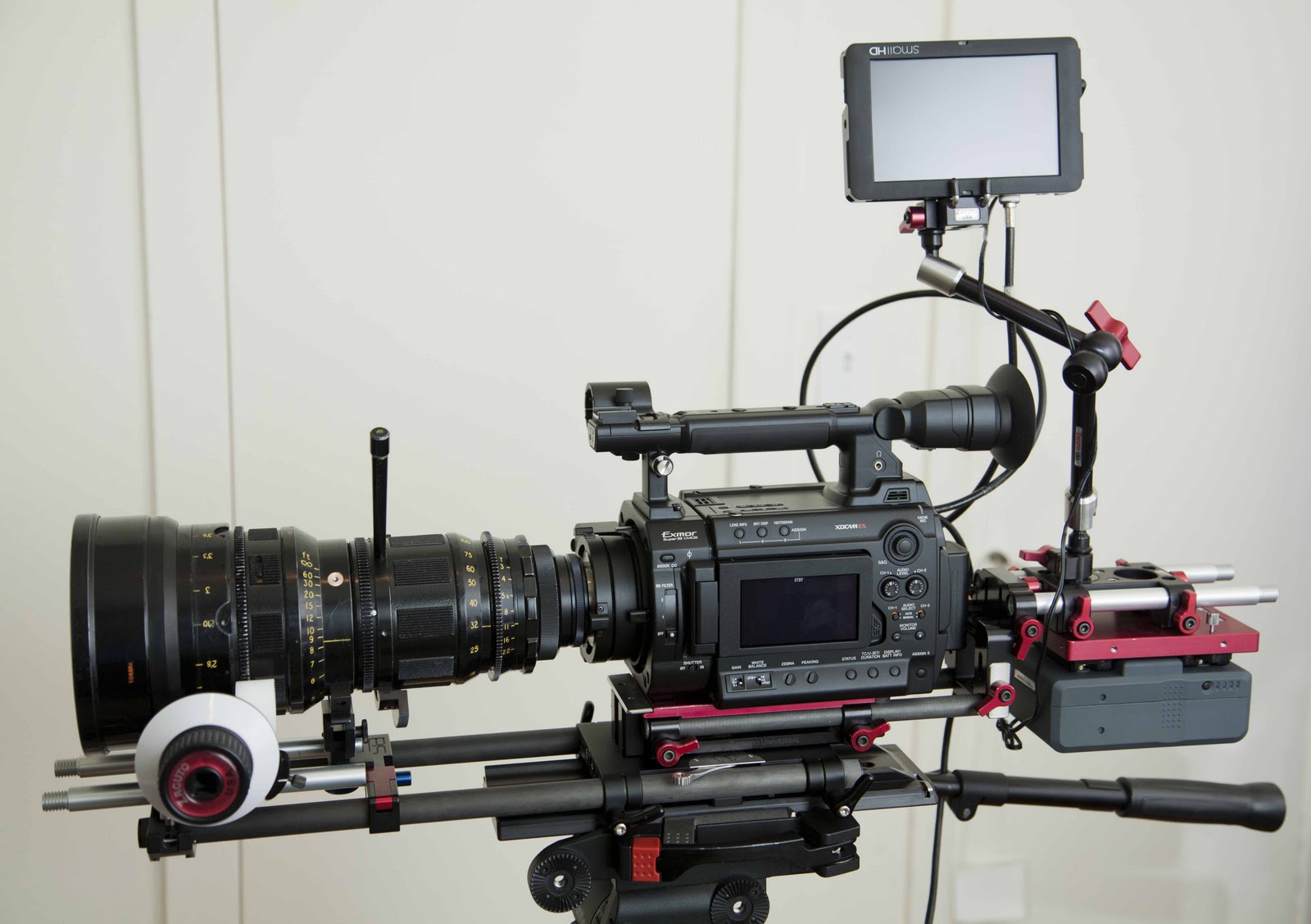

IronFilm Posted July 26, 2016 Share Posted July 26, 2016 3 minutes ago, dhessel said: Yes it is big and fairly heavy but not as heavy as I thought it was going to be. I own one that I use with my F35 beautiful lens but definately not run and gunning with it. It also has a interchangeable mount design so it can be easily changed from PL to EF, etc... Oops, just realised I put a pic of a Cooke Varotal 18-100 T3, but it seems the one you're referring to is a similar size anyway? Hanriverprod 1 Link to comment Share on other sites More sharing options...
dhessel Posted July 26, 2016 Share Posted July 26, 2016 11 minutes ago, IronFilm said: Oops, just realised I put a pic of a Cooke Varotal 18-100 T3, but it seems the one you're referring to is a similar size anyway? Yes they are basically the same size, the 18-100 is the newer design of the same lens. It is a little bit sharper, so I am told, and considered a better lens but it goes for around $9000-$10000. I believe the 20-100 is about 14" long, has a 144mm front and weighs about 10.5 lbs. It has a min focus of a little over 2 feet so it can be used for closups on the long end. It is decently fast and has a slot for rear filters if you find one that still has the filter holder. It is a fantastic lens, if you can handle the size. Hanriverprod 1 Link to comment Share on other sites More sharing options...
