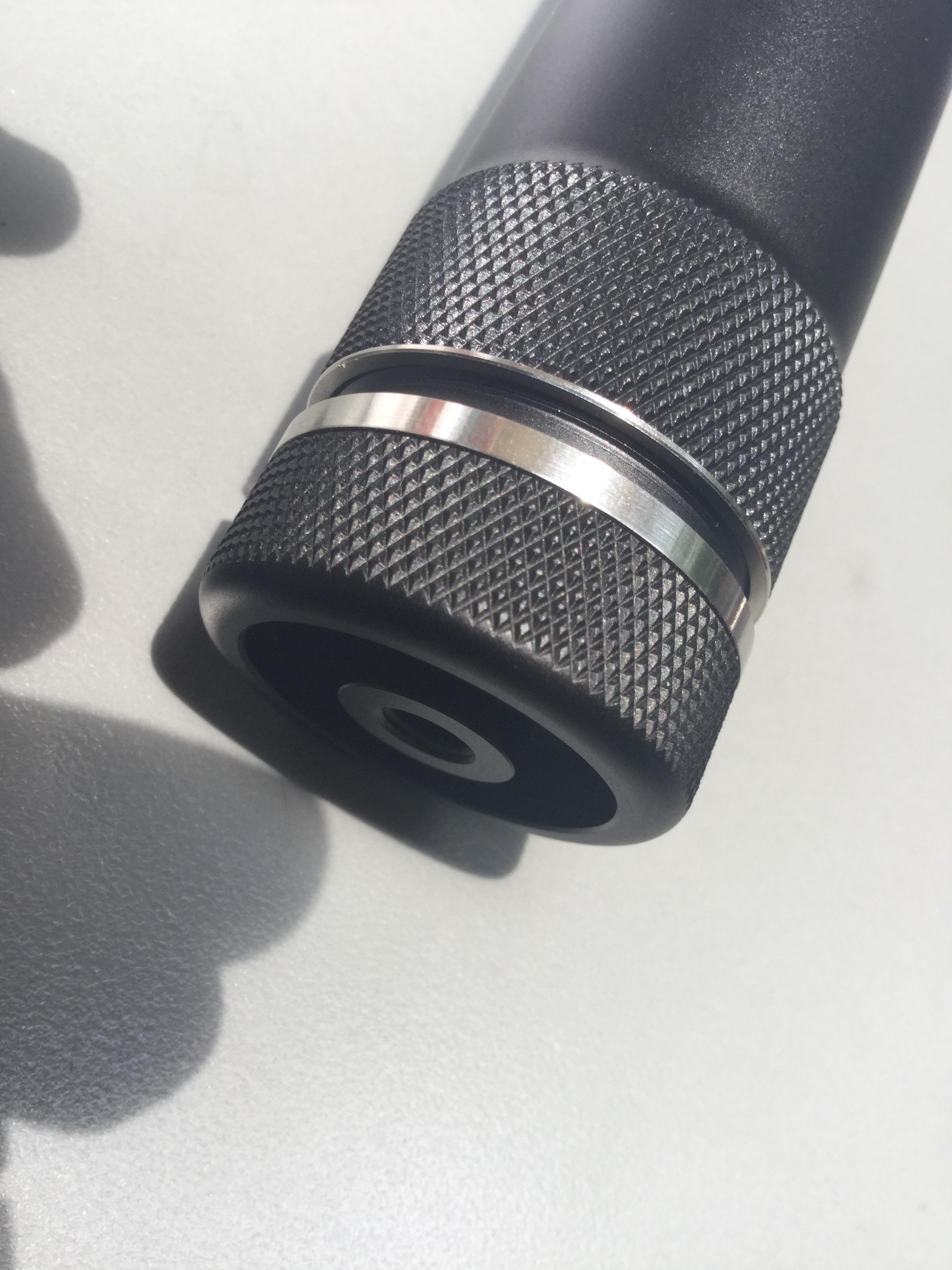

jonpais 0 Posted April 2, 2017 Share Posted April 2, 2017 Not sure if anyone's experienced this, but the other day, my Crane would keep shutting off on me. The battery was fully charged, the blue light would blink four times, and after a minute or so, it would turn off. I tried loosening then re-tightening the handle, which worked for a bit, then the same problem. This morning, I discovered that the cap on the bottom of the handle was loose! Problem solved. ? Quote Link to post Share on other sites
Axel 666 Posted April 2, 2017 Share Posted April 2, 2017 Good to know, thanks. jonpais 1 Quote Link to post Share on other sites
