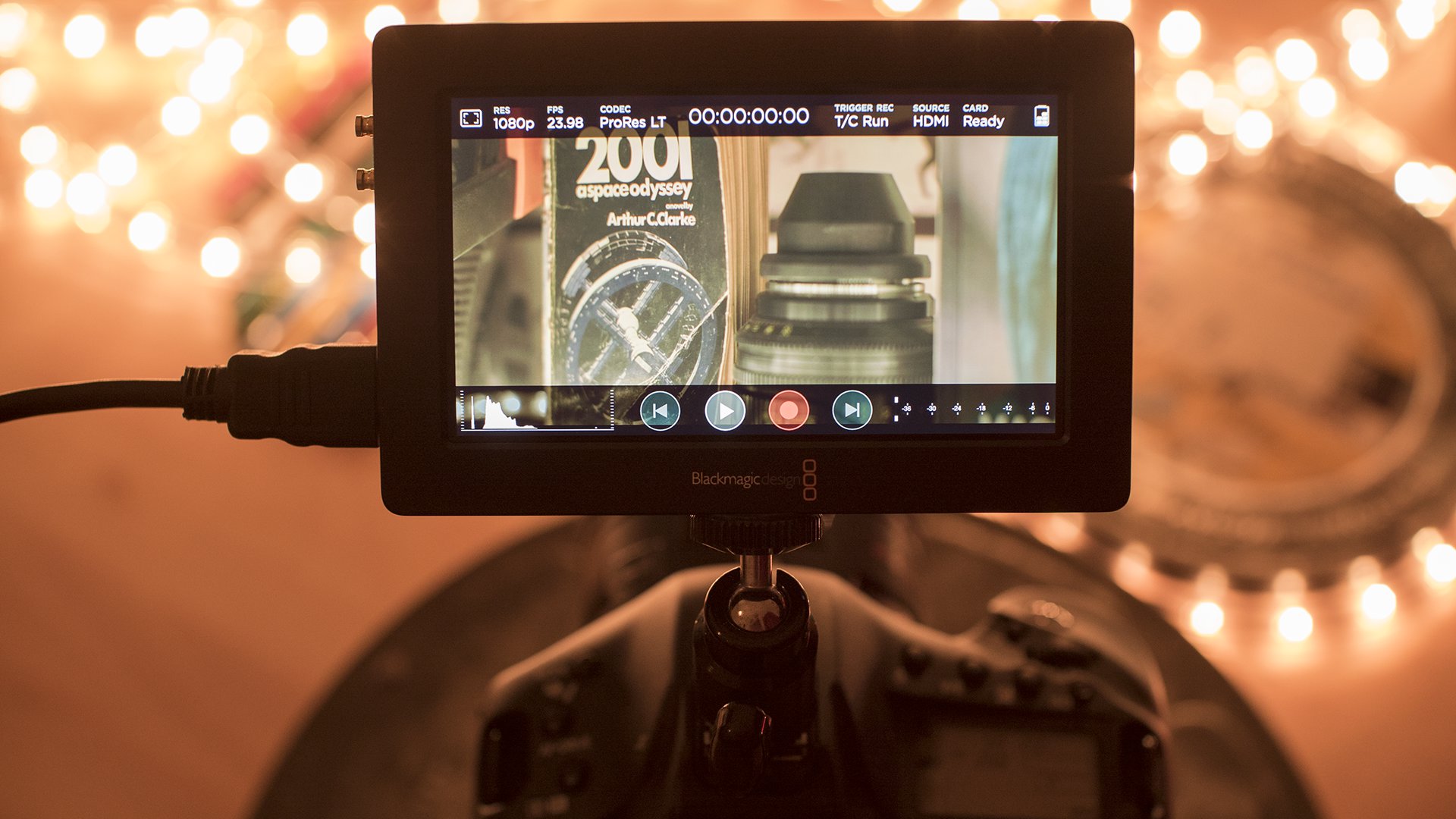

Administrators Andrew Reid 10,307 Posted November 12, 2015 Administrators Share Posted November 12, 2015 Out of the blue Blackmagic sent me the new Video Assist, which isn't quite yet shipping at B&H (pre-orders are available) or CVP but will be soon.Here is an early look at the device and what it can do.Read the full article Zach Ashcraft and Christina Ava 2 Quote Link to post Share on other sites

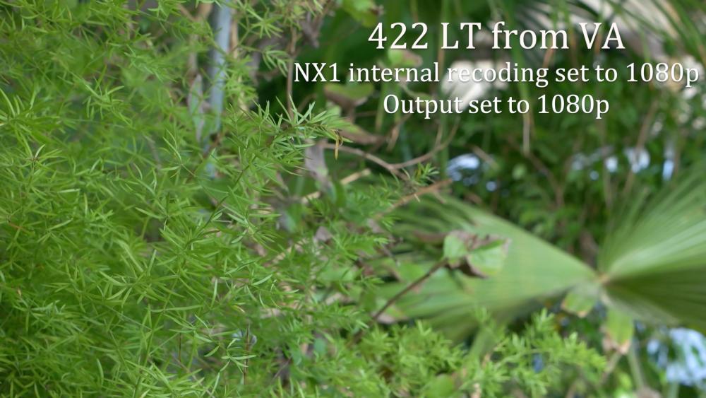

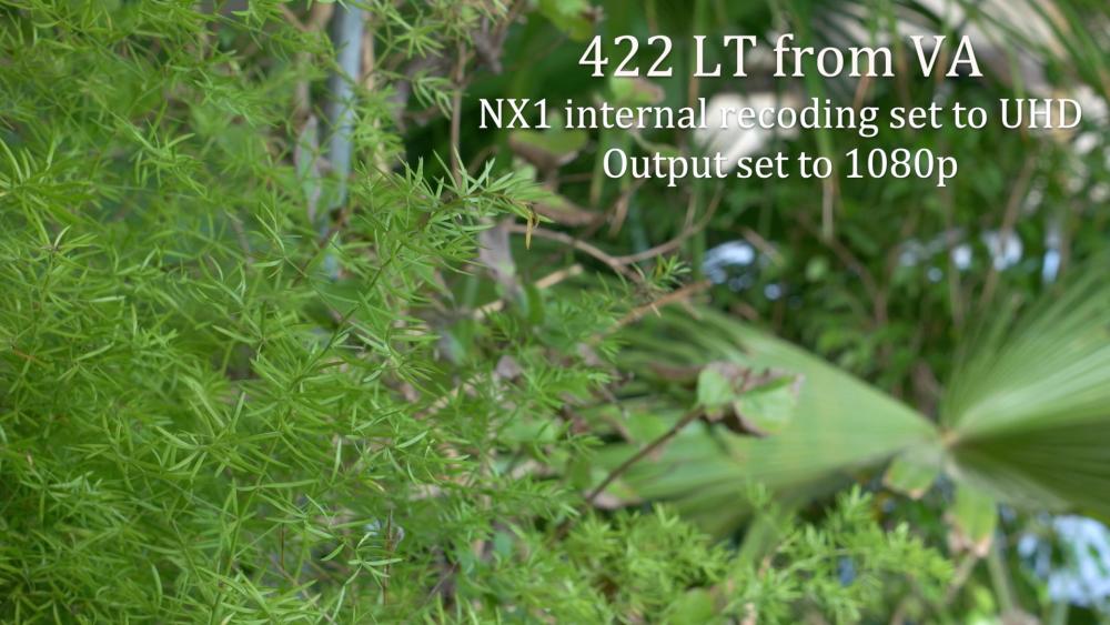

Administrators Andrew Reid 10,307 Posted November 12, 2015 Author Administrators Share Posted November 12, 2015 I've yet to test my NX1 with my Ninja Blade, but have you tried a 4k output downscaled to 1080p with the NX1? I'm sure it does 8bit 4:2:2 out of its HDMI port, so just wondering how good the downscaled 4K would look. Would be a potential reason for me to pick this up as my NX1 runs B cam to my C100 and I've been following the video assist for sometime. Dont know if they changed it, but when I originally contacted them, Blackmagic were saying that there was no rec trigger for the C100 with the device.Edit: Just noticed you said the 4K downsample is only SDI, apologies!Actually the NX1 nicely downscales the 4K internally to 1080p for the HDMI output. I've tried recording that with the Video Assist and it is pretty decent quality. Better than the internal 1080p!So get the Video Assist if you need better quality 1080p from your NX1 and can't be bothered with 4K or H.265.Also the 1D C's 4K downscaled in-camera to feed the clean HDMI output is rather lovely.1.3x crop of sensor like the 4K, but without the massive file sizes or MJPEG to contend withVideo Assist good for capturing that. It is VERY sharp and clean with very little weirdness going on. Gradients are very smooth too. Looks like 10bit luma. I also have a Nikon D5500 at the moment but not sure about that, it may have to go back because the HDMI seems stuck at 29.97p or needs pulldown from interlaced signal. Can't get native 24p or 25p out of it.Review of the D5500 is in the works by the way, aside from that issue it is rather nice for a cheap 1080p camera. Very small and light for a DSLR. Calum MacPhail 1 Quote Link to post Share on other sites

Calum MacPhail 19 Posted November 12, 2015 Share Posted November 12, 2015 Its a bit of a shame this didn't come out earlier. Theres been pretty aggressive reductions from Atomos in the UK, I deliberated on the Blade for ages and then picked it up last month for 400 quid from CVP. The inc vat price of the assist is £361 and thats considerably cheaper than what the Ninja Blade was listed for at the time. Still its nice to see that theres choice for the consumer, so we definitely benefit.Actually the NX1 nicely downscales the 4K internally to 1080p for the HDMI output. I've tried recording that with the Video Assist and it is pretty decent quality. Better than the internal 1080p!So get the Video Assist if you need better quality 1080p from your NX1 and can't be bothered with 4K or H.265.So set the HDMI output to 1080P and just leave the camera in 4K? Cheers mate I'll try that with my Atomos, if it pans out I'll probably pick up the assist for my NX1. Quote Link to post Share on other sites
