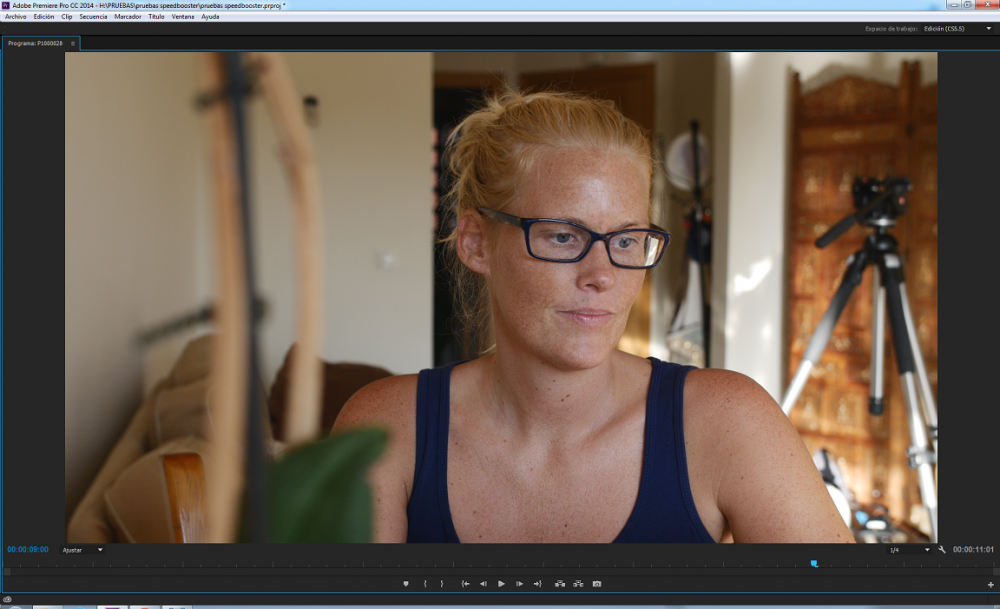

jorgelibra Posted August 26, 2015 Share Posted August 26, 2015 Hi Andrew and everyone else!I've been following you for a while and I really like your work. Where of I have decided to buy this Log Converter Lut.Congratulations, beacuse the Lut looks very promising.. However, I have to agree with the ones who are claiming that the result looks a bit magenta/red straight from the workflow that you indicates in the pdf.I'm skipping the transcoding process so I'm applying the Input Log with Lumetri in Premiere and then Filmconvert Canon 1-DC Log Lut.I have attached some samples: 1-straigh from the camera (using Cine V and the other tips you recommend in your guide); 2-After lumetri input log; 3-After Filmconvert Canon 1DC (KD 5207 Vis3 film settings, without any other changes than setting filmgrain to zero).I just wanted to show those to you guys in order to get light on this, maybe we need to apply some other workflows or is it the Lut that would need some corrections?Apologise for my poor English! On 8/25/2015 at 4:39 PM, stephenk said: The guide talks about cc15 input/output but on CC14 I'm assuming you drag & drop the "converter" as a lumetri effect to flatten the image first? This resulted in heavy contrast & strong magenta after I added the output lut. My colors looked similar to xrayspecs. Flipping them seemed to correct it.. so in CC14 you drag & drop the output first and then the converter lut? Weird. I skipped the transcoding below and rushed into Premiere with an Arri lut first and then added the converter. Honey Smacks. nomsThis looks simply amazing!! So please could you please give more details, like how do you apply this Arri Lut first, and which one,... Thanks! Link to comment Share on other sites More sharing options...

Antonis Posted August 27, 2015 Share Posted August 27, 2015 On 8/26/2015 at 7:24 PM, jorgelibra said: Hi Andrew and everyone else!I've been following you for a while and I really like your work. Where of I have decided to buy this Log Converter Lut.Congratulations, beacuse the Lut looks very promising.. However, I have to agree with the ones who are claiming that the result looks a bit magenta/red straight from the workflow that you indicates in the pdf.I'm skipping the transcoding process so I'm applying the Input Log with Lumetri in Premiere and then Filmconvert Canon 1-DC Log Lut.I have attached some samples: 1-straigh from the camera (using Cine V and the other tips you recommend in your guide); 2-After lumetri input log; 3-After Filmconvert Canon 1DC (KD 5207 Vis3 film settings, without any other changes than setting filmgrain to zero).I just wanted to show those to you guys in order to get light on this, maybe we need to apply some other workflows or is it the Lut that would need some corrections?Apologise for my poor English! This looks simply amazing!! So please could you please give more details, like how do you apply this Arri Lut first, and which one,... Thanks!After reading this thread I started playing around with converter LUTs and film stock (not Andrew's but from Visioncolor) and to my surprise I got some interesting results. What do you guys think?(I played around with the opacity/intensity of both the converter LUT and film stock LUT to get a desired result. This might help dial down the unwanted magenta you guys seam to have) Link to comment Share on other sites More sharing options...
