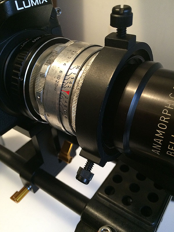

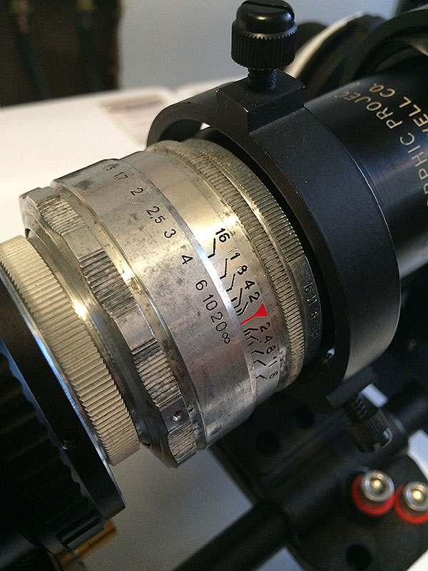

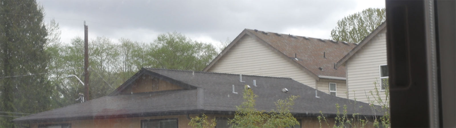

Bold Posted April 3, 2016 Author Share Posted April 3, 2016 My initial test was disappointing. The mod seems to suffer the same issue QuickHitRecord mentions near the bottom of the first post in this thread, where it can't quite seem to get to infinity. The taking lens is a Helios 44 (not 44-2) that focuses to infinity just fine on its own and is flat up against the back of the B&H. The front element of the mod is sitting in the helicoid nearly touching the front glass of the anamorphic. John Barlow mentions a negative achromat further down in the same thread as a solution. Anyone know of this and how to acquire one? Richg101 (or any other B&H modders out there) do you have any other thoughts/suggestions? I'm hesitant to shorten the distance between the front glass and anamorphic any further because I'm worried about the glass touching each other. On a positive note, the long helicoid allows me to focus down to about a foot (maybe less!) on my Helios without noticeable vignetting. Some mighty focus breathing, though. I'm very close to finishing this mod and would hate to think all my effort has been for naught. Any help on this issue would be greatly appreciated! |. . | .| Gabriel Copoeru and Tito Ferradans 2 Link to comment Share on other sites More sharing options...
Gabriel Copoeru Posted April 3, 2016 Share Posted April 3, 2016 Bold, I applaud your efforts, the mod is looking good. Regarding the infinity focus issue, I believe it is a flaw of the B&H itself. It simply cannot focus to true infinity. I was also wondering if you've saved the design for the 3D printed parts and could share it. Maybe I can find some workshop where I can do it in my country and try your mod as well. BTW, I see that redstan is selling his original clamp on ebay: http://www.ebay.com/itm/finest-anamorphic-lens-clamp-kowa-isco-sankor-and-more-by-redstan-/331812493831?hash=item4d4190da07:g:0NUAAOSwQYZWzlcS This clamp is a perfect snug fit for the B&H with the silver ring attached (I have it). Cheers! Bold 1 Link to comment Share on other sites More sharing options...

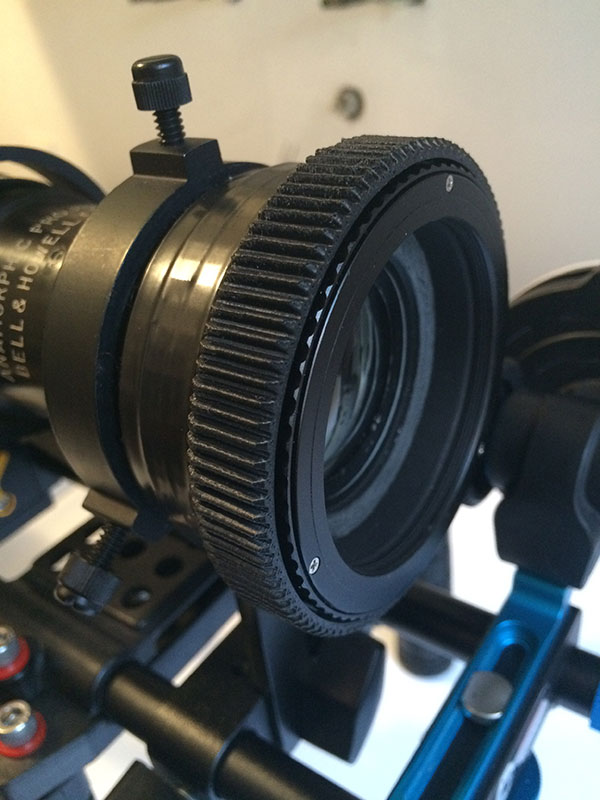

Bold Posted April 3, 2016 Author Share Posted April 3, 2016 Thanks Gabriel! Rich posted some pictures earlier in this thread which shows his mod focused at infinity, so it be should achievable on mine (in theory). The 3D printed collar only works with the polyurethane piece (this is the part that physically screws onto the front of the B&H) that I made for myself. Without that, the 3D printed part is of no use to anyone. I may consider recreating the whole assembly and selling it, but not until I can resolve some quality control issues - and hopefully the infinity issue. A note about helicoids: the ones on eBay from China that I've gotten use a terrible lubricant which loses viscosity at lower temperatures. Basically the rotation is very stiff when it gets cold. If you experience this problem, you can disassemble the helicoid (don't lose the screws!), remove the grease lubricant and replace it with some white lithium grease for much better focusing action (although reassembling a helicoid in the correct order takes some patience!). This is actually the first thing I do now when I get a helicoid from eBay. Link to comment Share on other sites More sharing options...

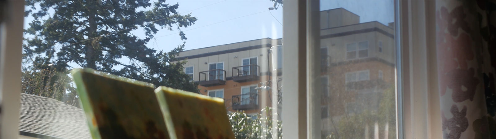

Bold Posted April 7, 2016 Author Share Posted April 7, 2016 Through a combination of small arms fire and hand-to-hand combat techniques, I was able to get this: The apartment in the background is at least 300ft away. It may not be perfectly crisp infinity, but it's within an acceptable margin of error for my uses. Eight inches out to (good enough) infinity, single focus, no vignette (probably down to 50-55mm), light weight, 2x anamorphic. HUZZAH! Link to comment Share on other sites More sharing options...

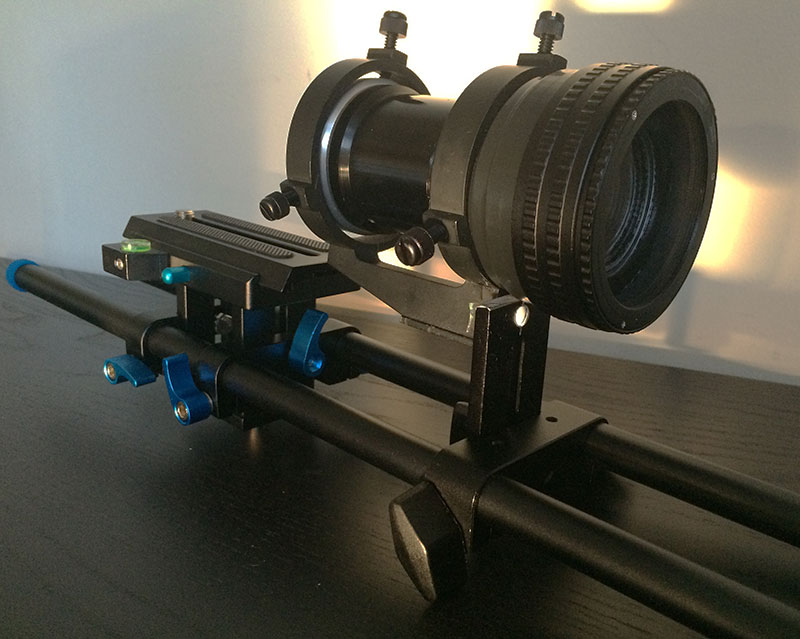

Bold Posted April 25, 2016 Author Share Posted April 25, 2016 I want to take a moment to thank everyone who contributed to this thread. Tito, Gabriel, Nahua, and particularly Rich, for your support and the invaluable information you shared that allowed me to get from 'novice anamorphhc modder' to 'slightly-less-novice anamorphic modder.' Seriously, without your insights I never would have finished this mod. I now have three working B&H lens mods. Two have the 14mm helicoids, allowing focus to approx 36 inches, and the 30mm helicoid which provides an amazing 8-inch focus distance. The downside on the 30mm helicoid is that: It still requires several barrel rotations to rack focus from 8 inches out to infinity Focus breathing is noticeable particularly at close distances. Not a bad trade-off, to be able to so close with the camera. I'm going to keep one of the 14mm's as well as the 30mm. I've ordered parts to create a second lens bracket, and will bundle that with the remaining 14mm helicoid modded lens for sale on eBay, to recoup some of my costs. As mentioned, I'm thinking of making the helicoid mod & lens bracket available as a kit if enough B&H owners are interested. So let me know if you are. Now I'm ready to start taking my rig out to do some serious test footage. I'm especially interested in trying my Mamiya Sekor 50mm f1.4 and my Angenieux 12-120mm to see results of night shooting and zooming, respectively. Once again, a thousand thank-yous to everyone in this thread for your help. You've allowed me to realize my goal of shooting in widescreen, an ambition I've had every since I bought my first 8mm movie camera so many years ago. I hope the info in this thread has helped other B&H owners take advantage of this lens. Cheers,|. . | .| Gabriel Copoeru and Tito Ferradans 2 Link to comment Share on other sites More sharing options...

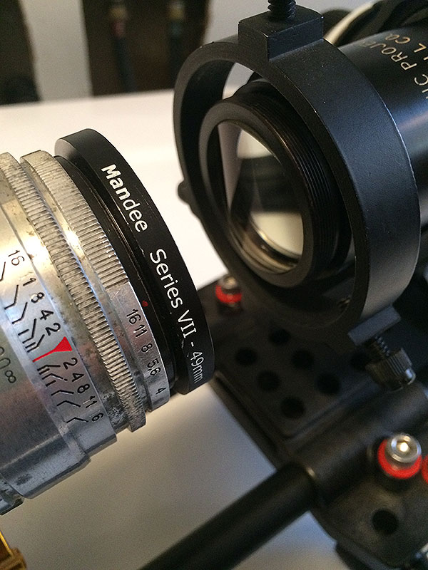

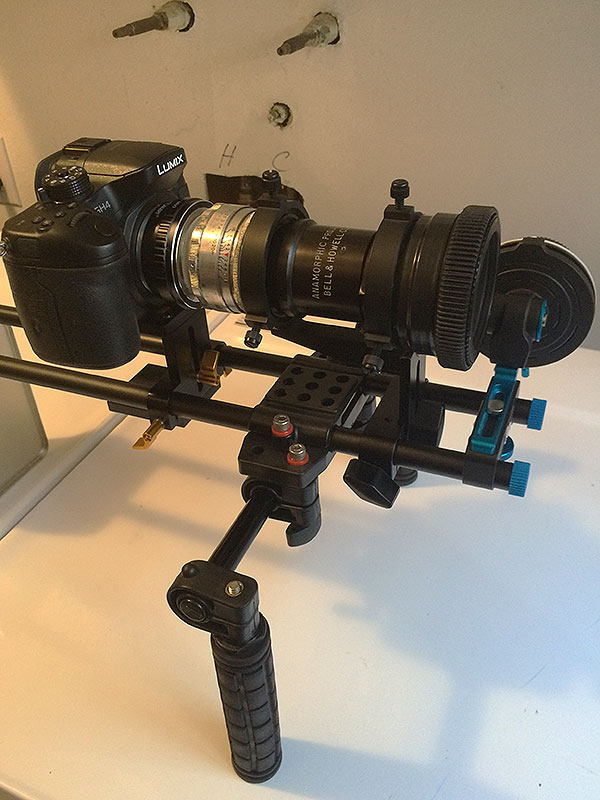

Bold Posted August 30, 2016 Author Share Posted August 30, 2016 A small update to B&H modding: I’ve been using the silver Series VII ring that comes on the back of most B&H’s found on eBay. I made a polyurethane version for Tito since his did not come with one. The ring is great for adapting to whatever taking lens you’re using. On a whim I decided to take off the silver ring to see if I could get my Helios any closer to the back of the anamorphic. Here’s the back of the B&H without the silver ring. Since my Helios has a diameter of less than 61mm (which is the inner diameter of my support bracket), I was able to slide it closer so that the back of the B&H is actually sitting inside the taking lens. So the series VII ring isn’t necessarily needed in all situations. It doesn’t necessarily improve the resulting image either, but it is a snug fit. In other cases, like if you have a taking lens with a 72mm thread, I would definitely recommend a 72mm-to-S7 adapter to ensure that your lenses are locked, light-sealed, and centered. On Tito’s advice, I also took a 3D file for a follow focus ring, altered it, and fit it around the helicoid of my B&H mods. It’s a much easier process than hand-gluing focus strips, and the results are a little nicer looking too. Cheers, |. . | .| Tito Ferradans and Timotheus 2 Link to comment Share on other sites More sharing options...
Tito Ferradans Posted August 30, 2016 Share Posted August 30, 2016 I like the silver Helios! hahahaha Great job, man. Shooting the tests with the mod was the most fun I had in a while! Video comes out this weekend. Bold 1 Link to comment Share on other sites More sharing options...
Bold Posted August 30, 2016 Author Share Posted August 30, 2016 Here's my badly photoshopped cross-section of what I mentioned above. The narrowing inner cone of the Helios prevents the B&H from touching the glass of the taking lens. You just have to slide them together with caution and care, to avoid scraping inner section of the taking lens. 2 hours ago, Tito Ferradans said: I like the silver Helios! Me too! I picked up a couple 44-2's for cheap last year, but I haven't used them much because I love love love the image quality of the original 44. I'm probably going to take one of the 44-2's and do this since I have the Kowa glass as well. 2 hours ago, Tito Ferradans said: Great job, man. Shooting the tests with the mod was the most fun I had in a while! Video comes out this weekend. Thanks Tito! Can't wait to see the video... so glad you had fun with the mod !!! Link to comment Share on other sites More sharing options...
