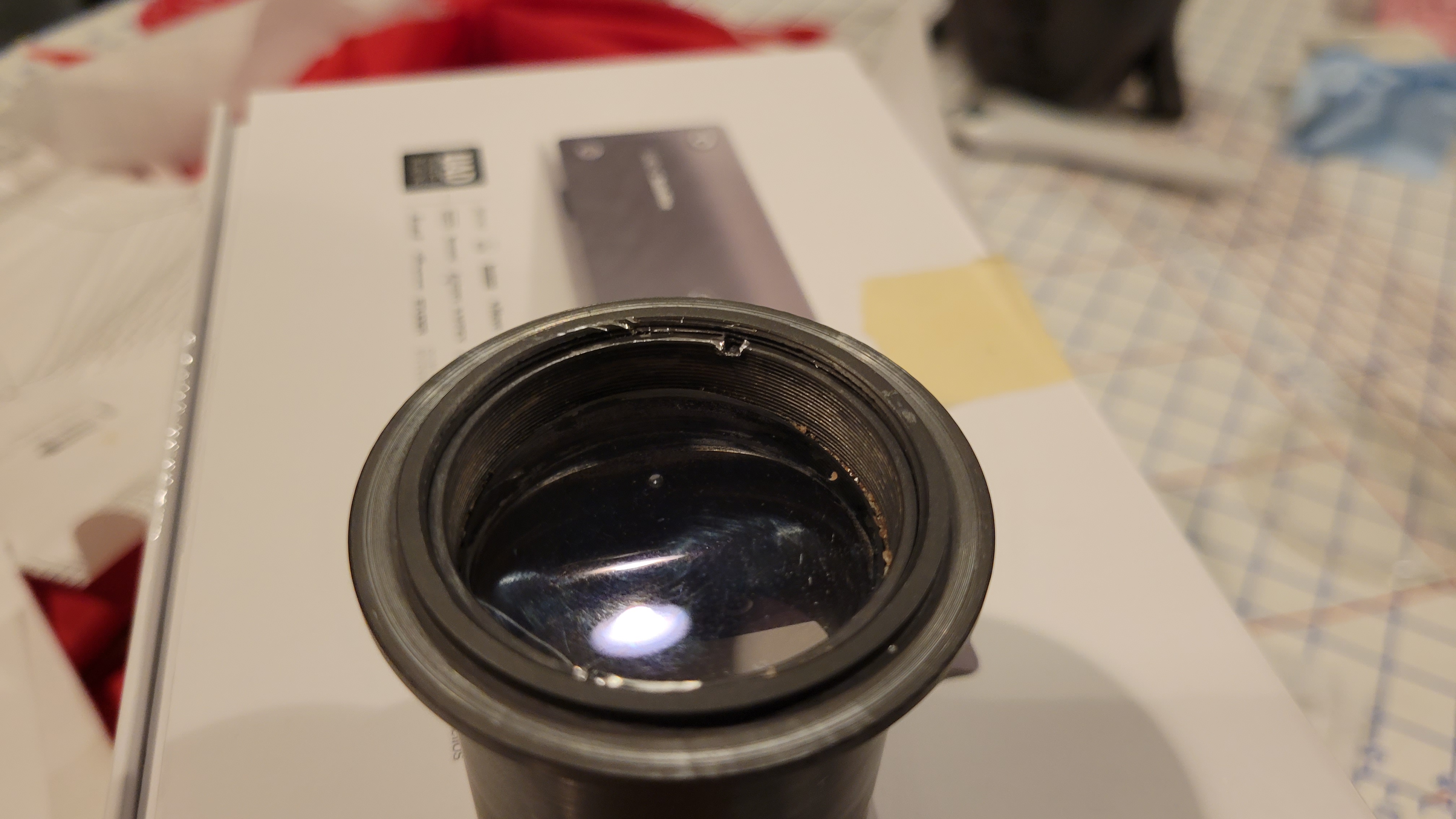

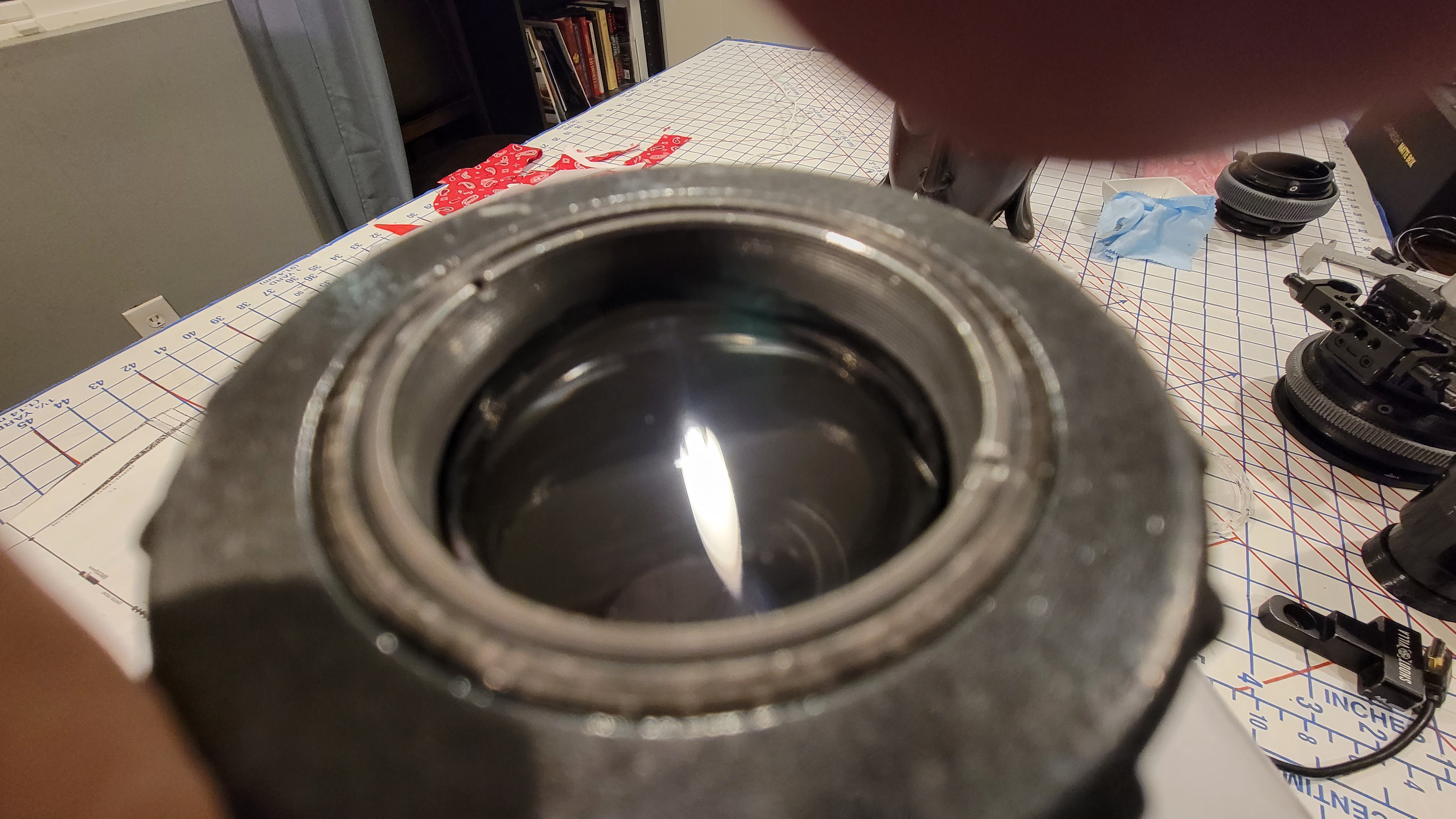

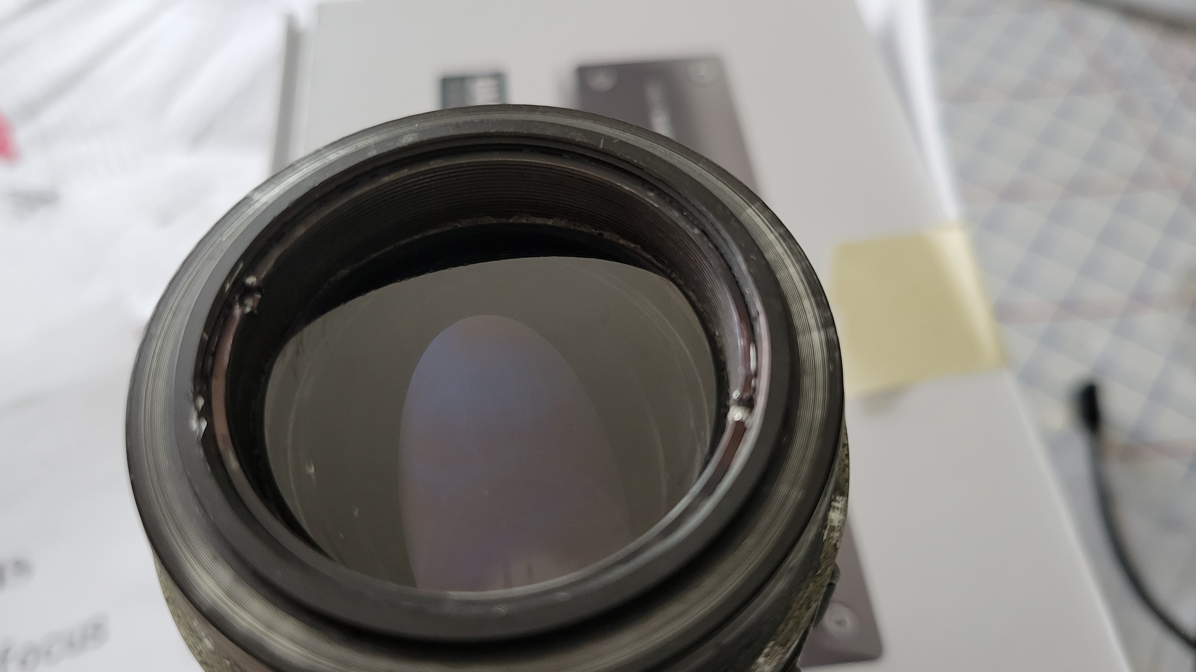

After reading a facebook post in the vintage lens group, where a member asked about polishing a lens with damaged coatings on the front element, and where the responses were basically, "throw it in the garbage", I decided to make a quick comparison video of 2 moller 32/2 lenses I have.
One is in perfect condition.
The other was one I picked up for cheap.
When it arrived, the front lens cleaning marks were so excessive, it was truly unusable. So I decided to try polishing it.
I used diamond polishing compound 14000 grit, and a dremel with a polishing tool.
Look at the video and tell me which one of these lenses is unusable, and should be thrown in the garbage.
