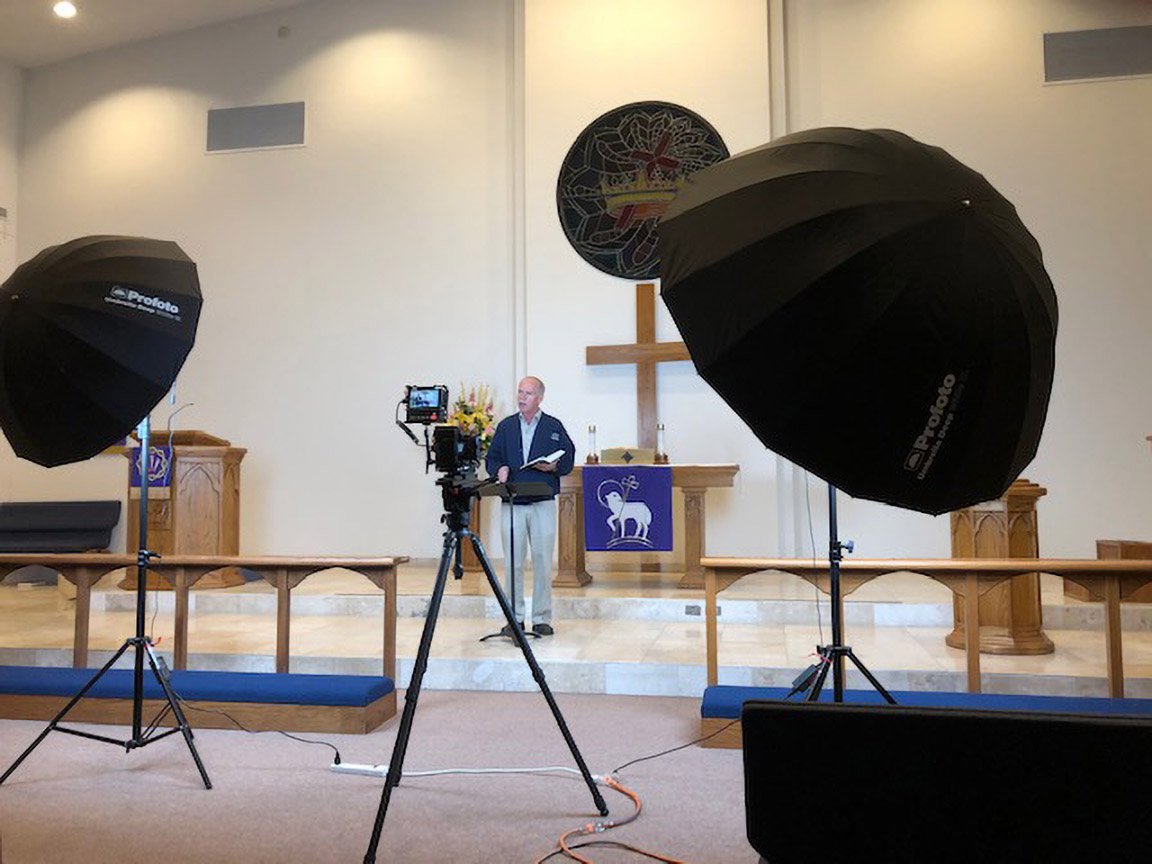

I have not tried RAW with LOG off ... but honestly at iso 400 I see little noise ... but I tend to keep the blacks fairly low.
DR is voodoo to a certain extent ... no pleasing image has 13 stops of DR ... but it does allow you to pick where Zone 2 -8 fall ... most of mine are bunched
up but just my preference.
I am struggling with the DPAF AF choices ... tracking is great and perfect for lighted venues ... less so in landscape ... I am presently trying to make
the Canon 85 F 1.4 L work ... it is great for stills but is a recalcitrant beast for video ... misses more than it captures ideal focus ... in tracking spot and small
focus point modes ... I may chuck it and order a Sigma Cine 85 .... I can use the MF focus assistance to define my points and easily find them with the 180 (?)
degree focus range.
All of this was RAW with LOG ... edited with DR Studio and using the Clog2 to wide 709 LUT from Canon ... 7 nodes ... grain added ...
