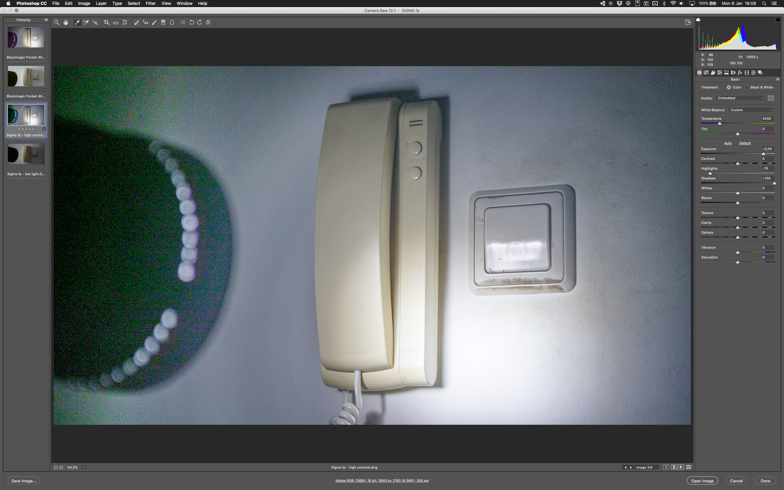

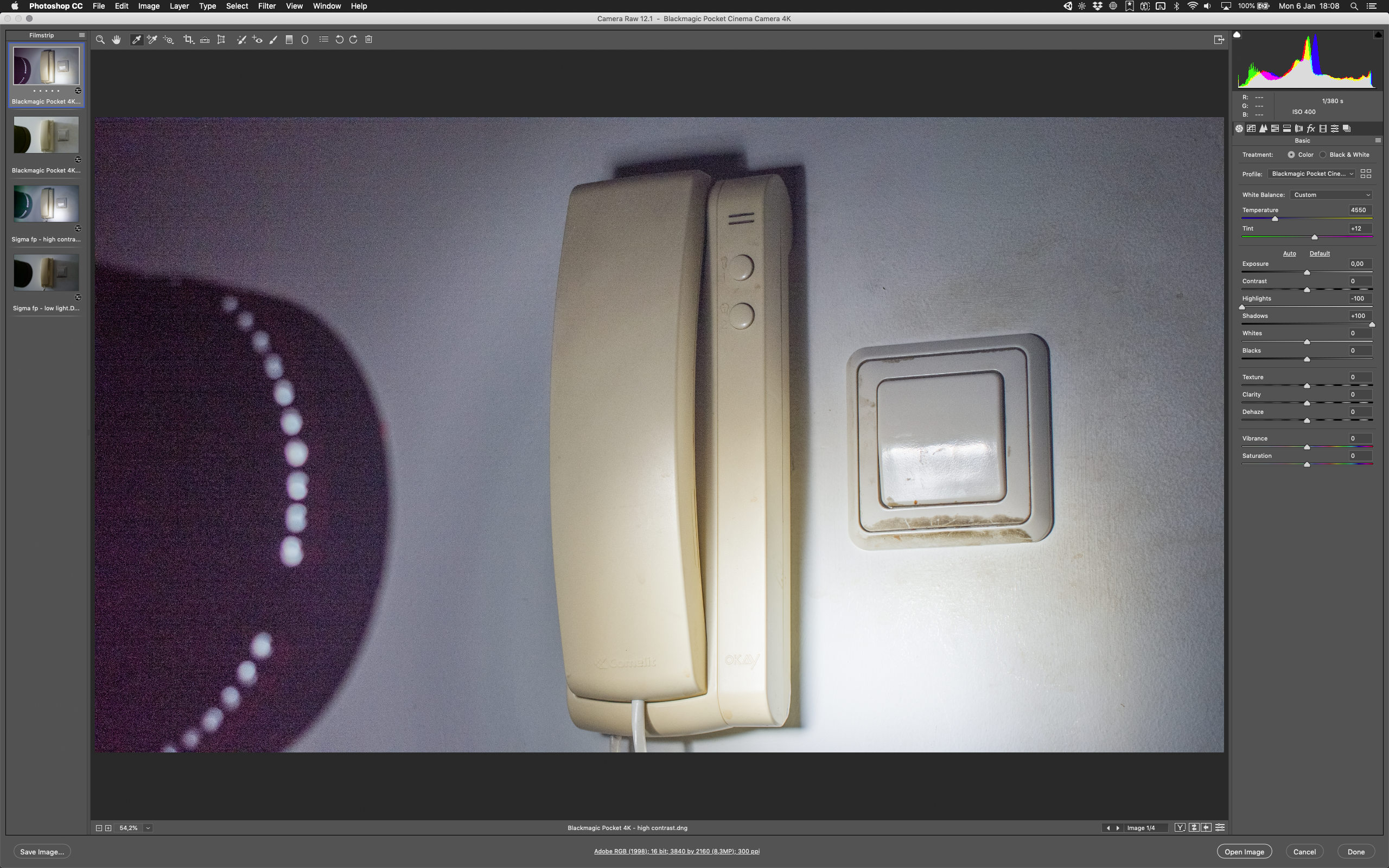

Lars Steenhoff Posted January 6, 2020 Share Posted January 6, 2020 I made an extreme grade in Lightroom to see what information is in the shadows. There seems a green tint on the sigma and a purple on the black magic Also the black magic seems to be exposed different in Lightroom, not sure why this is. Link to comment Share on other sites More sharing options...
rawshooter Posted January 6, 2020 Share Posted January 6, 2020 1 hour ago, Lars Steenhoff said: Also the black magic seems to be exposed different in Lightroom, not sure why this is. Sorry, I had included the wrong DNG in the archive. This has been fixed now; if you re-download it, you should obtain the frame with the correct exposure. (Has now also been fixed in the originally uploaded archive.) Link to comment Share on other sites More sharing options...
