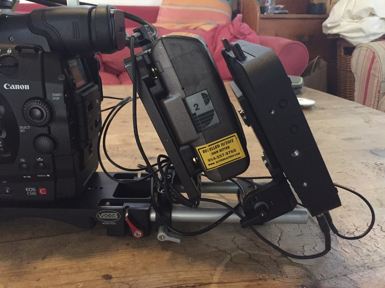

Ollywood88 Posted October 19, 2017 Share Posted October 19, 2017 9 hours ago, Dogtown said: Hello Olly, when you say you are having issues with the C500 and the Odyssey 7Q+ (is that he plus you have) those problems are they with the peaking for focus, and the image glitches, are they on playback on the Odyssey, or just monitoring picture on the Odyssey? I see some glitches monitoring some times but have never had a problem with recorded footage on the SSD's, just remember to always safe eject before removing those drives. @Dogtown No thing major, files are always ok. What happens is when I press breaking the screen freezes, I spoke to CD and they said just pull the cable out and reinsert and that does work. I mean when I play clips back, I have like glitch looking screen, then I go back out and play again its fine. I love the setup it produces great images, just the file size sucks. The grade is perfect tho, the footage. I haven't shot much 4k just 12 bit 4444. I normally shoot 2k 50fps and then 1/100 shutter and decide to slow down in post or not, Looks nice. Just need a cage for the 7Q for holding it now. Link to comment Share on other sites More sharing options...

Dogtown Posted October 19, 2017 Share Posted October 19, 2017 Some nice frame grabs John. Olly, I like the shape cage for the Q7+ and the 15mm adjustable rod mount, but what I've been using and it works very well is one of these 1/4 -1/8 with Arri rosette adjustable plate, cheap as chips and works! https://www.ebay.com/itm/ARRI-Type-Rosette-Cheese-Plate-Mount-Baseplate-fr-DSLR-RIG-15mm-Rod-Support-GH4-/361508743028?hash=item542b99a774:g:tbUAAOSwP~tW4neq Link to comment Share on other sites More sharing options...
