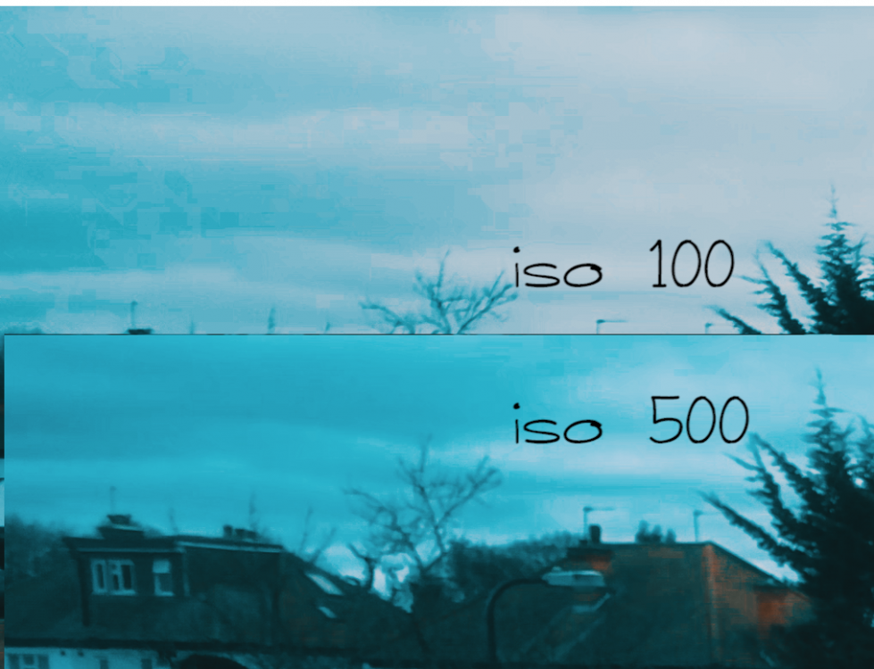

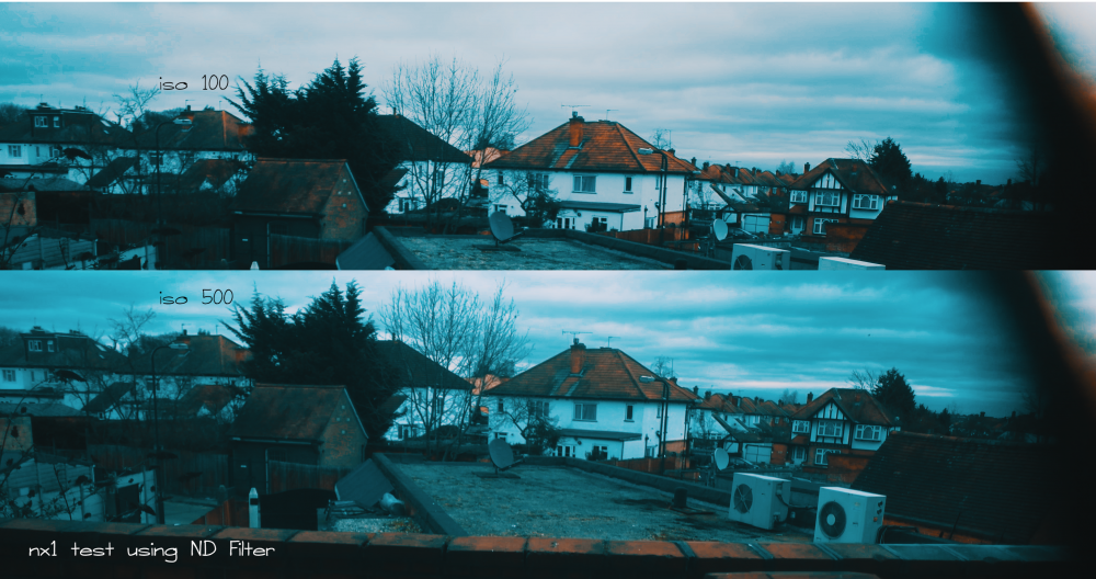

لطفي بوعكاز Posted February 21, 2017 Share Posted February 21, 2017 I just want to share my experience with getting rid of the blocks artifacts especially on a sky, I've found out that it's all to do with ISO value! when using the gamma DR profile and a low iso this introduces very ugly blocks or artifacts on the blue channel so I tried with a high iso either 500 or 800 and turns out it reduced this by a large margin if not completely. however high iso means overexposure, so ND filter must be used, if you're shooting a talent then you'll need to reflect light on your subject too. The picture shows you the difference, look at top left corner, I've maximized the color grading to be able to see it. I also tried adding grain to the 100 iso image but that still didn't fix the blocky image. The blocks are due to the compressed 8bit only video quality and the nature of h265. Kisaha, SMGJohn, Pavel MaÅ¡ek and 2 others 5 Link to comment Share on other sites More sharing options...

neosushi Posted March 24, 2017 Share Posted March 24, 2017 On 21/02/2017 at 4:15 PM, لطفي بوعكاز said: I just want to share my experience with getting rid of the blocks artifacts especially on a sky, I've found out that it's all to do with ISO value! when using the gamma DR profile and a low iso this introduces very ugly blocks or artifacts on the blue channel so I tried with a high iso either 500 or 800 and turns out it reduced this by a large margin if not completely. however high iso means overexposure, so ND filter must be used, if you're shooting a talent then you'll need to reflect light on your subject too. The picture shows you the difference, look at top left corner, I've maximized the color grading to be able to see it. I also tried adding grain to the 100 iso image but that still didn't fix the blocky image. The blocks are due to the compressed 8bit only video quality and the nature of h265. Could it be the effect of the ND filter ? Some have a dark cast that (maybe ??) could explain the difference. If not its strange because this test shows that the NX1 would have more DR at ISO500 that ISO100... Link to comment Share on other sites More sharing options...
tugela Posted March 24, 2017 Share Posted March 24, 2017 The reason is more likely because at the higher ISO he is losing some detail in the image, which allows the compressor more bandwidth for areas which normally might be compressed to accommodate detail elsewhere, such as the sky. Essentially by using the higher ISO value he is spreading the compression more evenly around the image rather than in specific areas. This seems to be the big disadvantage of H.265 over H.264 btw. Using higher bit rates should minimize these sorts of artifacts. Link to comment Share on other sites More sharing options...
