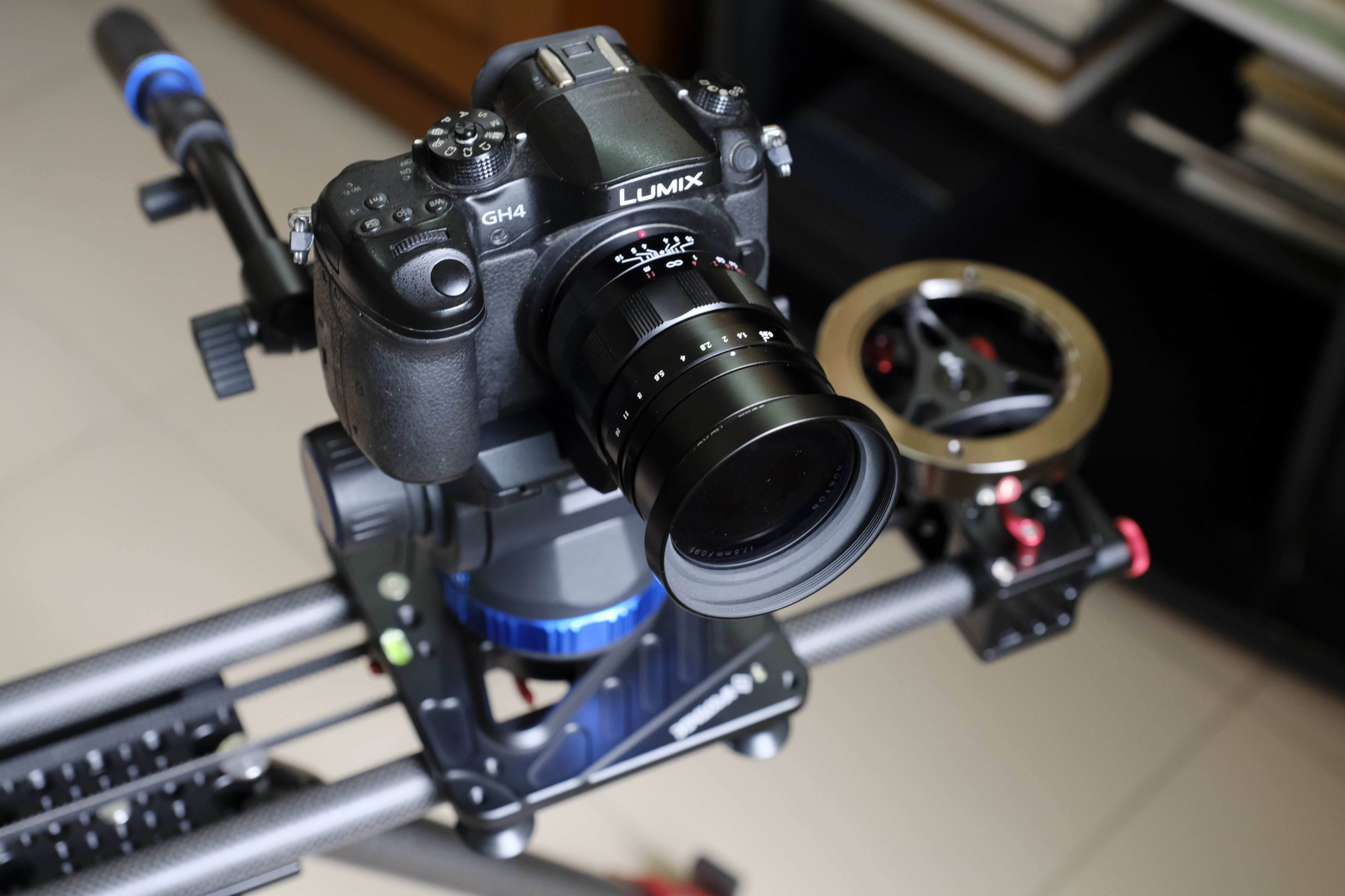

My advice is to go for the iFootage Wild Bull T7 carbon fiber tripod (around $575, so within your budget). I have used it along with the iFootage Shark Slider S1 and have not experienced any flexing when used with the Lumix GH4 and Leica Nocticron, for example.

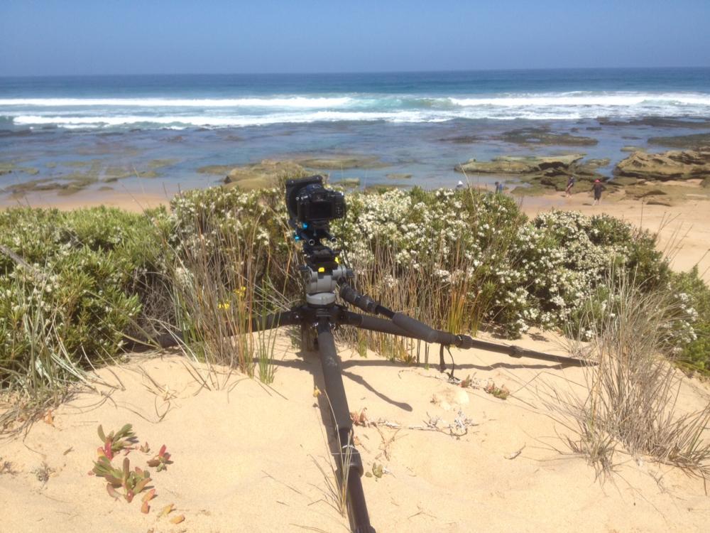

I have had very few Video tripods that work with single legs like most photo tripods are made. And you need the spreader on the bottom, not mid way. When they, looks like 3 leg ones, are in their lowest position they are VERY stable. It is easy to spend your money but there is no real cheap way out on tripods unless you go on ebay and buy a beat up, used high dollar one for cheap, because you really can't wear out a really good tripod.

Okay checked out the review of the wild bull here with the slider and counter weight on it... still some flex :(
He says "very little flex" but I think it's kinda significant if you watch the video... although I don't think it's the slider's fault but the carbon rods in the slider.

Also on the video tripods with multiple legs, not the photo single ones,  Never get one with a center section that raises.  And the ones with a bowl are the hot setup. I like the 3 section better than the 2 section for 2 reasons better. 1 The top section ends up being supported better by the next section down because it is not usually extended all the way, and 2 they tend to be able to go higher, not often you need that but when you do it beats having to carry two tripods around. They tend to weigh a bit more which is a good thing also. And don't be shy about hanging something from the center of them also. You can't have too much weight on a video tripod for stabilization. But tripods are personal thing, and you tend to use what you can afford, maybe not what is the best. :grin:
