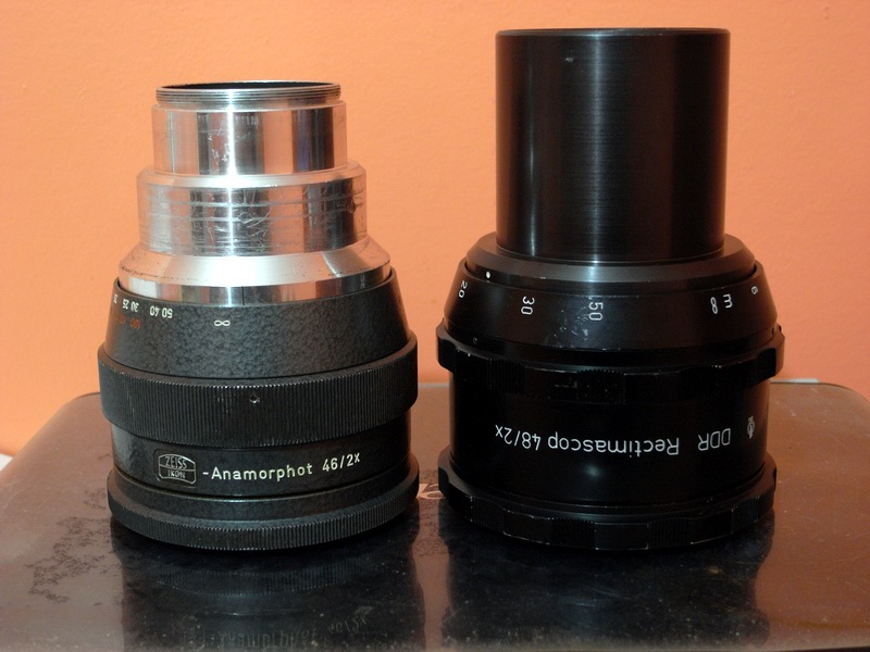

Dr. Verbel' Posted October 7, 2016 Author Share Posted October 7, 2016 Heavy, but cheapest :-) I have Rectimascop 80/2x, lenses very heavy in comparison with 35nap 2-3m. Front lens in cutted frame 900 g, rear 560 g. But light streaks very cool and very sharp from left to right. Number? I measured diameter rear lens of 80/2x, 80 mm. Your guess maybe right On 10/7/2016 at 4:20 PM, ken said: Hehe, too heavy to me. I remembered the front glass of Moller 63/2x is around 0.47kg. So I think the 46/2x or 48/2x lens are the best size for me. The 32 lens is too small. BTW, who knows what this number mean? But I guess it maybe the rear glass size in mm, looks very close. Expand Link to comment Share on other sites More sharing options...

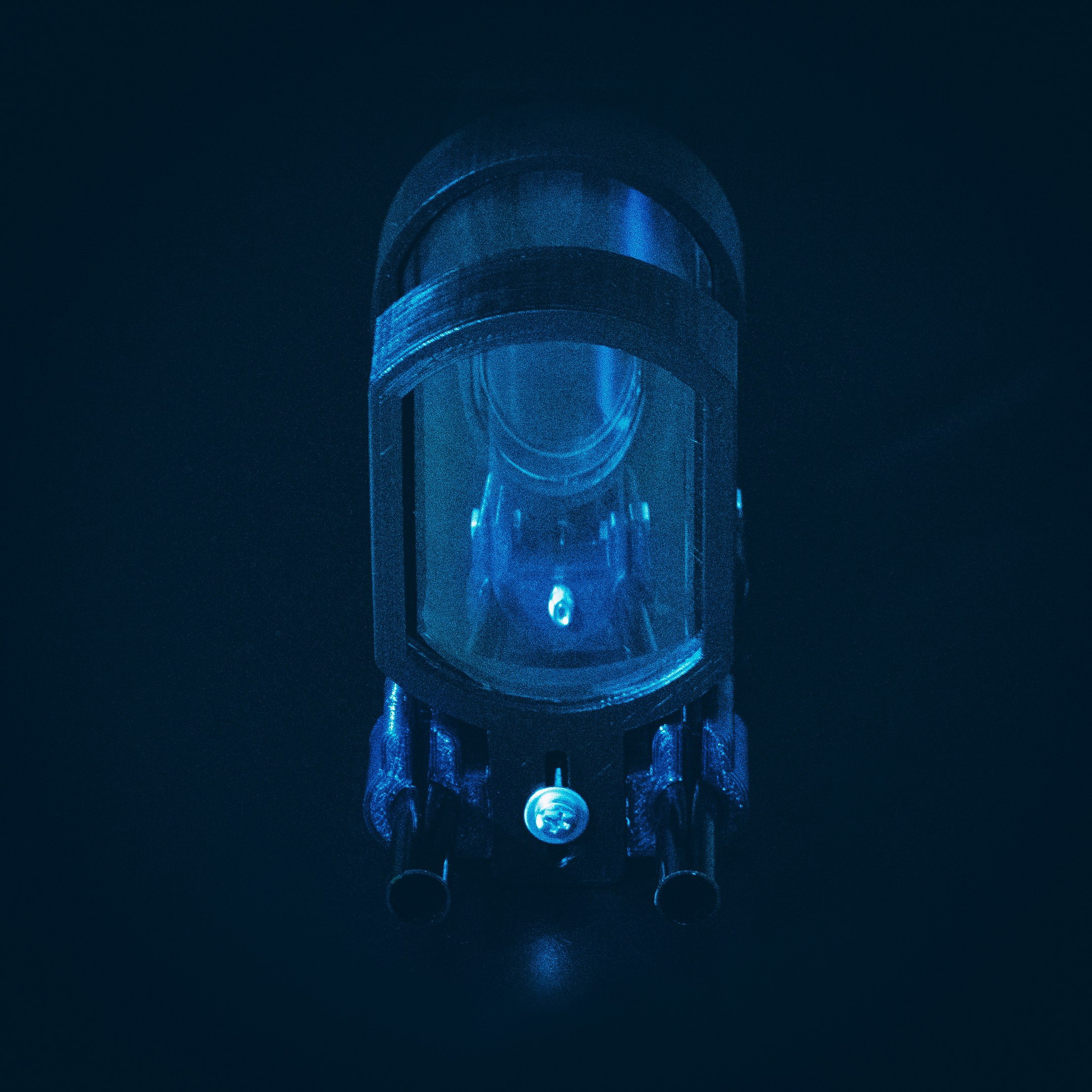

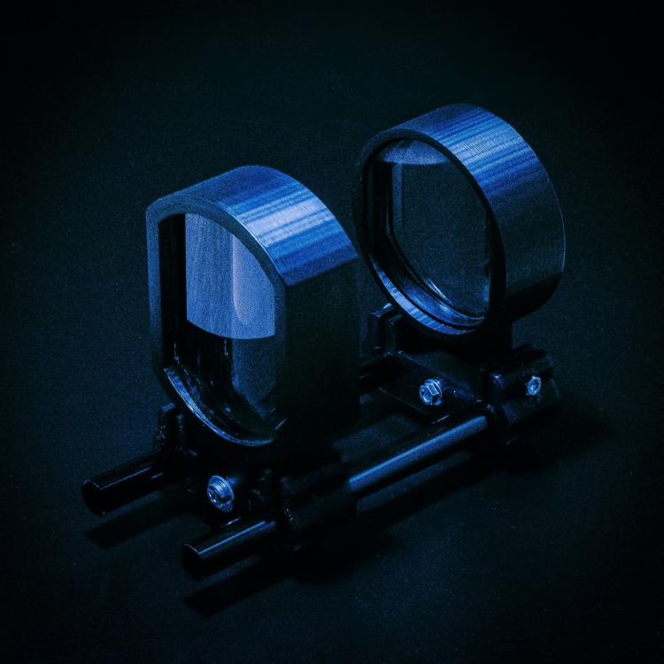

Dr. Verbel' Posted October 10, 2016 Author Share Posted October 10, 2016 Some edited photos. Just for fun Juank and Justin Bacle 2 Link to comment Share on other sites More sharing options...

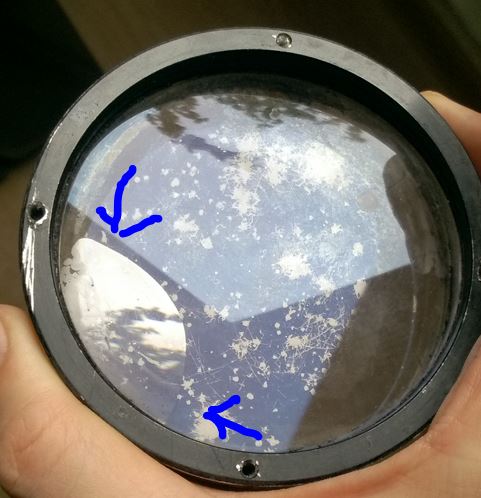

Dr. Verbel' Posted October 11, 2016 Author Share Posted October 11, 2016 Caution! WD-40 may ingrained between the cemented lenses... on the pic died lens from another Rectimascop 80/2x. It is not a pity, because she was so dead from fungus. But the possibility may be after WD-40. Maybe yes, maybe no... On 10/11/2016 at 8:15 AM, Justin Bacle said: I did put some WD-40 on the theads yesterday, so I might have a bit more luck this evening ... but I'm not feeling confident about it :s Expand Justin Bacle and Juank 2 Link to comment Share on other sites More sharing options...

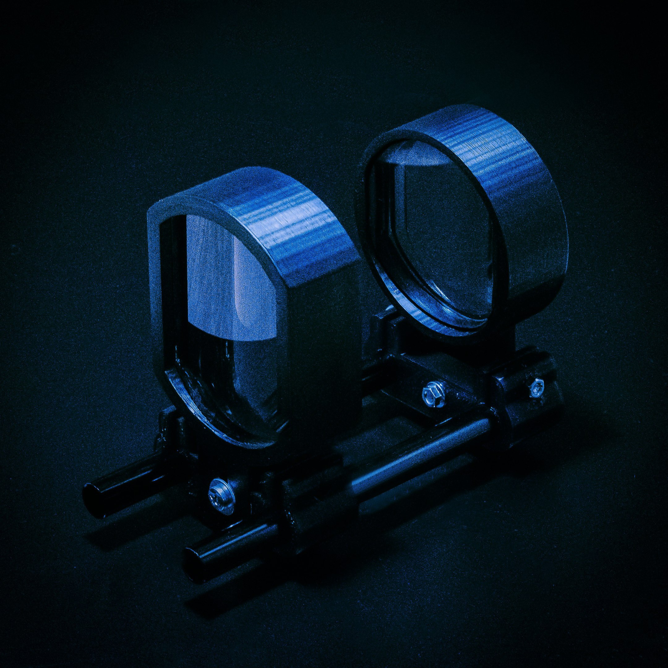

Dr. Verbel' Posted October 13, 2016 Author Share Posted October 13, 2016 Early test single focus for 35NAP... and for any bulky big projector lenses. Credits goes to this thread Link to comment Share on other sites More sharing options...

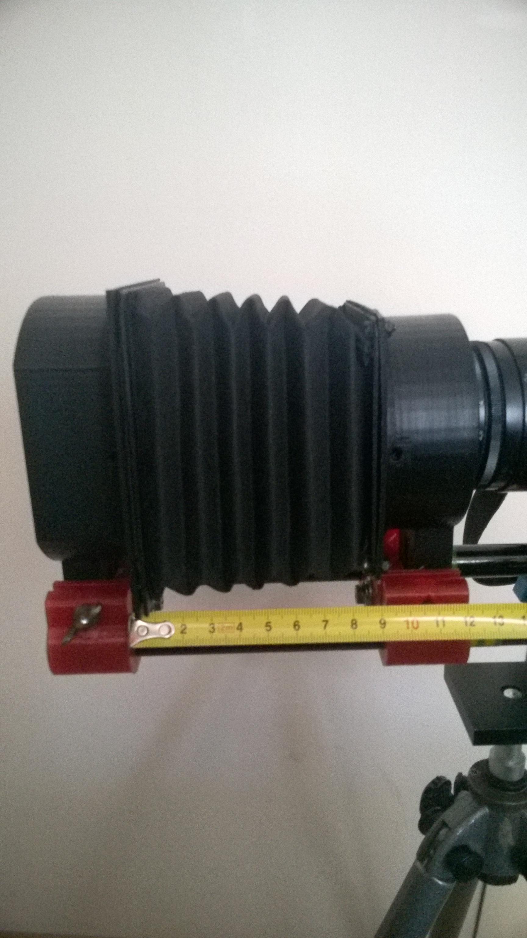

artiswar Posted October 13, 2016 Share Posted October 13, 2016 Question, how far apart are the elements at infinity? Link to comment Share on other sites More sharing options...
Dr. Verbel' Posted October 14, 2016 Author Share Posted October 14, 2016 artiswar, for 2-4 (2-3m) 9 cm / 3,543307 inch Juank 1 Link to comment Share on other sites More sharing options...
Dr. Verbel' Posted October 14, 2016 Author Share Posted October 14, 2016 More successful test single focus. Link to comment Share on other sites More sharing options...

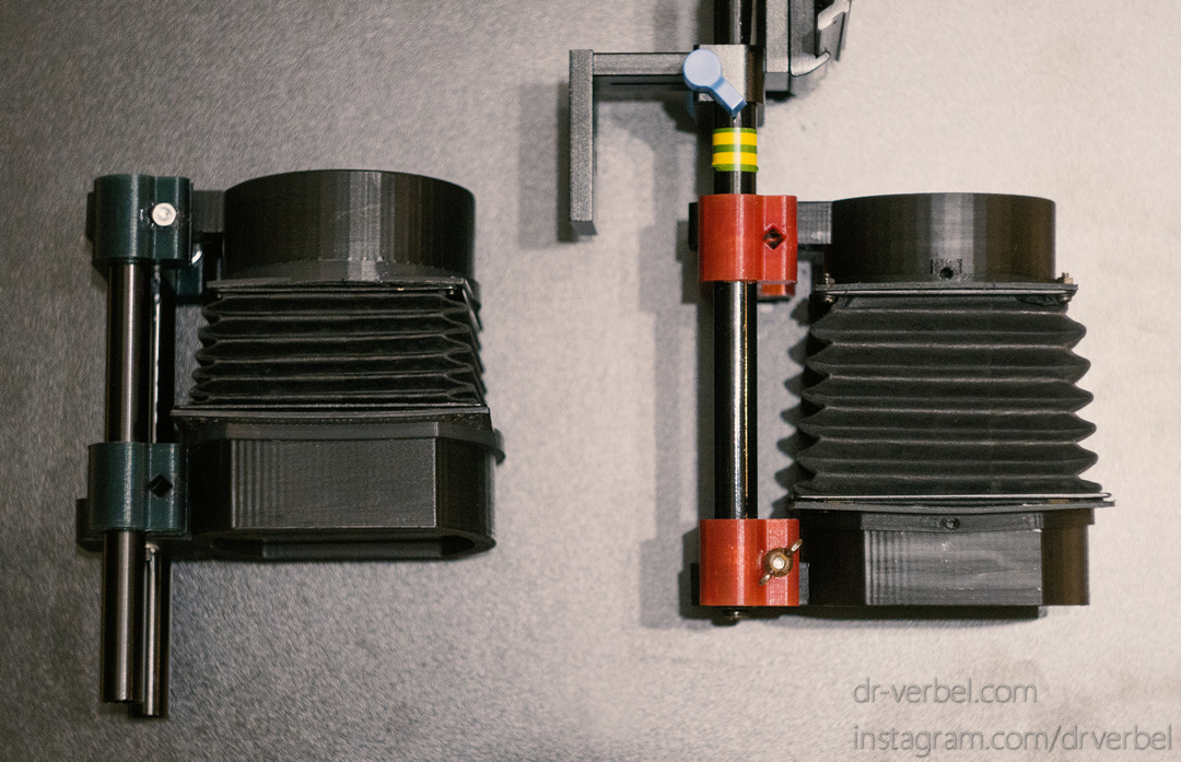

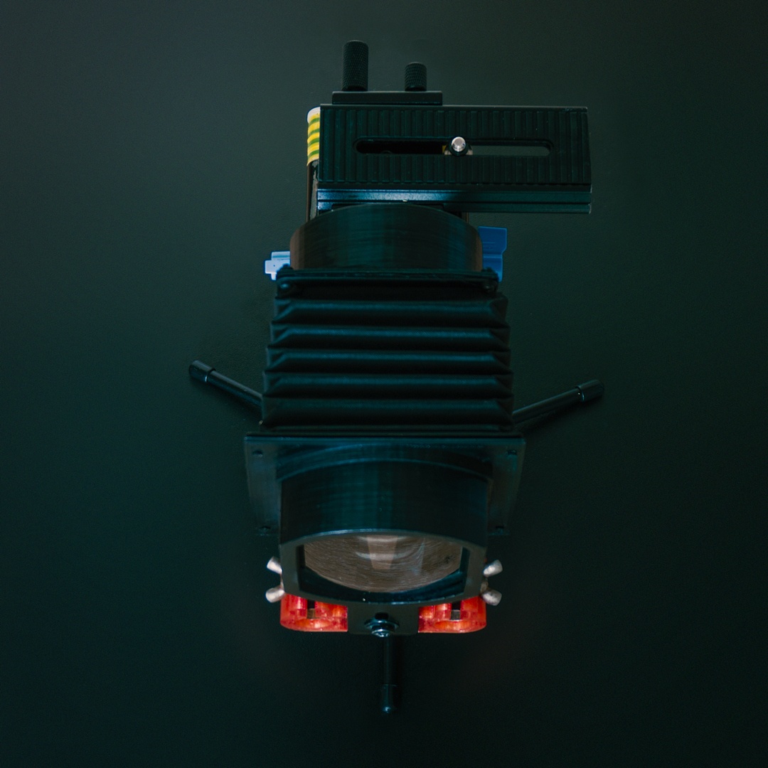

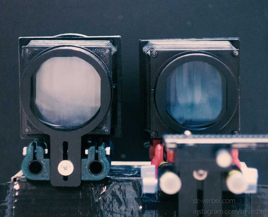

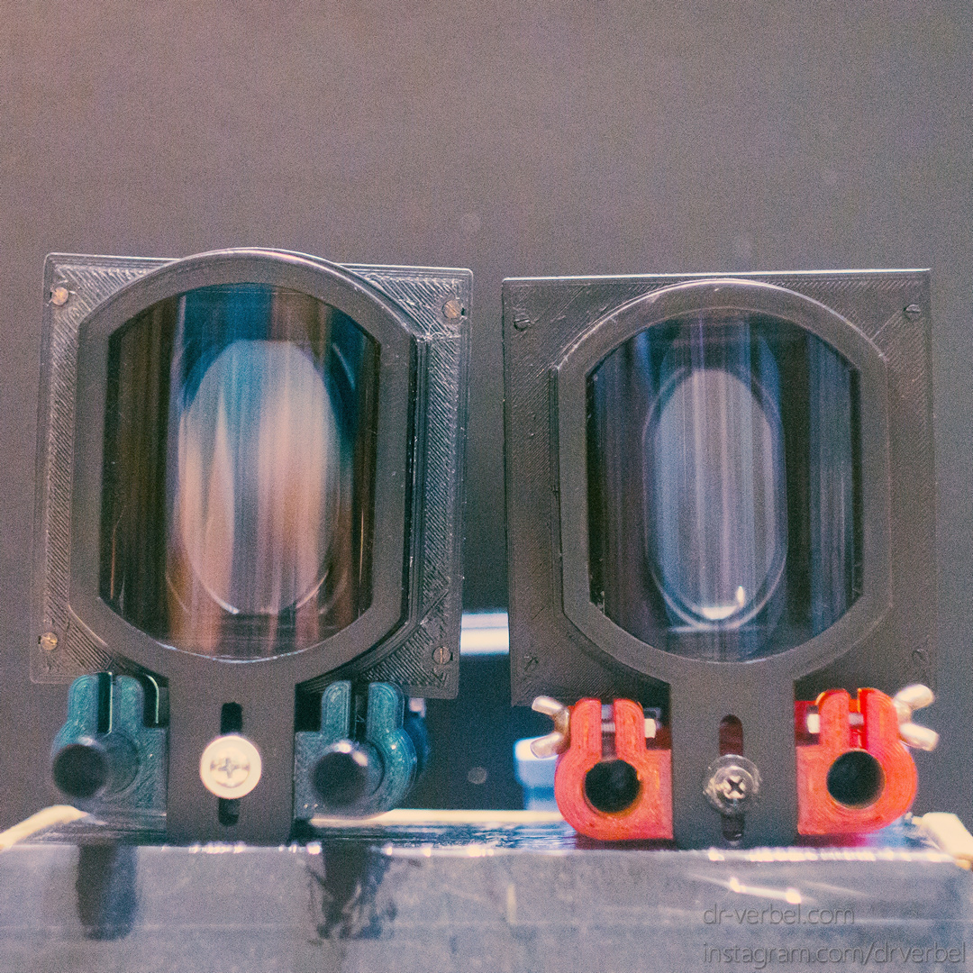

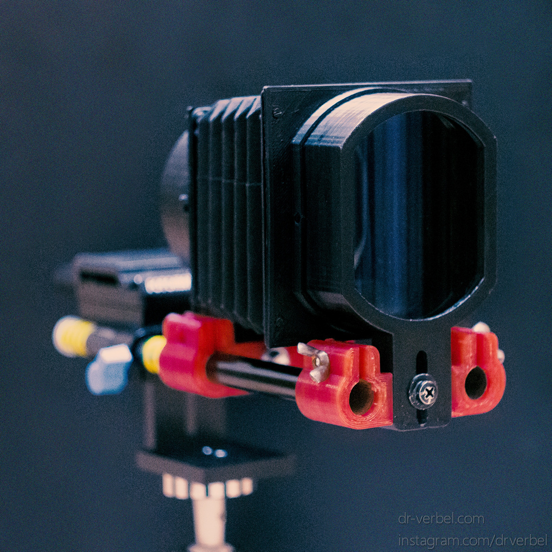

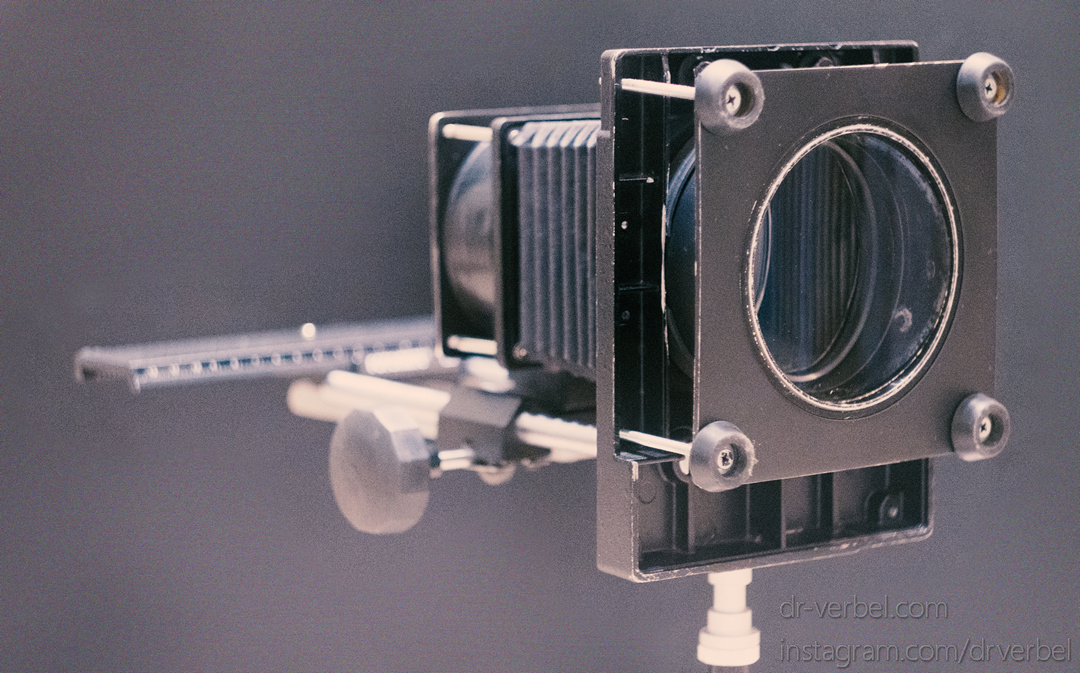

Dr. Verbel' Posted October 15, 2016 Author Share Posted October 15, 2016 Some photos of current construction. Beautiful body for single focus in progress. Juank and Timotheus 2 Link to comment Share on other sites More sharing options...
Timotheus Posted October 15, 2016 Share Posted October 15, 2016 On 10/15/2016 at 11:49 AM, Dr. Verbel' said: Some photos of current construction. Beautiful body for single focus in progress. Expand Will you let us know how you built it to be single focus? :-) Link to comment Share on other sites More sharing options...
Dr. Verbel' Posted October 15, 2016 Author Share Posted October 15, 2016 Credits to Frank Ladner https://www.youtube.com/channel/UChWCqVp4OYzofwZyvxprDWg . Thread on eos I posted on earlier messages. On 10/15/2016 at 2:18 PM, Timotheus said: Will you let us know how you built it to be single focus? :-) Expand Juank 1 Link to comment Share on other sites More sharing options...

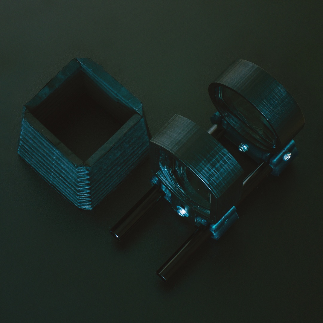

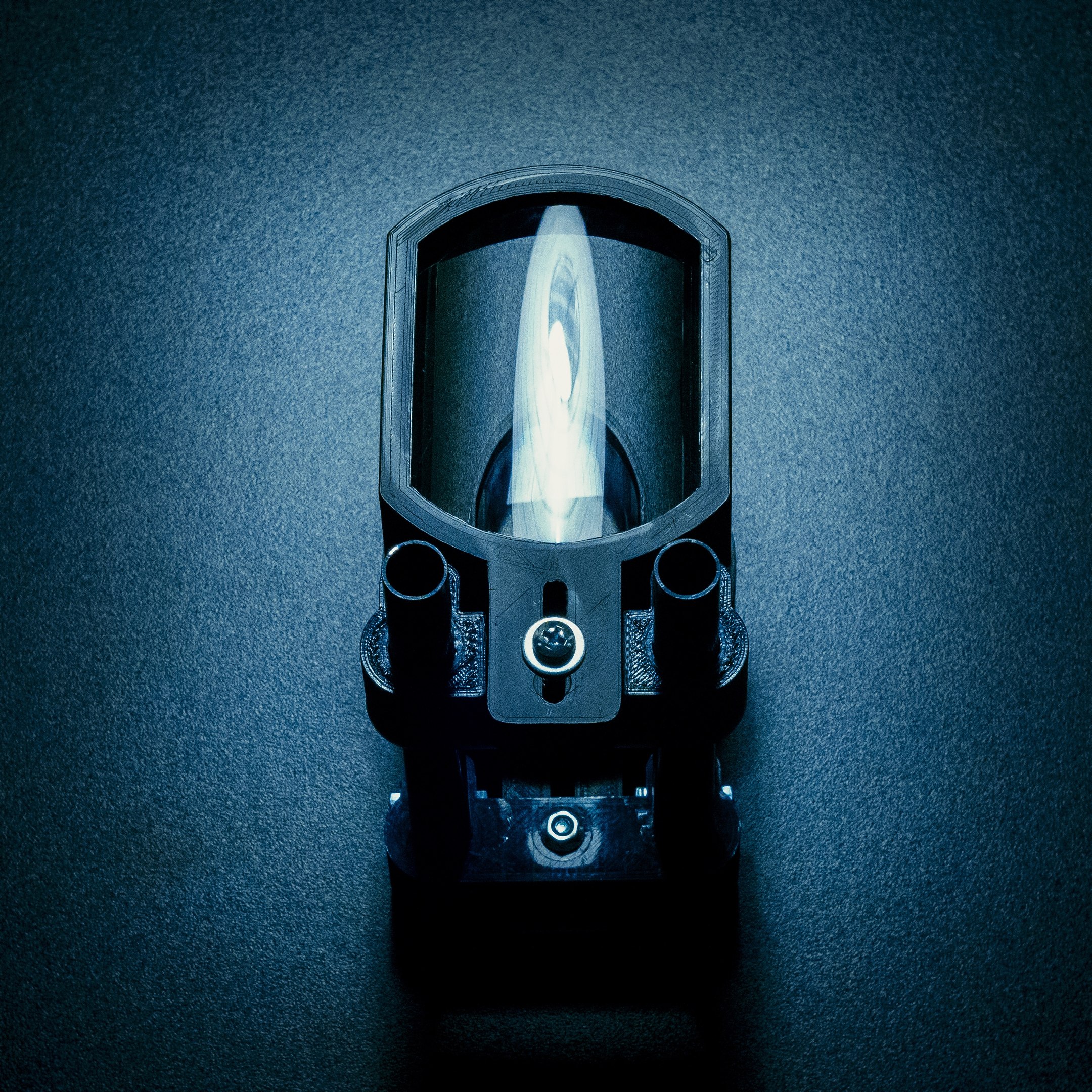

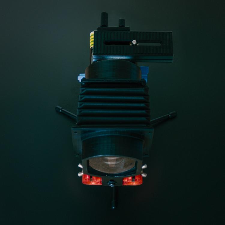

Dr. Verbel' Posted October 21, 2016 Author Share Posted October 21, 2016 Photos of modded — 35NAP 2-4; 35NAP 2-4, 35NAP 2-3M. Rectimascop 80/2x; 2-3M bigger than 2-4. 2-3M goes to Moscow soon for one filmmaker. Juank and Justin Bacle 2 Link to comment Share on other sites More sharing options...
