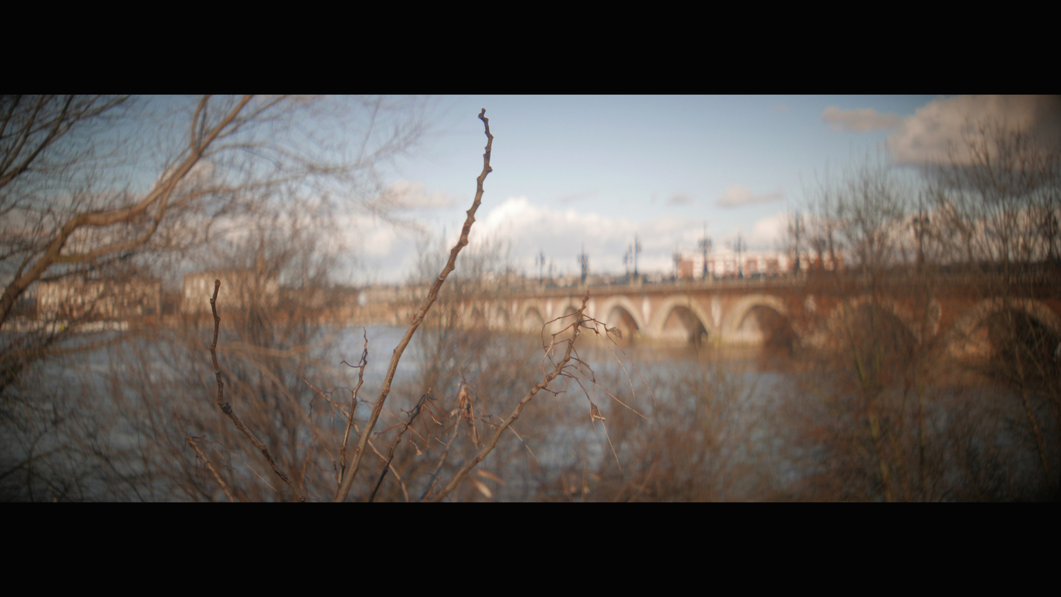

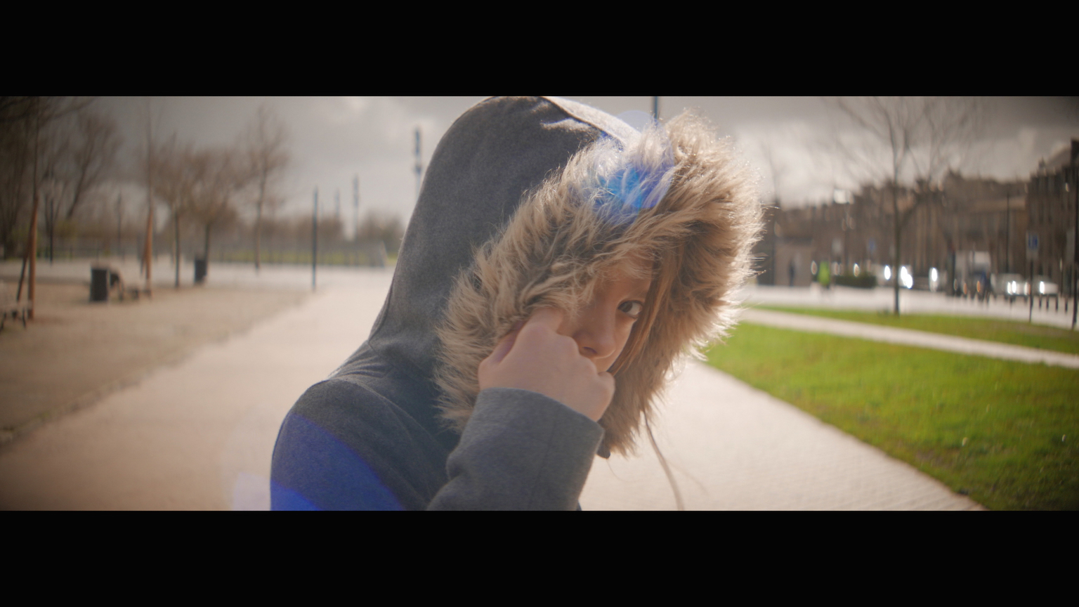

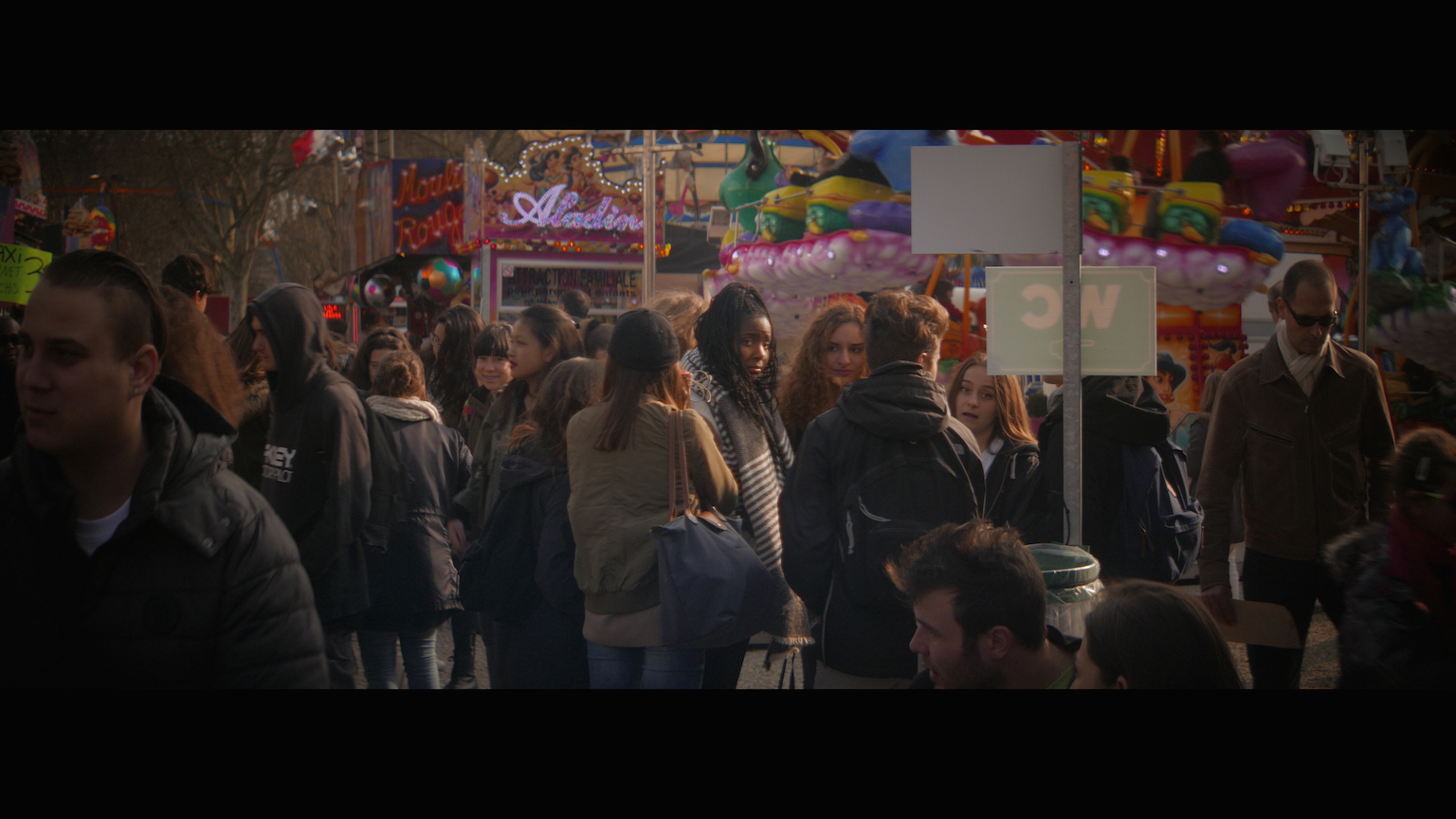

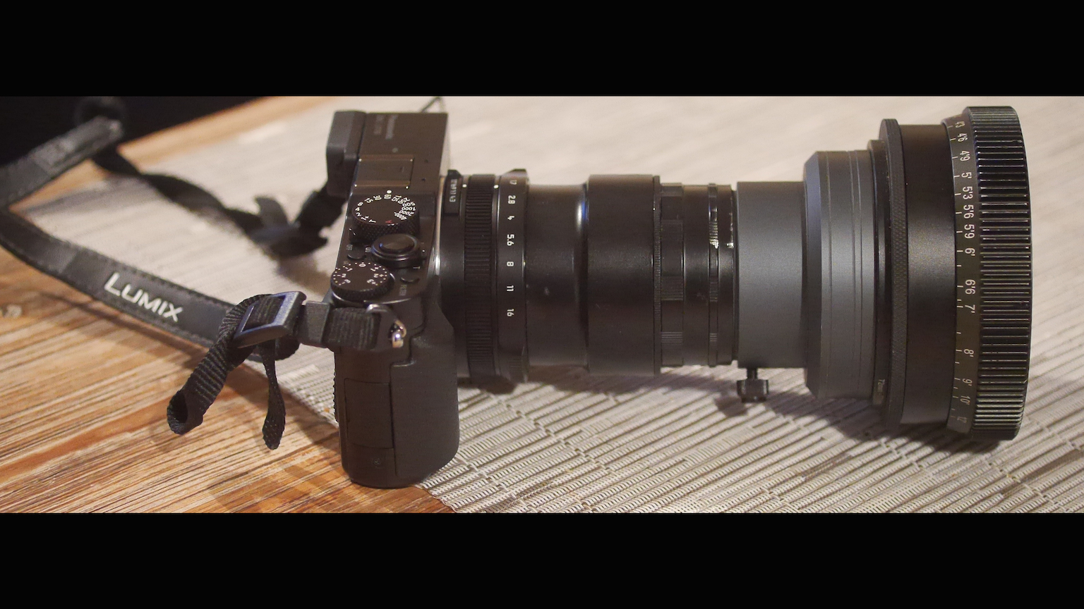

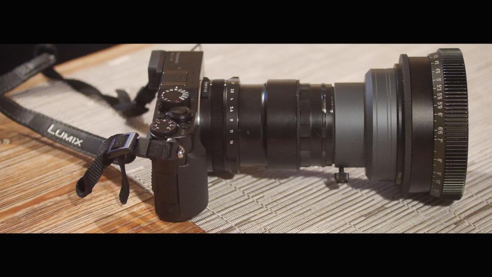

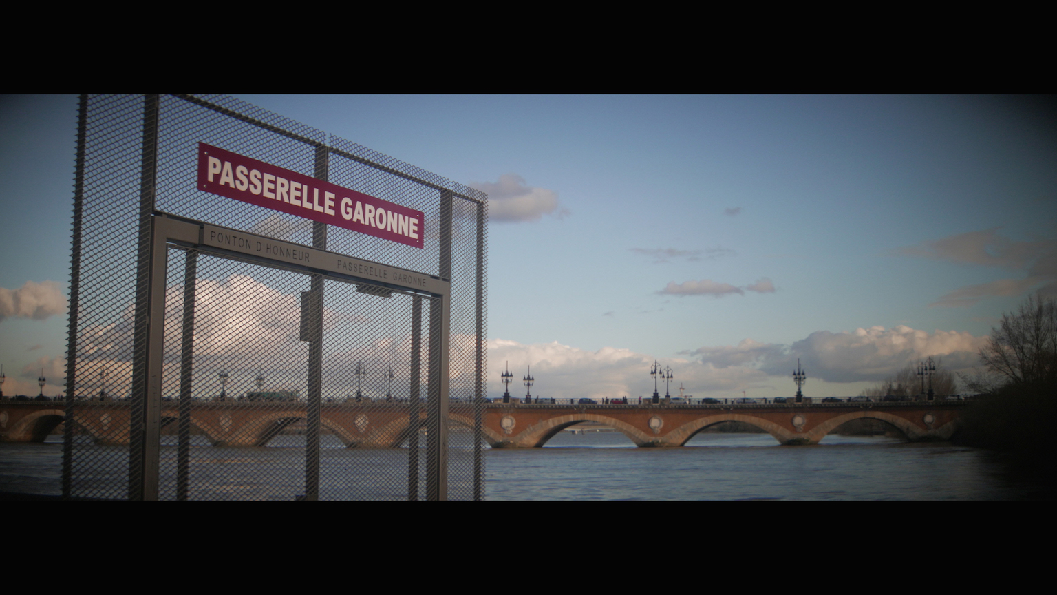

Sebastien Farges Posted March 15, 2016 Share Posted March 15, 2016 I'm happy having managed building a system for using my baby anamorphic on a 4K compact camera. I used an accessory tube made for the Canon G7 and managed to screw it on the bayonet system of the LX100. then I screwed another tube on it to allowed the zoom going at it's end of it's range (84mm in 4K, because it's vignetting below), then the Redstan clamp for my baby Hypergonar, and finally the SLRMagic Rangefinder focus system, and here we go ! For me the result is very promising ! What do you think ? camera : Panasonic DMC-LX100 on tele zoom position (84mm) always at it's full aperture (f2.8 in tele position) 3:2 4K 25p photo mode exported in UHD baby Hypergonar anamorphic 1.75x lens SLR Magic Rangefinder focus system no color correction except slight upper whites on 3 clips -5 personnal color settings Howa ND 32 filter music : The Cure Thanks to the students from Master, Nina, Céline and Charles, Arnaud and Tchie-Kung Ian Edward Weir, benymypony and 1tkman 3 Quote Link to comment Share on other sites More sharing options...

Sebastien Farges Posted March 15, 2016 Author Share Posted March 15, 2016 24 minutes ago, shanebrutal said: This is great, anamorphic looks nice on the lx100! I was recently thinking about anamorphic on my lx100. Thanks for the idea! I want to try the anamoprhic shop vm lens because it's very small and wouldn't need any extra adapters. But i'm worried about the lx100 sensor size being too large. The vm lens is recommended for bmpc sized sensors. The canon g7 accessory tube, what exactly is it for and can it be purchased online? Thanks! This tube is compatible more or less with the bayonet system attachment of the LX100, so I can fix the system on the camera with care, much better than fixing it on the fragile zoom... http://www.ebay.fr/itm/Filter-adapter-tubus-black-metallic-58mm-for-Canon-Powershot-G7-G9-/262291664068?hash=item3d11cd2cc4:g:XesAAOSwWTRWwZsc shanebrutal 1 Quote Link to comment Share on other sites More sharing options...

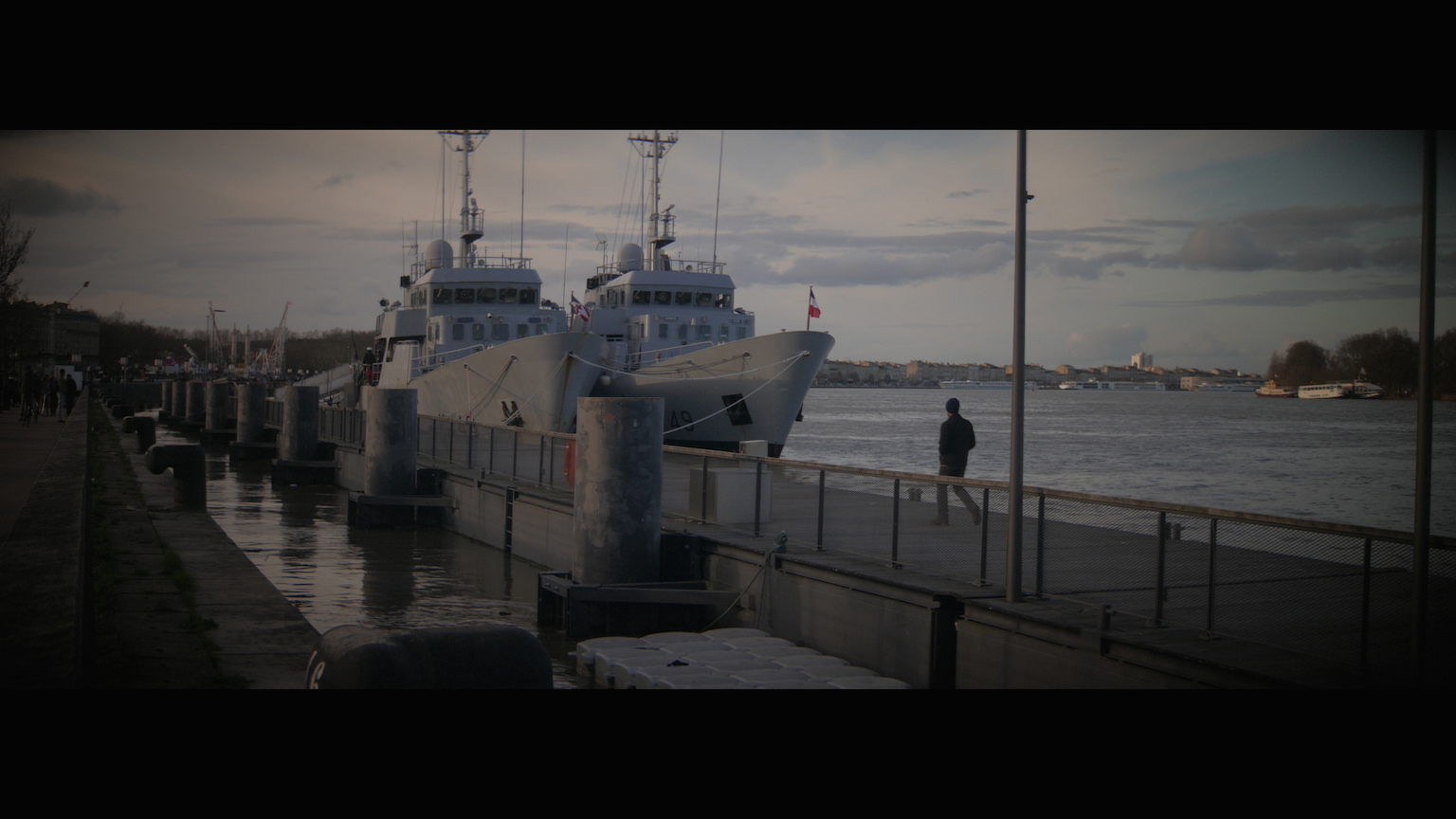

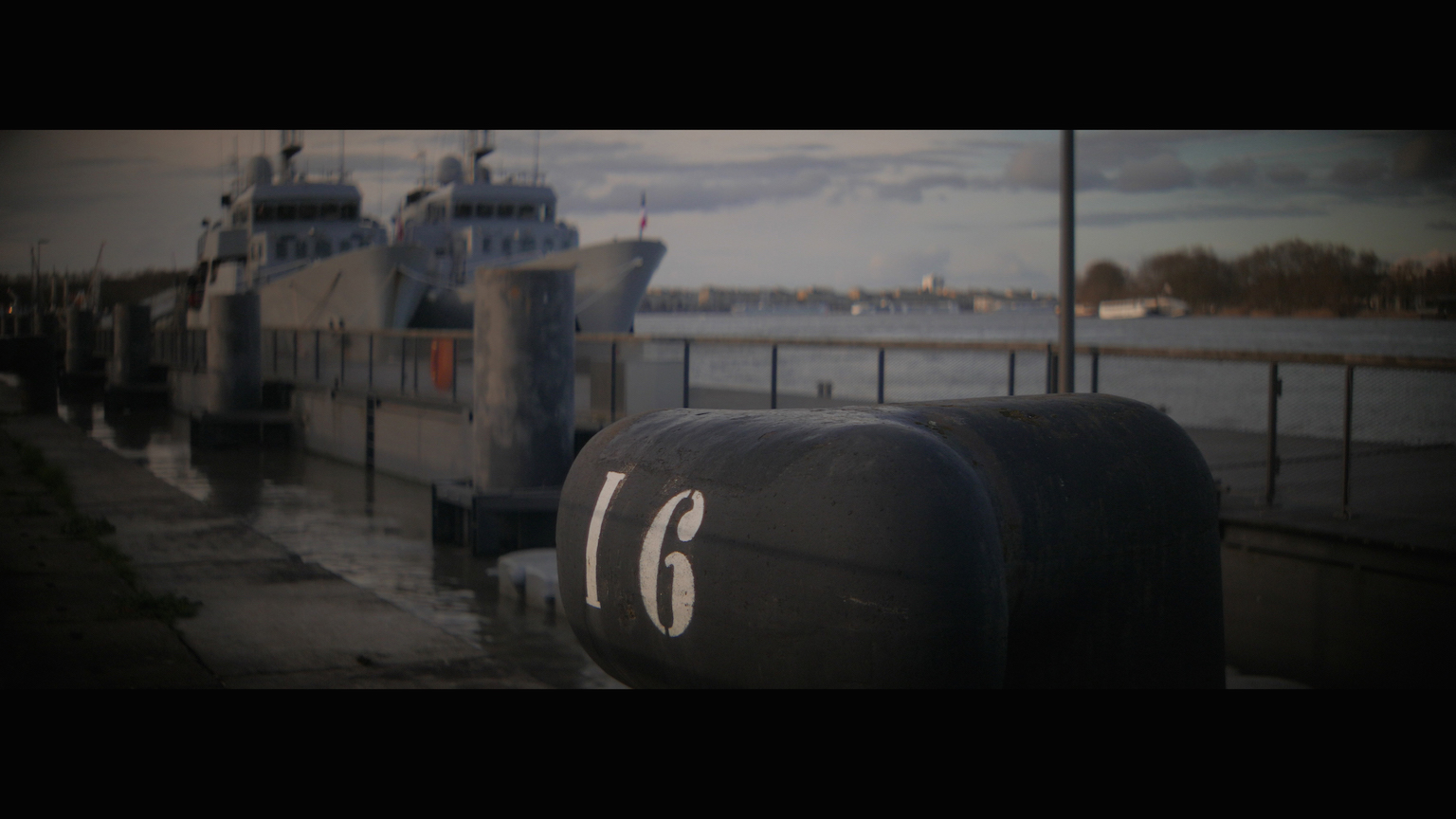

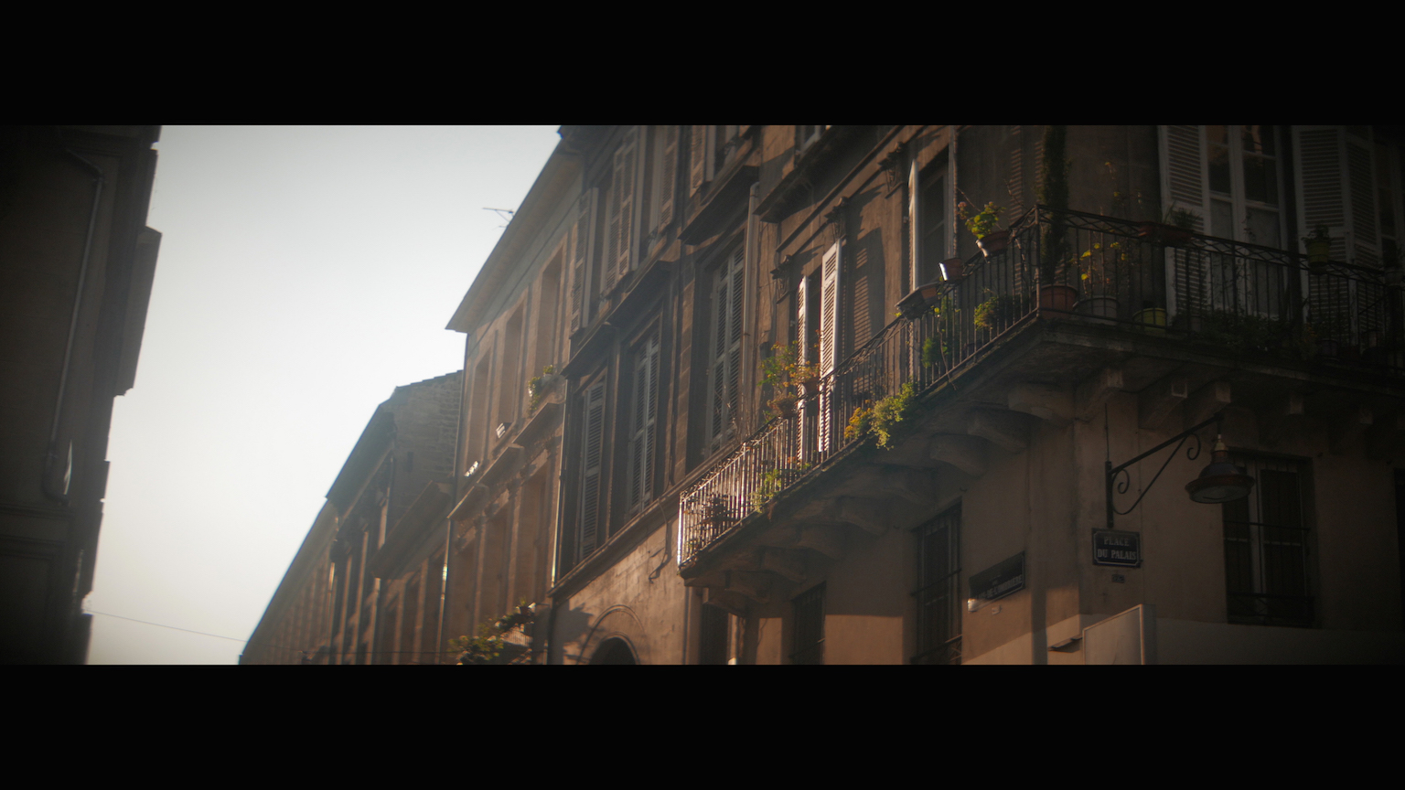

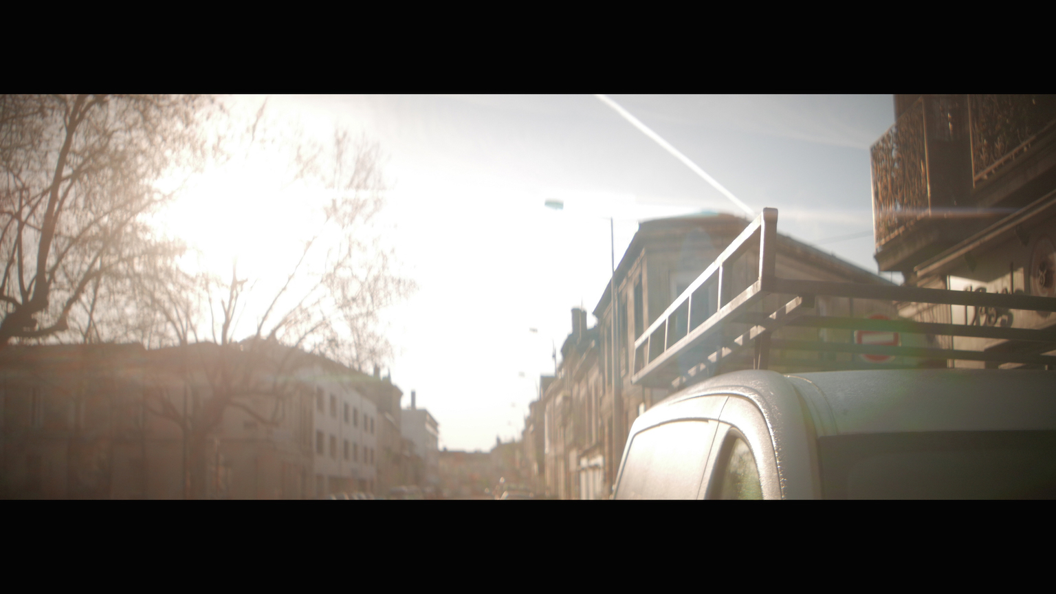

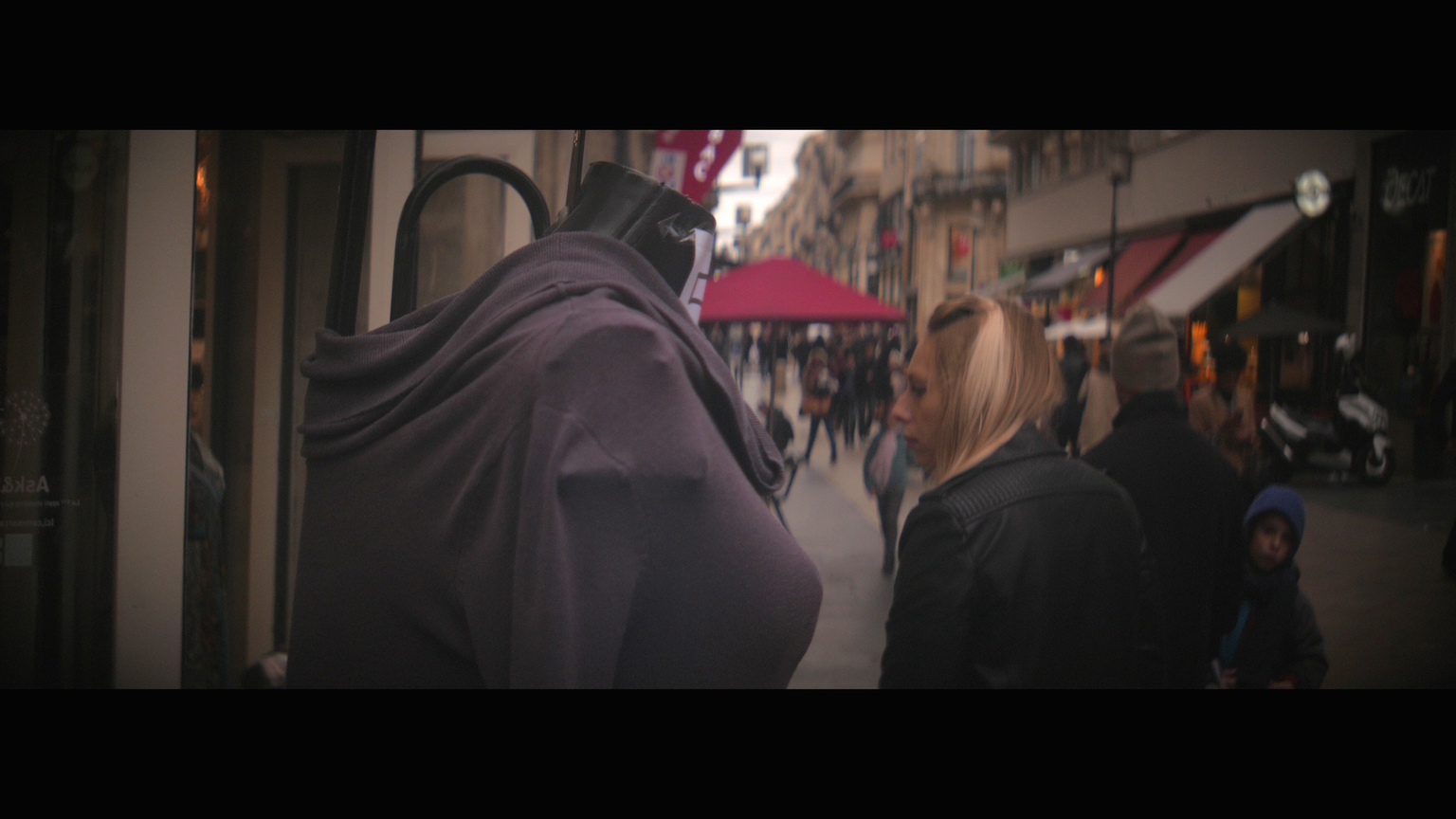

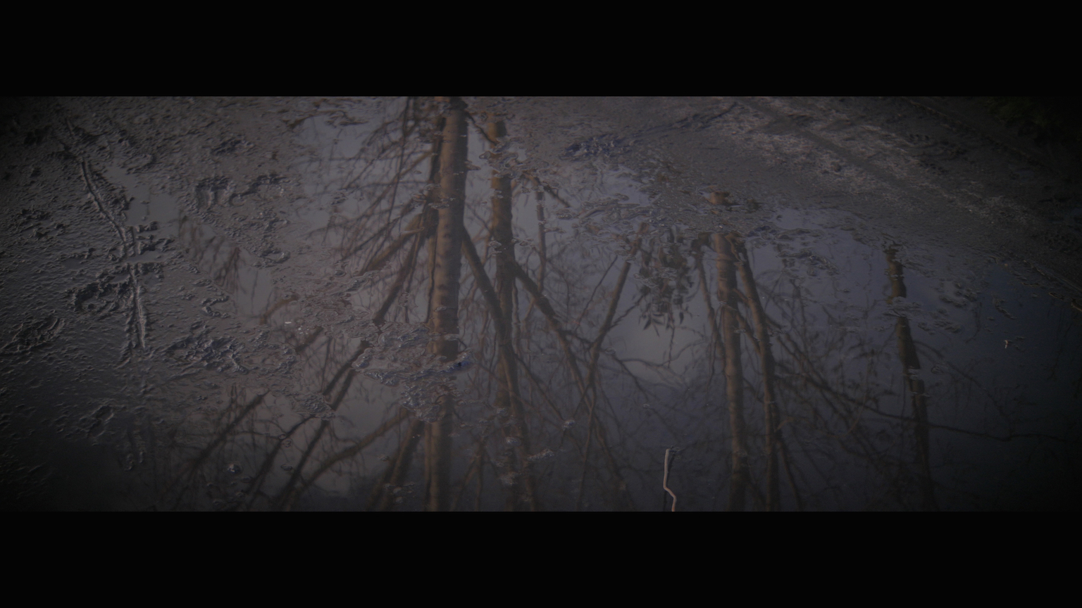

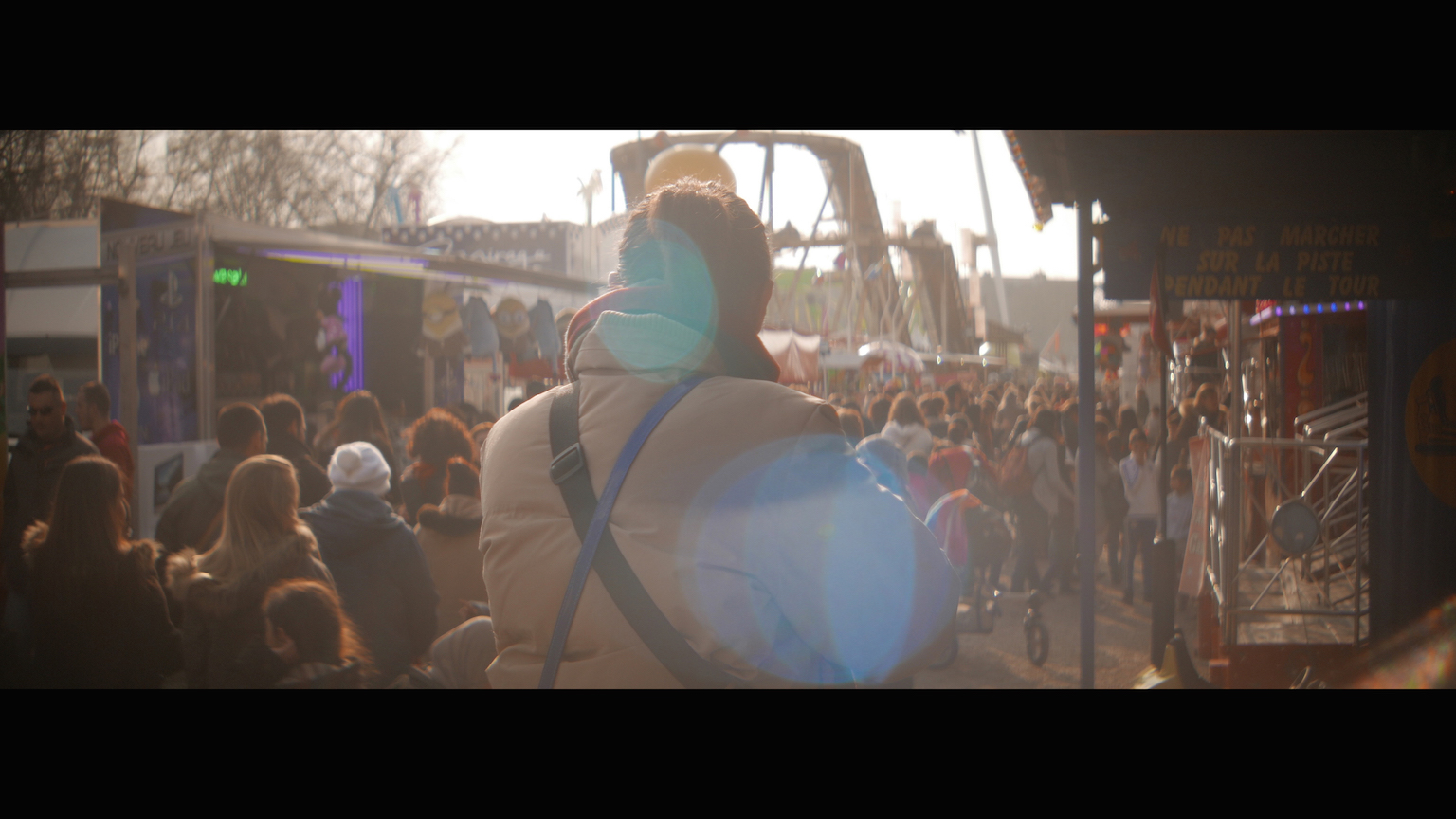

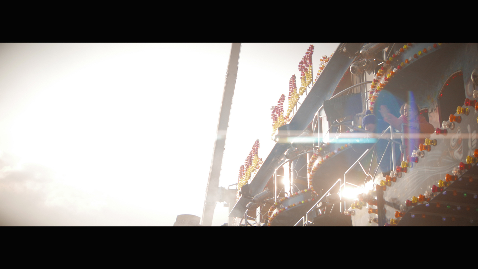

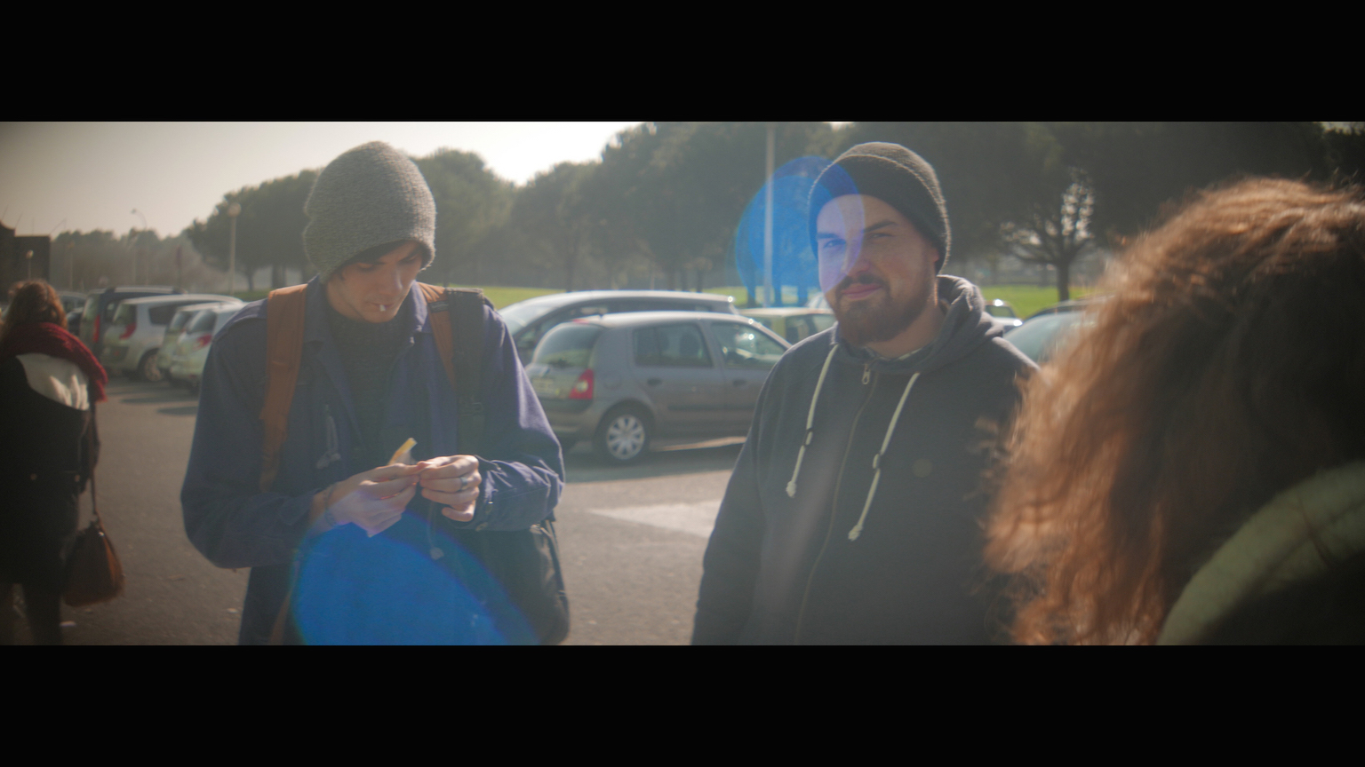

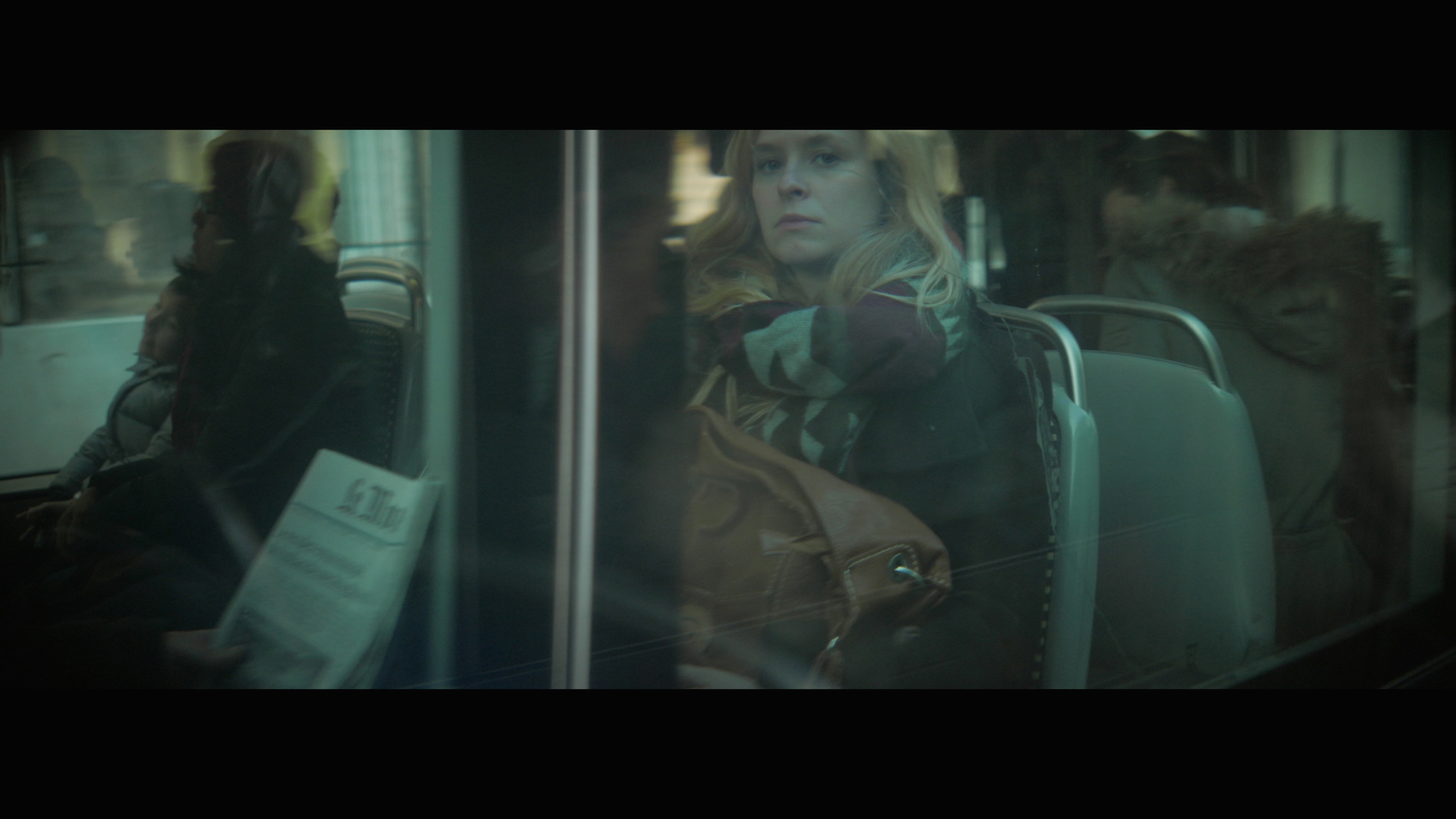

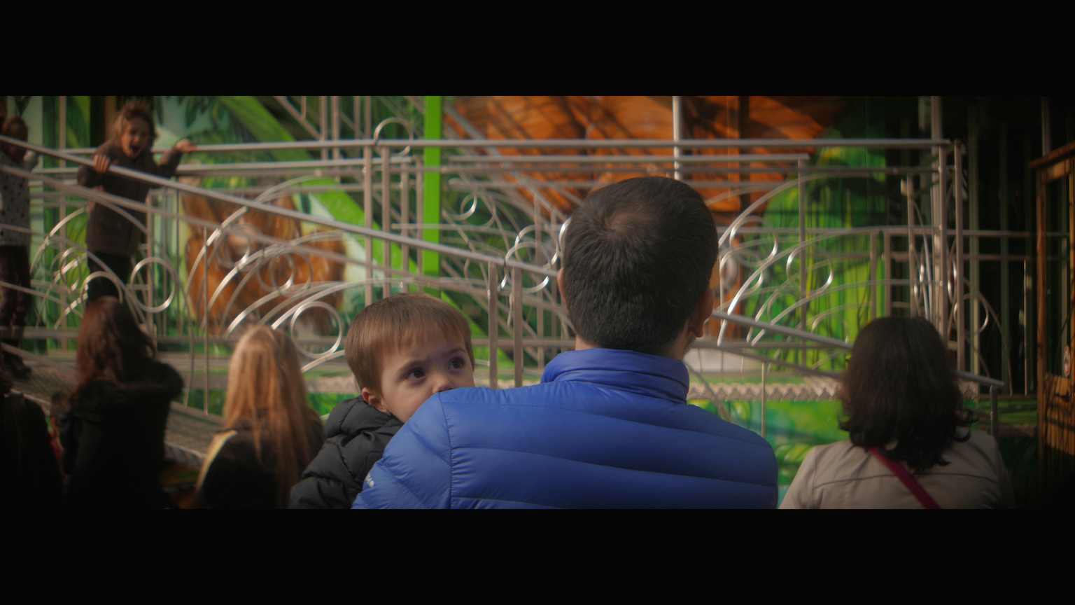

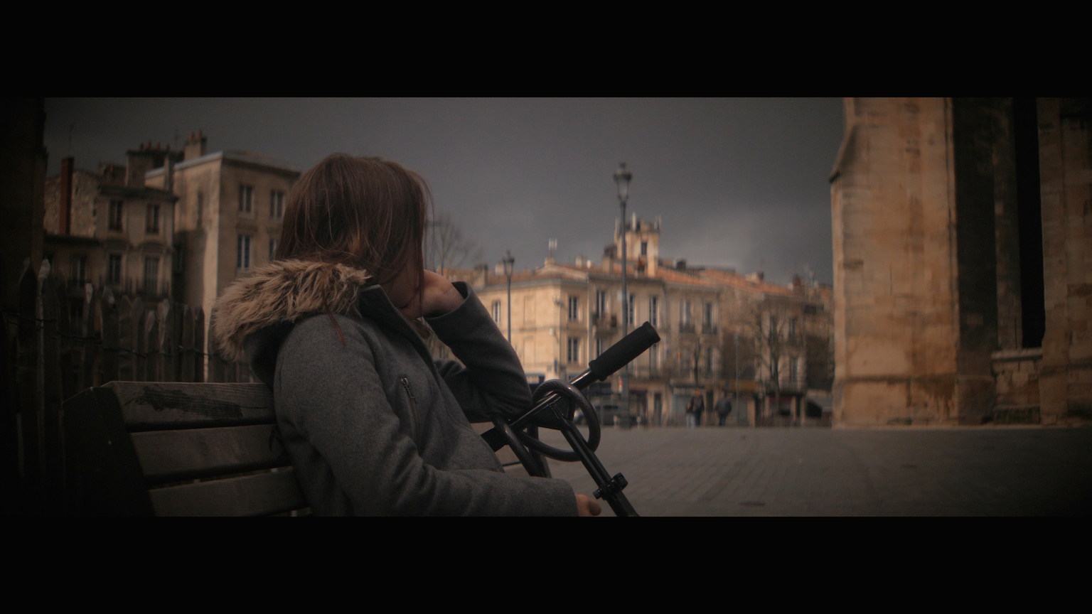

Sebastien Farges Posted March 15, 2016 Author Share Posted March 15, 2016 Some video stills from Flickr's album of the movie https://www.flickr.com/photos/43243778@N04/albums/72157665903659526 shanebrutal and benymypony 2 Quote Link to comment Share on other sites More sharing options...
shanebrutal Posted March 15, 2016 Share Posted March 15, 2016 10 hours ago, Sebastien Farges said: This tube is compatible more or less with the bayonet system attachment of the LX100, so I can fix the system on the camera with care, much better than fixing it on the fragile zoom... http://www.ebay.fr/itm/Filter-adapter-tubus-black-metallic-58mm-for-Canon-Powershot-G7-G9-/262291664068?hash=item3d11cd2cc4:g:XesAAOSwWTRWwZsc Oh now I understand. I wasn't aware the lx100 had a bayonet system for attachments like that. Thanks for the link. I also read that the panasonic lx7 bayonet accessory tube might be compatible with the lx100. I wonder if a 2x anamorphic attachment would work on the lx100 in 4:3 at max zoom (87mm) I have a proskar laying around that I will try eventually. Quote Link to comment Share on other sites More sharing options...
Sebastien Farges Posted March 15, 2016 Author Share Posted March 15, 2016 34 minutes ago, That Guy said: Hmm, it looses a LOT of detail there. What do you mean ? If you want the full res of the video stills they are in the flick'r. Don't forget it's a lens for 8mm film and for me the result on a compact is far surprising 3 hours ago, shanebrutal said: Oh now I understand. I wasn't aware the lx100 had a bayonet system for attachments like that. Thanks for the link. I also read that the panasonic lx7 bayonet accessory tube might be compatible with the lx100. I wonder if a 2x anamorphic attachment would work on the lx100 in 4:3 at max zoom (87mm) I have a proskar laying around that I will try eventually. Îm not sure it will work with a 2x (the baby is 1.75), Îm very closed to vignetting Quote Link to comment Share on other sites More sharing options...
